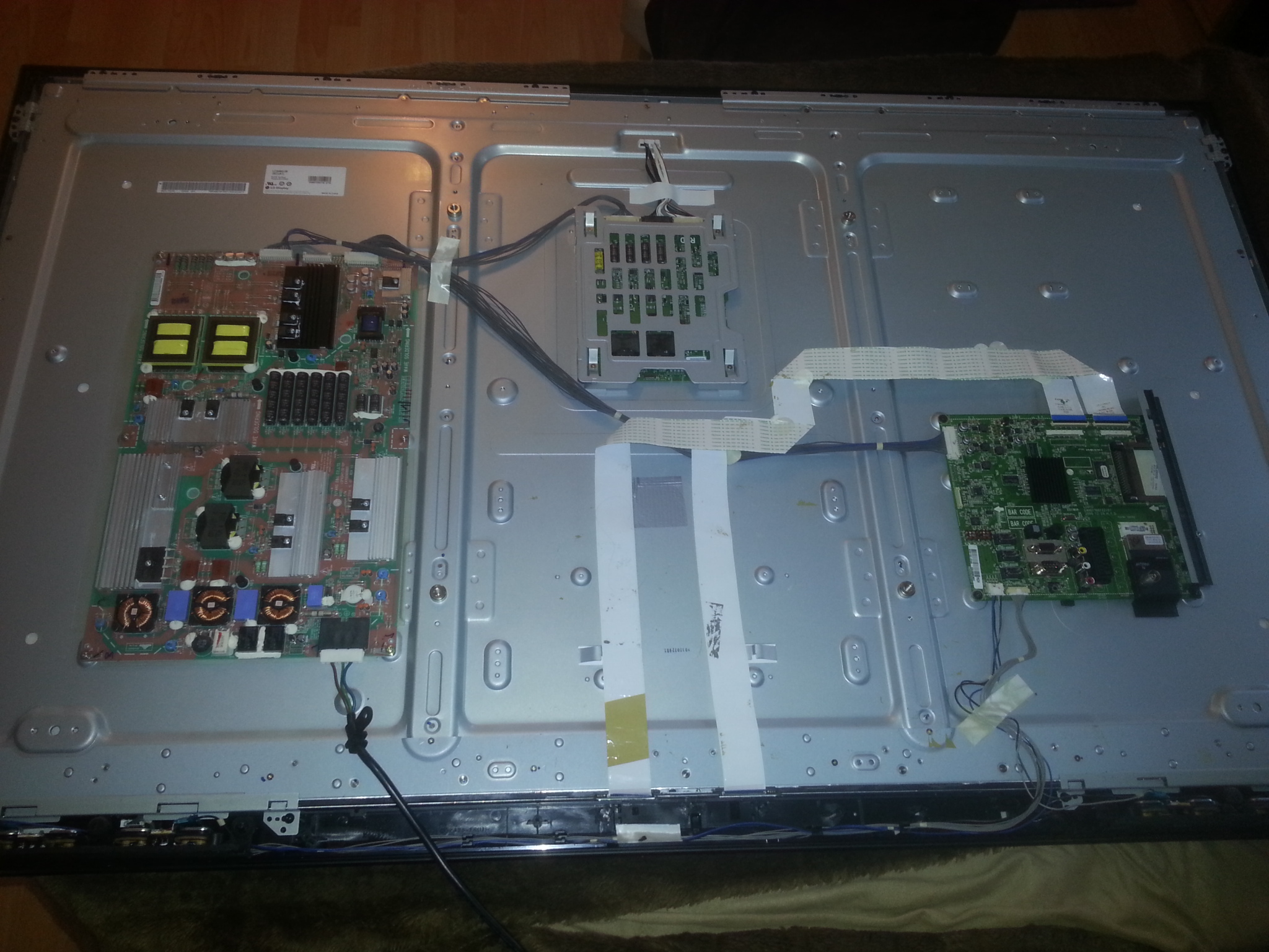

    hello, i habe a lg 55le5300 led tv. i have open the case but dont see and find a tcon board ? xan anyone tell me how it is? best thanks
  • bammbammfran
    • Apr 2014
    • 476
    Re: LG 55LE5300 where is the tcon board?
    I doesn't have a separate replaceable t-con
    It would be between the two flat white ribbons and the lcd board.
    Right now your two ribbons go directly to the lcd board which is permanently mounted to the lcd panel.

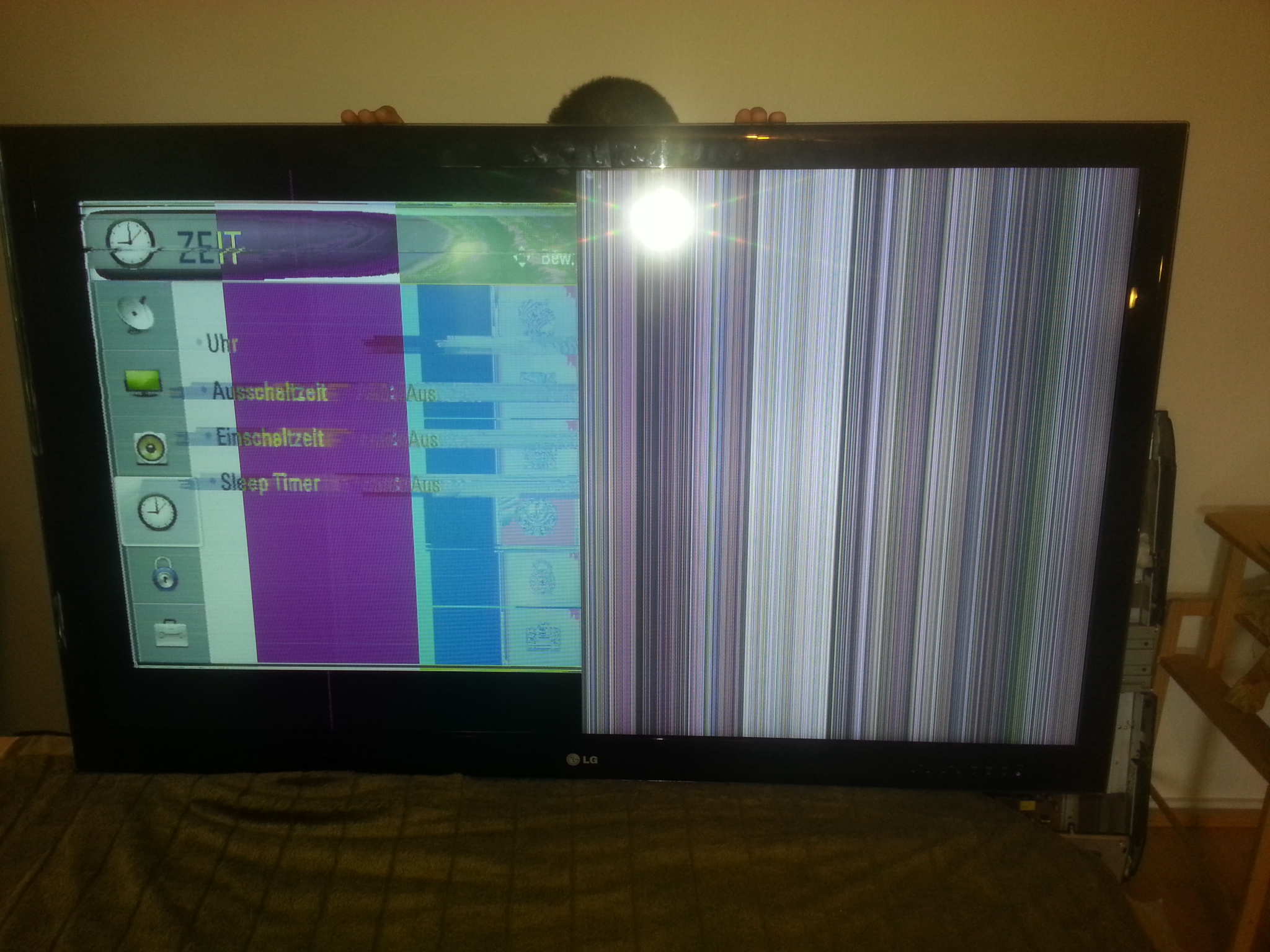

      ok thanks, is funny because on ebay you can buy them for the 55le5300. can anyone tell me where I can buy the white ribbon cable? my have a defective. would explain this error see photo, or a defective panel?
        That's a panel problem.
        Loose connection to the panel.
        You could temporally fix the problem but it would involve taking the tv right down to the panel.
              you would need to take the tv down to the panel.
              leave the boards connected to the back, find the screws that remove the black casing from the front. once removed, you should be left with only the silver casing.
              flip the tv back over so the boards are now facing down, best way to do this is by placing the tv back into the back cover.
              then find the screws that are on the front of the panel holding the panel inplace. remove them and slowly slide the casing off.
              you should now see these.
              http://i1.ytimg.com/vi/xHst6pKLtTE/maxresdefault.jpg
              with the tv on gently appl pressure to them, you should find one that when you press down the picture comes back.
              now the difficult part is how to get the pressure without holding your finger there.
              some folk use rubber or silicone. wedge it into place with the panel casing. takes a few attempts but can be done, sometimes it doesnt last long, other times, if done perfectly, it might never happen again.

                Try to switch the two flat white ribbons first and see if the problem changes sides
                Switch the positions on both ends.The one cable might not be long enough, so you might have to loosen the main board to get it to reach
                If it switches sides, then one ribbon is bad
                If the problem does not switch sides, disconnect the ribbon on the worse side to see if the better side clears up since it also has a problem

                  hello, thanks i have switch the ribbons and the stripsand the stiff are now on the other side so I could get lucky I'll buy new and report immediately. the model has a tcon? and it is installed panel? on ebay you can buy one
                    If you changed both ribbons at both ends at the same time (swapped the ribbons places)
                    Then you need to change the flat ribbon
                    you need to measure how wide the ribbon is and how long and count how many contacts are on it
                    If you only swapped one end at the board then the main board is the problem with the inputs is bad
                    If you do not understand
                    post a picture with the ribbons swapped

                      ello, now i have change the 2 ribbon cable but the picture mistake is the same, habe anyone a idea what can i do? or its a panel faulty?
