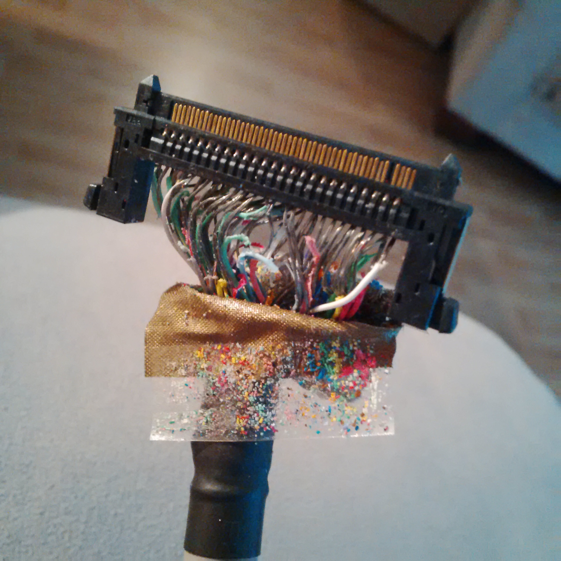

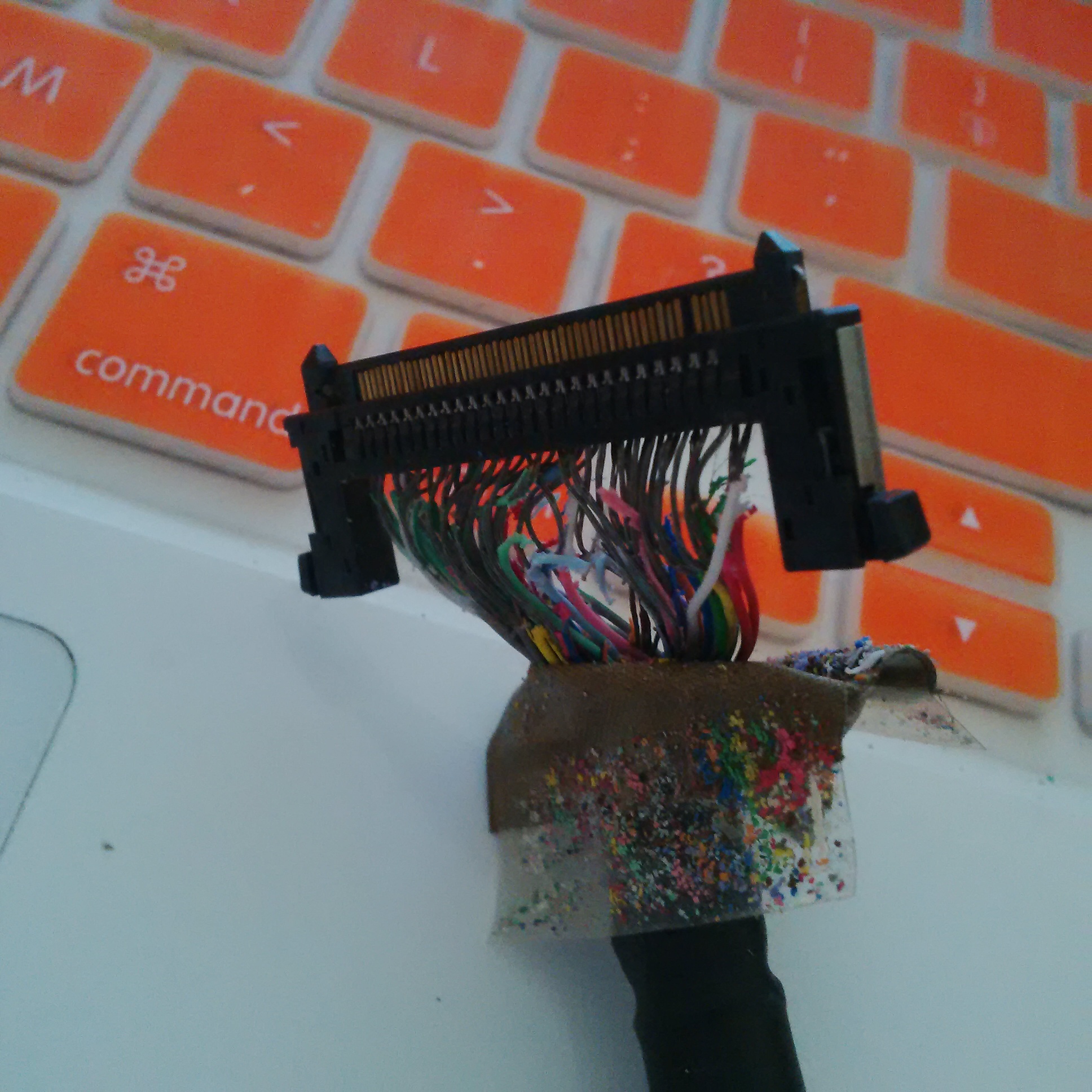

    I have never seen this from any tv since I started this hobby. I have an LG 32LB9D tv with 33000 hours. I replaced all the caps including the main cap. Also had to reflow the power board to get the sound back. I have another post on this tv. I thought it was all working great until I saw flickering when I turned it on. Check out the pics. How would this have happened? Anyways I'm looking for a part number to replace the cable but can't find anything in the service manual. A little help?
    EDIT: The only numbers on the cable are 6631900133F. Google search shows companies I have never seen or used before.

    Similar to this
    https://www.badcaps.net/forum/showth...008WFP&page=12
    start at post 240. I think I have seen 2 others.

      I wish I could solder new lines but they are melted right to the pins. I saw a 6631900133A on ebay but no idea if it would work.

        wires are a mess
        I might be able to find you the plug and or replacement pins if you can find out what wires were from where
        what is the pitch (pin to pin center)
        or what is the distance from the first pin to thee last pin (then divide that by 50)
        • dcapper

            Re: Need Help Finding a Part# for LG 32LB9D
            You may have to do that if you can not find the entire cable.
            plug looks like FI-RE51HL
            with two types of pins
            FI-RC3-1A-1E-15000 and FI-RC3-1B-1E-15000
              this ebay one does not have enough pins and looks like a different pitch and all the wires go in on one row instead of two

                          Mine is a UA version. I found a LVDS cable at home I can cut. Some of the pins are in different spots but I can move them. Rather replace it though.
                          • dcapper
                            • Dec 2013
                            • 496
                            I just acquired an LG 42LK450 tv and the LVDS cable worked great and found another one on Ebay to replace the one I used. It's a little long but it works fine.
