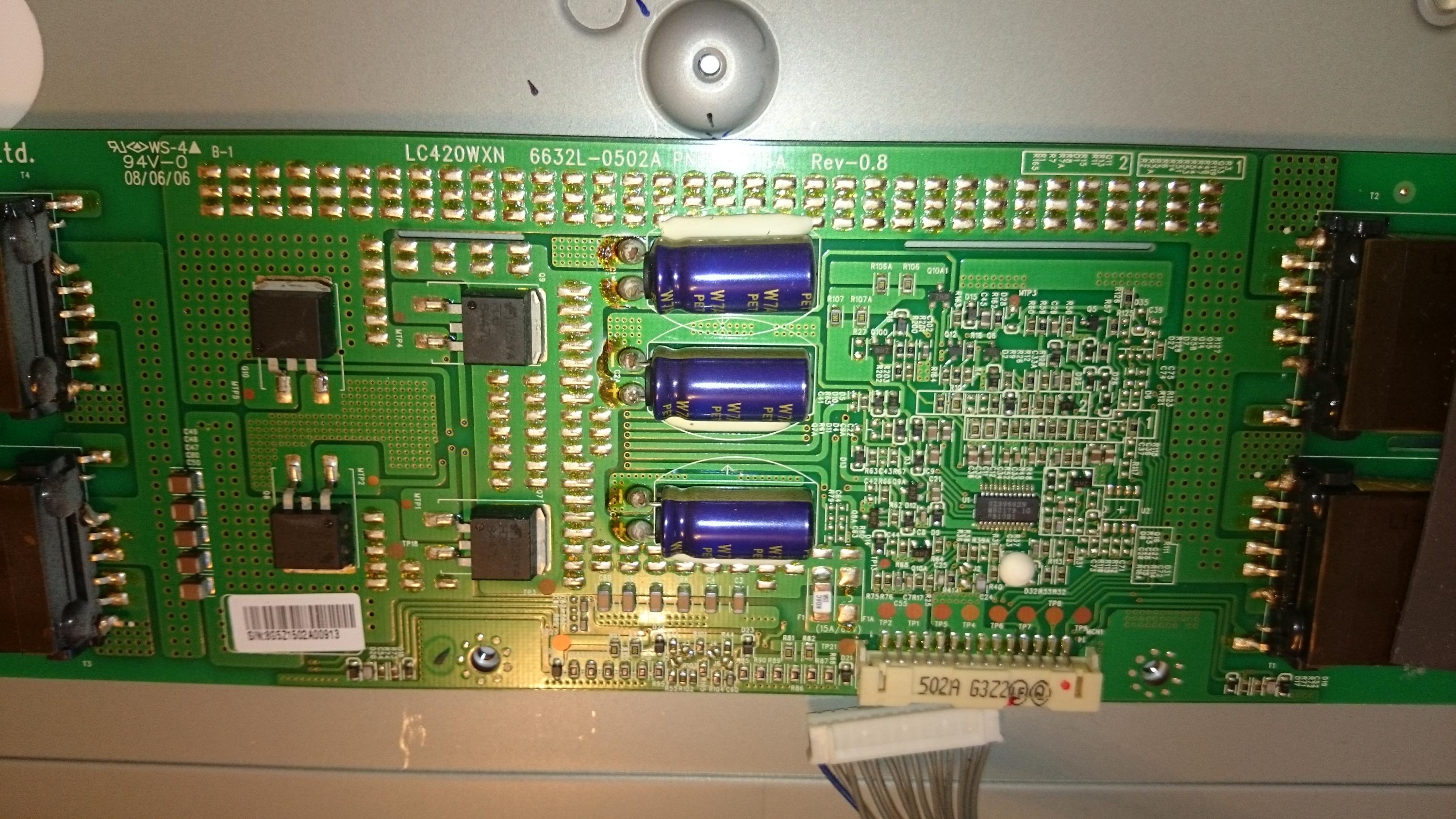

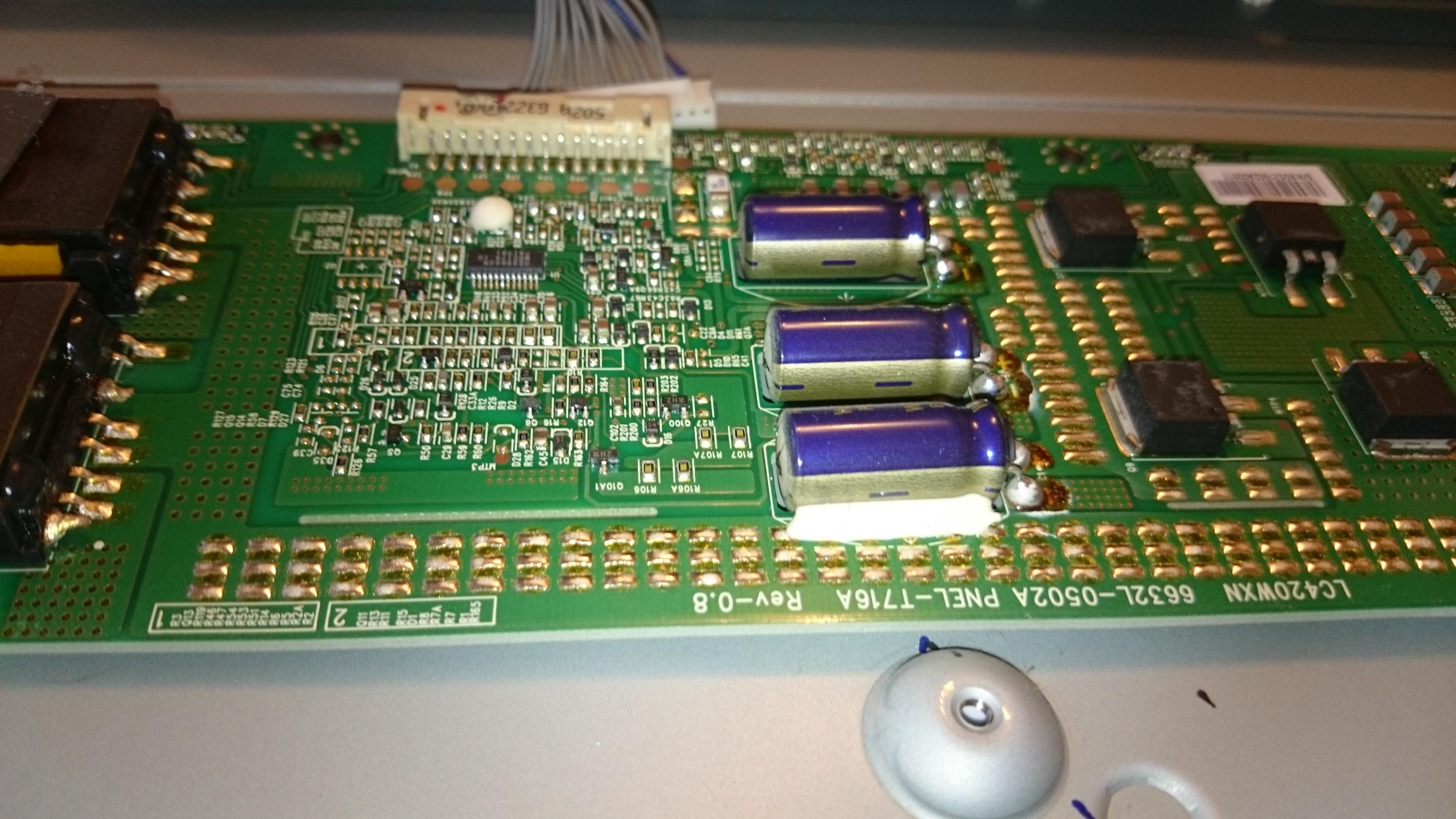

    42LG2000 intermittent switch on
    few pics but Im suspecting the 3 Bulging caps on the inverter board so far...
    Tv still switches on, and voltages look good on PSU
    What do you lot on here think? is this a common problem
    Is it likely to be any thing else?
    I hate intermittent problems!!!!! :-0
    Re: 42LG2000 intermittent switch on
    If no backlight then yes those caps could easily cause your fault.
      ill try and get it to fault before i take them off and see what happens
      would you say its better to replace the caps or the whole board??
        I would replace the capacitors. You can buy genuine Panasonic FM/FR/FC from CPC with free delivery. Replace all Samwha caps (if there are non bulgers on a second inverter replace them too, they won't be too far behind.)

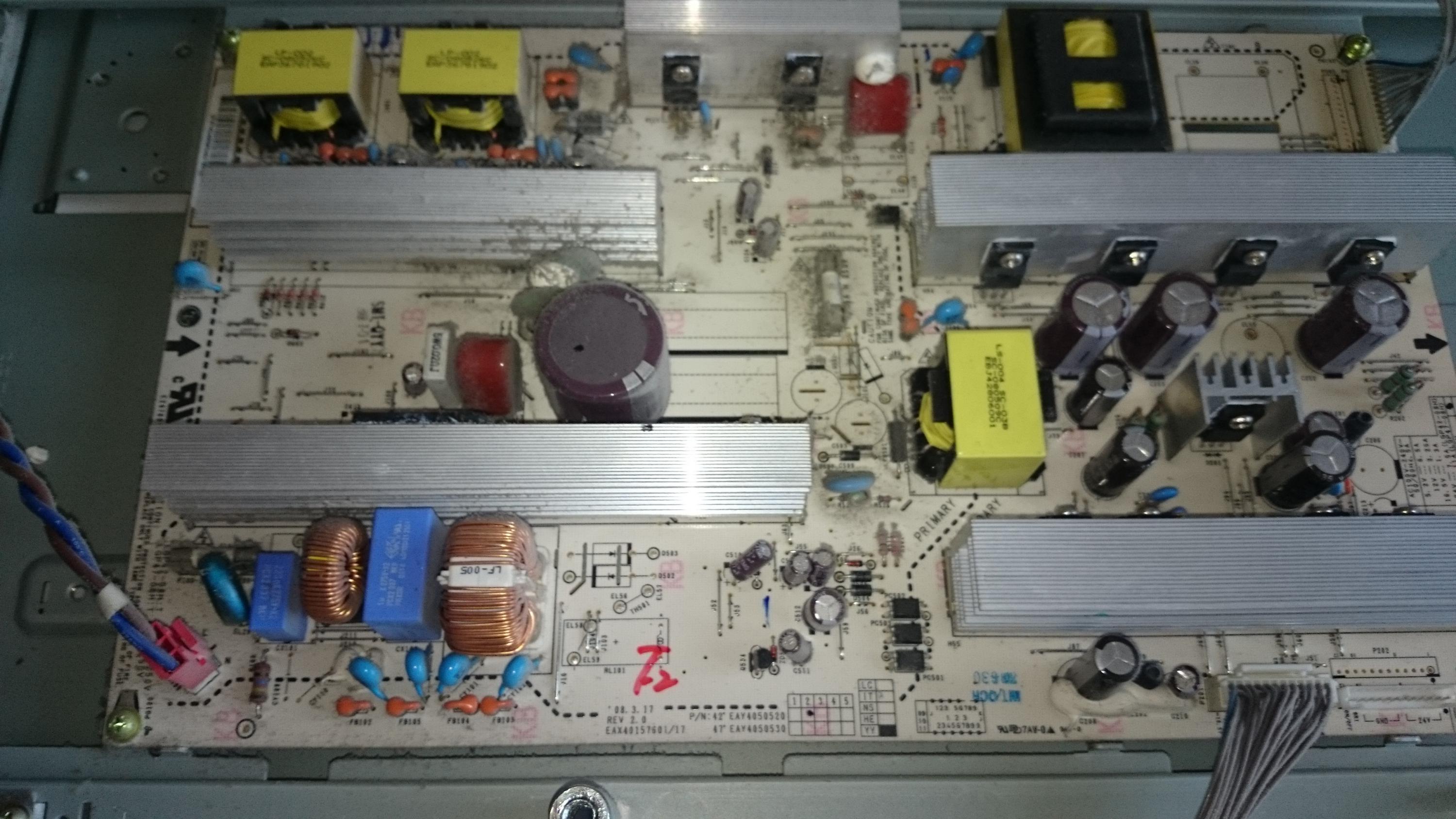

          theres only them on the inverter (only 1 board)
          the ones on the PSU are all SAM YOUNG (are these ok?)
          ive never changed a sam young yet so my guess is there pretty good caps?
          p.s ordered Panasonics today
            Samyoung are "OK". I've not seen one fail yet. They used to be Chemicon subsidiary but broke off about 10 years back so I think they kept some tech from Chemicon.
              I've seen many failed ones but it's always been in really old sets so i'll give them the benefit of the doubt. Certainly better than Samwha or Teapo.
                changed the caps and retested today, everything seems to be ok so far
                will retest for a couple of days see if it faults....can any one recommend a test procedure? like leaving it on for so long then on off tests etc or whats best test?
