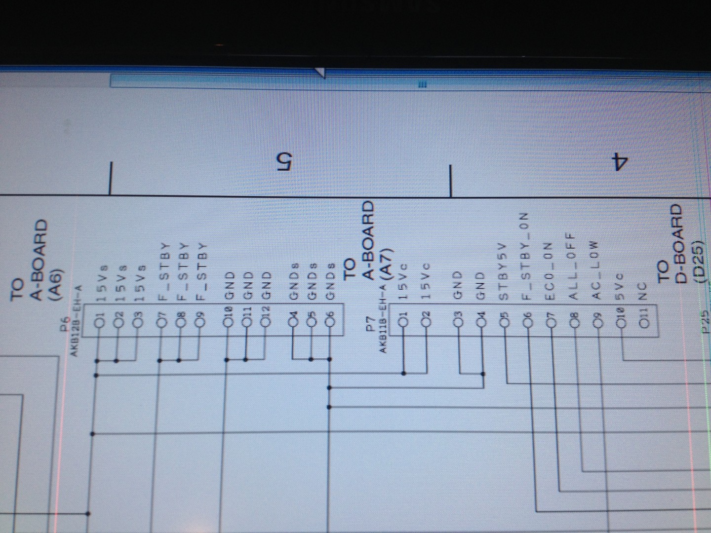

    On P6:pin 7,8and 9 I have 15 volt (F-STBY)
    On P7:pin 5 I have 5volt (STBY5V)
    :pin 6 I have 3.3 volt (F-STBY-On)

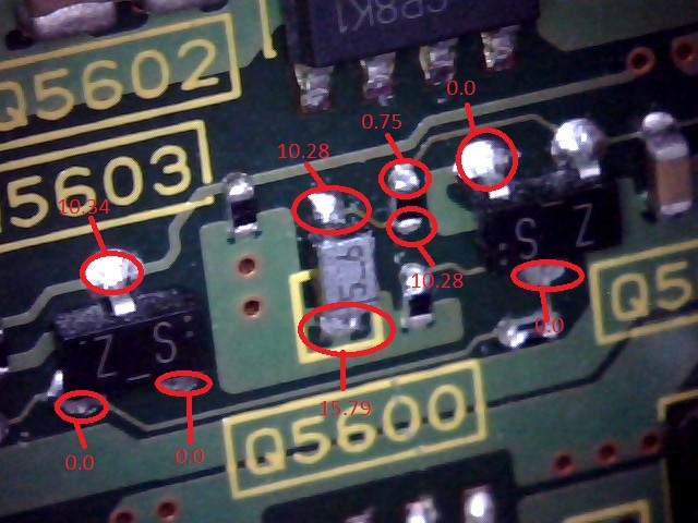

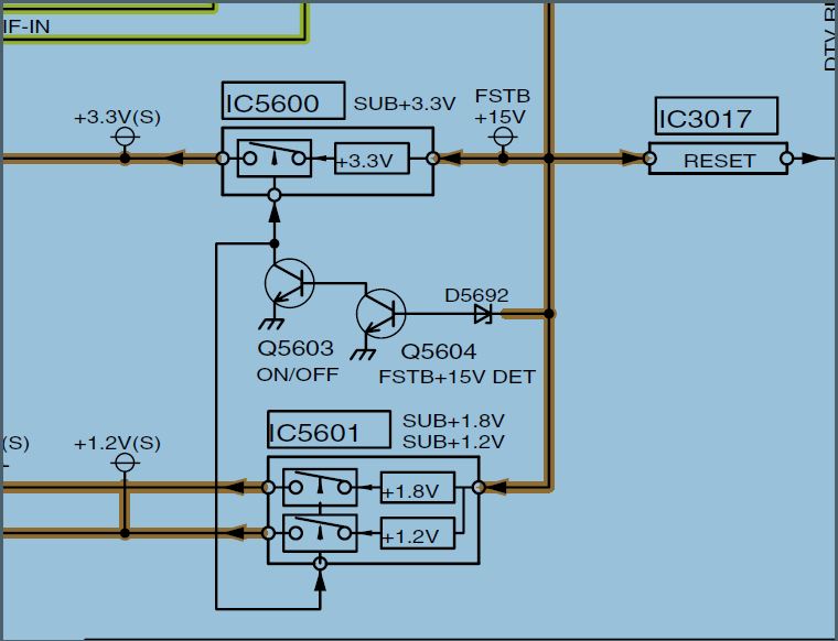

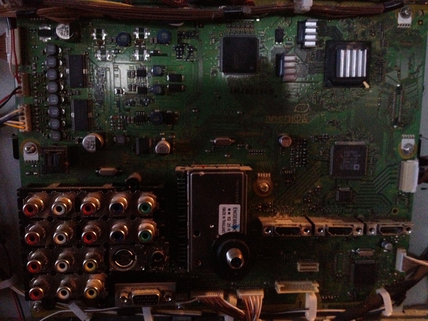

          poking around on the mainboard,concentrating on this area,see pic#1.
          see pic#2 for voltage reading,does that make any sense to you?

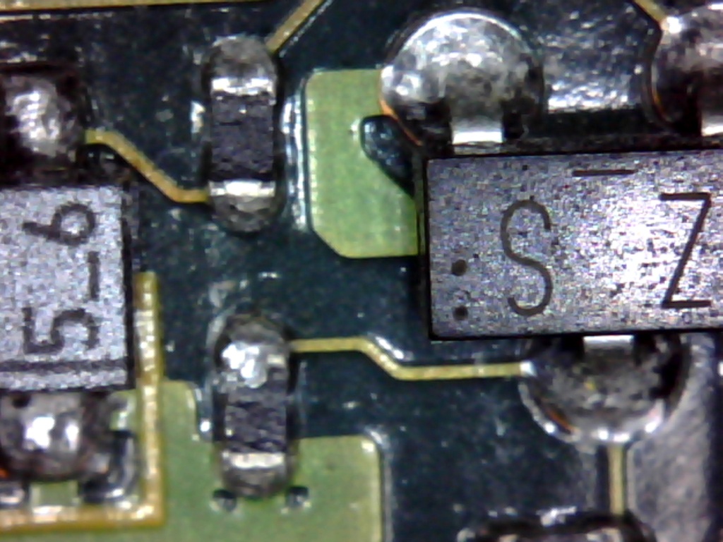

          pic#3,close up of suspect area with my handy little usb microscope camera
          Q5603 and Q5604 =2SD0601ARL=transistor
          D5692=MAZ80560LL=zener diode

            Re: Panasonic TH-46PZ800U dead.
            FSTB+15V det fault would probably cause 2 or 10 blinks.
            Have you checked the 3.3V, 1.8V, 1.2V, etc.?
