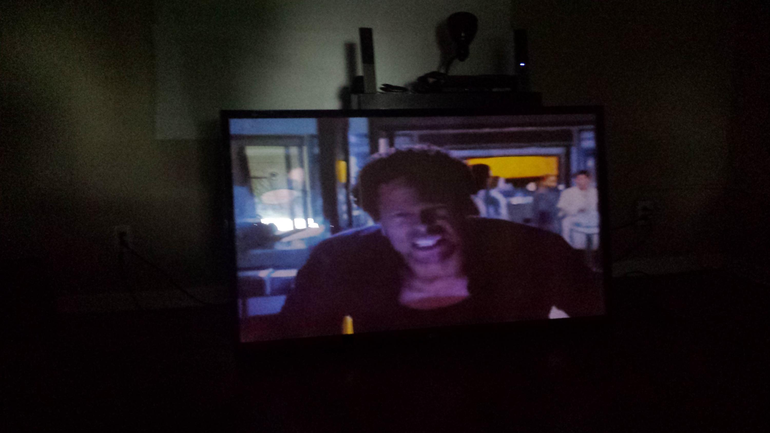

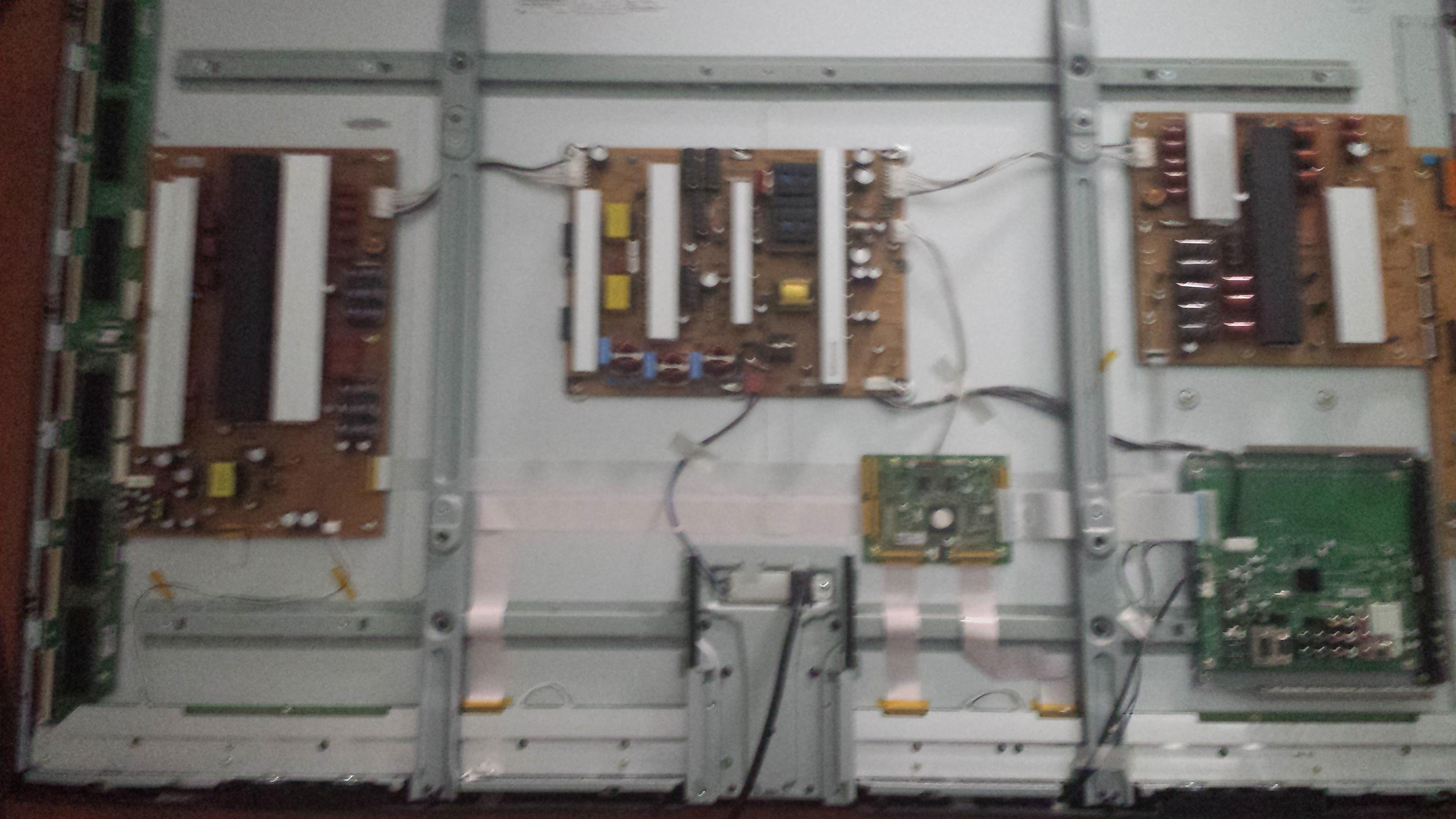

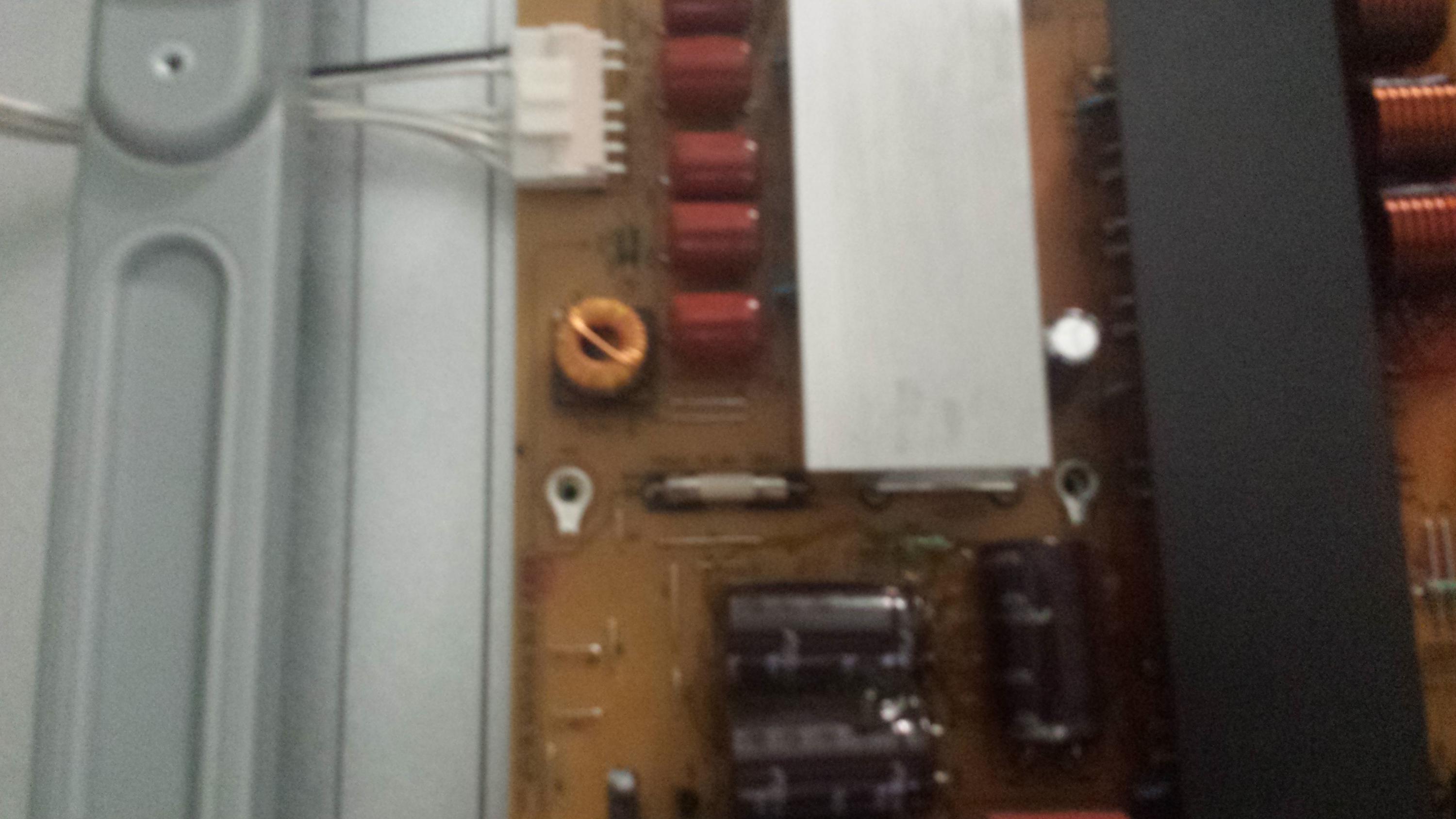

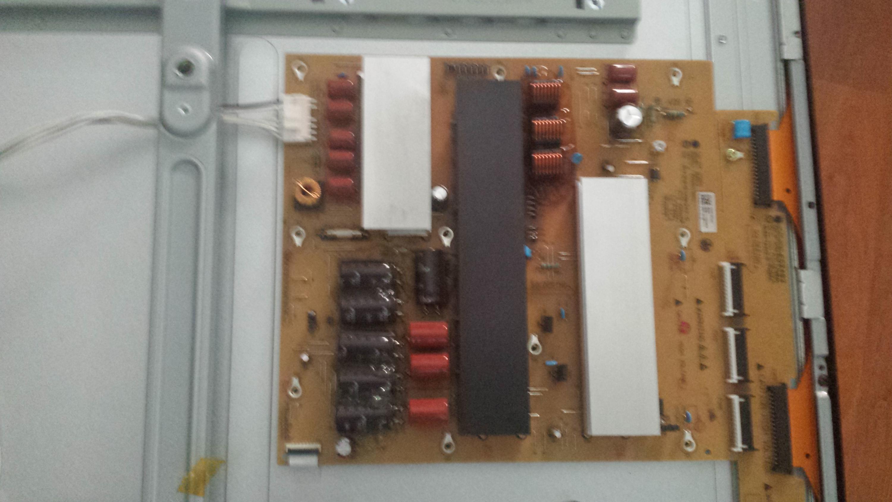

    Got one of these given to me, it is only 3 years old. Came on but very dim and washed out colors. Opened it up, checked all fuses and the zsus fuse was blown. Also there are 3 copper coils that had lost their solder connections to the board.
    Replaced the fuse, re-soldered the coils and bam. now the tv wont power on at all. It cycles on, relays click, red led fades out, more clicking, then stays red
    Should i just order another zsus? they are about $60 and that would be a great price for this otherwise MINT plasma tv.
    Thanks in advance, I'm posting an image of the tv before i did anything to it.

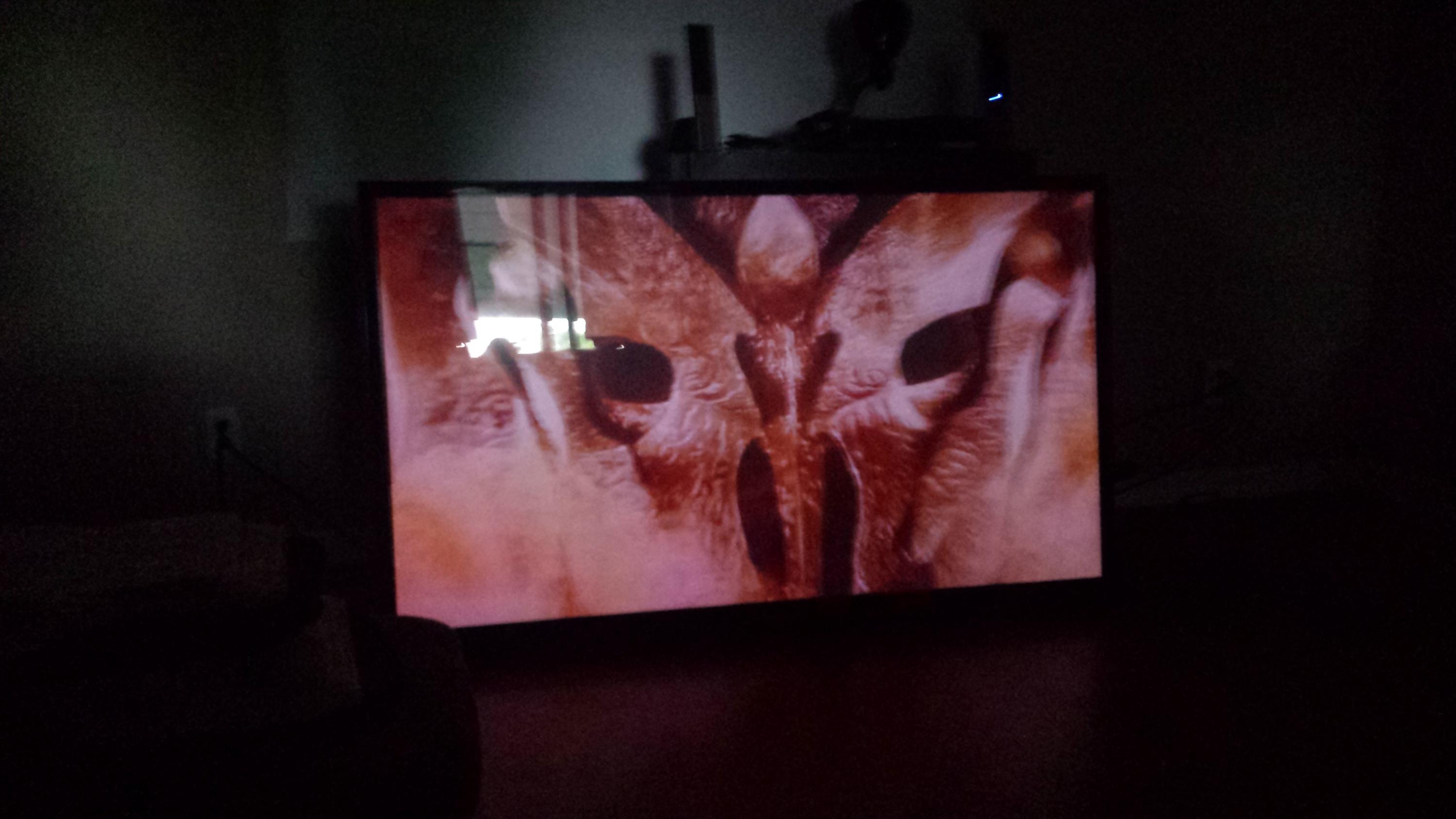

    More photos. And the zsus fuse did not blow again when i turned it back on. The two screen photos are from before i replaced the fuse and resoldered. still have no image at all

        I'd unplug the zsus board and see if the TV powers up. I guess the attempted repair could have damaged the supply. Doubt it, but possible.

          Thanks for replying. I unplugged the zsus as you said and the tv does power up, I have static sound but no picture at all. Plug it back in, goes back to no sound no picture, and relays clicking a few times as before

            Going to order a zsus, and report back.
