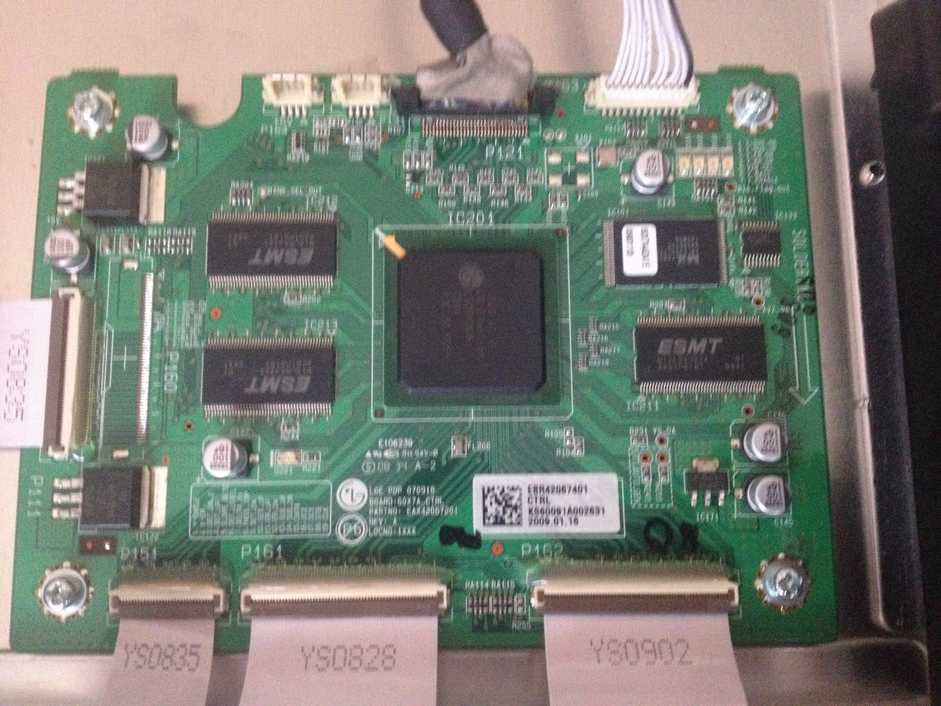

        I'm posting a pic of board, as I can't find the points,
        Maybe you can point them out for me please.
        And do i just link the 2 points with a wire?
          Re: Lg 60pg3000
          The two points just below VS_DA point, I think marked AUTO GEN, bottom right of board.
          You also need to unplug top most connector going to main board - the LVDS cable.

            Re: Lg 60pg3000
            ok, found it, crossed the 2 points, and the screen still shows red pixel sparkling,
            nothing else seems to happen

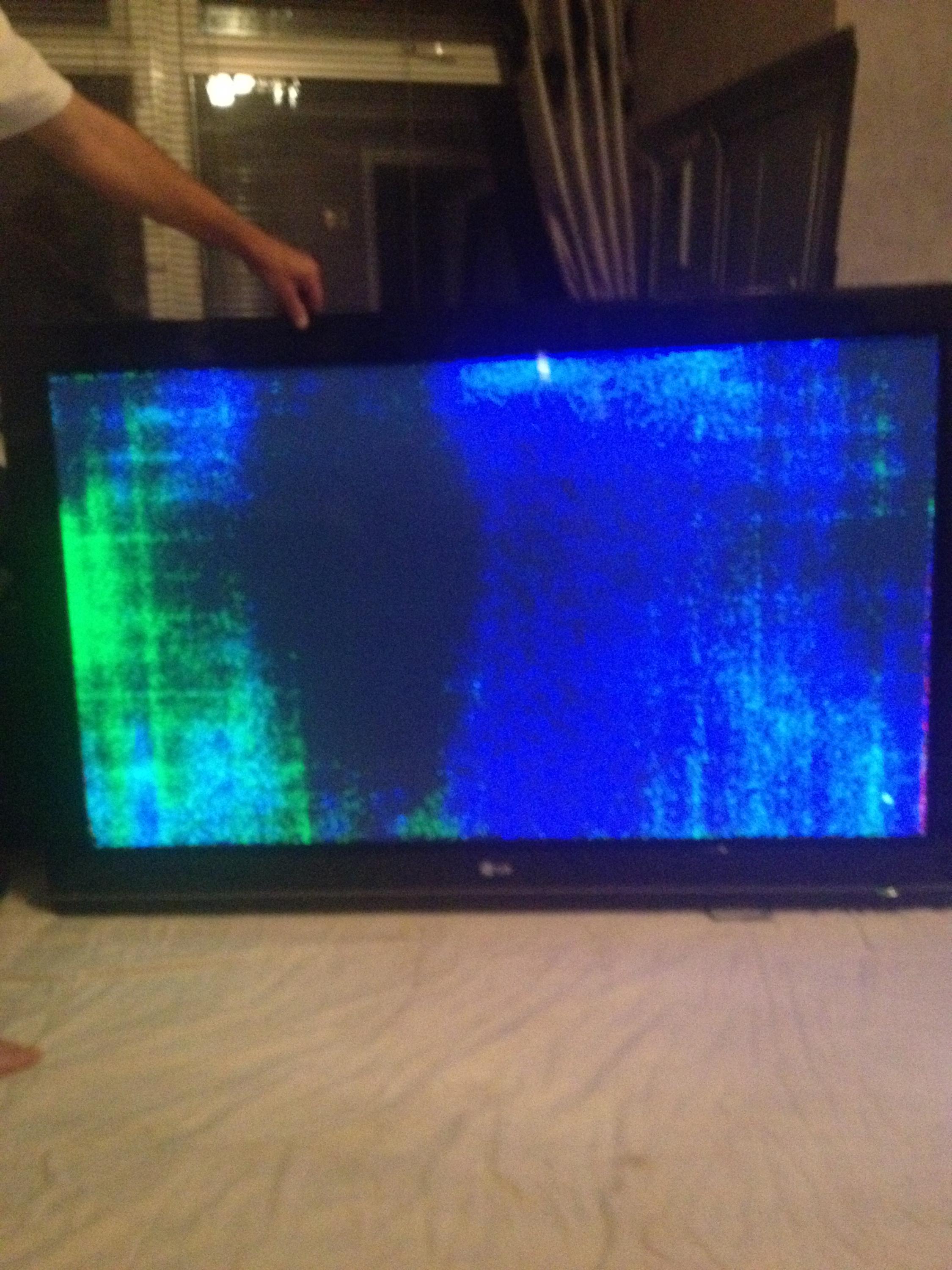

                        Re: Lg 60pg3000
                        This is what i have now with buffer disconnected, this image flashes 4 to 5 times then screen goes black for 10 seconds then repeats flashing image again.
                          Re: Lg 60pg3000
                          Which buffer out? Odd image given one removed...

                            Re: Lg 60pg3000
                            That was with 2 buffers disconnected,
                            when bottom disconnected same image on bottom half of screen only, the top half is black with red sparkling pixels as original with all connected.
                              Re: Lg 60pg3000
                              I am surprised you can get an image like that with both buffers out, did you completely unplug them from Y-sus? They are screwed in I think, so you need to undo the screws too, as they carry drive current.
