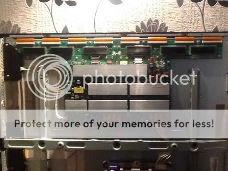

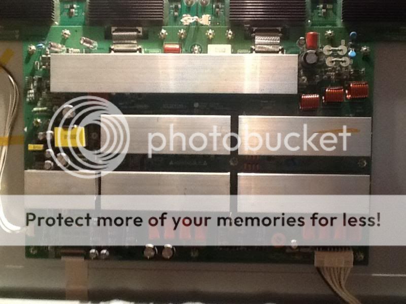

                        Well if you could supply a picture I could tell, it is hard to describe, address buffers on top and bottom of panel instead of ones just on the bottom. This is why we ask for pictures, every TV model (especially plasmas) are different sometimes even with the same model, is it so much to ask for even a camera phone pic...? Some X-buffers have fuses on them, or connectors that can come astray. Control boards can sometimes split the picture drive into two halves, which is apparent from how the control board is laid out (component and connector position, number of processor chips, etc.)
                        Heatsinks on a sustain board running cold isn't necessarily a problem - the panel will be running at less than half its rated power with a half screen fault, so the heatsinks might not be getting noticeably warm. Also, half the job of a heatsink is to effectively dissipate heat - the better it is at doing this, the cooler it runs, so it could just be an over-engineered heatsink. On my Kuro, the heatsinks get barely warm above ambient even after running for hours.
                        Since it is obviously intermittent, and this is almost always temperature dependent, I recommend you try to locate the temperature dependence by heating up parts. It would appear from your description that the TV gets better after time, so something will be heating up. Running hot air over parts may reveal exactly what is causing the fault.

                          Re: Lg 60pk590 half screen fault
                          Here is some pictures for you tom
                          The two heat sinks in middle of the Ysus are the ones that stay cold
                            The two heat sinks middle and bottom in the middle of the Ysus are the ones that stay cold

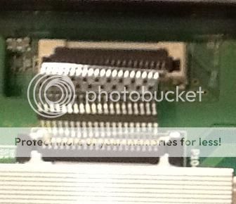

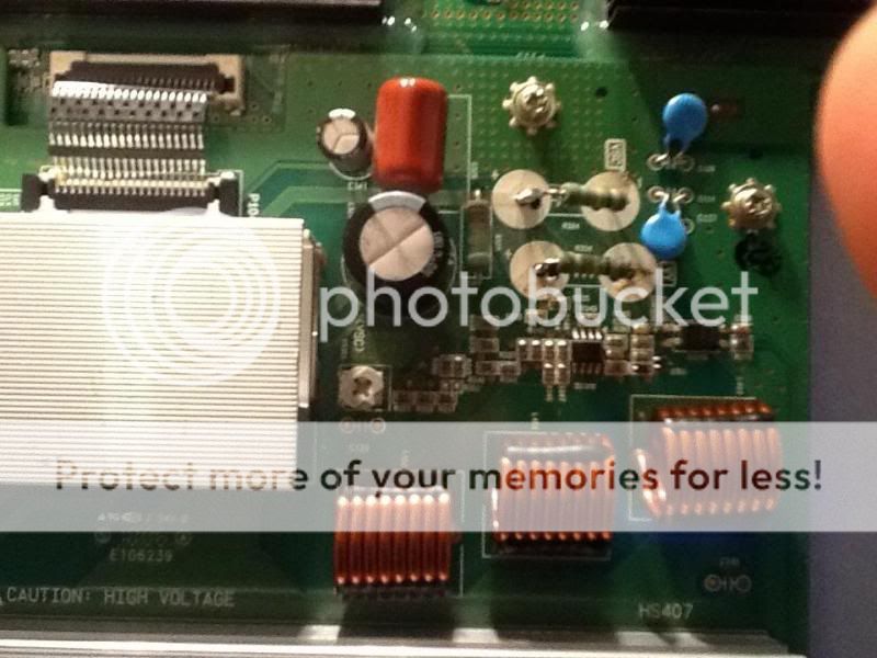

                                It is unlikely that the coils are bad, but perhaps the connectors nearby it. The coil connections going bad would affect the whole screen.
                                  This is the area tom any ideas where to start please mate
                                    Right waited till TV cooled and went went half with a hair dryer on full setting I aimed it at the main connector and tv flickered then bounced into full screen 10 secs or less
                                      Poor connection? Clean all connections, make sure all pins seated, check solder connections.
