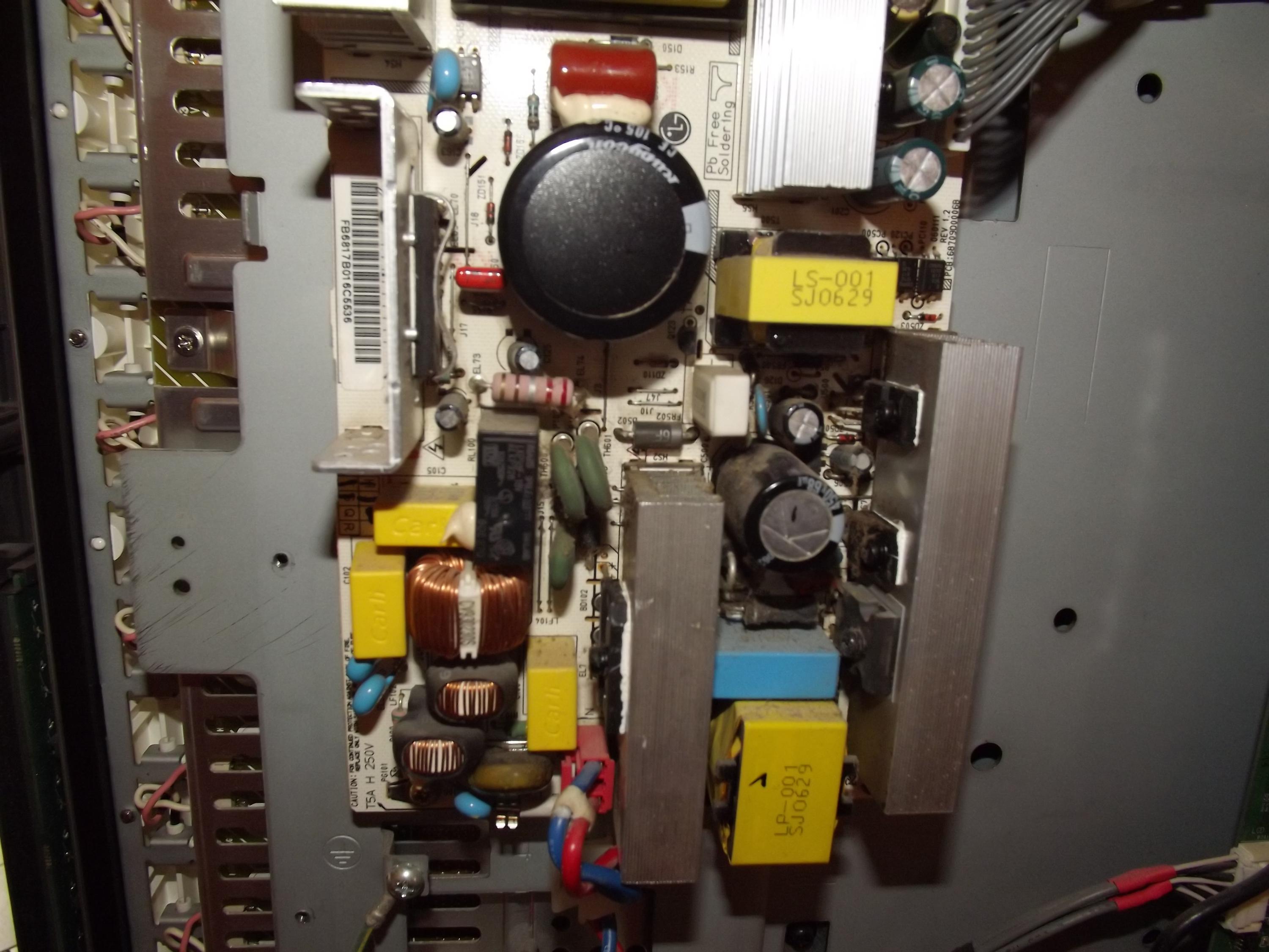

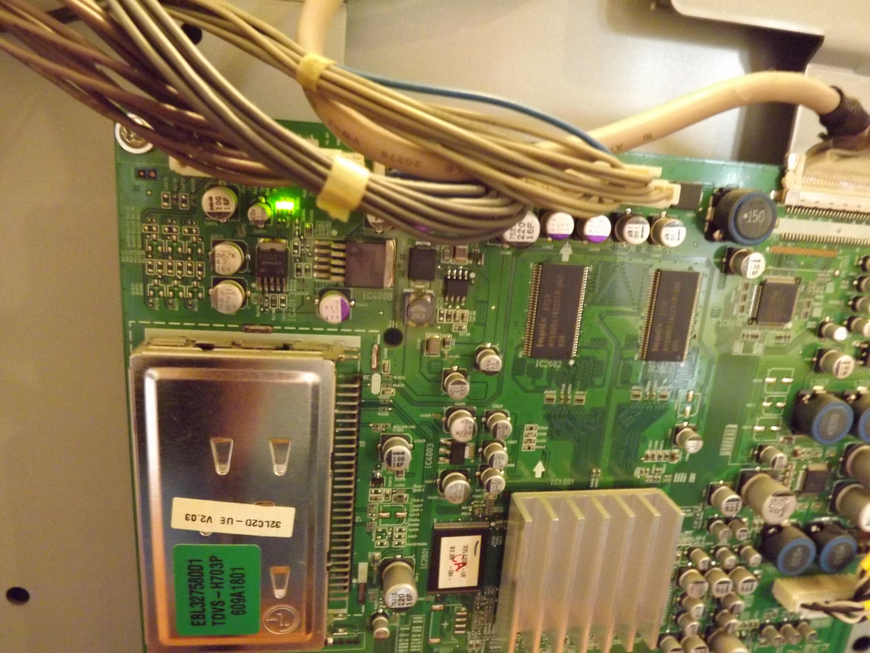

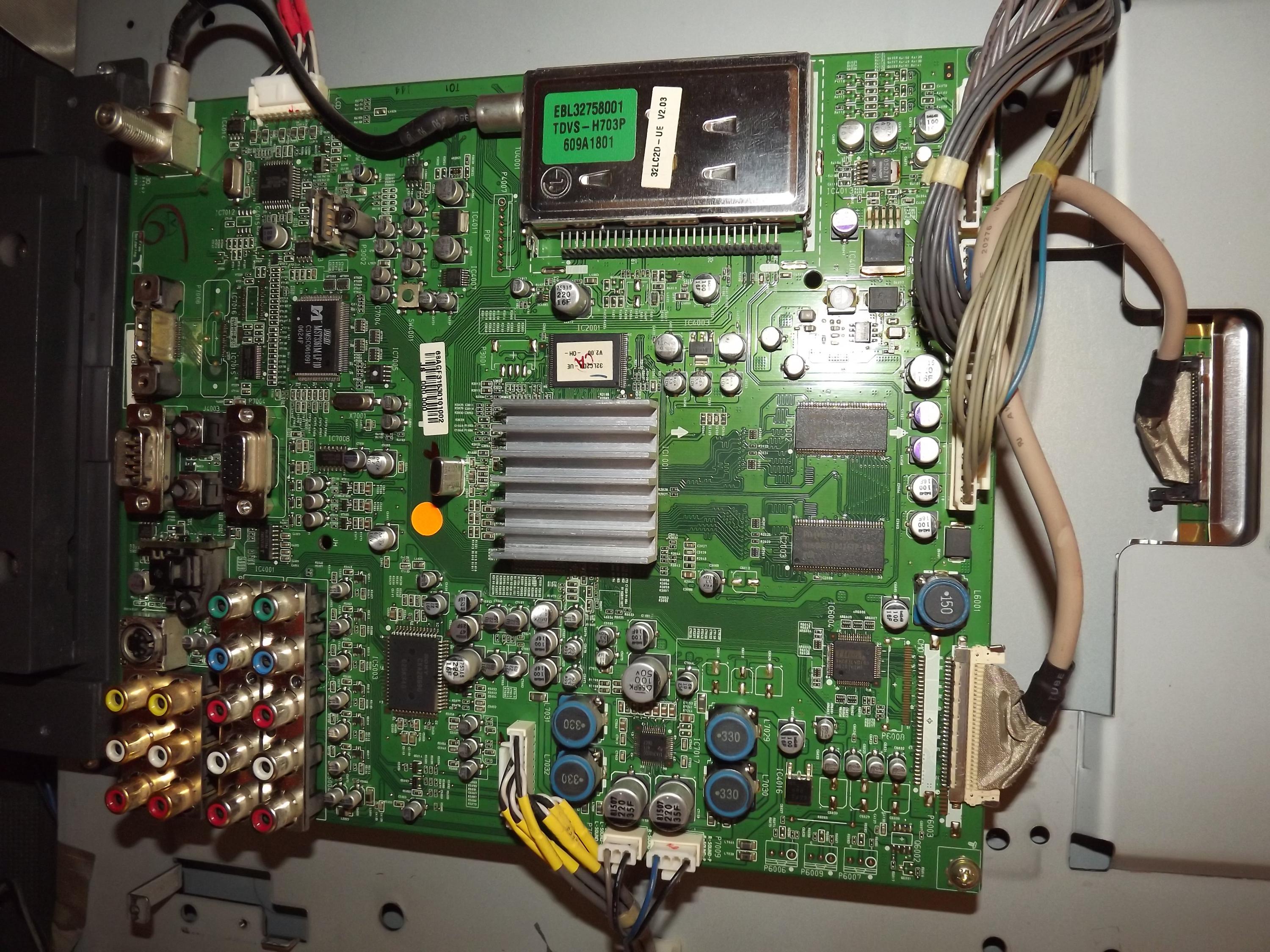

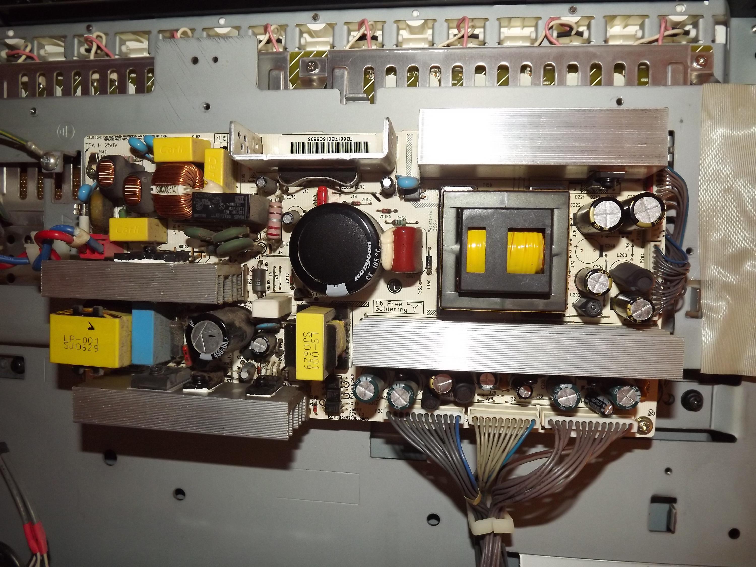

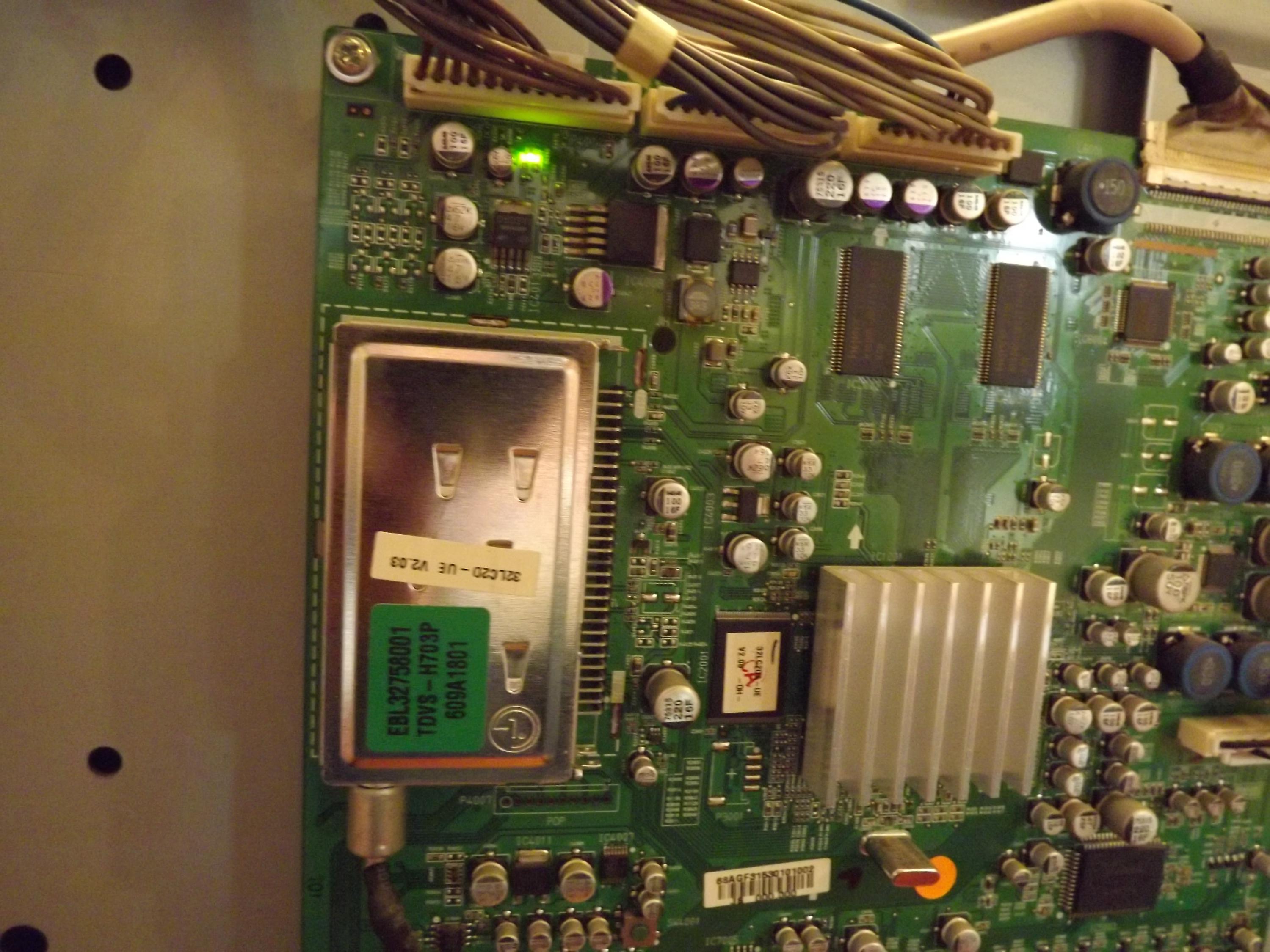

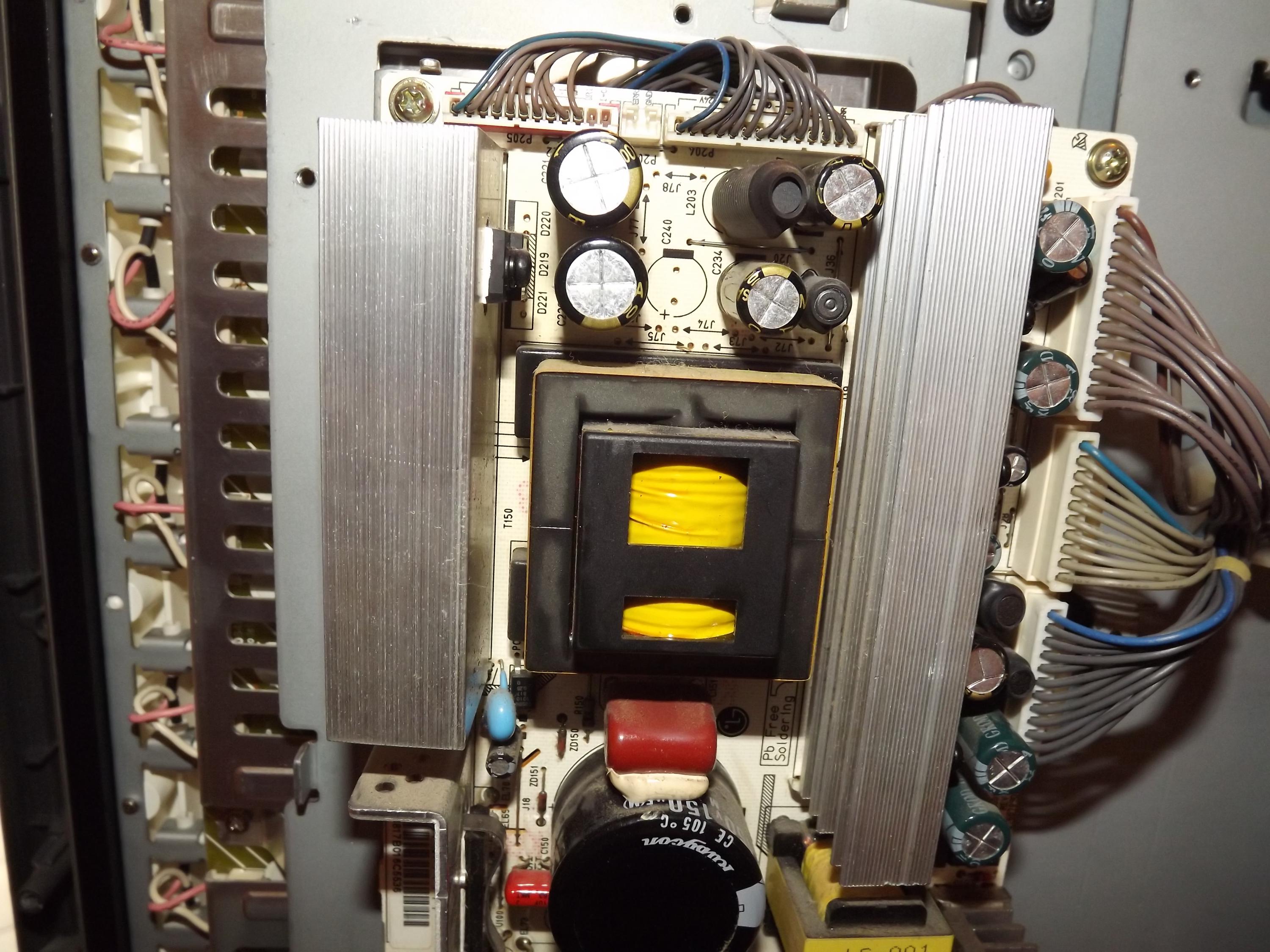

    I previously replaced a cap on the PSU in this unit. From the time I did that, it worked, albeit with a bit of a whine that I was never able to solve.
    Now, the unit has failed again.
    I still get the same whine when I plug it in. I get a flashing front panel light and a relay click. If I press the power button, the front panel light goes solid, but, I get no backlight. Other than this, none of the buttons work. Menu, Channel, Volume, Etc. Even Power to turn it back off.
    I found a PSU for $59 but, unless I can pretty much isolate this as being the issue I am not up for spending more $$ for this unit. And I am not the most wonderful at soldering, so re-capping the whole PSU would be a daunting task. 1 cap is 1 thing. 20 is a whole other ballgame!
    Please find photos attached.
    Thanks.

      Re: Need more help with Zenith 32LC2DA-UE.AUSUZBM
      Check the 3.4V output on the PSU. Is it measuring about 3.4V? Common failure on these PSUs.
        Hello. I thought I posted my answer to this, but, I guess it didn't take.
        I had to unplug the connector to measure the voltage, if this does not taint the results, I am reading 1.64 volts on all the 3.4V pins.
        Is there a specific component or set I can replace, or is this $59 board a good option?
        Thanks.
          You should be able to do it with the connector installed, there is a small piece of metal ring around the component pin whcih you can touch.
