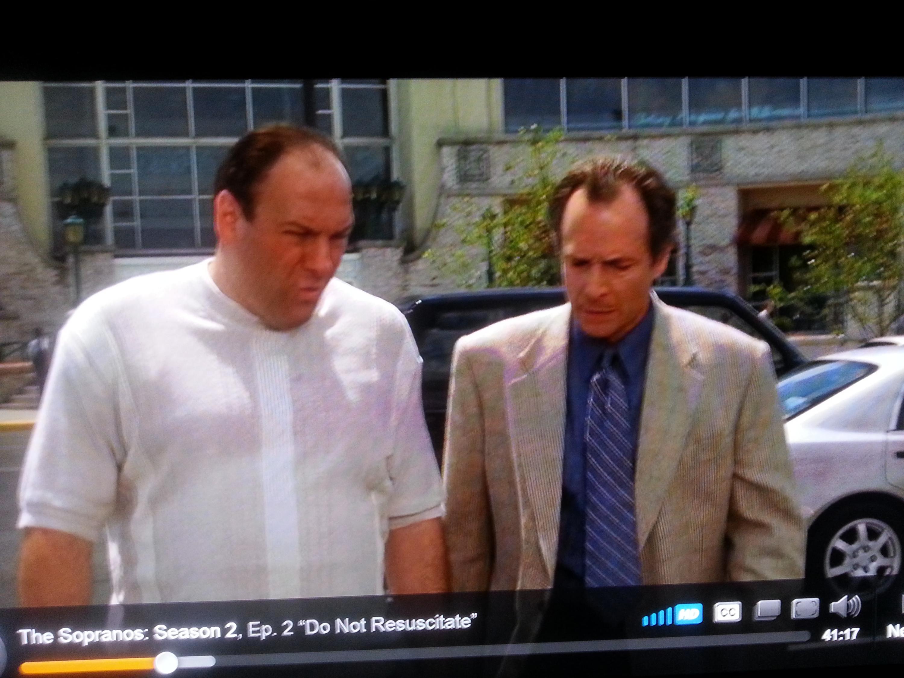

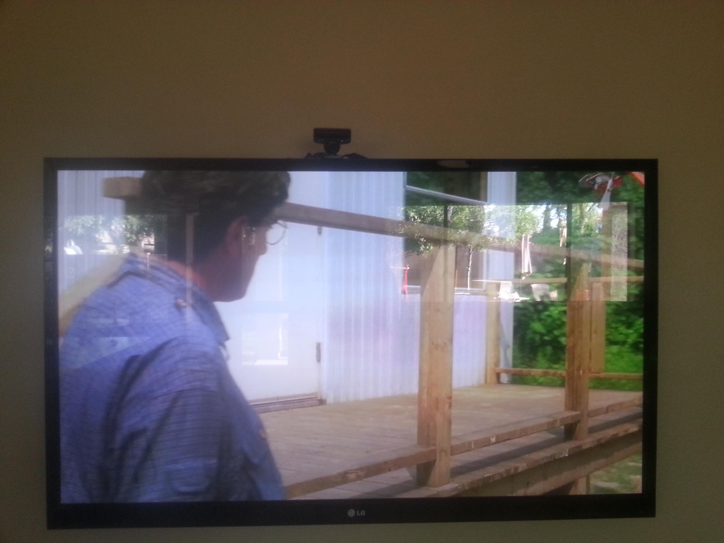

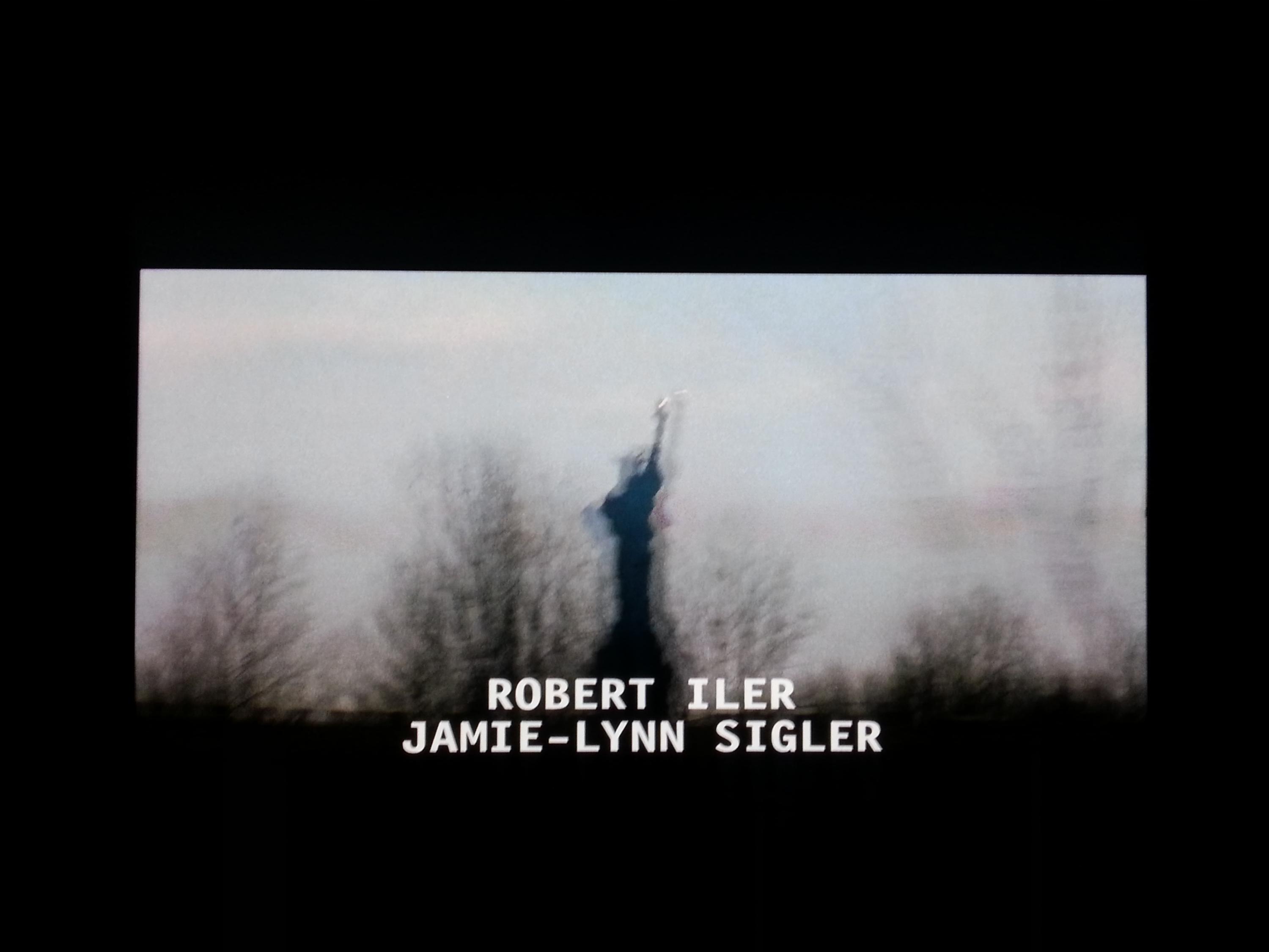

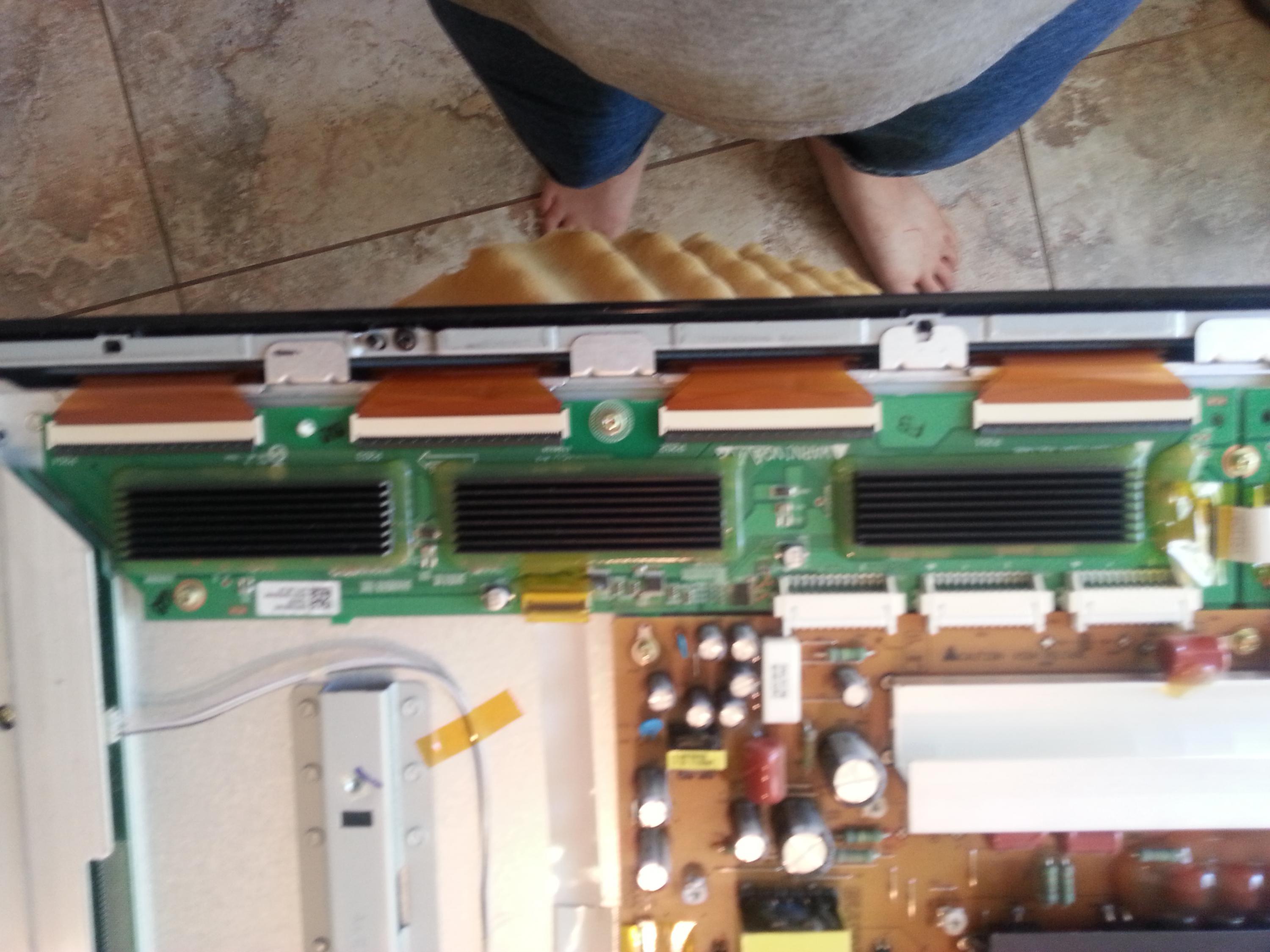

    Hi everyone. Love this forum. SO much information. I tried to look through the troubleshooting guide to figure out the correct procedure to fix my tv. I have an LG 60PZ550 Plasma tv, a few months shy of 3 years old. It does get used a lot. Over the last few weeks it starts to display a pinkish/purple horizontal stripe around the middle of the screen. This seems to be progressively getting worse. It is more evident during light scenes, especially if it is a white background. I also see from time to time posterizing, where faces on people seem particularly bad (although this is not as common).
    I read the guide for troubleshooting common plasma tv problems (THANK YOU to Tom66!). I think the issue is the y-buffer but the picture doesn't match really. I posted some here. Would you conclude this is the right diagnosis? Just want some guidance before I dally behind the tv
    Thanks for any help!
    (pardon the glare on one of the tv pictures)
    Beachguy

    This is a common issue with these models, it is caused by cold solder joints under the Z- and Y-sustain ERC inductors. Relatively simple to fix, you will need a decent soldering iron and solder.

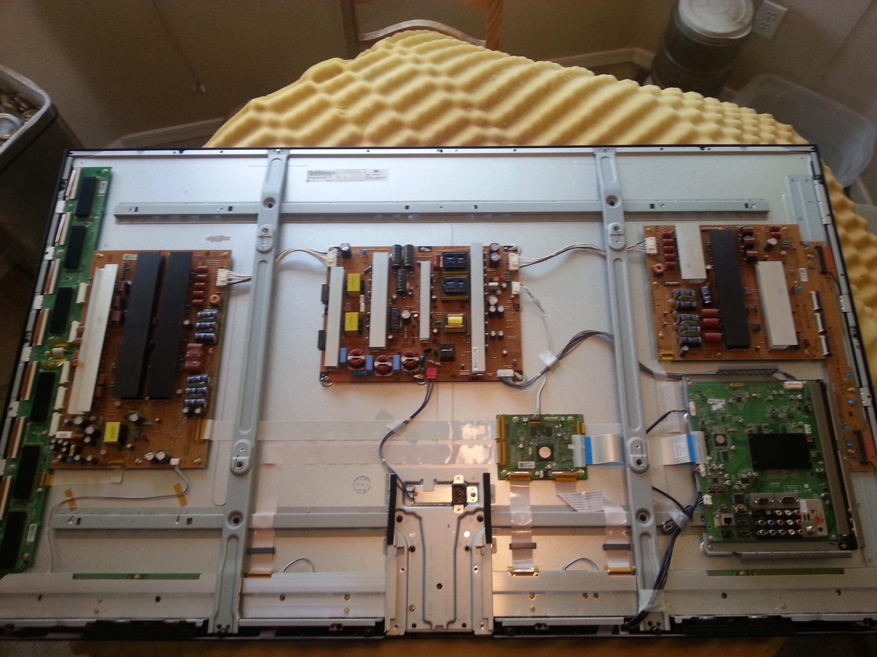

    Post a picture of the TV with the back off.

          Ok, first, Shinju I'd love to find out how to get to the panel hour timer, not sure how to do that. Would be interesting to find out how many hours it took to get to this problem. Shortcut on the remote or combination of button presses? As far as tuning, the tv has always had a great picture, it was only just recently. Good suggestions.

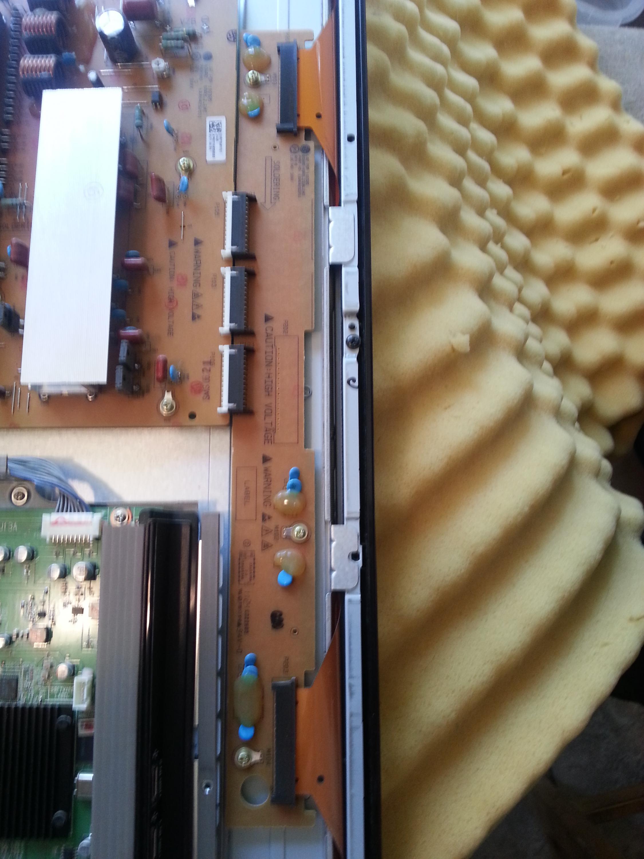

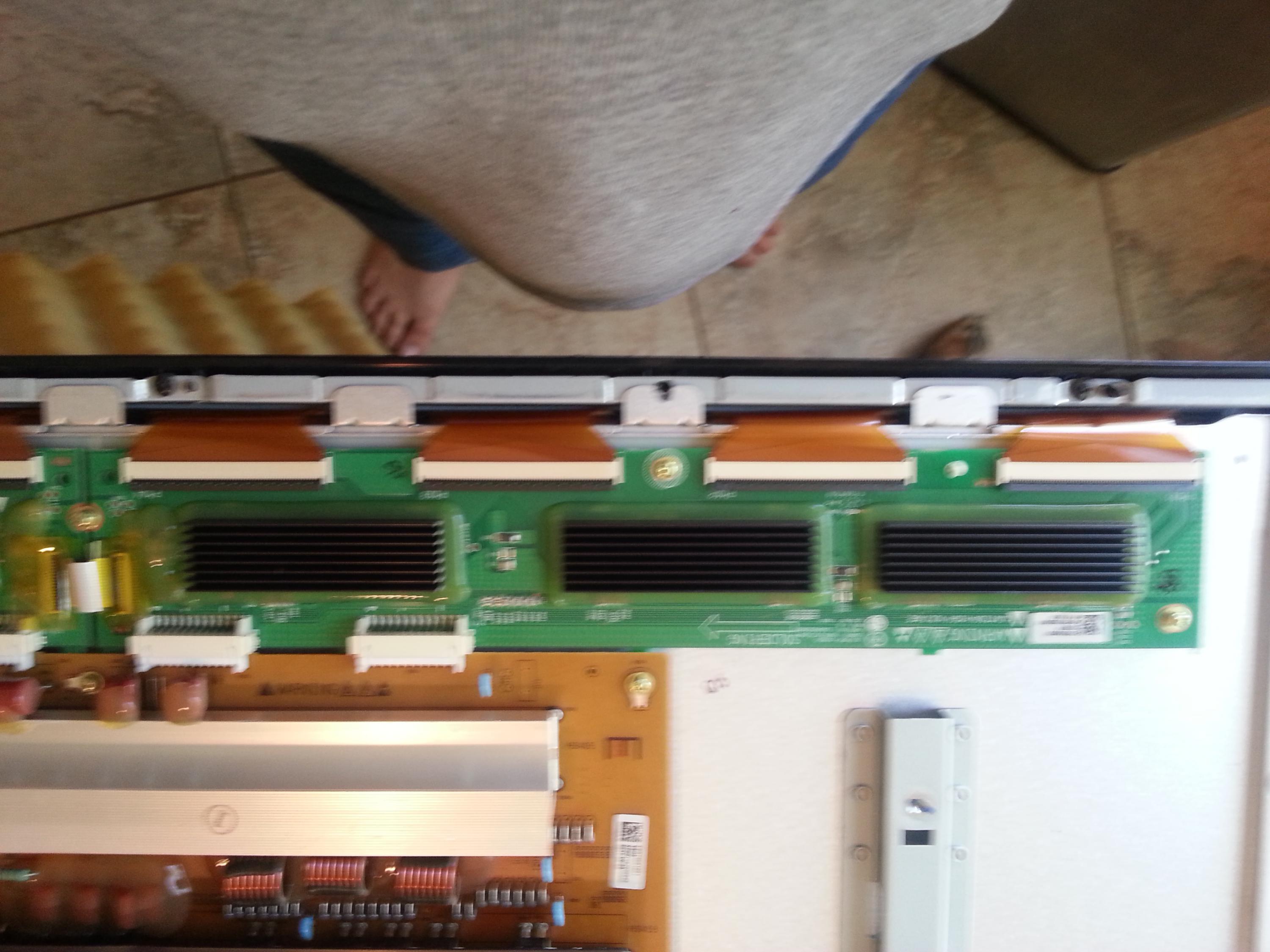

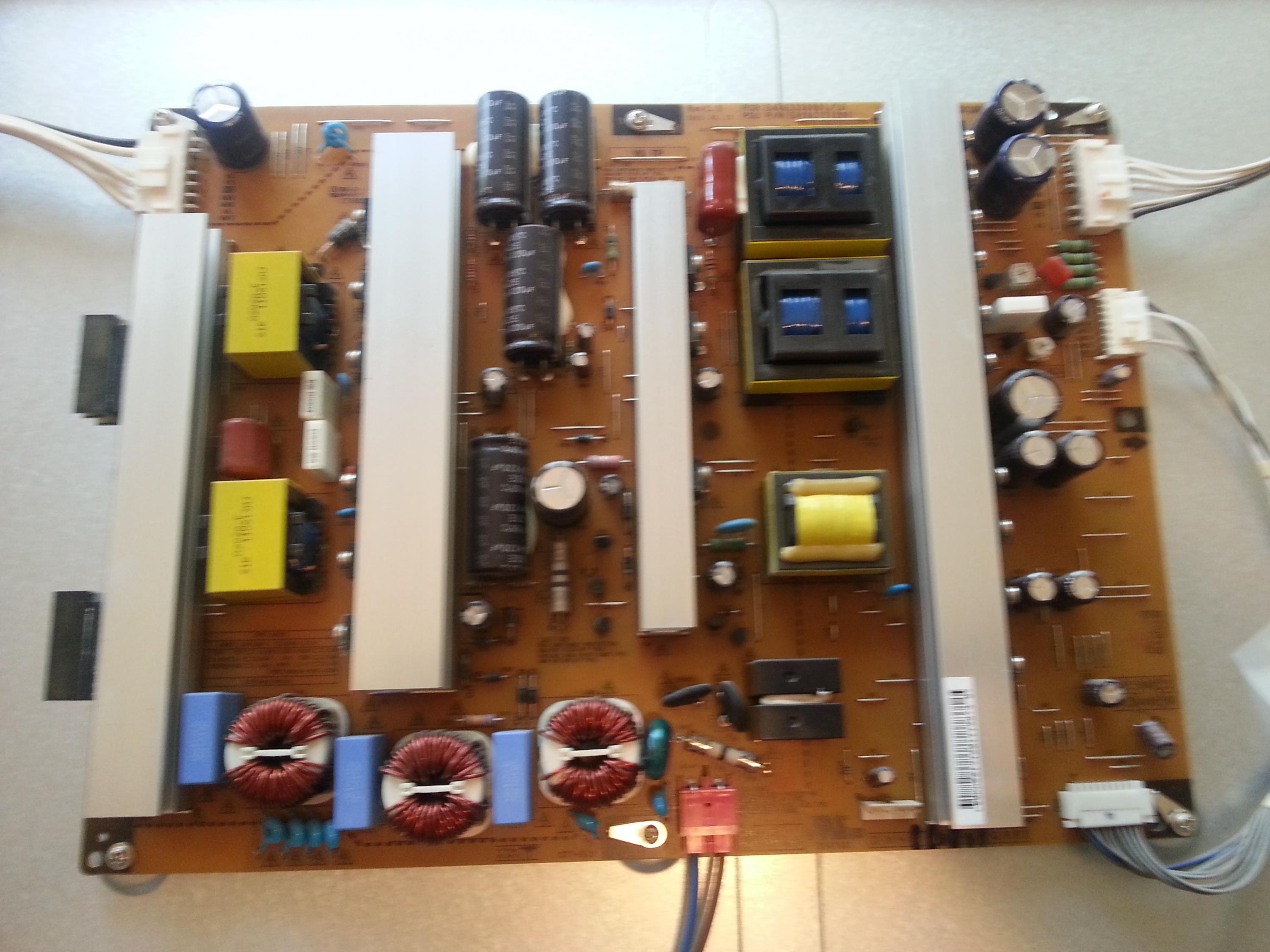

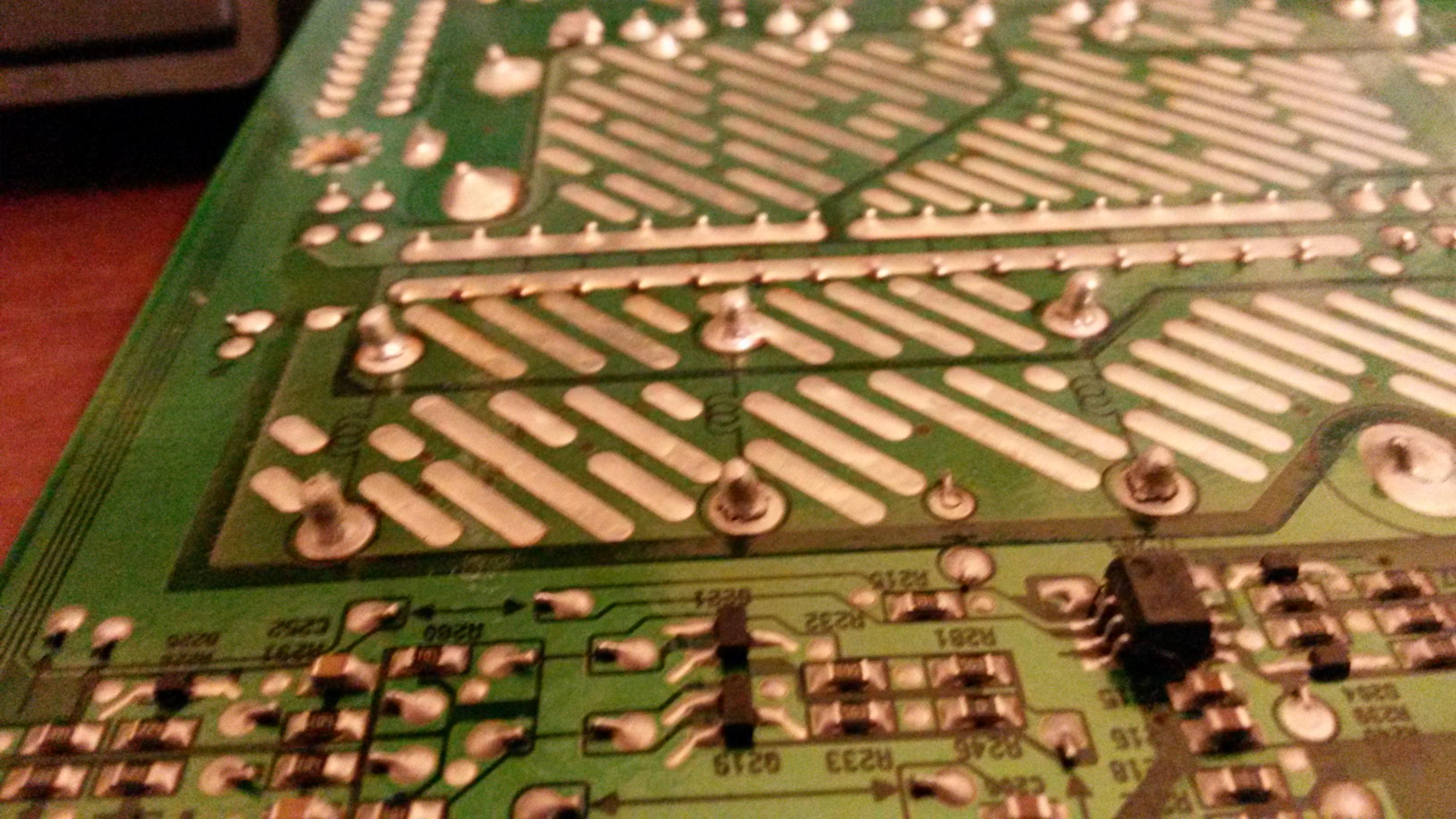

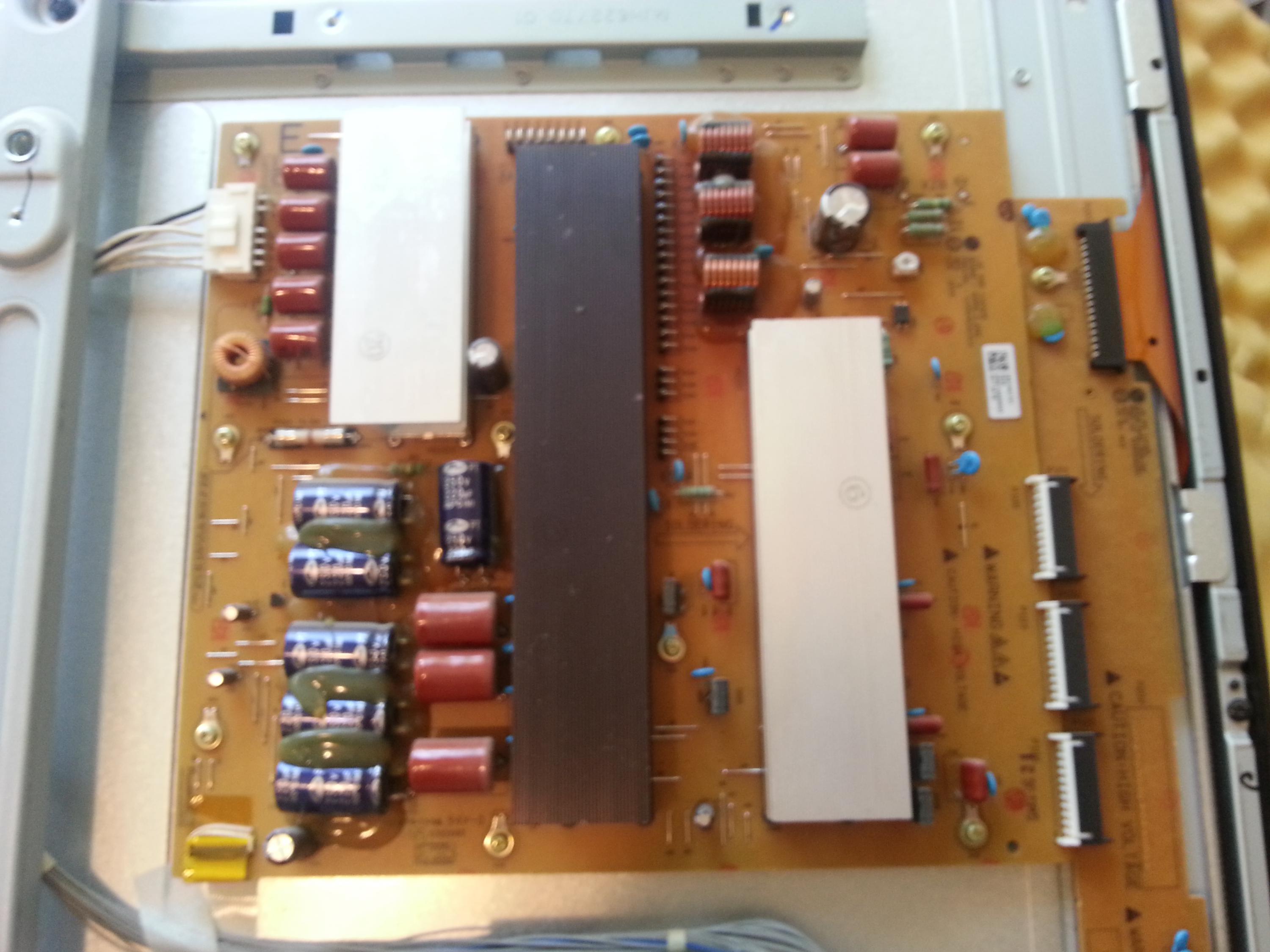

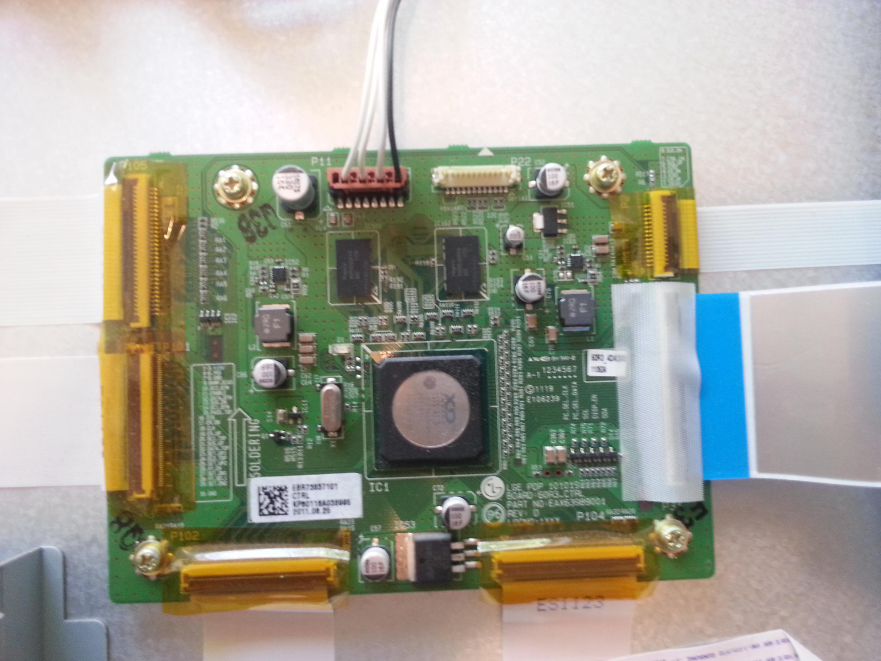

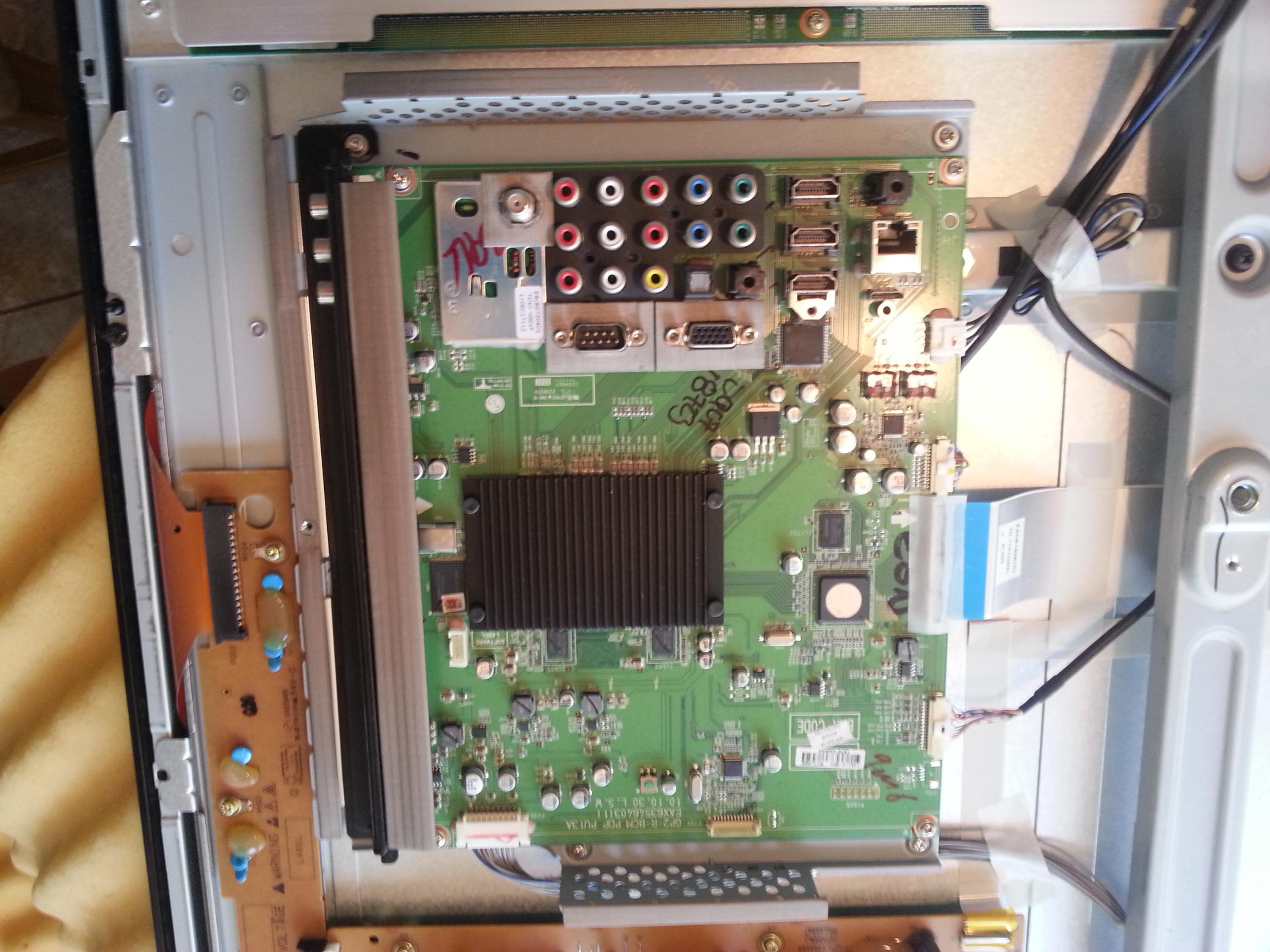

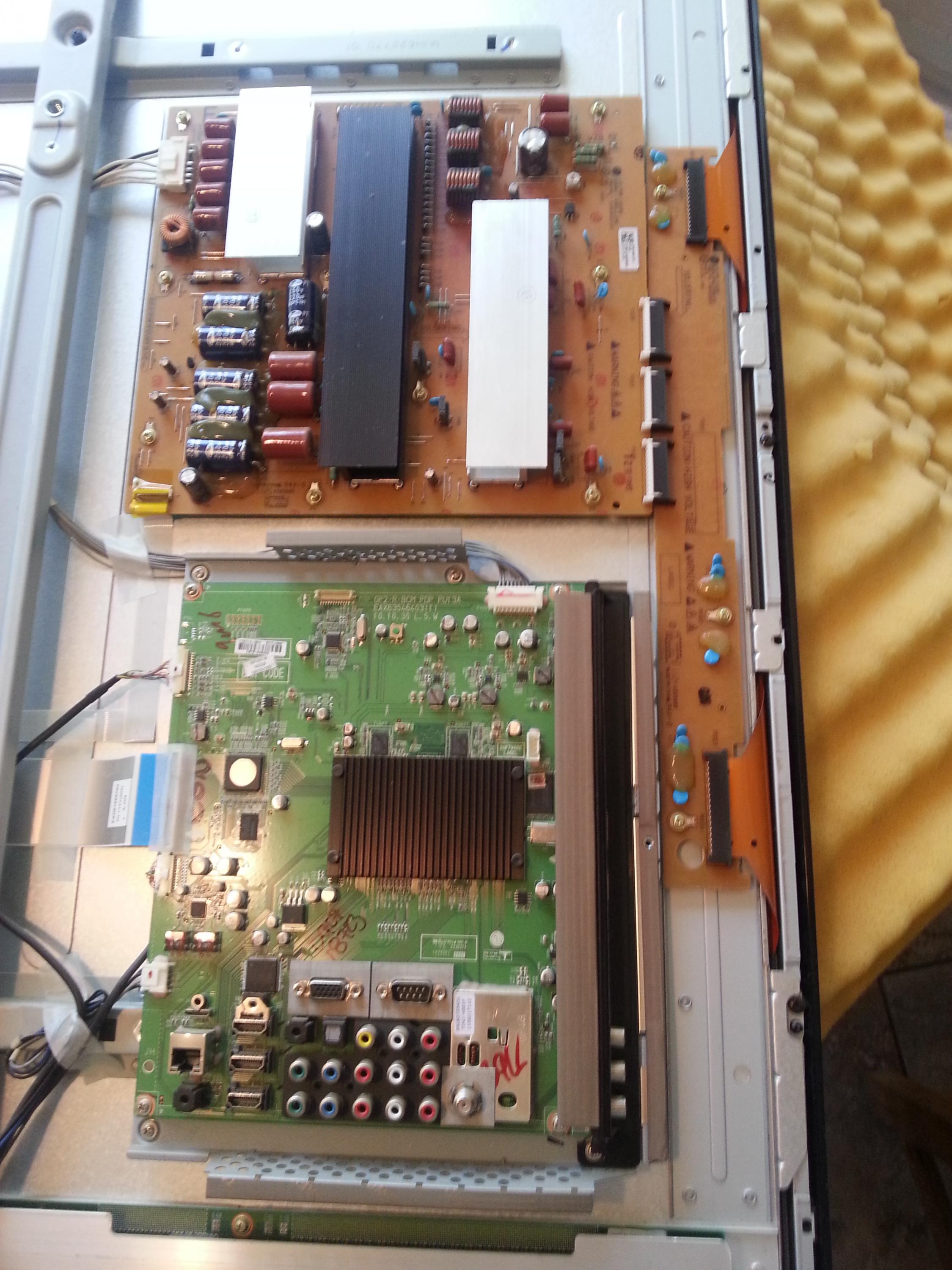

          tom66, I've attached a number of pictures, first the whole rear panel, then closeups of various sections. Thank you again for taking a look. Look forward to your next instructions.

            Re: Purple/Pink Lines / Postering on plasma LG 60PZ550
            This is your Z-sustain board:
            https://www.badcaps.net/forum/attach...6&d=1401401845
            This is your Y-sustain board:
            https://www.badcaps.net/forum/attach...2&d=1401401774
            (the green boards attached are the buffer boards)
            Near the middle top of the Z-sustain you can see a few coil packs (technically called inductors) and that the board has discoloured significantly underneath them due to the heat produced. You can also see the same coil packs between the black and silver heatsinks on the Y-sustain board.
            You will need to remove both boards from the set and reflow the solder around both of these coil banks.
            Use leaded solder, for improved reliability.

                Just a followup. I followed the directions from tom66 closely. It worked beautifully! I couldn't be more pleased, my picture is back to looking crystal clear, no purple streaks or posterizing. Thank you so much tom66. I'm sure I saved a bunch of money. I'd love to send you a few bucks for a pint (or coffee if you'd prefer), let me know if you have a paypal account so I can send something for my appreciation. Thanks again!!!
