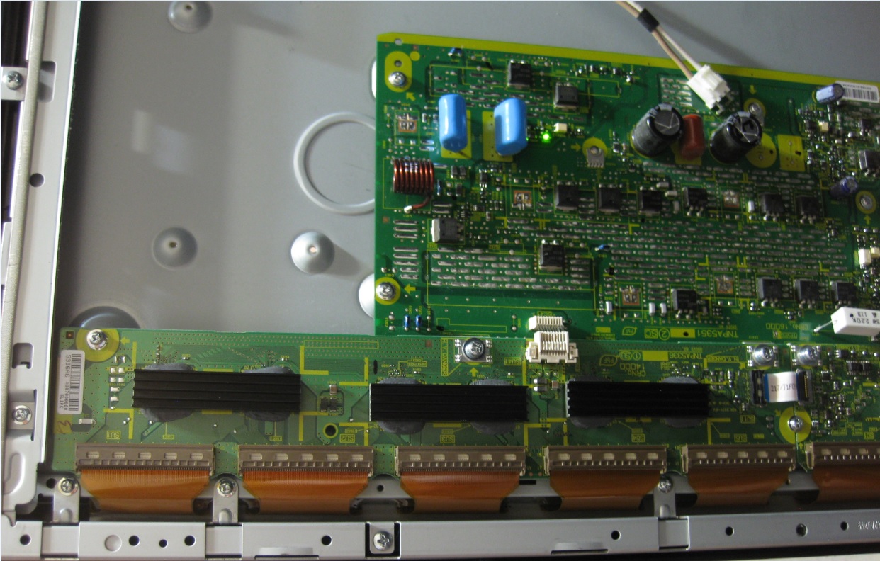

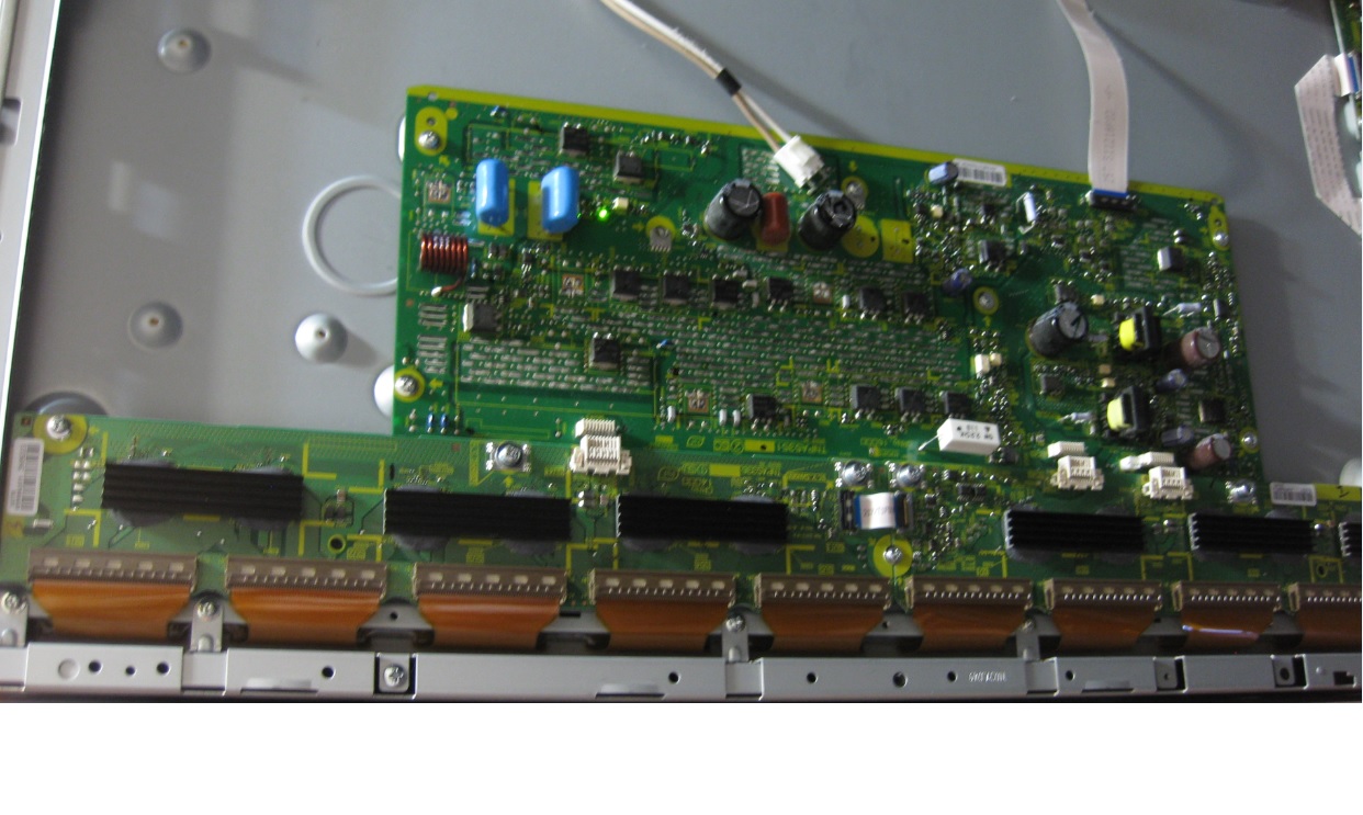

    Panasonic Plasma TC-P50S30 7 blinks, open cover and took an eye inspection on the SC, SU/SD boards, no obvious damaged components were found.
    Checked SC board had voltage while turn on, but disappeared as the tv shut itself off.
    So what I did was:
    1. Isolated the SC board from the two buffers (SU/SD) by disconnecting.
    2. Shorted the SC50 (I used an old IDE hard drive jumper).
    3. Plug power cord and Turned on the TV, it powered up constantly, no blinks any more, TV response to the remote control.
    4. Unplug the power cord from the wall, wait for 5 minutes.
    5. Connected the SC board with the SU/SD board again, TV still turned off and gave 7 blinks.

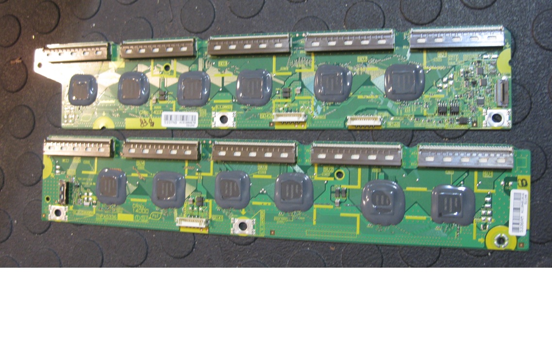

    From this point, I suspected the buffer boards failed, this is a common issue for this model, most likely is the upper board problem, I think the culprit
    was that there are no heat sinks for the ICs on the boards. I checked the price on ebay, the upper buffer board was quite expensive.
    The two buffer board part numbers are TNPA5336AB/TNPA5337AB. I happed have a pair of TNPA5336AG/TNPA5337AG from Panasonic TC-P50GT30, which is a 3D plasma TV.
    Since the part numbers are the same only the suffix are different, I thought they should work.
    So I replaced the TNPA5336AB/TNPA5337AB with TNPA5336AG/TNPA5337AG, turn on, TV lite up ! Everything works !
    Please note I replaced as a pair. TNPA5336AG/TNPA5337AG boards have heat sinks on top of ICs, so I'm sure the these two boards are more reliable than the old pair.
    (The fourth photo was the original boards).

    Re: Panasonic Plasma TC-P50S30 7 blinks fixed by replacing with differnet model SU/SD
    Yes, if you do enough digging , it's fairly common to find a heatsinked/non-heatsinked buffer boards that are electrically the same.
    I know with the 2010 series , for example a V20 and a VT20 (3D) buffer set are not the same on the SD but the SU are the same.
    You can certainly increase your luck doing the research and sometimes works out cheaper.

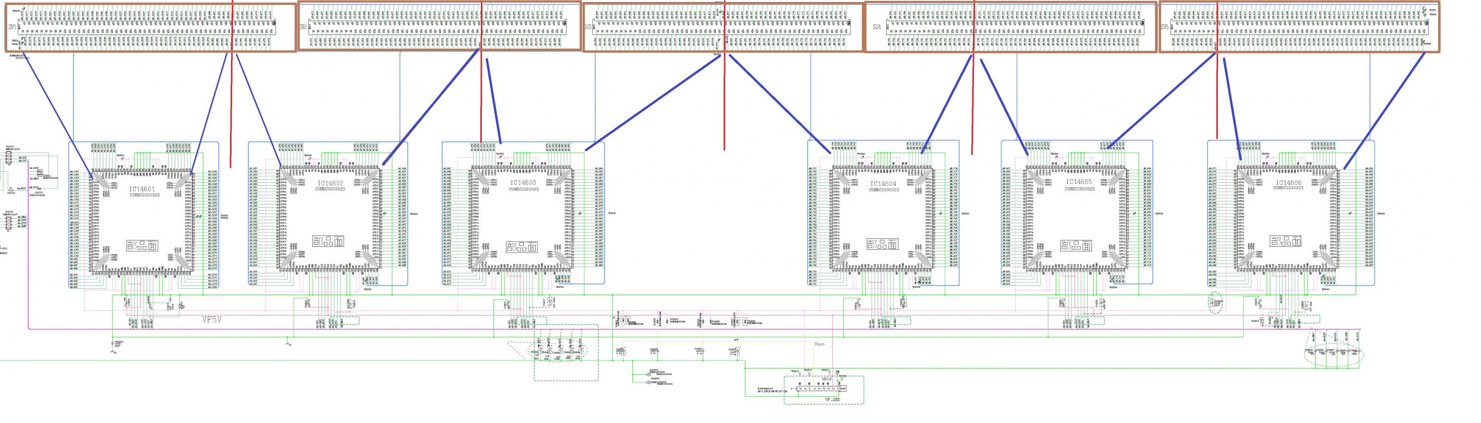

                    I have the same fault, same board, 5336AM.
                    The chips are the R2A20250. Is there a way to find out which one is faulty?

                      Should get a rough idea from simply determining which of the output pins are short with respect to gnd(vfg). then you should be able to guess which chip feeds that pin.
                      I've broken this diagram for you into the sectors and boxed in brown what are the panel connectors so you should have a good visual reference now.
                      I've got 2 5336 buffers shorted with only 1 chip, and

                          Thanks again. Exactly as you said. I had one defective chip, swapped it, everything works great.
