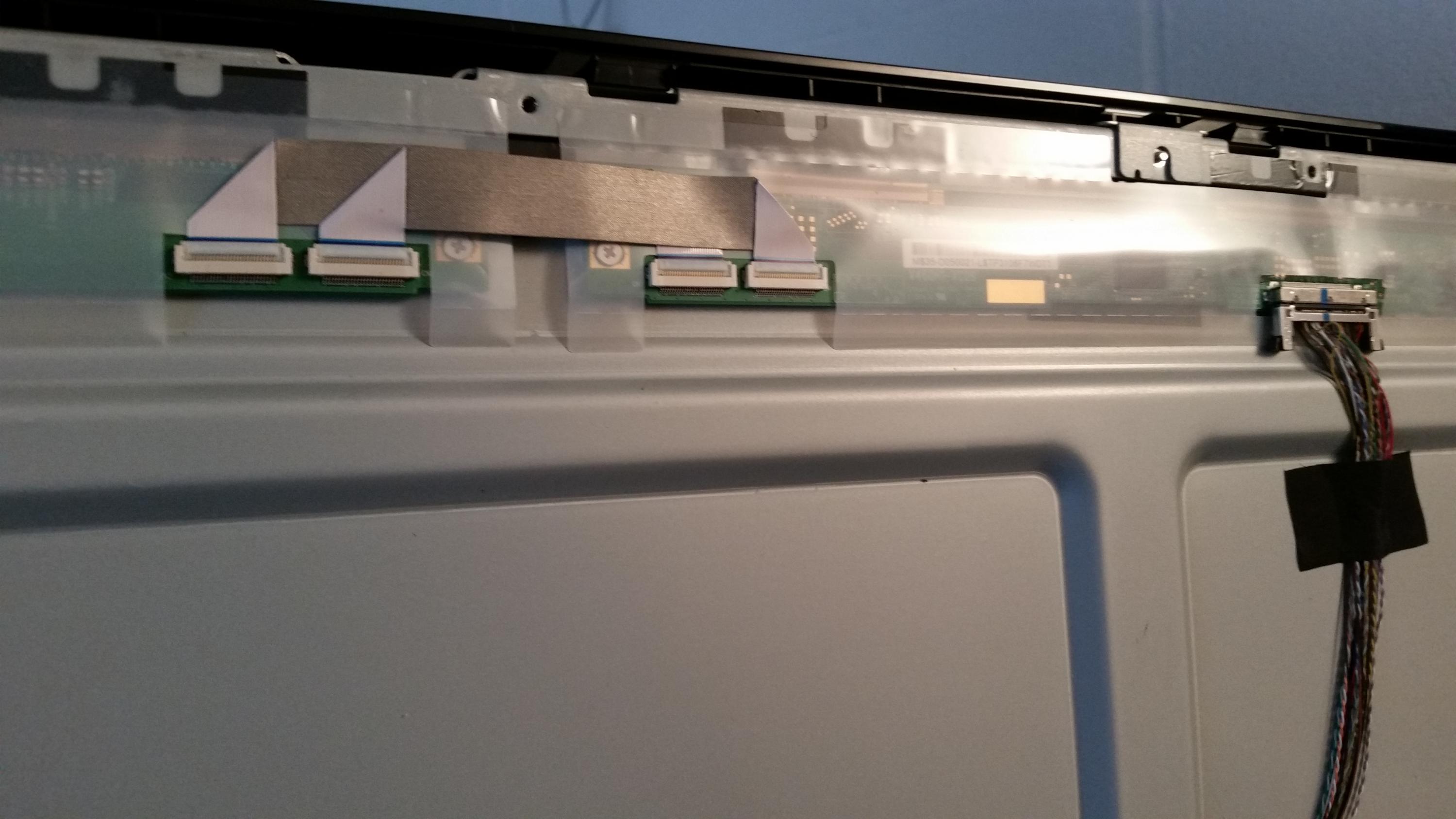

    I have picked up today this TV and I thought, that it will be most likely an EEPROM issue, because I have found some EEPROMs for sale.
    To my surprise, this TV is the same as the famous 4665 model, with the same exact issue.
    The only difference is, that at the LED strip, they have changed the connectors.
    It doesn't have, that small tab like connector anymore, they have a push in type connector, much better.
    I have figured out, another way of cleaning the ribbon cable, by using a metal brush with the Dremel at a low RPM.
    http://static.hardwarestore.com/medi...2_front500.jpg

    Which ribbon connector are you referring to? I just started a new thread for this set. I tried to search for the model number but came up empty. I am stumped on this one.
      Re: Westinghouse LD-4680 repair
      The one on the LED strip. It doesn't have the little clip, holding the ribbon anymore.
      It's a push in only connector.
        Which of these on the picture are you referring to?
          Inside the panel, where are the LEDs, on an aluminum strip.
            Ok
            Thanks.
              If you remove those two ribbons from the mainboard, the TV should turn on(have LED at the front on).
              Then try one by one, to see which side is causing the problem.
