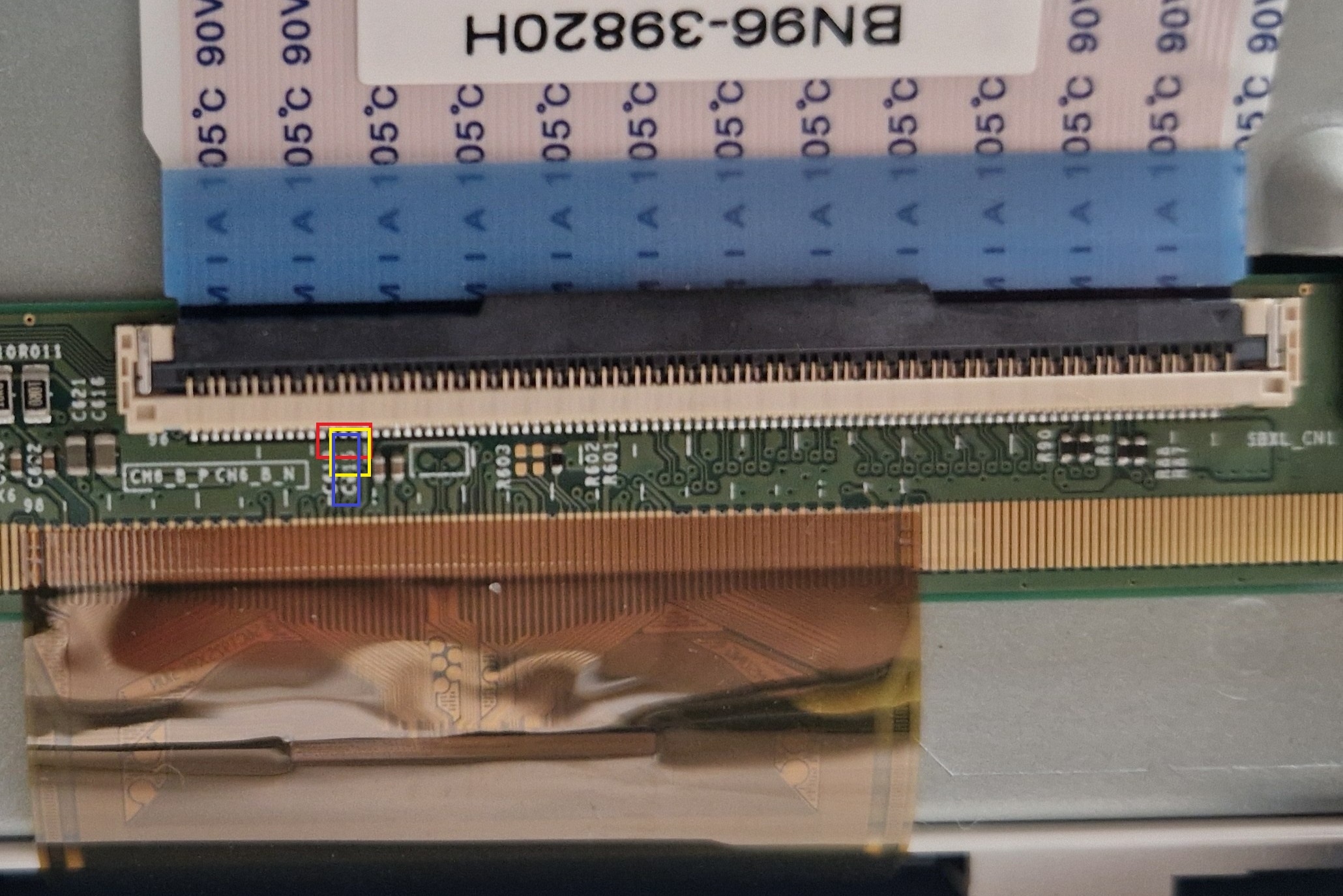

    These 2 legs will not rise, the case of the transistor will crack, the tracks on the board will break, then only use a hairdryer to completely remove it.

          ohh my GOD... i can notice from yours test video, you have stable hand... but why so,,, to lift pins first need at soldering fat pasta on the pins... then add little solder.. then use shield to suck the solder it will be easy to remove..damage it can be replaced
          read the label of the MOSFET first in case you
          if this was the one we trouble shooting it then you have short inside the panel glass.. no way

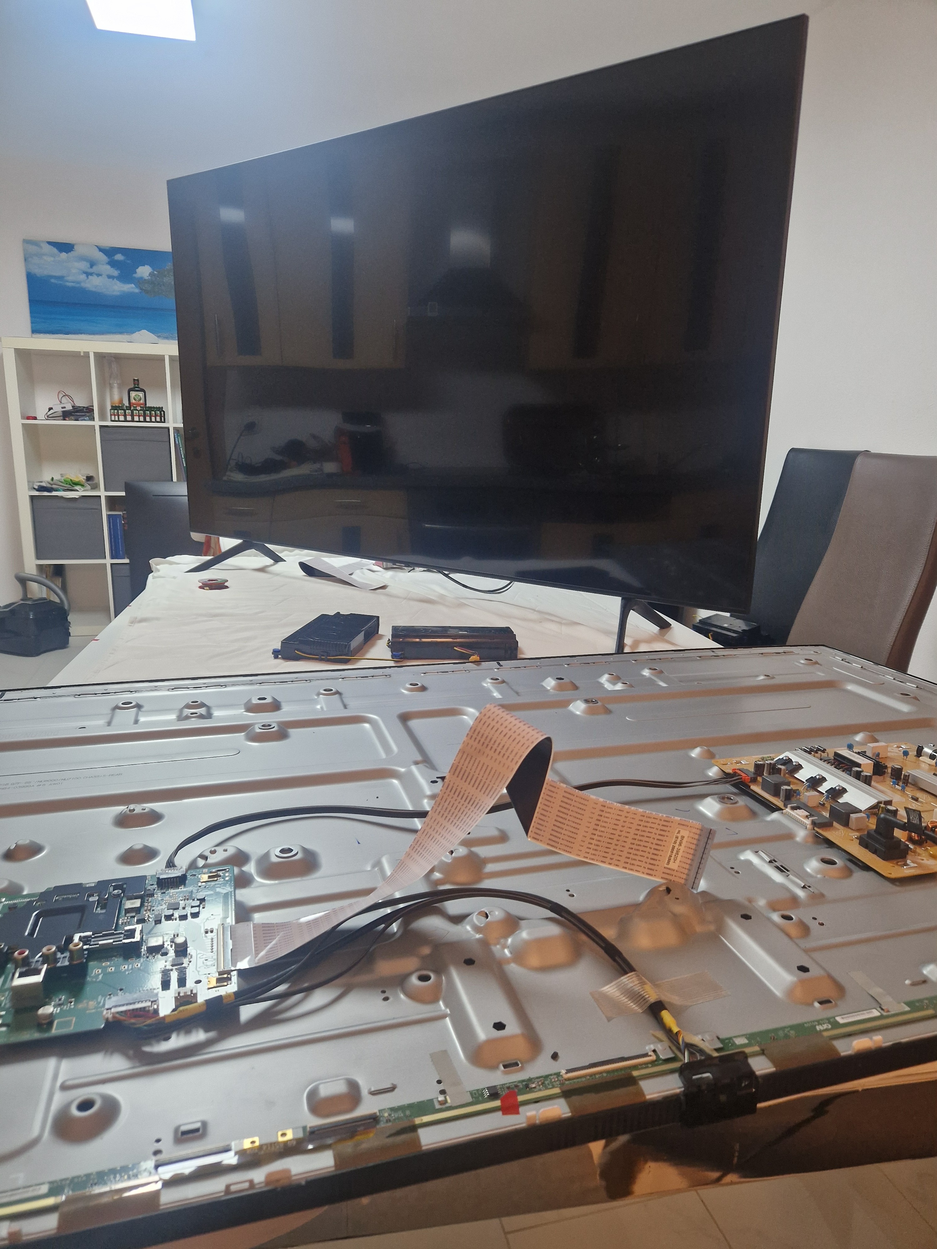

              nooo... this was not the one with trouble shooting of course... the videos i made with the one which panel is not damaged! i got one with broken panel, in order to check if the reason is the mainboard...
              the "good" tv is standing, and from that i took the measures. the bad one, with broken panel and now broken transistor is laying... so no damage caused (yet)

                  the broken screen tv... even u remove Q totally will remain in bootloop because its broken and sure there are shorts at some where on glass

                          don't move the Q., however i don't like to write over this forum any kind of masking.... as its not repair... but it could satisfied you some how.
                          try to mask exactly this pins start with Red mark... then yellow then blue tell the result.... all U ribbon cable should be in place

                            i got a headache... it s such a sysiphus work... i didnt manage, nothing has changed. keeps going off and on. on one sec... off two seconds... than on sec... and so on... it s frustrating

                              scrap it what did you waiting for when panel shorted !!
