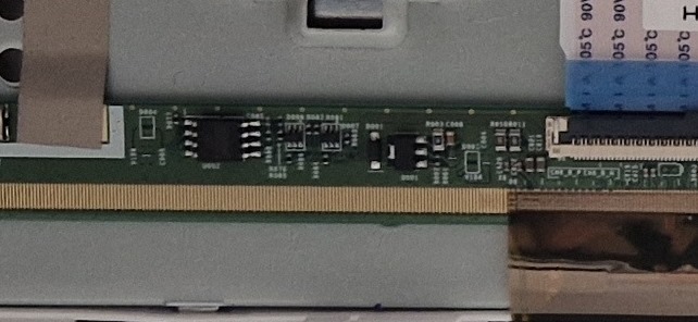

              post very clear close and focused photo on this area

              • marillo
                • Sep 2024
                • 21
                thats the left side Click image for larger version

                • marillo
                  • Sep 2024
                  • 21
                  the middle panel board Click image for larger version

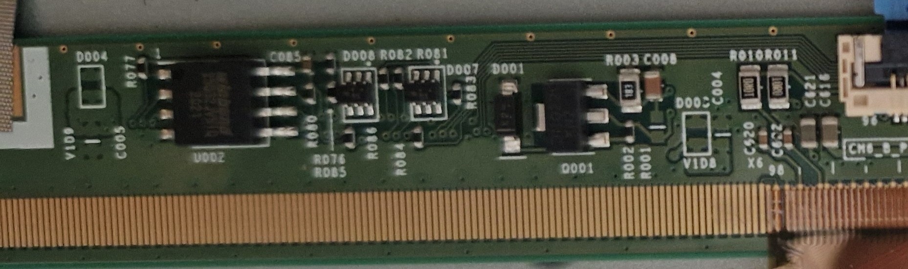

                    • Diah
                      • Feb 2013
                      • 6424
                      Man, not all,,, just one are now important this part... still i cant read the label of the parts, focus it with light. ( ich brauche nur diese Teile um Ihre Label zulassen )
                      • marillo
                        • Sep 2024
                        • 21
                        ah here we go... sorry i thought you need all
                        • marillo
                          • Sep 2024
                          • 21
                          here a better quality one

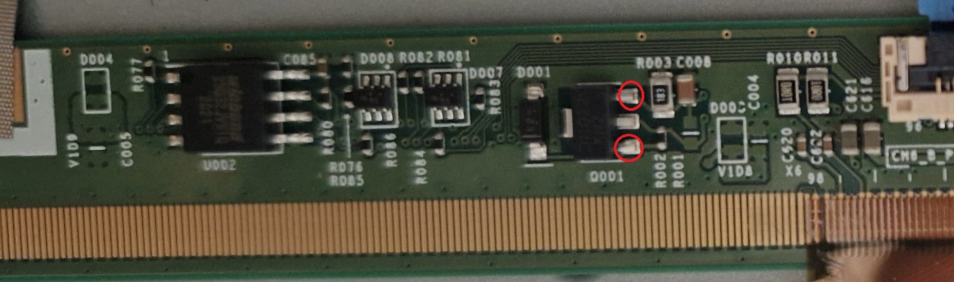

                          • Diah
                            • Feb 2013
                            • 6424
                            okay, now you disconnect the LVDS , and keep the U ribbon at this time all disconnected
                            first test with yours DM in Diode mode the MOSFET Q001, between the middle and A G
                            with OHM test C 621
                            with diode mode test D007 D008 ( between the three 123 against 456 and in reserve way

                                  • Diah
                                    • Feb 2013
                                    • 6424
                                    lift the 2 LEGS carefully from the board , put all cable back in place and turn on see if there are no boot loop, if no more reboot test in diode mode the Q again and compare to yours first reading

                                    • marillo
                                      • Sep 2024
                                      • 21
                                      you mean with a soldering device to remove the two legs?
                                      • Diah
                                        • Feb 2013
                                        • 6424
                                        lol no with finger nail...lol.... of course u need soldering
