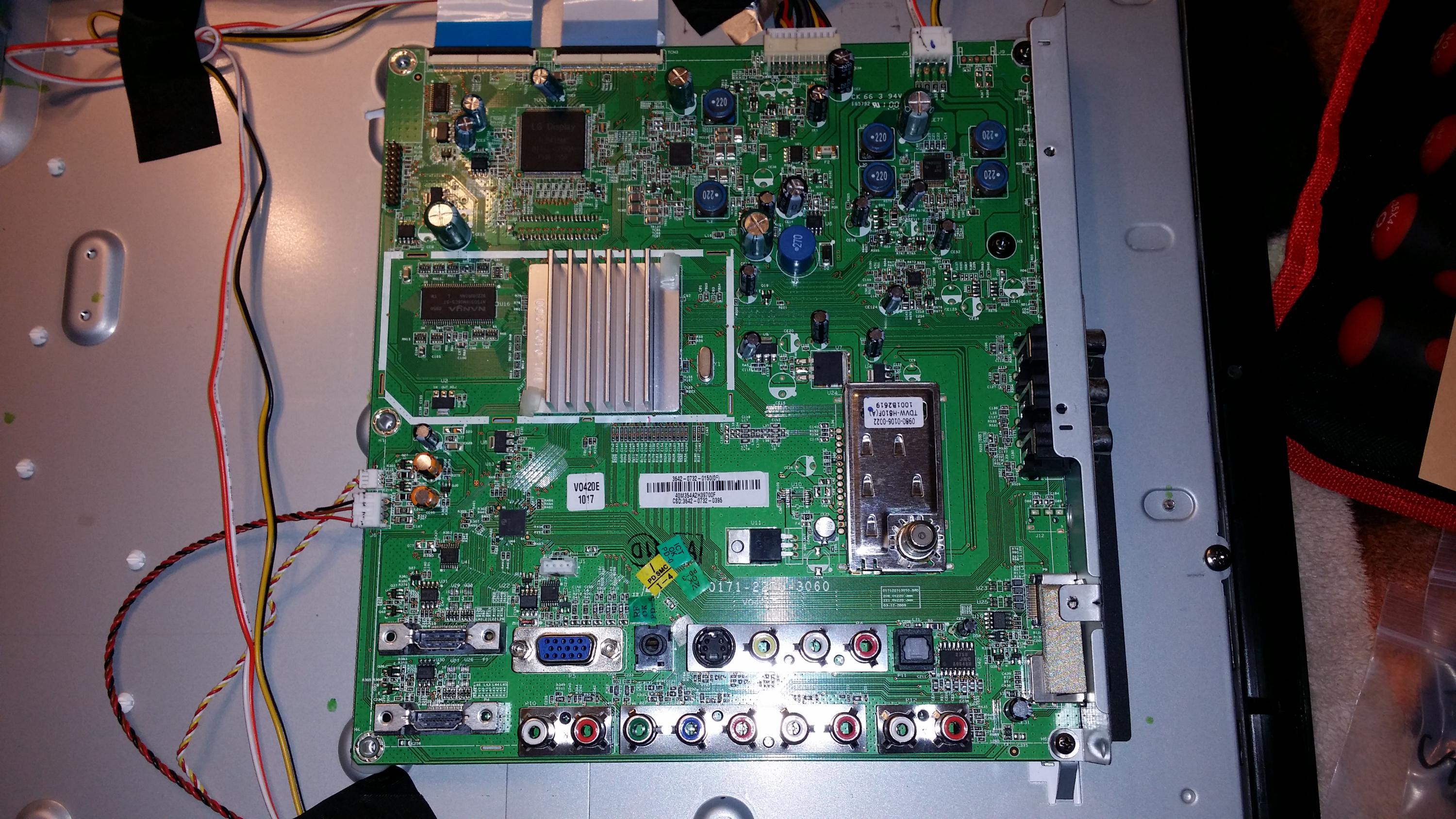

    Picked up a broken Vizio VO420E dirt cheap as I have the exact same model working now...figured worst case I have some spare parts, best case I have another TV which I also needed. Now the problem:
    Mainboard #0171-2271-3060
    Powersupply #0500-0407-0750
    Tv Turns on...Back-light lights up...nothing displaying on the screen whatsoever. Sound from HDMI works, yet there is no picture. It seems everything works, except displaying an image. The screen is just pitch black. Remote Works, Volume Buttons Work, Input button works (took a million presses to figure out where I was at)
    Power / Inverter board *was just replaced* by the previous owner as he thought it was a back-light problem...but had same problem with the new board. (Did not get an extra power supply to prove it, but someone was definitely inside the back of the TV).
    I took it apart and did some quick voltage checks @ the power supply. I have 5v, 12v. (don't remember the exact voltages, but I know they were less than .5v over, but none under. The 12v is taken while turning on. Doesn't fluctuate at all it seems. I visually checked the caps...none are bulging, burnt, or leaking. Checked the 2 fuses on mainbaord (F1,F2) and both are passing voltage (12v and 5v). I really have no idea where to go. Any insight would be greatly appreciative. I have been searching for hours, and can not find much that can help with my exact model.

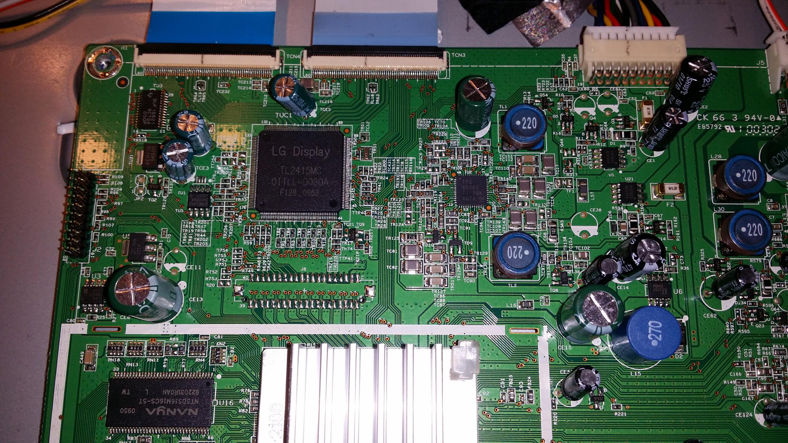

            OK, do you have some insight into where that would be located? Because I was assuming it was integrated into my mainboard as I only have a Power supply, and a Mainboard in the back of there. Power goes into Mainboard...2 ribbons come from the Mainboard and connect to the Driver Boards on the top of the LCD. I am sorry if I am not noticing something here, but I can seem to see where this would be? I guess I assumed that the top section of my mainbaord was an integrated T-Con as it has most its components prefixed by TC. (Pic in 1st post) I will tear it apart again in the morning and see what I am missing. I just looked at the service manual and don't see it listed...Do I have the one VO420 without an external T-Con Board?

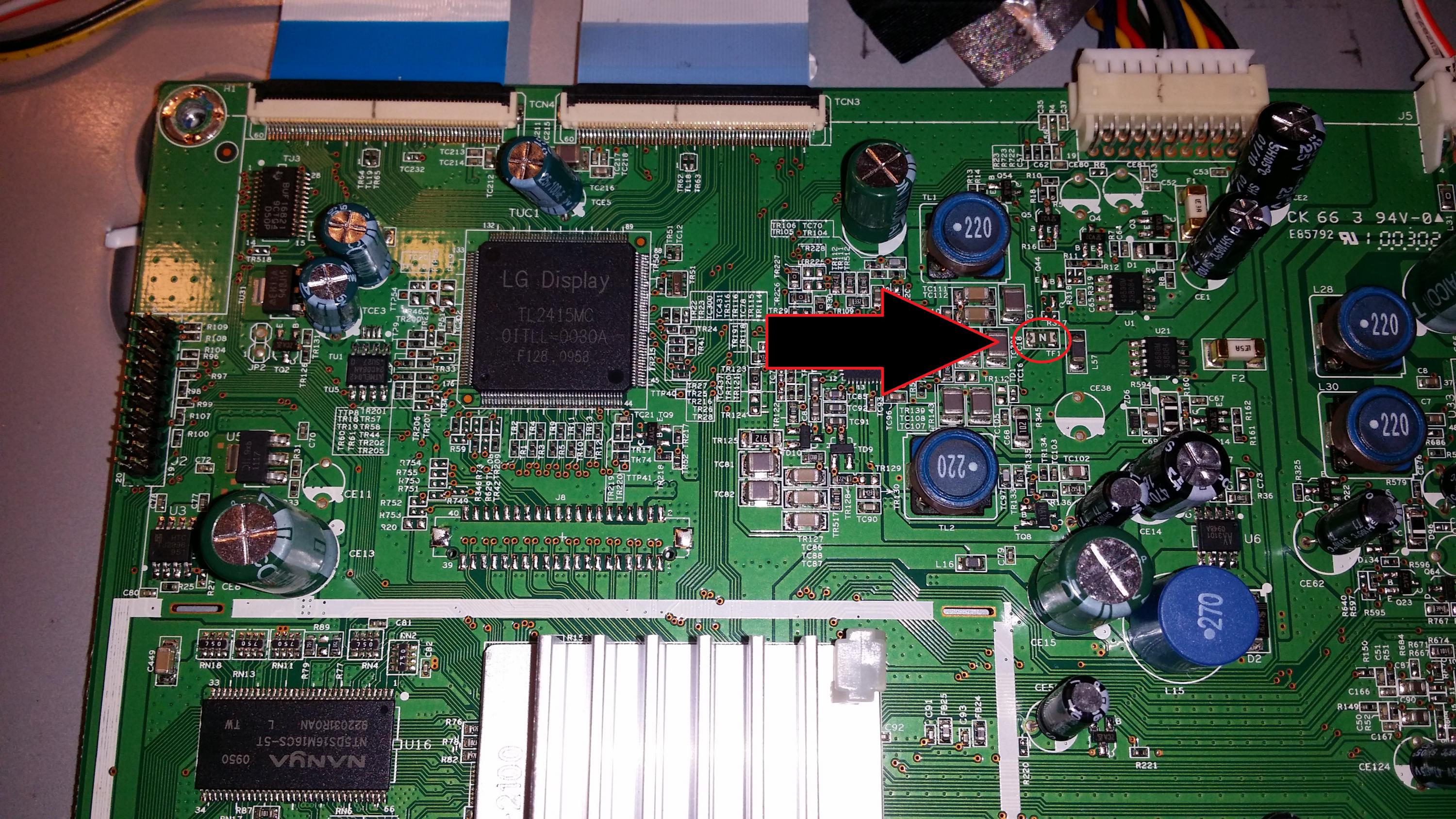

              I did some searching of pictures...and see a fuse I did not check..Labeled TF and circled in the pic. I think this is the equivalent of the one on the actual T-Con Board...Do you? I will give it a test tomorrow. Or maybe I am blind and there is an external T-Con board in here somewhere that I cant see. Either way Input still accepted and I will post back update tomorrow morning.
                Re: Vizio VO420E - No Video But Has Backlight,Sound.
                "Do I have the one VO420 without an external T-Con Board?" It looks like it after I did more search on your model. Your version does not use the AUOPTO LCD panel.

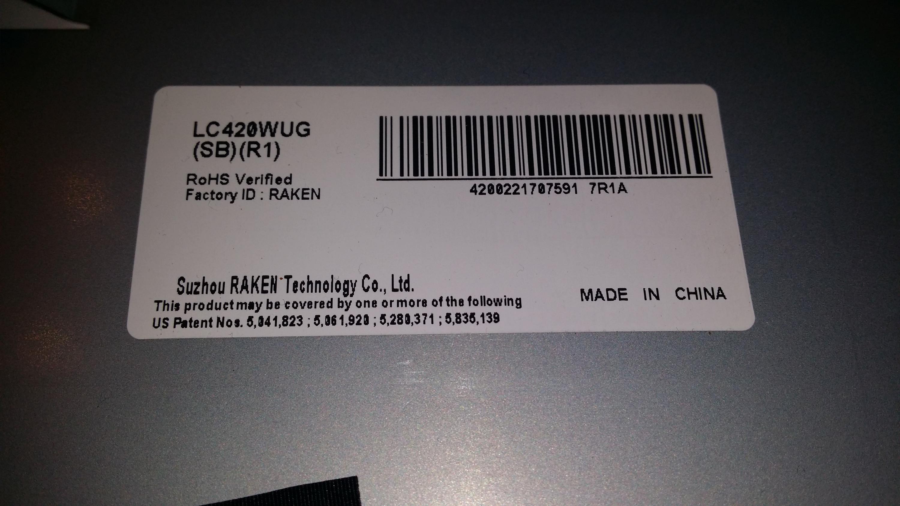

                Can you see the label for this LCD panel you have? We can try locating the spec sheet for this panel.
                Yes, that is another SMD fuse.
                The empty J8 on the board looks like an option for installing the LVDS connector for the external T-CON board version.

                    LCD is LC420WUG (SB) (R1) (Pic Attached)
