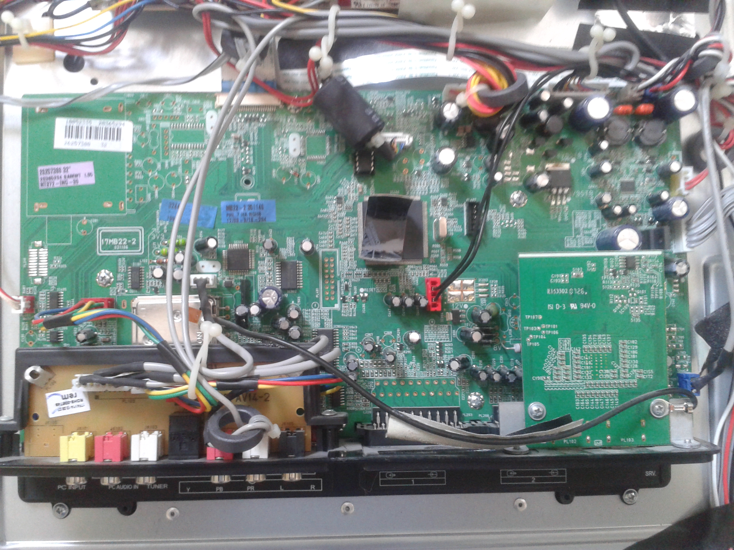

    Hello, I hope that one of you talented and knowledgeable guys or girls could help me.
    My telly screen suddenly went blank last night. The video source and HDMI inputs can still be selected as I can still hear the audio from each input and the LCD backlight is working. I cannot get any picture or screen prompts/graphics.
    I have trawled through the other two Finlux 32FLD760P threads in this forum and can confirm that all power supply rails are at their correct voltages and are stable. I've checked all connectors are secure and have done a search on all PWBs for any cold or dry joints.
    Any help or suggestions would be greatly appreciated.

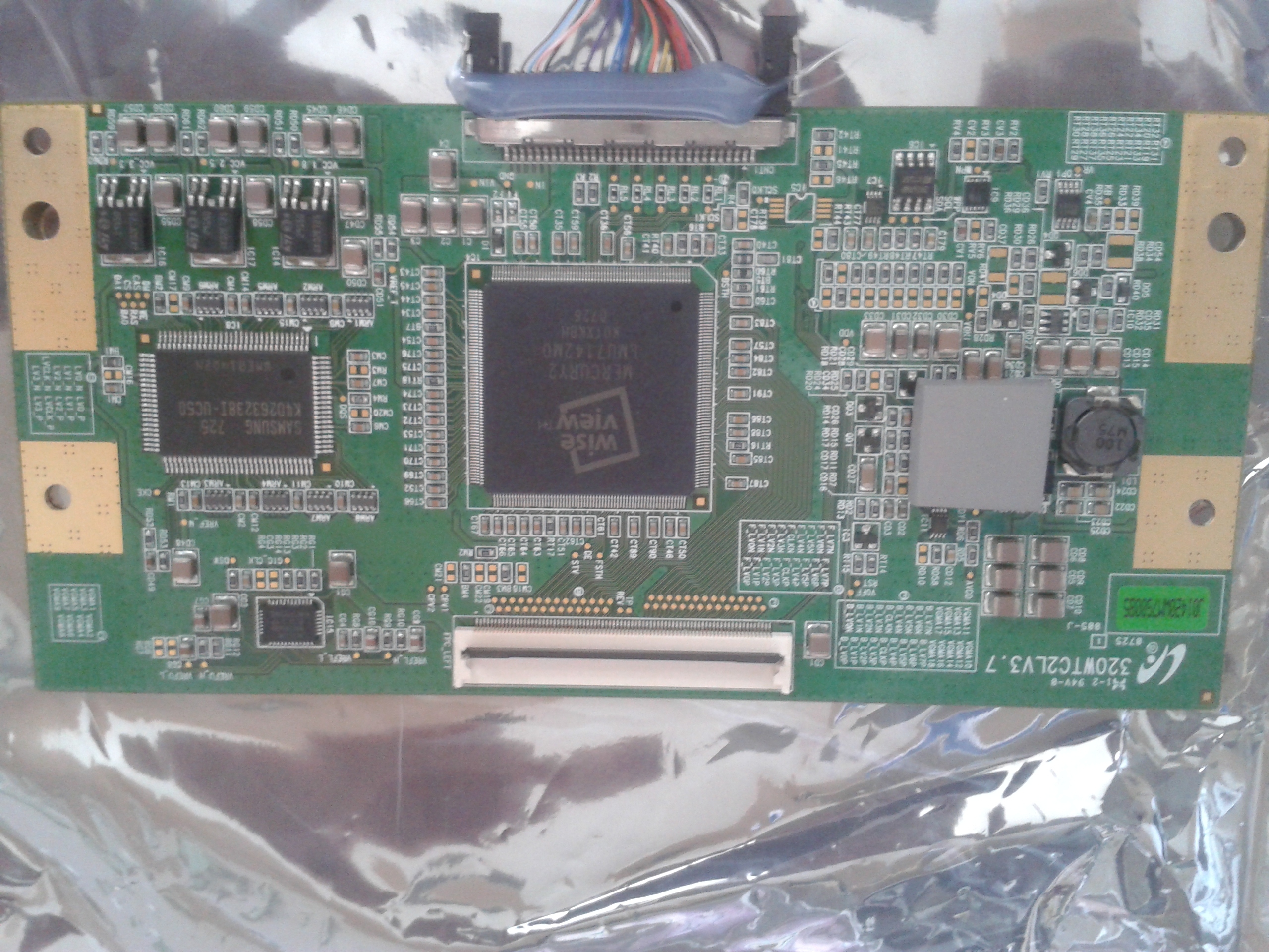

    my guess is the fuse on the t con board can u supply pictures of the boards in your set? some/most times the t con is under a metal cover.

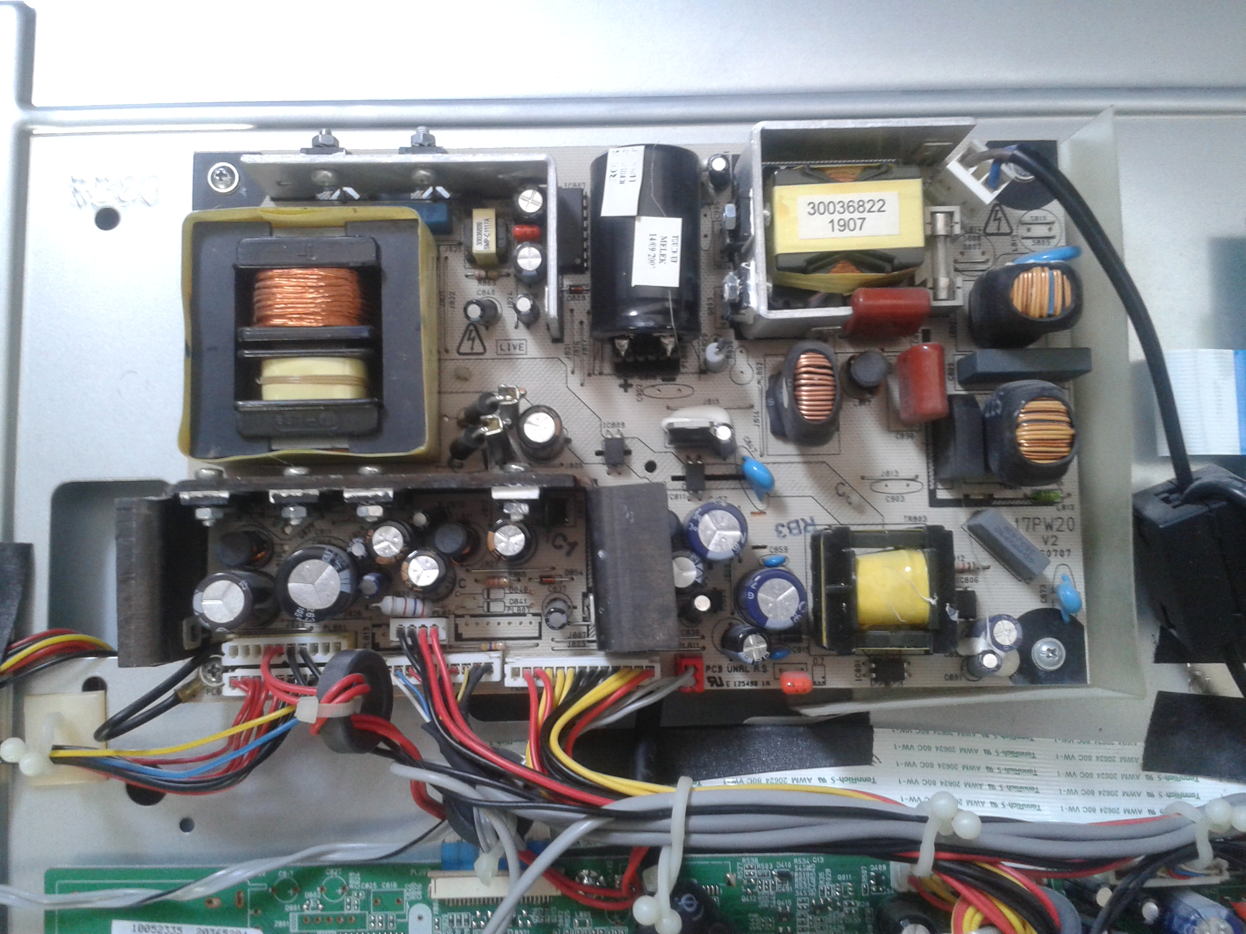

        Re: Finlux 32FLD760P Sound and backlighting but no picture
        Hi again. Please see the module pictures below.
        I assume the fuses on the T - Con board are F1 and F2 SMDs. I believe F1 is open circuit. Do you know the part number or rating?

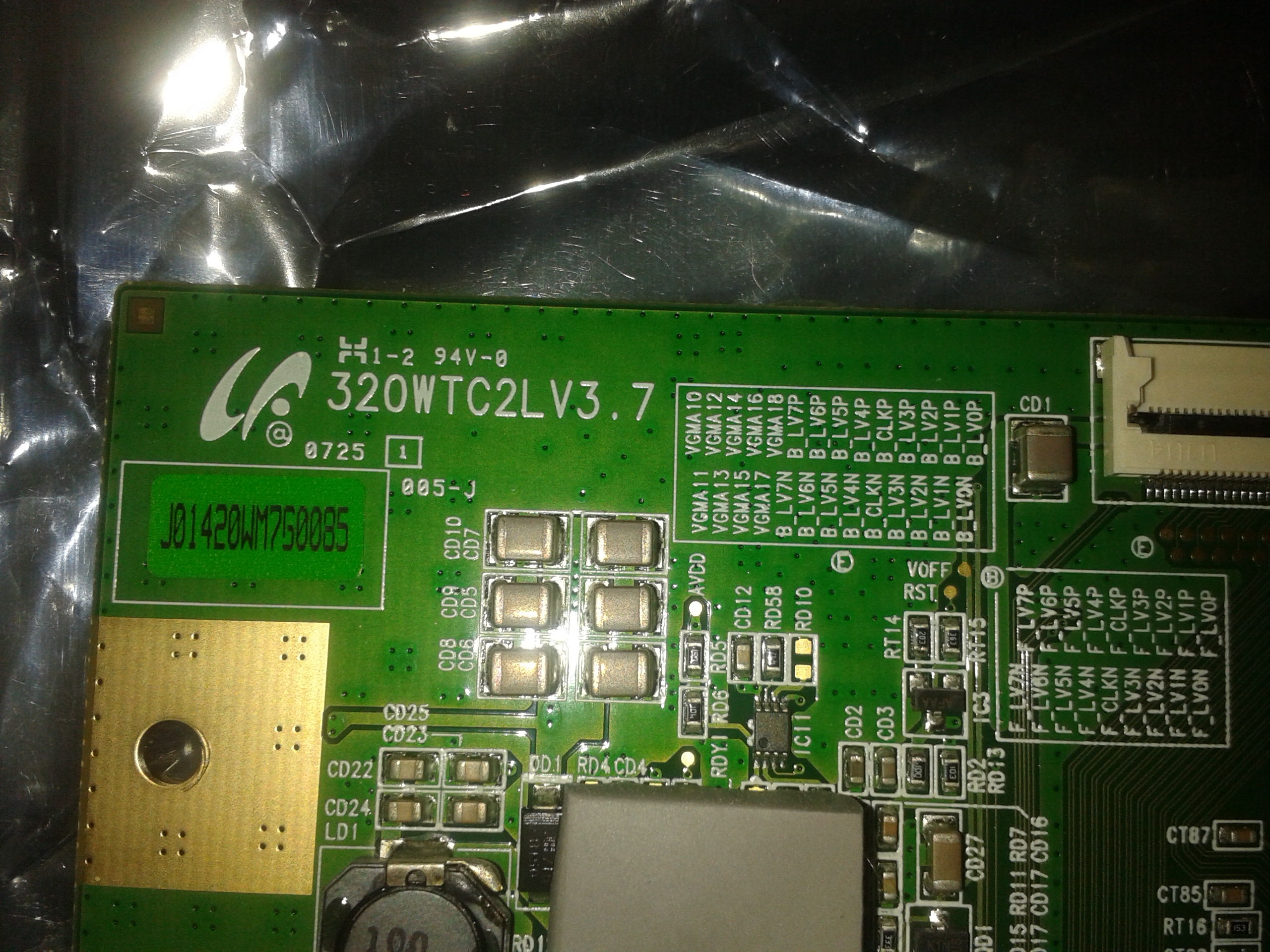

          cant really see when i zoom in on the picture whats the marking on it?
          see this post it gives a part number its a 3 amp
            It has a P on it which is a stated in the post you provided the link to.
            Many thanks. I'll let you know if it's successful when I get the part and fit it.
                While I'm waiting for delivery of fuses I bridged the blown one with a 3A canister fuse and hey presto everything works. I'm leaving it soak testing now
                Thanks again
