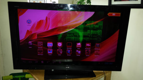

    picture is all red ish and image stays in the back ground
    Re: sony kdl-40cx523
    Tab bonds or gamma IC would be my two guesses.

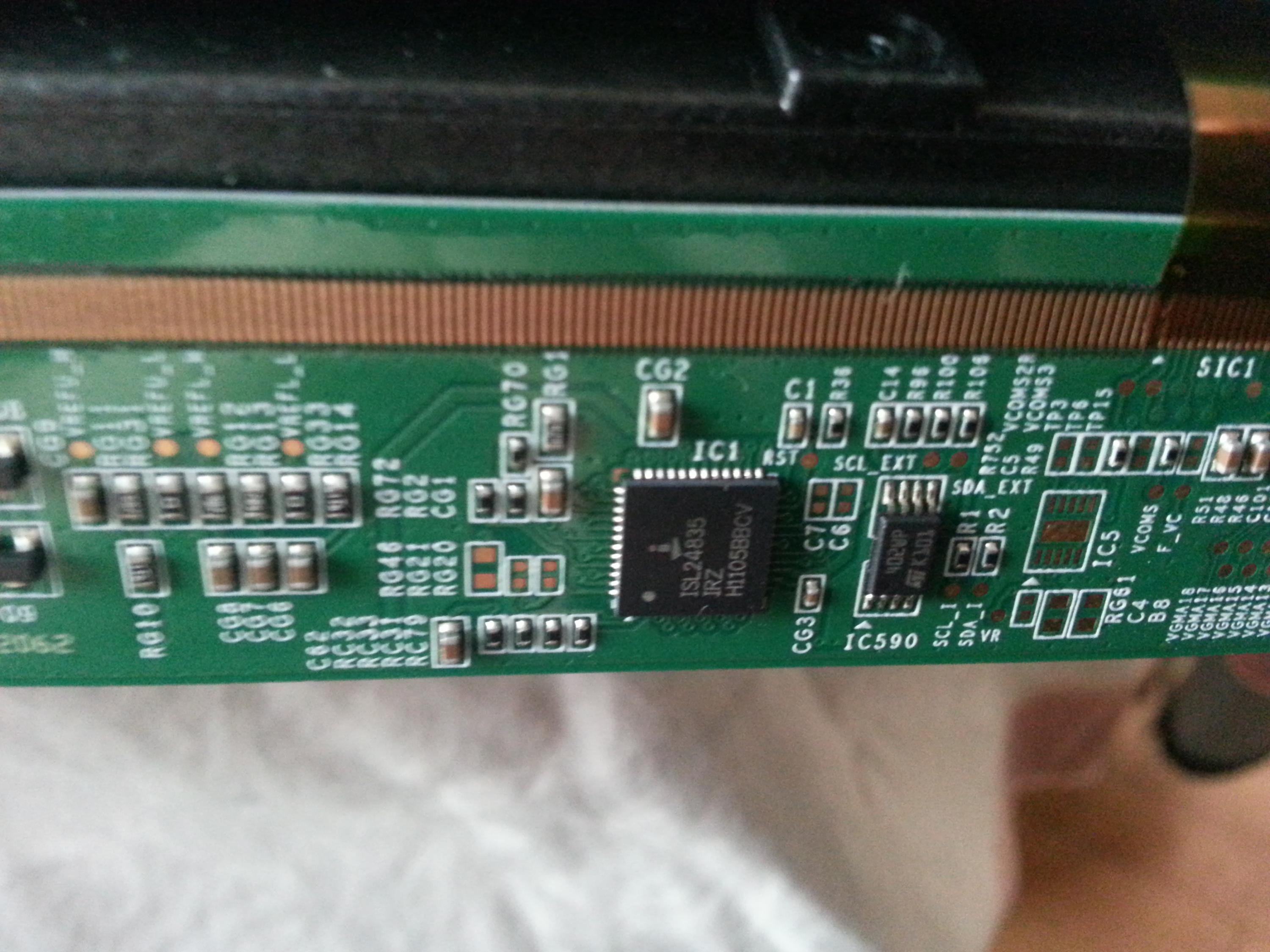

        Depends on what you can do. OK with soldering a 48 pin, 0.6mm pitch IC? (That's the gamma IC.) Tab bonds on 40" panels have often been tricky for me.
        On badcaps this week: we've had 6 failures of AS15 gamma IC...

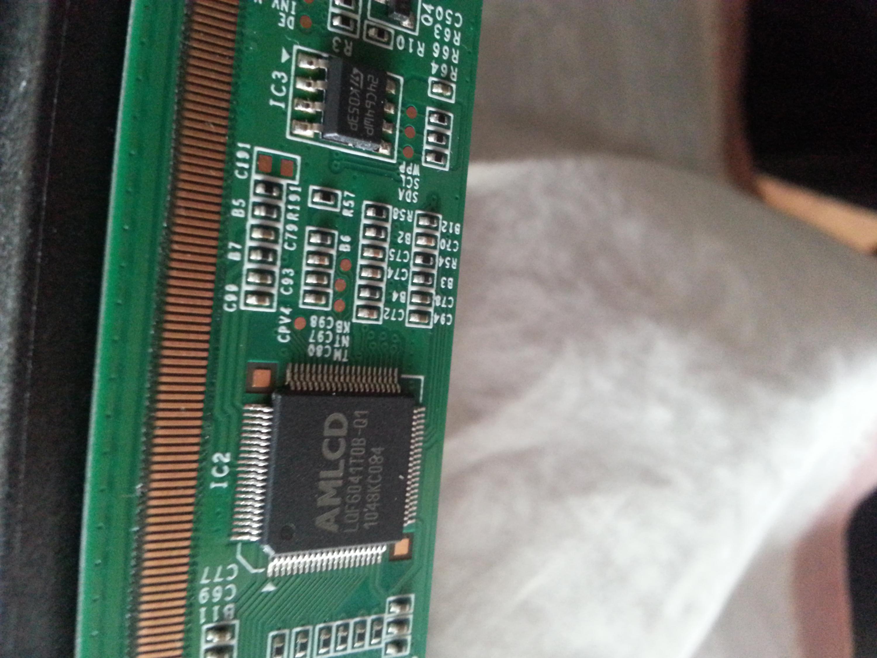

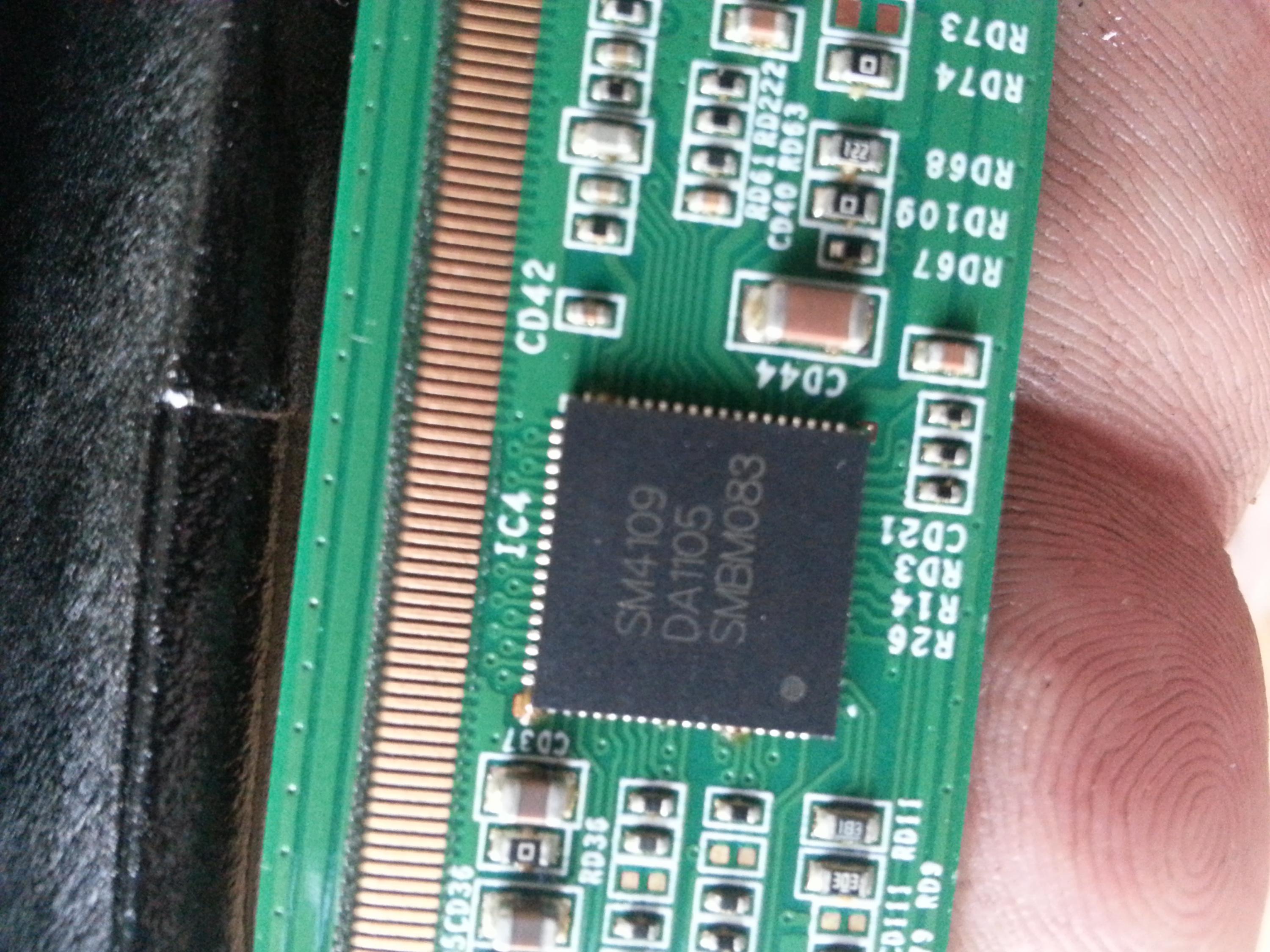

          Im back on with this one I have a buffer witch ic do u think it might be
            From these
              Up load using file attachment to show us the good clear pictures of the back side of the TV so we see the T-CON board.
              Your TV may use this one but we do not know until we see the pictures of your board.
                I have
                  Pictures in post 6 is not the picture of the T-CON unless this TV has the integrated T-CON, that is why we need to see the back side of your TV. See post 7 of what T-con board looks like for the model of your TV, there may be more than one version of your TV. It is hard for us to fix TV from remote, so good pictures are required so we can see what we are dealing with and how all the boards are connected together.
