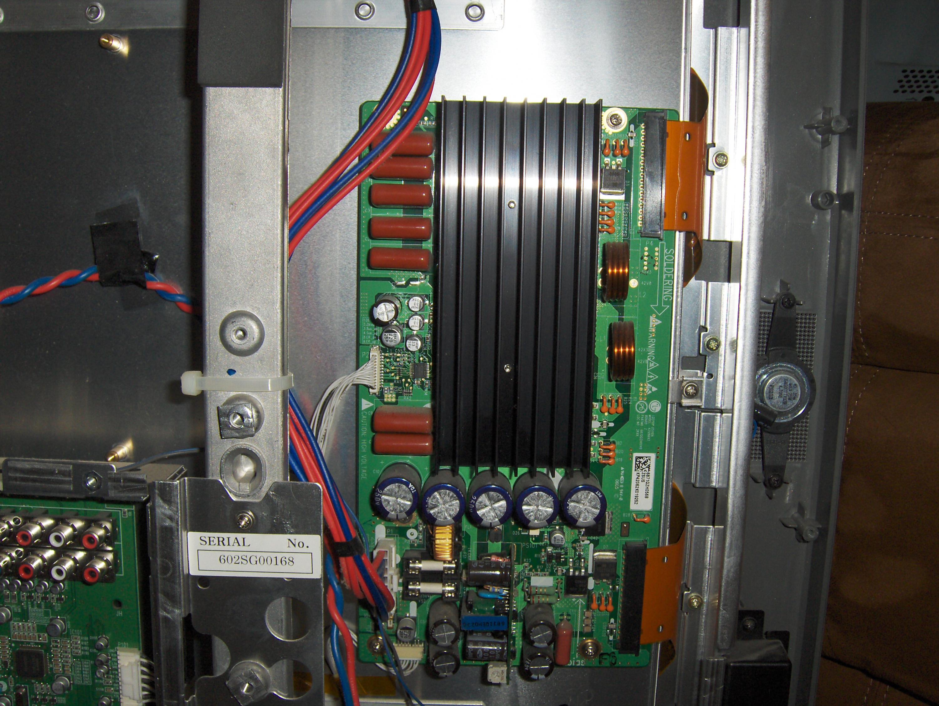

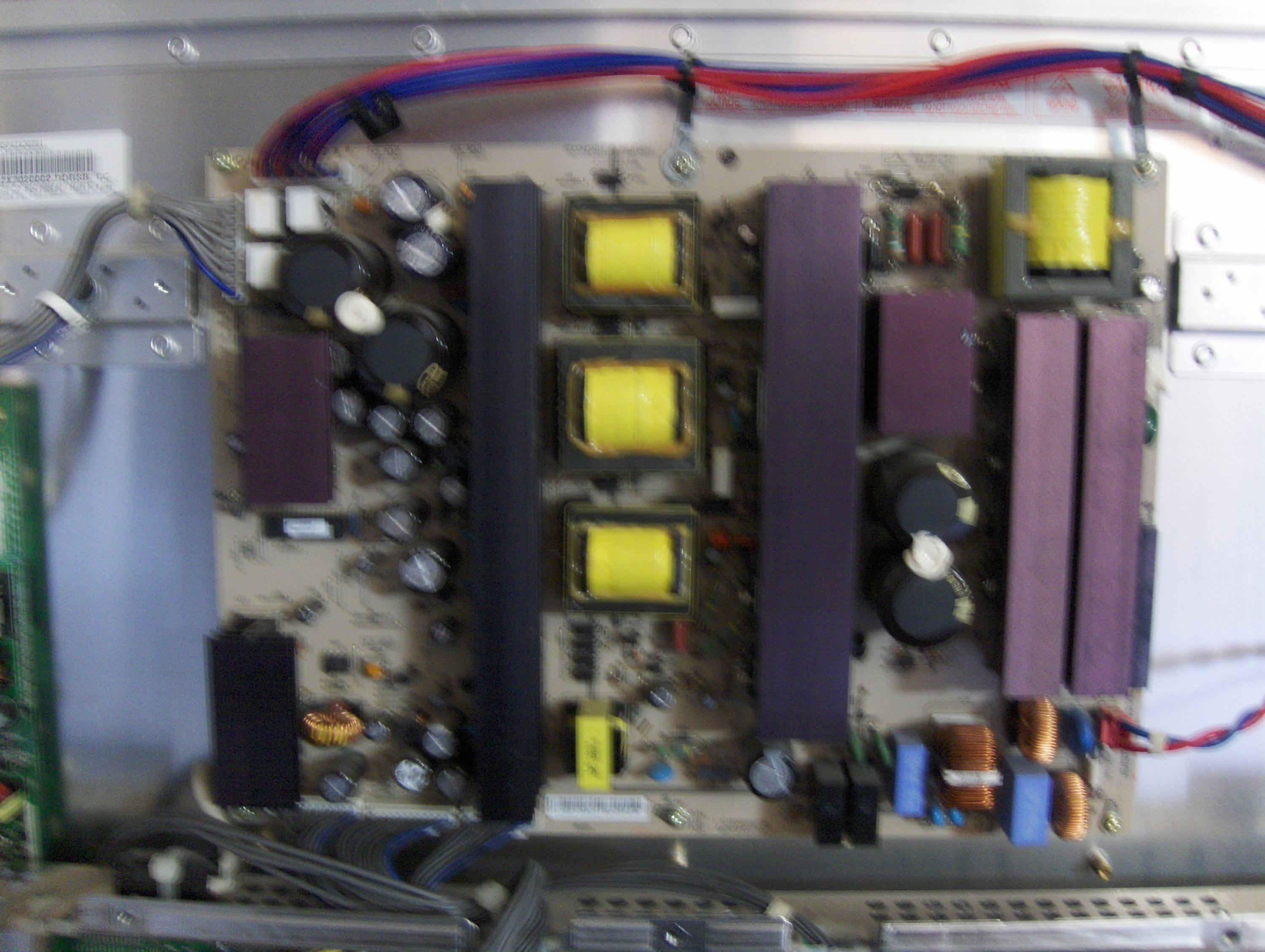

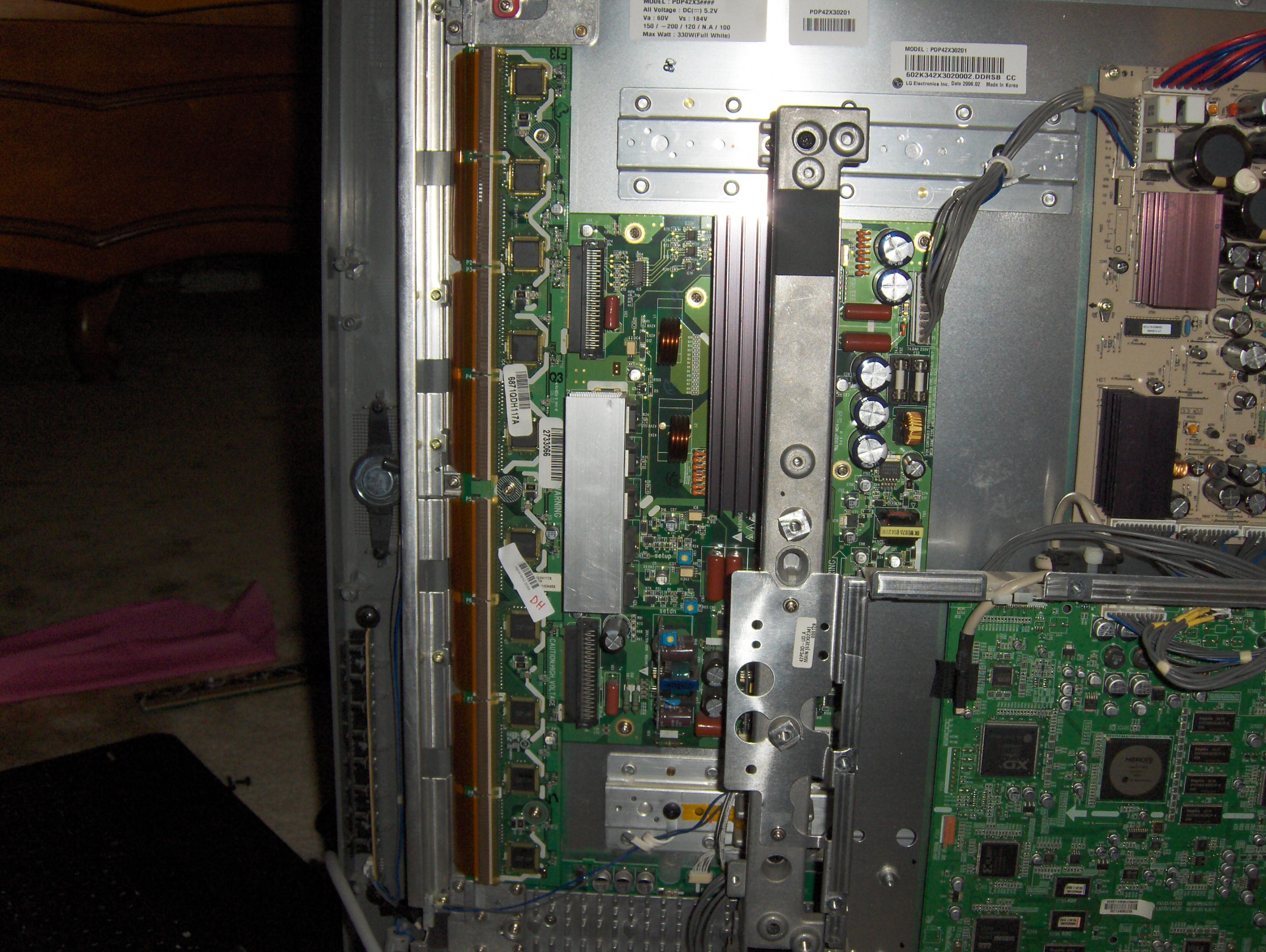

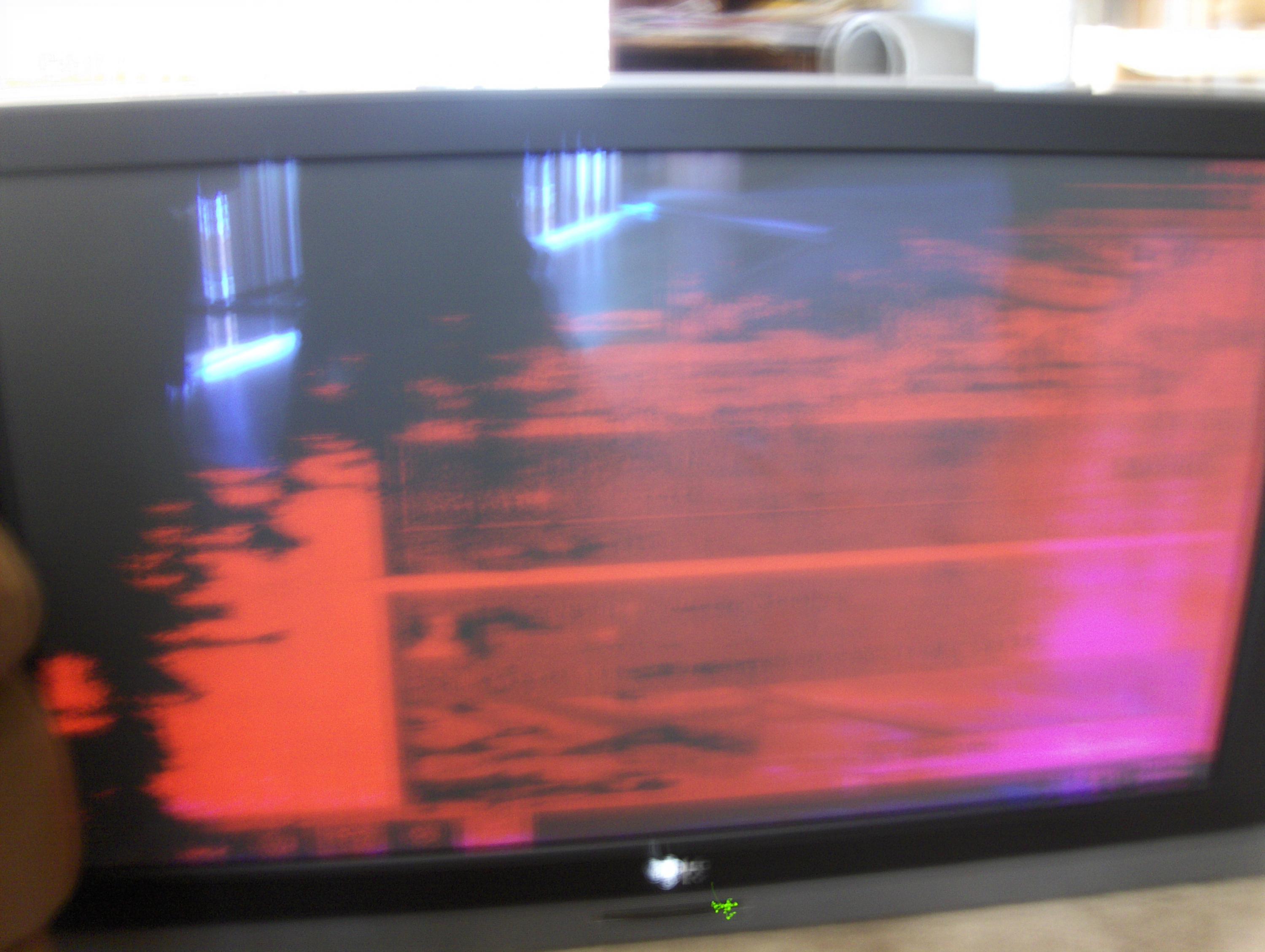

    Just wondering if any one has any idea what could cause this. I replaced the y-main and buffer a while back, now it is doing this. it worked just fine for two months. then I started to see red sparkles then went to this.
    Re: LG PDP42X30201 Picture Problem.
    Z-sustain fault in my opinion.
    This is the Z-sustain: https://www.badcaps.net/forum/attach...7&d=1397841223
    Check the fuse on it is OK.
