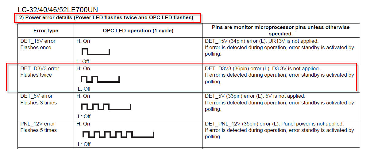

    My TV is not powering up, no picture and no sound.
    Blinking Code: Power, opc+power and it repeats.
    What may be the problem? any suggestions
    I looked at the service manual and it says: Page 70
    2) Power error details (Power LED flashes twice and OPC LED flashes)
    DET_D3V3 (36pin) error (L). D3.3V is not applied.
    If error is detected during operation, error standby is activated by
    polling.

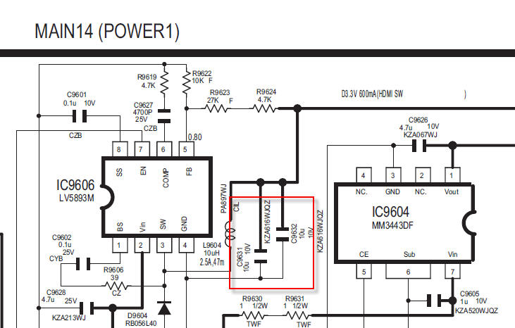

                Page 111 of that. Can you see C9631 or C9632?

                  i opened the tv and can see the power board - i could not locate C9631 and C9632 on the board. will they be on the power board or the main board?
                    Re: Sharp 46LE700UN - no power and picture - Blink: power, power+opc...
                    They are on the main board; if you can't locate the exact capacitors try getting a picture around the ICs and I will make a guess. Note they could be on the bottom of the board.

                      usually, IC 1605 and IC 1801 (hdmi) has a short, check for short Q1610,Q1808 too.
