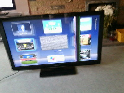

    This is for sale locally to me,
    Panasonic Viera TX-P42S30B 42, seller states believed to be pdp fault, isnt it more likely a buffer board issue? have attached image, thanks
    Re: 2012 Panasonic tx-ps42s30b, panel fault?
    Definitely panel, any time you get a bar with one or more fixed lines it's pretty much guaranteed to be a bad plasma panel.
