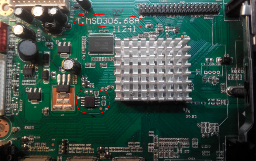

    A little help is needed just got this in,its a 32" lcd/dvd player with a Samsung panel and a T.MSD306-68A 12023 main board,i was told it would come on after a short time 10 mins to one hour,this is what its doing, when you plug it in you get red standby light and the screen shows a message " do not power off" "scan" and shows a count up from 1 to 100% with the red stby light still on.So far it has not powered on and has been plugged in over an hour, i am thinking main board possible Eprom fault? but you may have had this before and know the cause and hopefully the cure? so over to you and thanks in advance Flocko

    Just found a possible replacement eprom at Ohm supplies have messaged Andy to see if it will work fingers crossed Flocko

      Hi there,
      Have the same set with the same problem.
      I can certainly confirm that this is a EEPROM corruption problem,As a replacement from a non-dvd version works.(the dvd isn't working as the software for it is not installed in this other I.C.).
      Does anyone know where to download the latest firmware from?..Seems very elusive...
      thanks,
      Steve.
        Re: Jmb 32/68g-gb-1b-tcdu
        You can try SOURCE 3 6 9 0 and then turn on the DVD option... worked on a 24" Bush for which I got the non-DVD main board (but still had the connector.)

          i have had a message from Andy(Ohm supplies) about the replacement Eprom that he sells for the T.MSD306-68A 12023 for the Technika 40-270, but he has not tried fitting in the JMB 32"model so could not say if it would work or not,i have ordered one anyway and will give it a try.Steve is this the Eprom that you fitted?.I have not looked as yet but i think all these sets come from the same place Sky Media. co.uk and they have firmware downloads on there for a lot of models so look on there. please let me know what you find

            just to update, fitted new eeprom that i got from Andy (Ohm supplies)and set would then come out of standby, but as was said by Steve the dvd would not work and did not show in menu,but i was lucky to find a replacement main board for the set on ebay and it is now working Flocko
