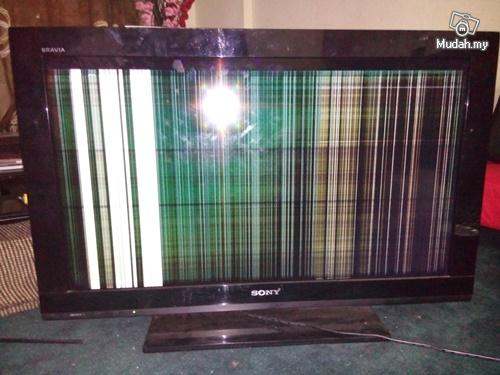

    Hi Guys,
    I have this Sony LCD TV KLV-32BX320. The fault is as in the attached picture.
    What is most likely at fault with this TV, mainboard, power suppy, TCON or LCD screen?
    Thank you in advance for your response.

    Re: Sony LCD TV KLV-32BX320 distorted
    Anyone had this type of problem before?
      If the lines move around, I had a 46" Sony with a bad main board causing a similar problem. I'll defer to others though. Did it happen all at once (like mine) or did it start in one area and get worse?
        I am tempted to say bad panel but you may want to test T-con supply voltages first.
