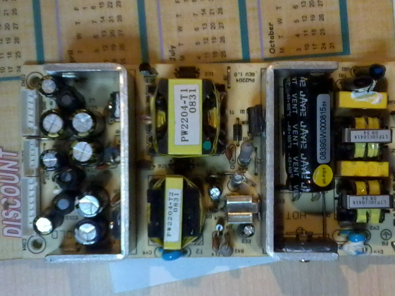

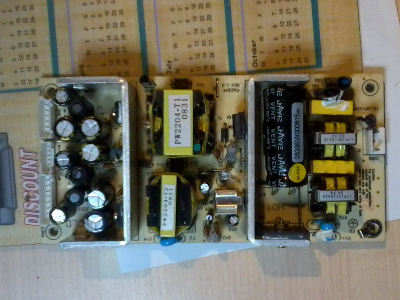

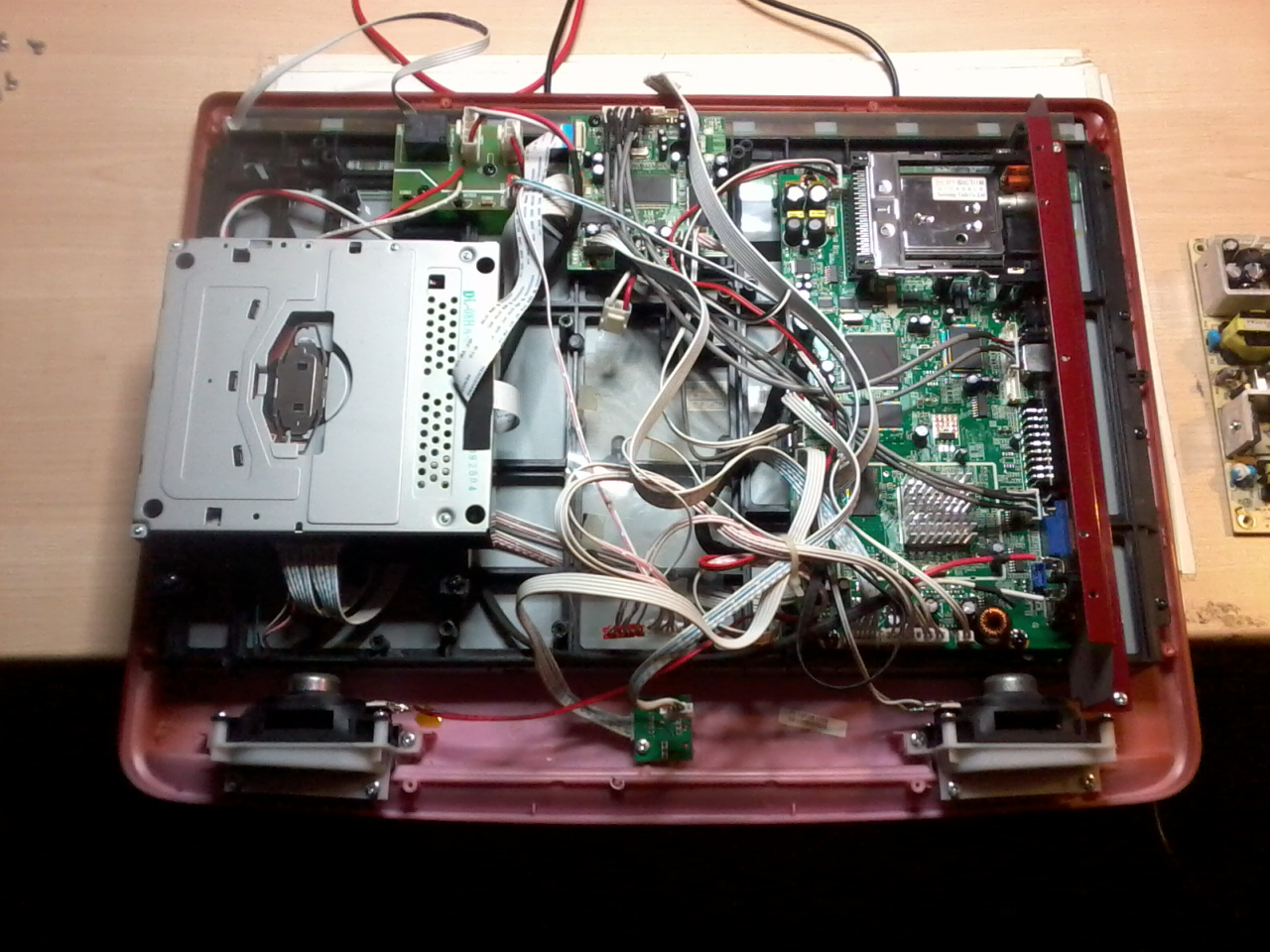

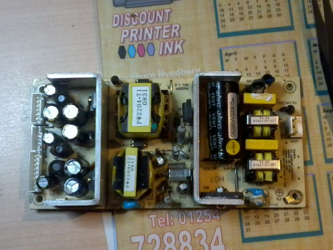

    Ms1951F001 TV/DVD Intermitent power
    Can anyone give me some help in solving power issue ?
    The problem is it is totally dead but when I took out PS to see if their was any noticeable damage (which there was none) & re-soldered a few dodgy looking joints I tried it & it worked for a few hours. I switched it of & now it is acting dead again with no power lights showing. I'm getting ac into the PS & 300V from Big cap just no 12vdc at connector to main board (I get a reading which jumps between 1.8-2.2vdc.) all the caps look ok & have checked diodes.
    any help would be great thanks
