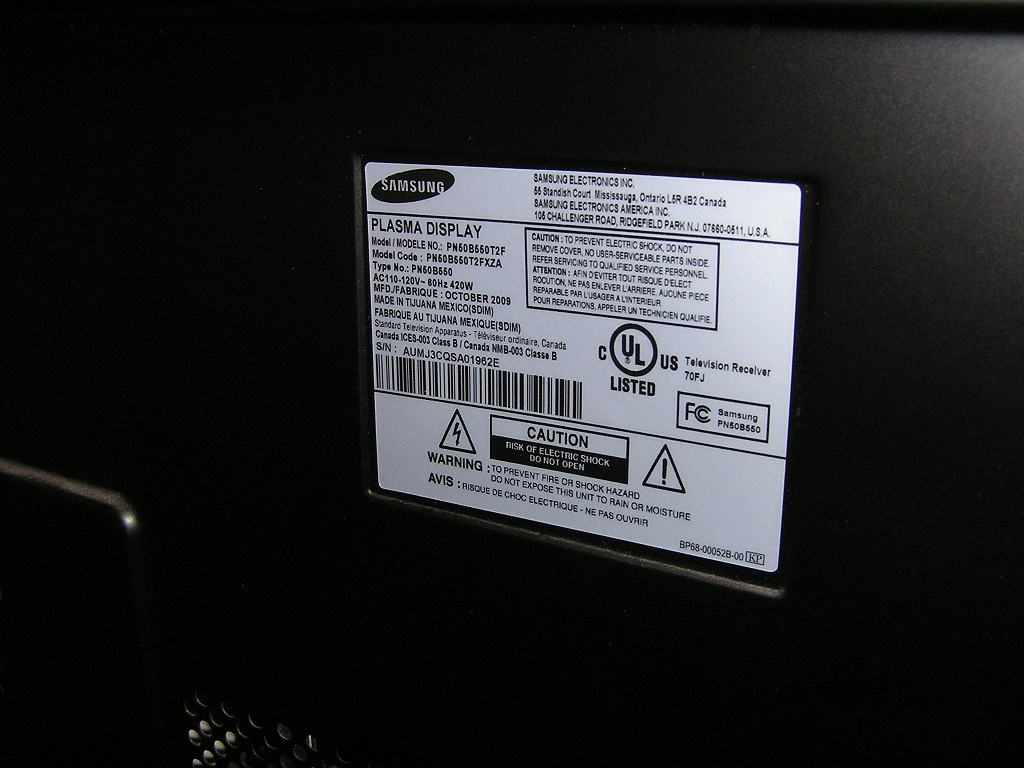

          Re: Samsung PN50550T Won't Turn On!
          It's not correct, there's a missing letter between PN50 and 550T, probably "A", or "B".
          • coppercitycomputer
            • Apr 2014
            • 90
            Re: Samsung PN50B550T Won't Turn On!
            My mistake it is a B, here is a photo of the tag. How do I go about trouble shooting it?

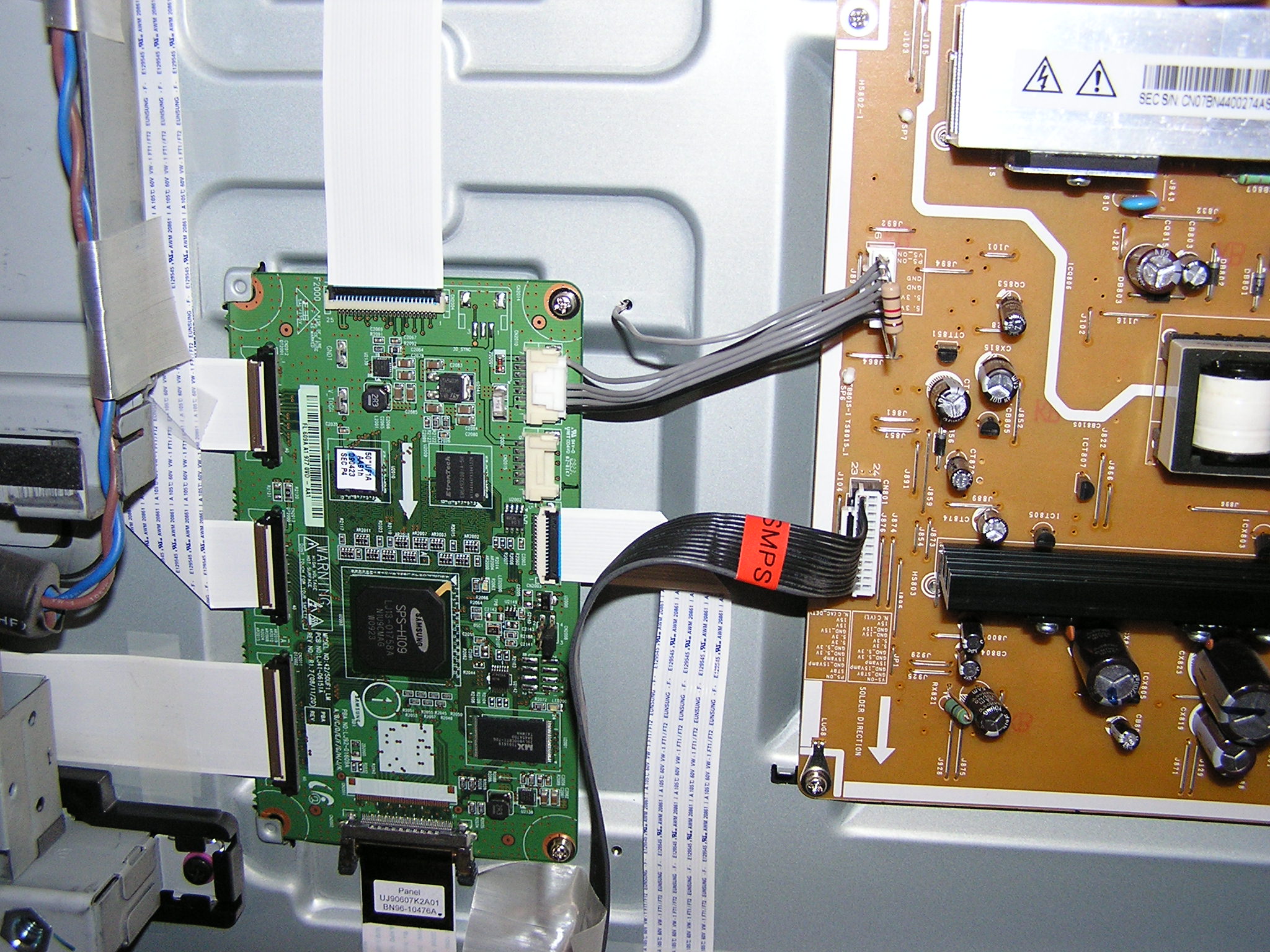

                          you could try to force on procedure. on logic board there should be four jumper pins. place jumper wire between #3&4 pins. on main board find ps-on wire, unplug wire harness from connector and short out ps-on wire to ground. power on , it should do a few self video tests
                            As above but you also need to jumper VSON to 5V with a 100 ohm resistor.
                              • Apr 2014
                              • 90
                              No change, if I am doing it correctly, I think that's the right resistor. The front LED light stays on when its in this mode but the TV won't power on, Unplugging the other boards X Y and input, has no effect. If I unplug the controller power lead it makes the start up noise and try's to turn on, that is without the jumper and short and resistor.
                              Any more ideals?

                                Check for shorts on the Vs line of both Y-SUS and X-SUS boards. Disconnect the PSU from the boards, and check resistance from the socket pins on the board to chassis/deck, should be pretty high resistance (Several 'K' ohms) after an initial low reading of a second or so--while the caps on the tested board charge via meter.....
                                Without the control-board connected, the PSU will not supply the Vs, Va etc but will supply the mainboard voltages--hence the chime and apparent life from the set.
                                I wouldn't waste dosh on a Control-Board without being certain that the fault wasn't elsewhere
                                  The Y board very quickly go's to "1" on my meter set to 2000K. On the X board the number slowly increase's. What does that mean?
                                    In the photo above, are you jumpering both VSON and PSON? Any relay clicks?
                                    Note, I've had a bad control board before, as has John on this forum, but it's overall quite rare.
                                      • Apr 2014
                                      • 90
                                      PSon is going to ground the chassis VSOn is going thought the the resistor to 5.3V while still plugged to the controller.
                                      Yes the relays still clicked.
