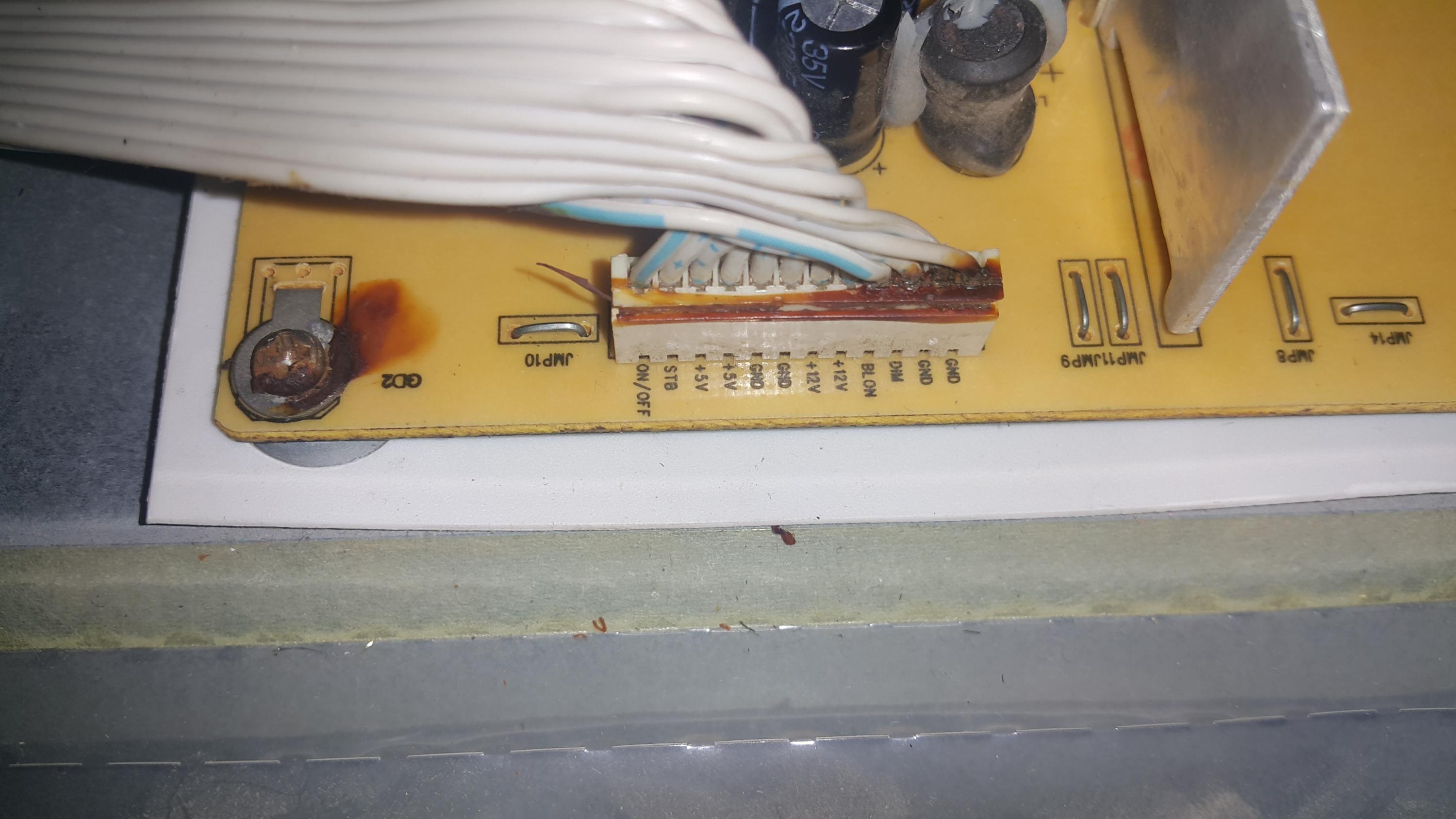

                      Need some pictures. From the one I can see the board looks pretty nasty. Is there more rust and brown stuff all boards?
                      • ainsworth
                        • Oct 2013
                        • 23
                        • jamaica
                        Re: Viore lc22vh56pb
                        I don't think it's rust, I think it's the hot glue they used but it's all dirty now, I could clean the board though, I only have alcohol at the moment, some ground terminals on the power supply board are corroded though
                        • dskall
                          • Oct 2016
                          • 2905
                          • usa
                          That brown stuff needs to be cleaned off. It becomes corrosive and conductive. Been several posts about damage it has caused. https://www.badcaps.net/forum/showth...ight=corrosive
                          It cleans up best with acetone.
                          With connector unplugged to mainboard and a 1k or so resistor from standby on/off and bl_on you should get all your voltages and backlights.

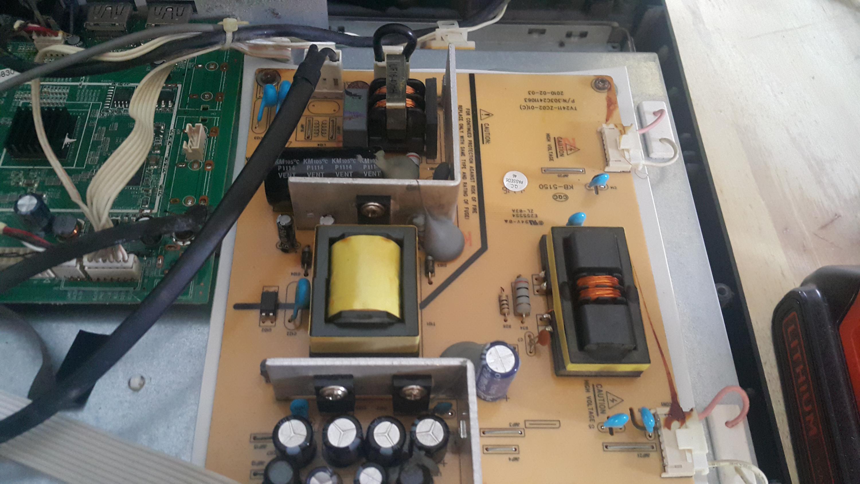

                            Here are some pics

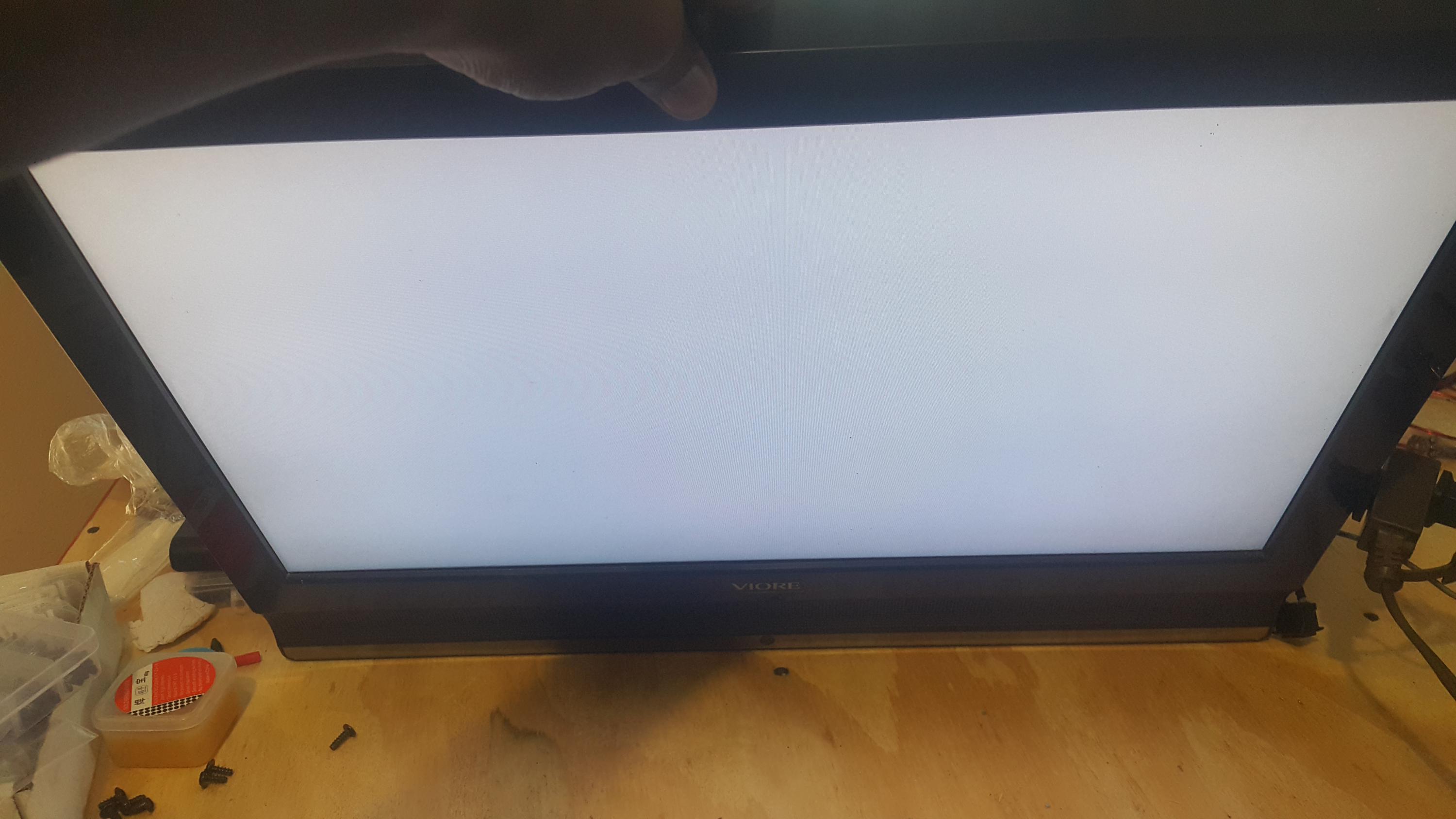

                                Here is a pic of the screen when it's lit

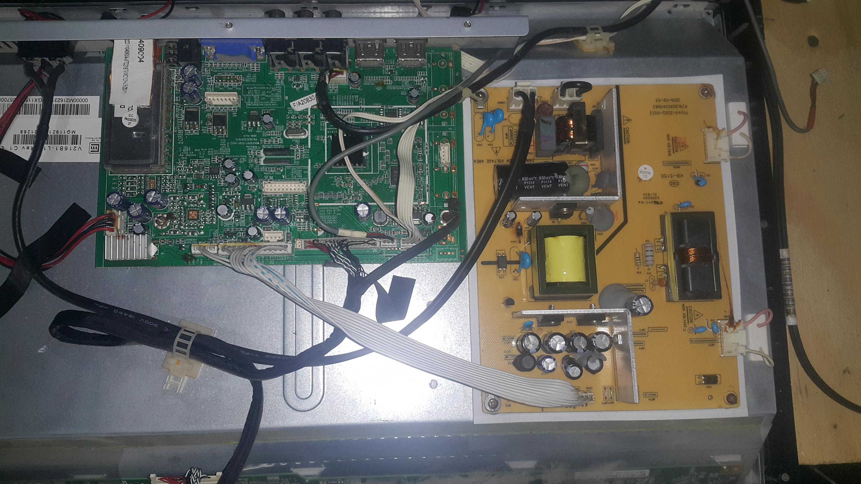

                                        Here is a pic of the boards
