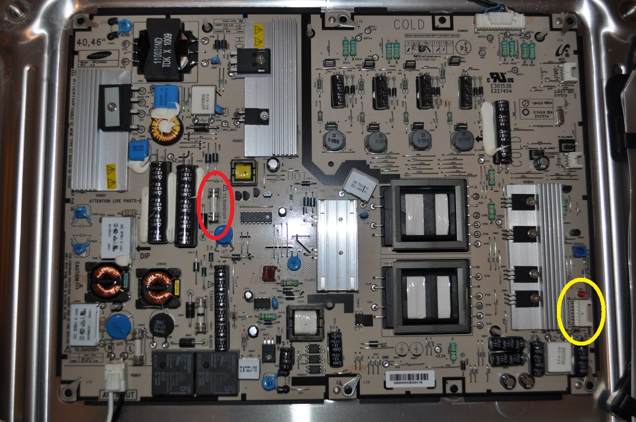

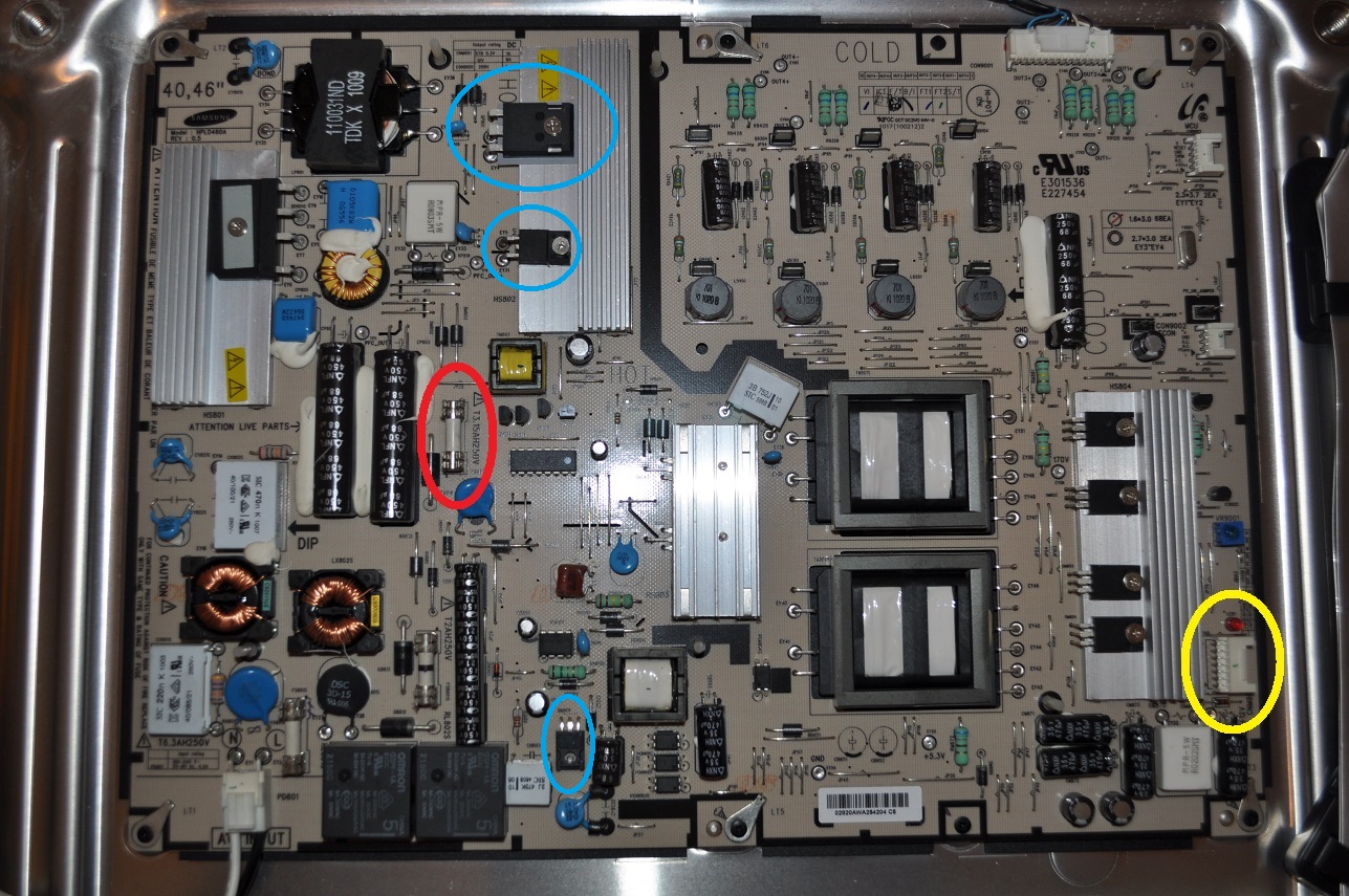

    I picked up a Phillips LED that all it does is make a repeating clicking noise when plugged in. If I unplug the main board connector (circled in yellow) the clicking stops. I found a fuse circled in red in the picture that was blow. Replaced the fuse and it blew as soon as I plugged it in. I unplugged the main board replaced the fuse and plugged the set in and the fuse did not blow and I had 5v standby on the PSU. As soon as I plug in the main board the fuse will blow.
    Re: Philips 40pfl7505d/f7 clicking noise
    There are relays on the SMPS, once the main board sends the power-ON command, the relay clicks on and the fuse "sees" a short, blowing.
    I would check all FETs on the primary for shorts, you'll probably find one or two bad.
      Thanks,
      Just to be sure before I desolder the fets, the fet's circled in blue are the primary side fets correct?
        Those are them (although left hand one is for 5V standby and so should be OK), plus there are two others under the other metal heatsink on the primary side, test those too.
        No need to desolder FETs for now. Just check for shorts. If you find shorts then desolder them to confirm the diagnosis.
        When replacing the FET always replace the driver IC, resistors, and diodes on the gate tract of each FET to prevent repeated failure.
          Just a follow up, three of the fets were bad. I couldn't find them to replace. I did find the entire board cheap. The new power supply did the trick. Thanks

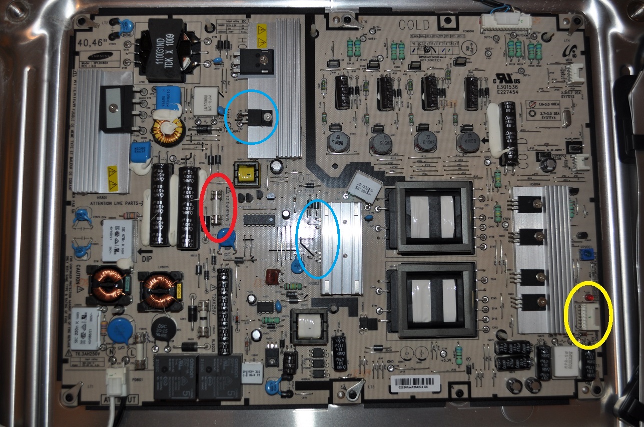

              Circled in Blue. All three had a Source to drain short.
                One is a diode, probably only the two on that small heatsink were bad.
