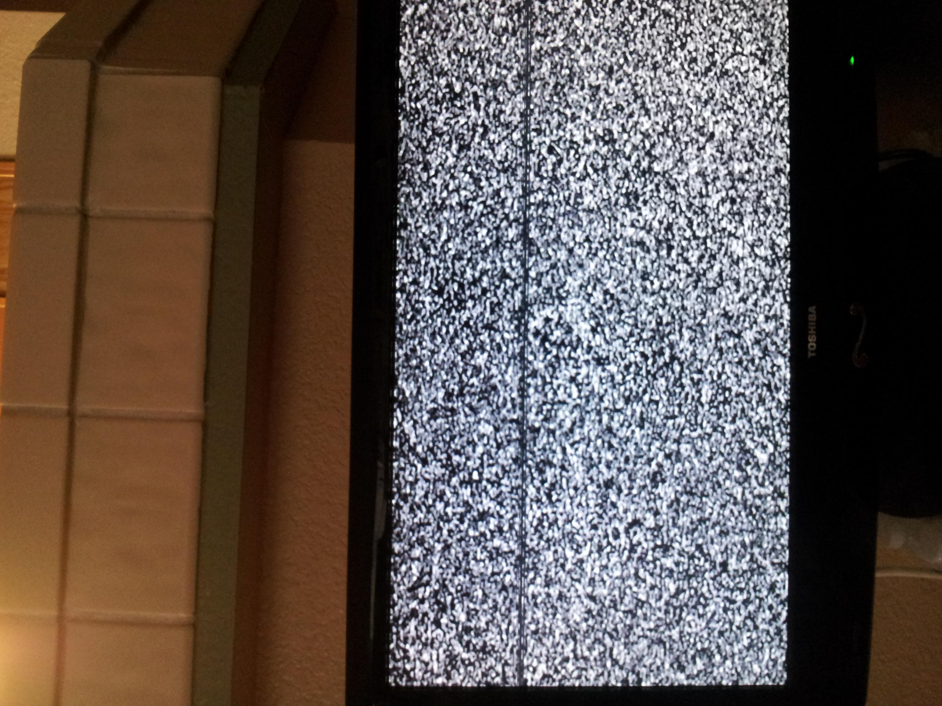

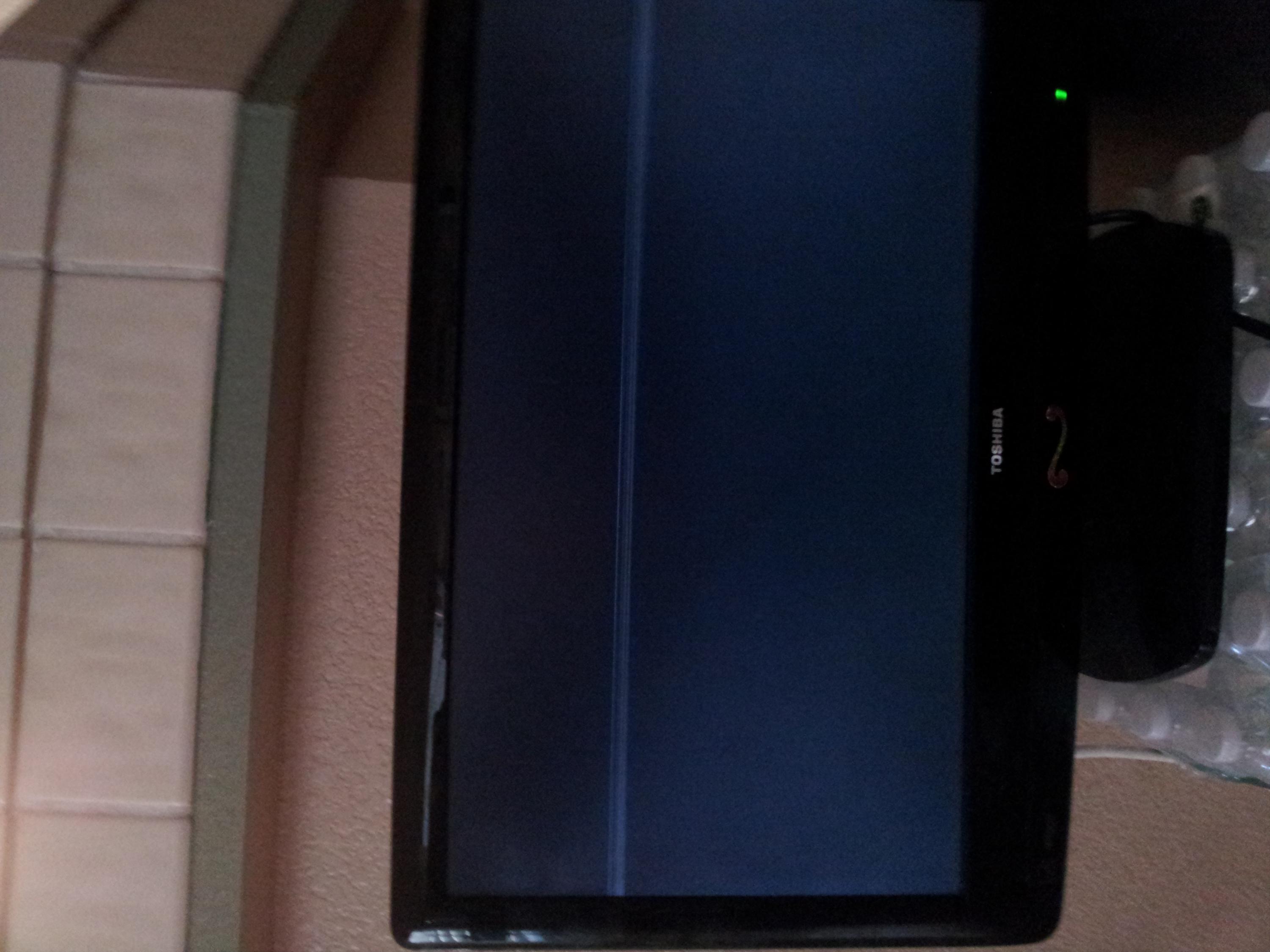

Toshiba 22AV500U horizontal lines on screen
  • Evenflow
    • Mar 2014
    • 38
    • US
    Horizontal lines 1/4 way down from top. When set is unplugged then plugged back in and powered on the screen below those lines freezes. With a gentle thump to top of set the picture comes back but lines are still present. Set ain't worth nothing but good for practice. Suspect t-con but on this set it looks as if its integrated to pannel. Ribbons to screen don't have a standard connector. Is this true?? The pics are bad but you can get the idea
    Re: Toshiba 22AV500U horizontal lines on screen
    Almost certainly the panel, t-con wouldn't cause this even if removable.
    • Evenflow
      • Mar 2014
      • 38
      • US
      Thanks Tom66.
