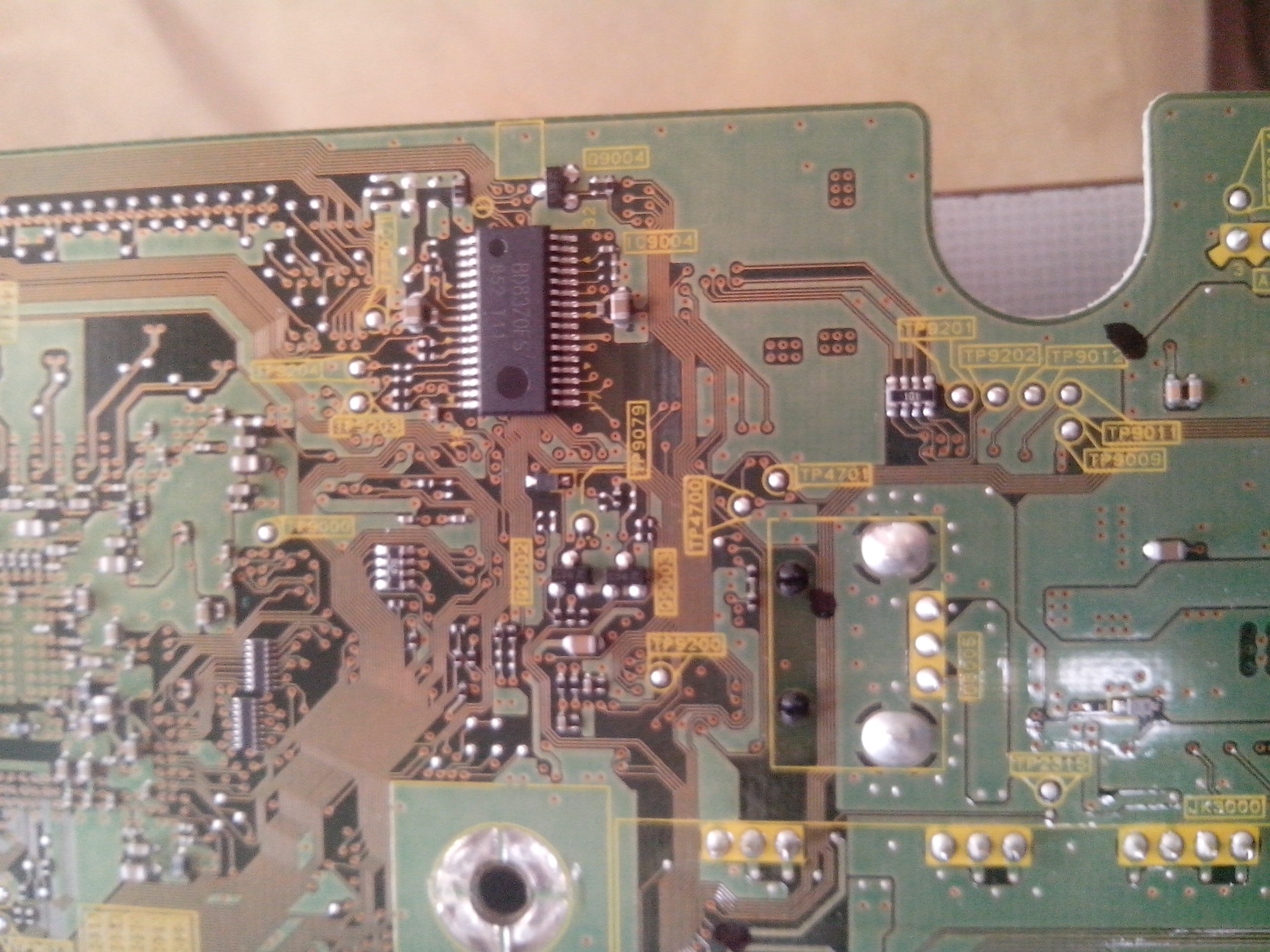

    Just another thought, but if you're willing to have a go at that chip replacement, why not try heating up pin 5 and carefully lift that leg to isolate and disable the SOS6 to see what happens.

      Them chips too small for me to solder but i like the idea of isolating pin5 think i will give that a go have the board out now anyway will let you know later.THANKS.

        Reckon you could take a nice clear closeup of the IC? I'm curious to see. Yes it can be a challenge, I have to use magnifiers.
        These boards seem hard to find, only saw broken ones. So you may need that board as a core for repair so be neat.

          Thanks TW heres the picture the 5th leg is on the left 5 down from the top right?It says 1 on the board at the top left!!https://www.badcaps.net/forum/images...nsertimage.gif

              Did it TW but its the same also now when i take off ribbons it cuts out before the fans and boards would keep going?Any ideas?

                No, probably time to stop messing with it. Obviously more complex than I hoped.
