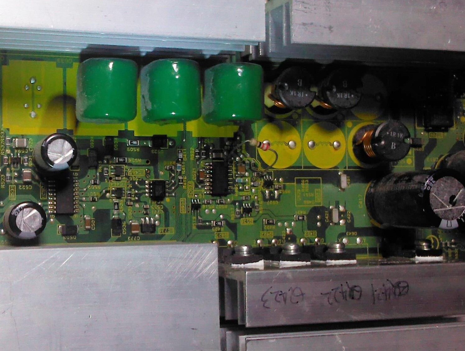

                    #29
                    Re: PANASONIC Th-p50g10 6 red blinks
                    heres the picture tw make your life a little easier what you think about that critter?
                    • cb007cb
                      • Jan 2014
                      • 51
                      • usa
                      #30
                      photo upside down its the brown thing next to right hand green cylinder.
                        #31
                        Looks like a mod someone has done...

                          #32
                          Originally posted by cb007cb
                          TW thanks i just tried voltage test on sos6 with the 3 ribbons off and i get no voltage at all! ic9004 have not found yet wish i was a pro like you!!! Something you might be interested in on my sc board someone has added a small brown thing with stripes on it looked odd.Well if you go to thread 17 and look at the great picture you gave me the 3 green cylinders next to each other, go to the left one and above it theirs a ic black with about 9 legs each side well the bottom left leg has this thing soldered to it and it goes to the small black square to the left of it if you cannot find it i will send picture.Proves someone has messed with the sc board.Look forward to your response thanks again.
                          Ok, so all the evidence is back on the A-board/SC20 ribbon. IC9004 could be on the foil side of the board. Interesting addition.
                          • tw2005
                            • Oct 2011
                            • 6458
                            #33
                            So is that 22ohm resistor at pin 8 of the iC and the other side of 10ohm R551?
                            What's the resistance across that , 7 ohms or 22 ohms?

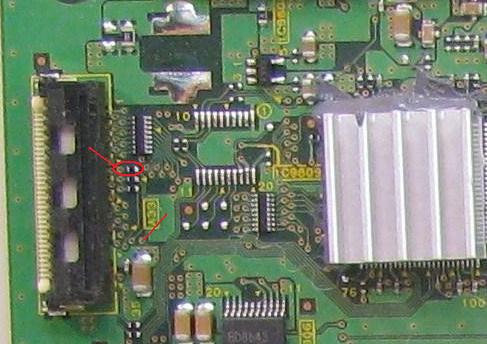

                            • tw2005
                              • Oct 2011
                              • 6458
                              #34
                              For now, go to A33 and just behind the connector ther are 3 SMD resistors, one will be R9110. Hook it all up and probe to the right side of that and start it up to see if a high is getting there initially.

                                #35
                                TW the ohms are 22.1 how you knew that i dont know!lol is that supposed to be their? Hooked everything up same symptoms turns off. Now looking for 9110.
                                • tw2005
                                  • Oct 2011
                                  • 6458
                                  #36
                                  You can see the color code of the resistor. That suggests the 10 ohm resistor is blown open cct or very high resistance. Picture is not clear enough to see if it looks bad not that you can unless there is a hole or burning.
                                  Two resistors in parallel 1/(1/R1+1/R2)= 1/(1/22 + 1/10) = 6.88ohms
                                  I've highlighted R9110. On the left side of that resistor, should see the same as TPSOS6, on the right could be a bit less with the voltage drop across that resistor.

                                    #37
                                    Thanks for picture TW. Just tested it got about 4.55 left and 4.75 right.Does that give us any help?Thanks.

                                      #38
                                      yeah, so you're saying what you see on the SC board is reaching those points and means you need an A board or take a gamble replacing IC9004,
