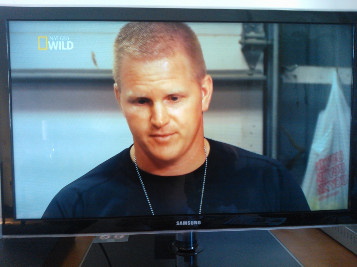

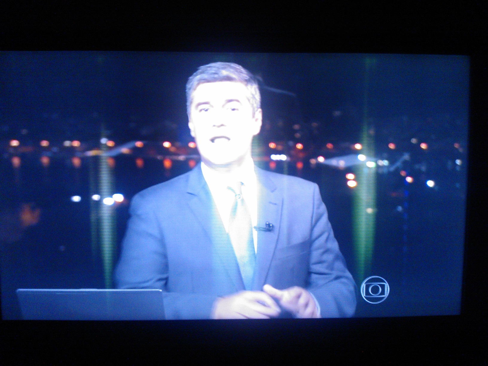

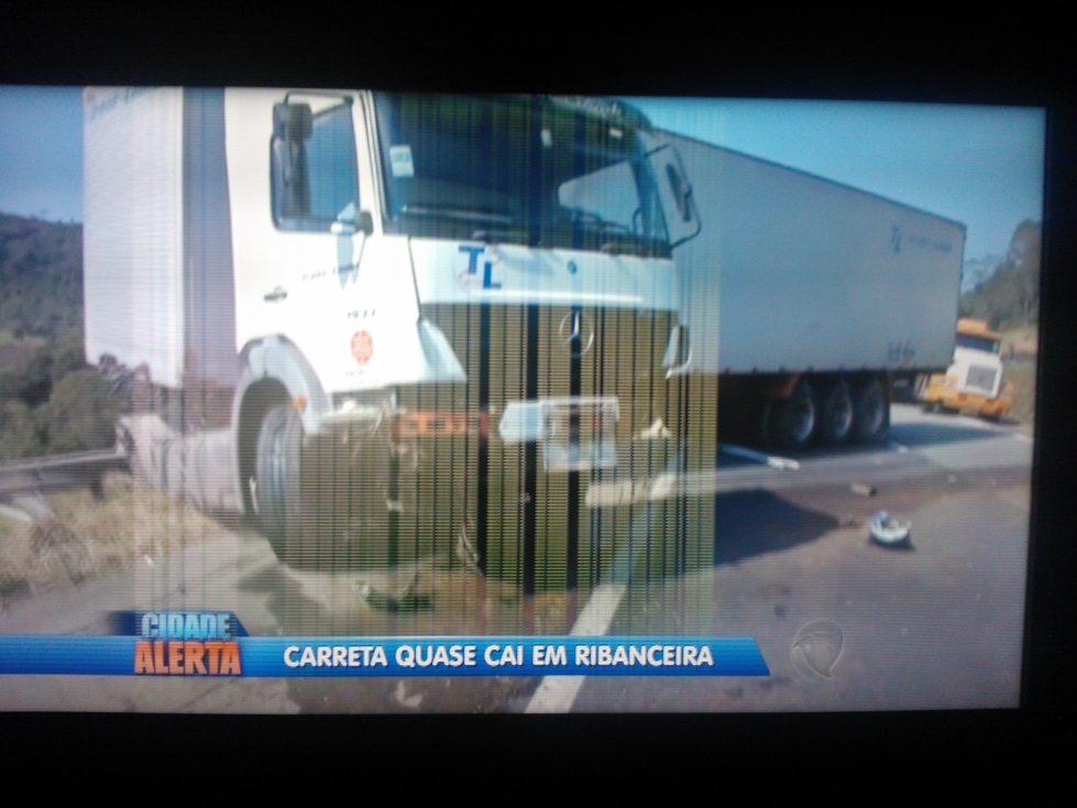

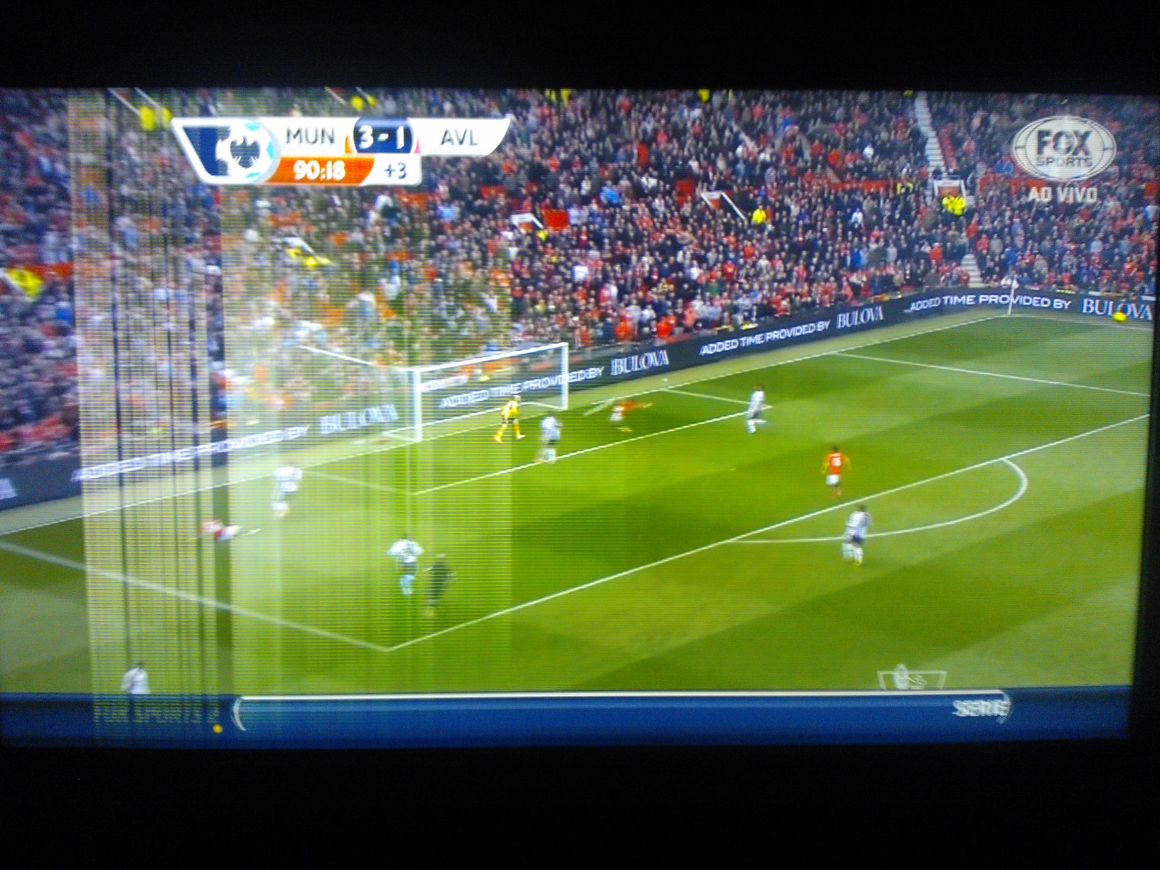

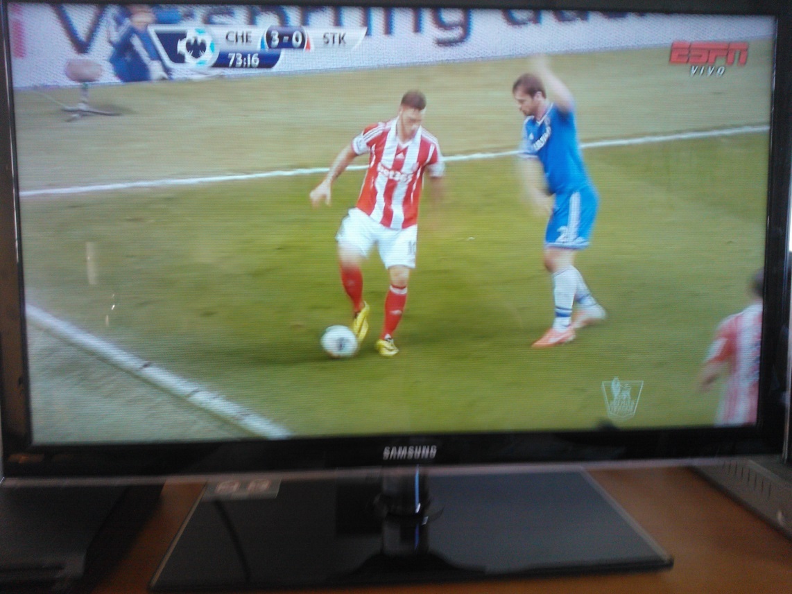

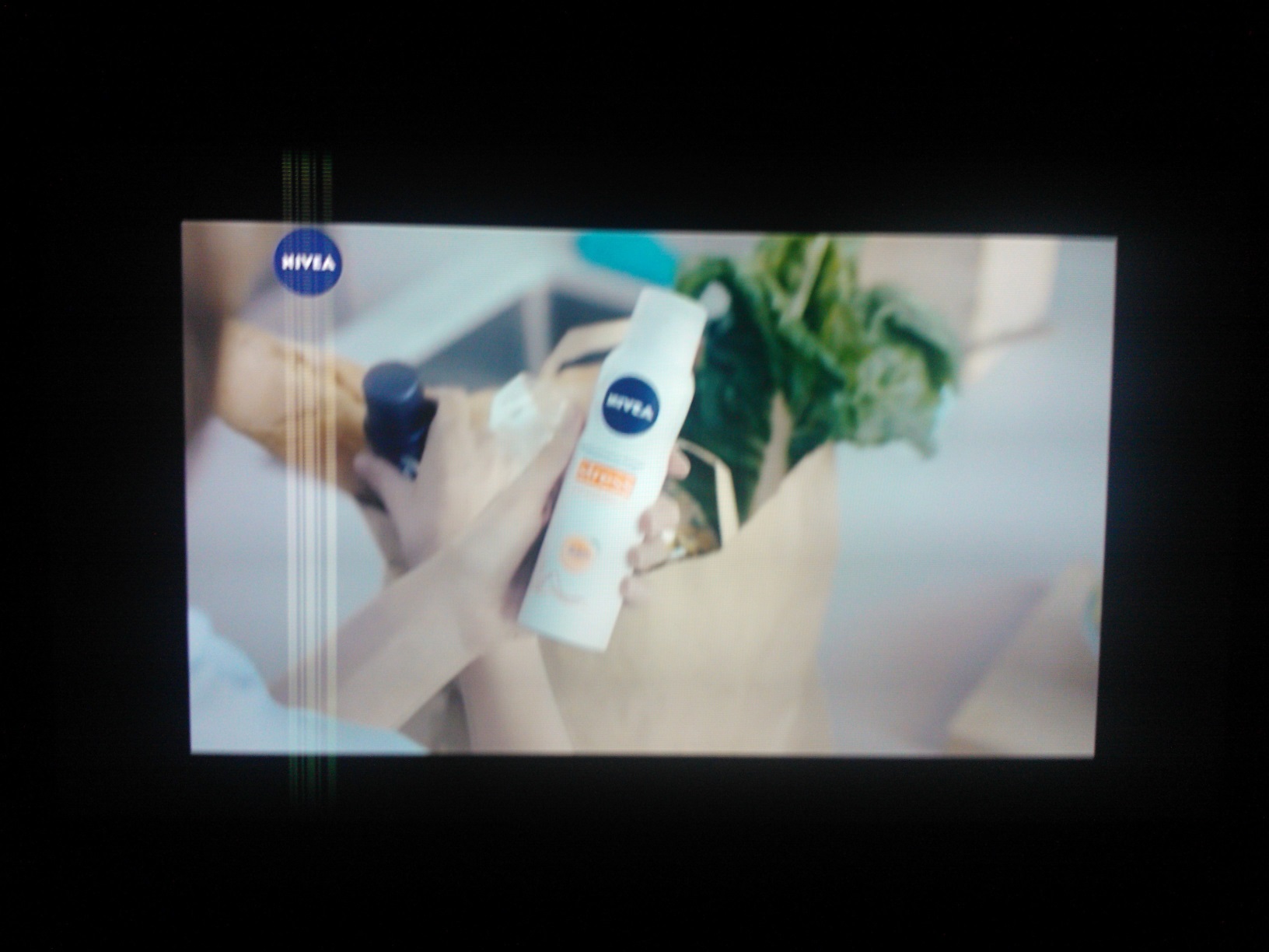

    My television started presenting lines like shown in the pictures below. The lines move, changing places according to the images on screen, and, sometimes, they disappear completely. Would, perhaps, it be a T-Con issue?
    I appreciate the help.

    I would first try and re seat the cable between the main board and T con board or wiggle them with tv on and see if it affects picture.
    It doesn't seem a tab bonding issue at first glance to me,but watch this video to learn about tab bonding issue,just in case
    http://www.youtube.com/watch?v=purk_SyiT44
    I realize you're not having the exact same picture distortion but they vary and its a good vid on what to do with it...

      Hello, martino. Thanks for your help. I tried following the steps on the video you sent me, but, unfortunately, it didn't work.
      I'll wait and see if anyone can give me another idea, 'cause I don't think I'll manage to solve this one on my own.

          Possibly a main board fault. Is it the same on all inputs ?
          By the way, you are missing a letter in the model number I think. UN32x5000... what series is this ?
            Re: SAMSUNG LED UN325000 PG - vertical lines
            Thanks, mmartell. Yes, it's the same in all inputs. I'd just like to be sure it's not a screen issue, because in Brazil it's cheaper to just buy a new TV.
            The Model Code is: UN32D5000PGXZD. The version is: KS24.

                Looks like a bad LCD panel to me. You can try checking some voltages on the t-con board, if you can provide a picture of it I will try and highlight them. But having seen this before with no repair success, I suspect the actual LCD panel is bad.
                This week, must have been FOUR Samsung D series TVs with bad panels!!

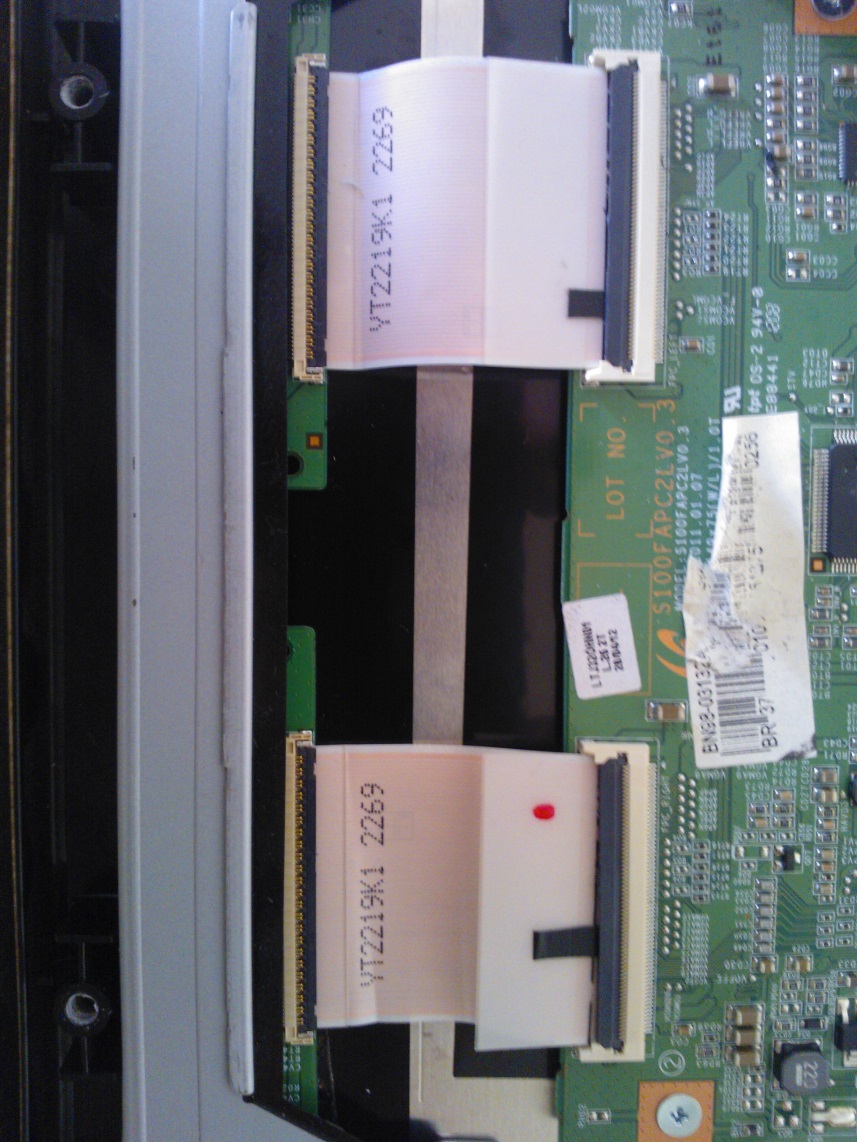

                  I just hope it's a fixable issue. That's a picture of my T-Con board. Thanks for the attention!

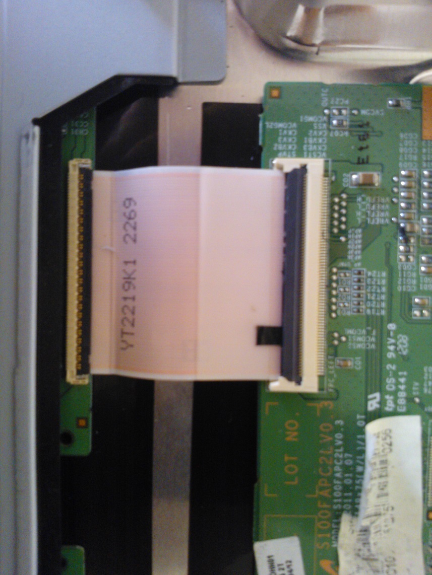

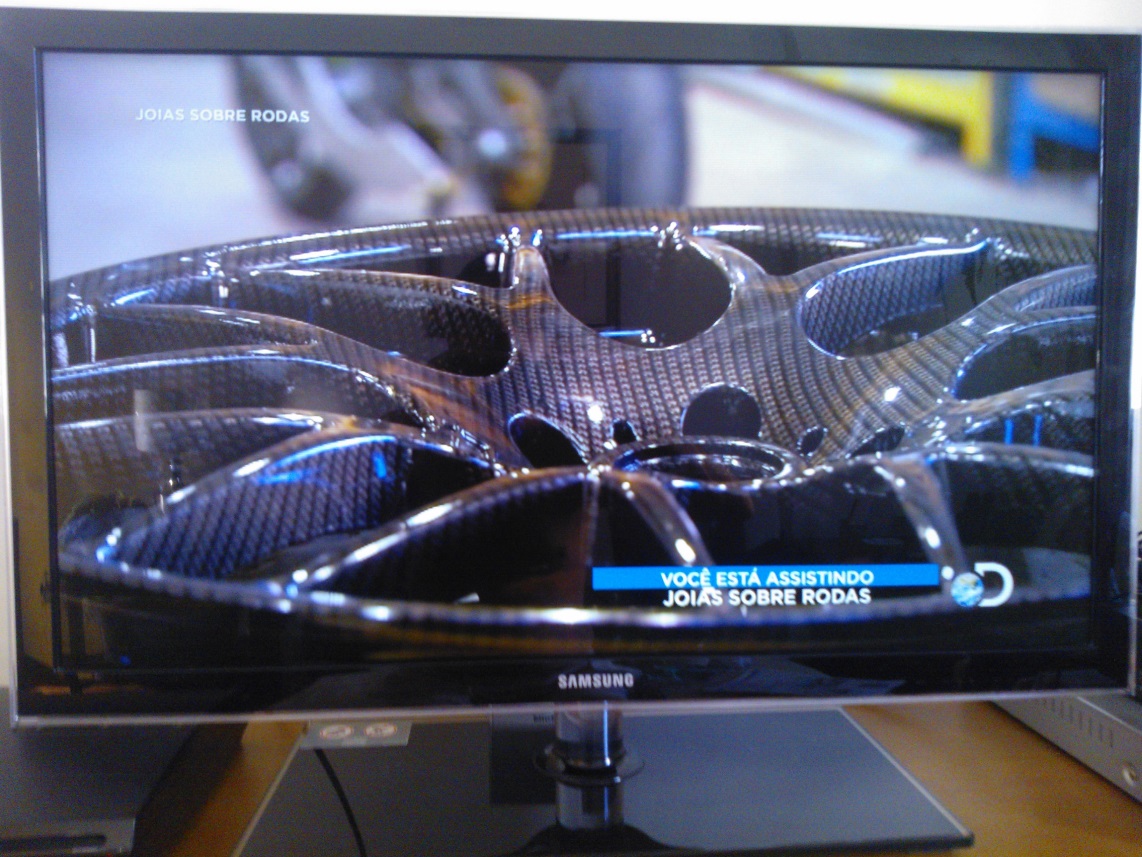

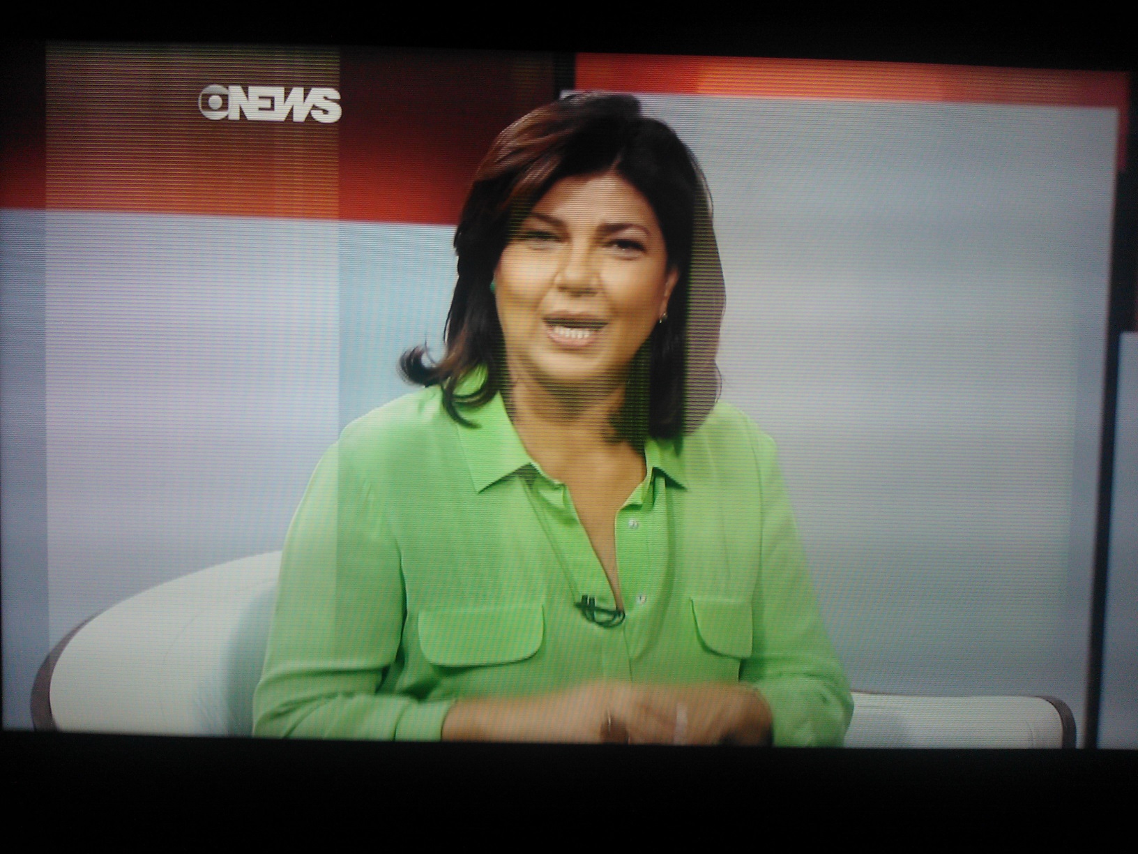

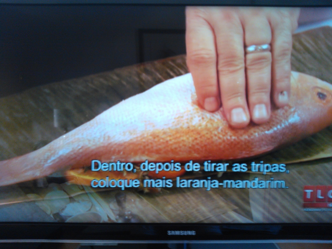

                    I searched online and found a youtube video (check the link below). I decided to give it a shot. First, I disconnected a flat cable, cut a piece of electrical tape and put it in different positions in the flat cable, 'til the issue was gone. I only had to re-do the process in the other flat cable, and it was done.
                    I'd like to know what happened. Does anyone have a clue why it worked? Does this prove it was a T-Con Board issue?
                    I'm attaching a few images of the procedure and the end result. The video link also follows: https://www.youtube.com/watch?v=WNgESNOtCoY
                    Thanks for the help.

                      Hmm, very interesting - perhaps a loose connection at that point? You could confirm this theory: without the tape, try pressing down on that area of the ribbon, or pulling up slightly.
                        I tried all procedures you suggested, tom66, but the lines only appeared again. They disappeared when I put the tape back on.
                          Well, it is good news. Let us know if it holds. I can only see VCOM labels there; maybe VCOM voltage going bad or connection coming loose causes problems, but I do not know.
