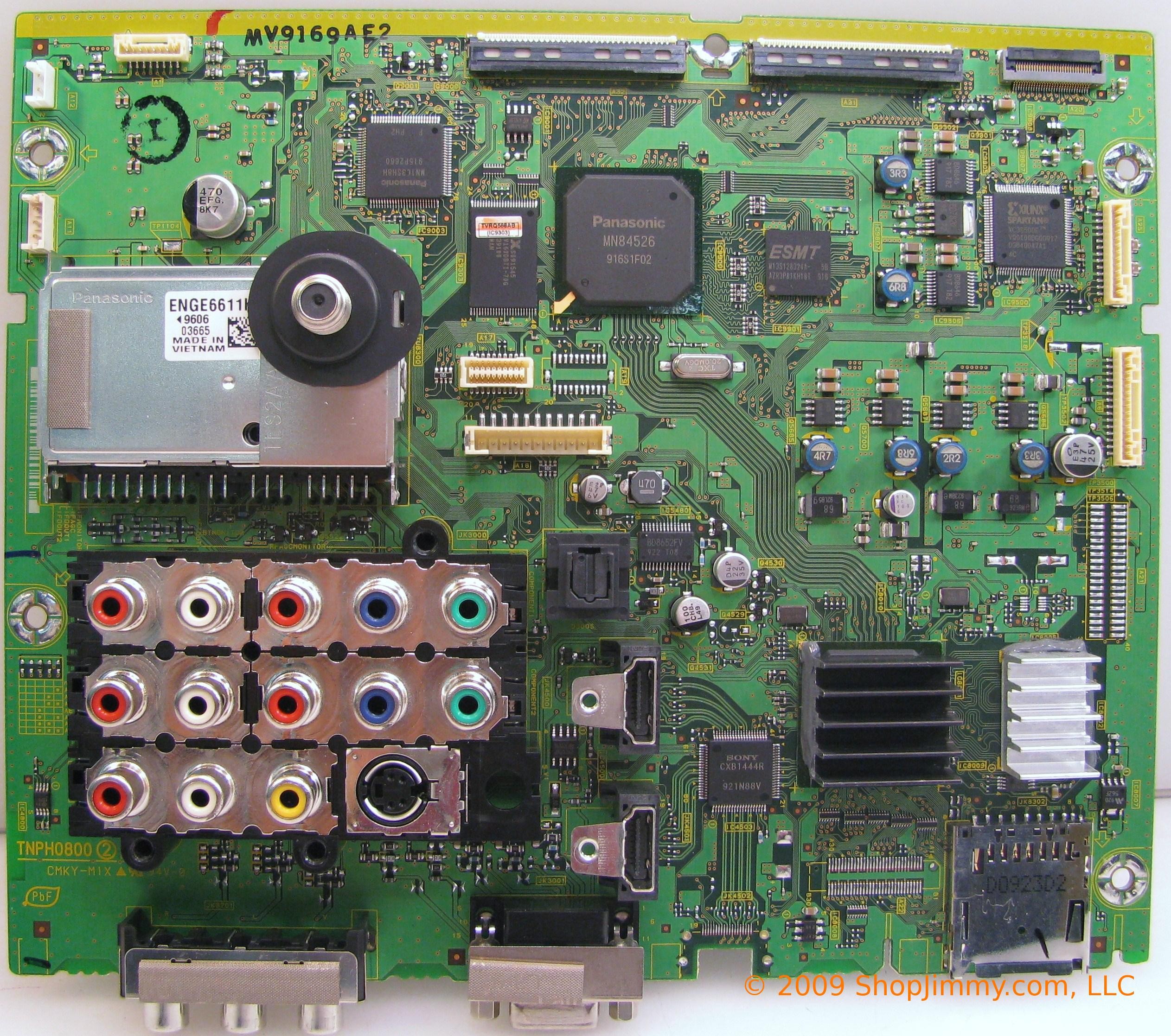

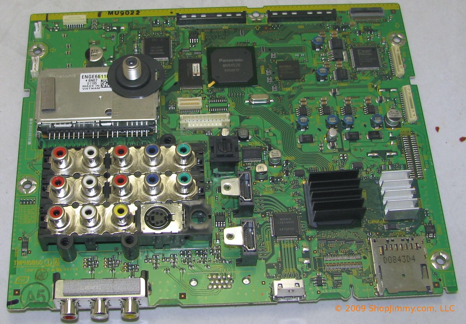

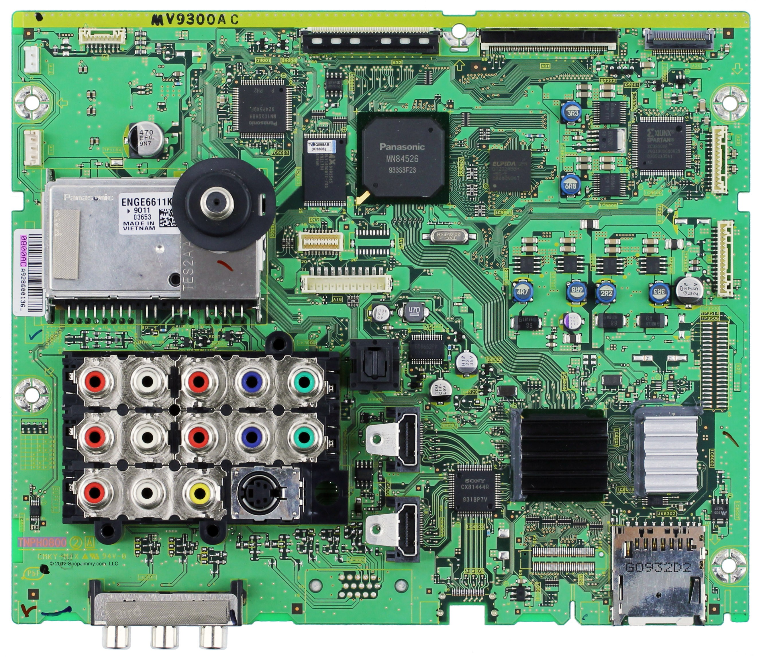

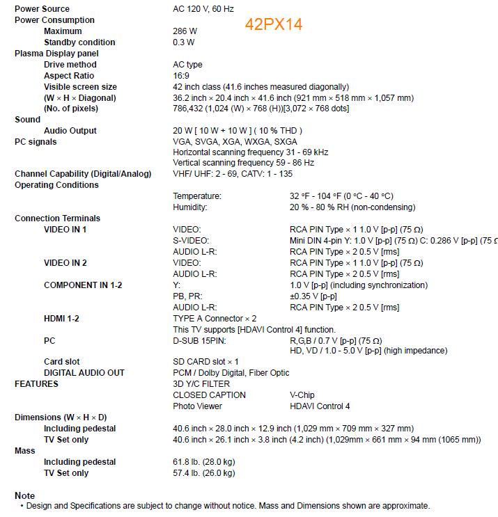

                  Re: Panasonic TC-P42X1 Plasma 12 Blinks
                  There's 2 other boards you'd get away with but you will lose the third HDMI port on the side. The PX14 has a PC D-SUB 15PIN, The rest should be the same. Maybe try and get the faceplate off whoever is selling the board if they have it.
                  TNPH0800, TNPH0800AC, TNPH0800AE
                  There was an Ebay list for repair but probably too late if the board is damaged.
                  42PX14
                  AE revision 42"

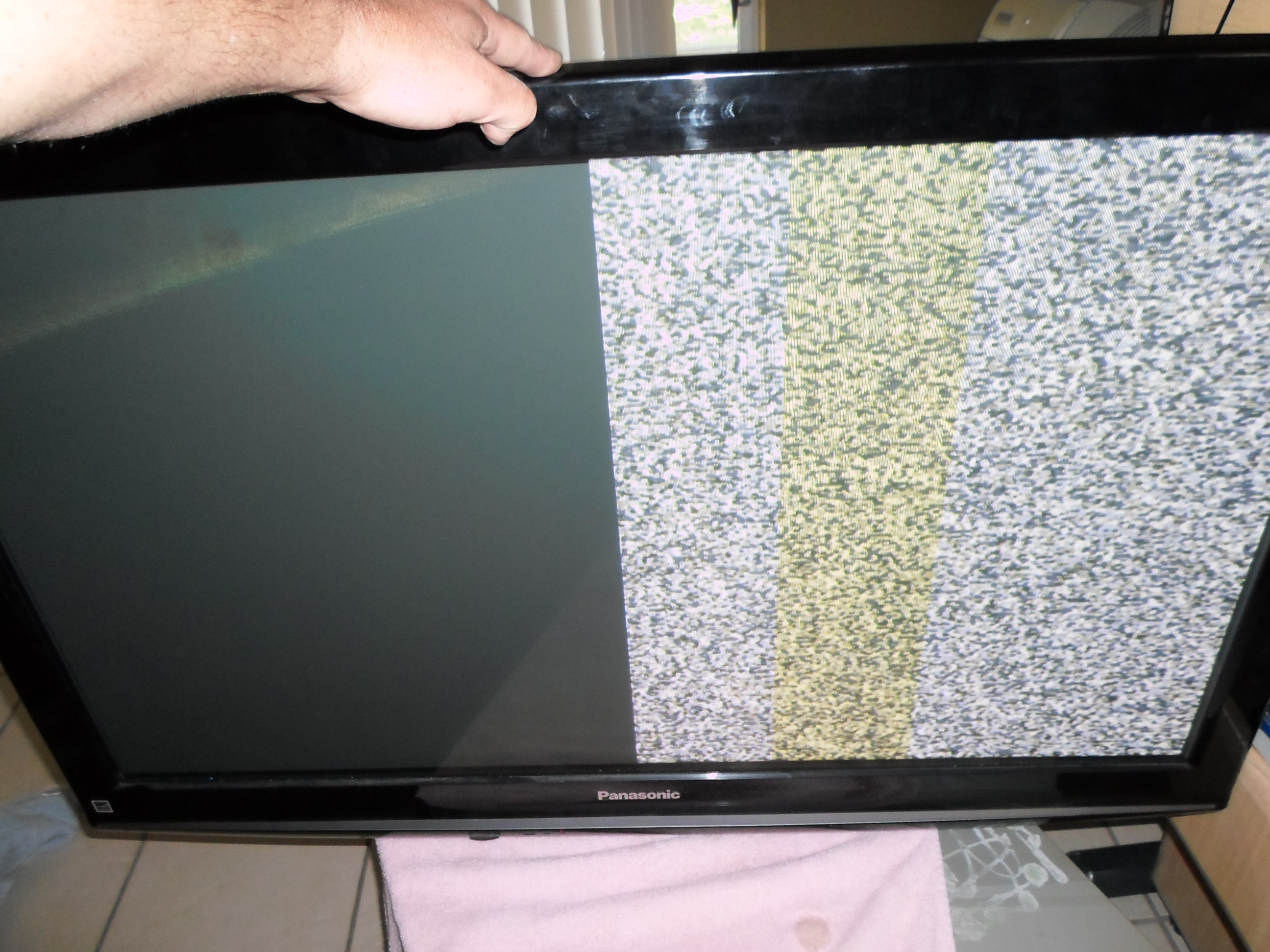

                            I had forgotten to plug connector P35 back in, now I get this
                            • kevinm34232
                              • May 2012
                              • 1884
                              #34
                              Unplugged to make sure cables were seated, now getting 7 blinks.
                                #35
                                I've had 7 blinks on a PZ80 caused by not an SC board fault but by a loose connector on the address boards (they run along the bottom edge of the plasma panel.) You may also get 5 blinks due to 5V DET failing (this can also be due to a bad panel shorting 5V though...)
                                The yellow bar would indicate to me you have at least one loose connector.

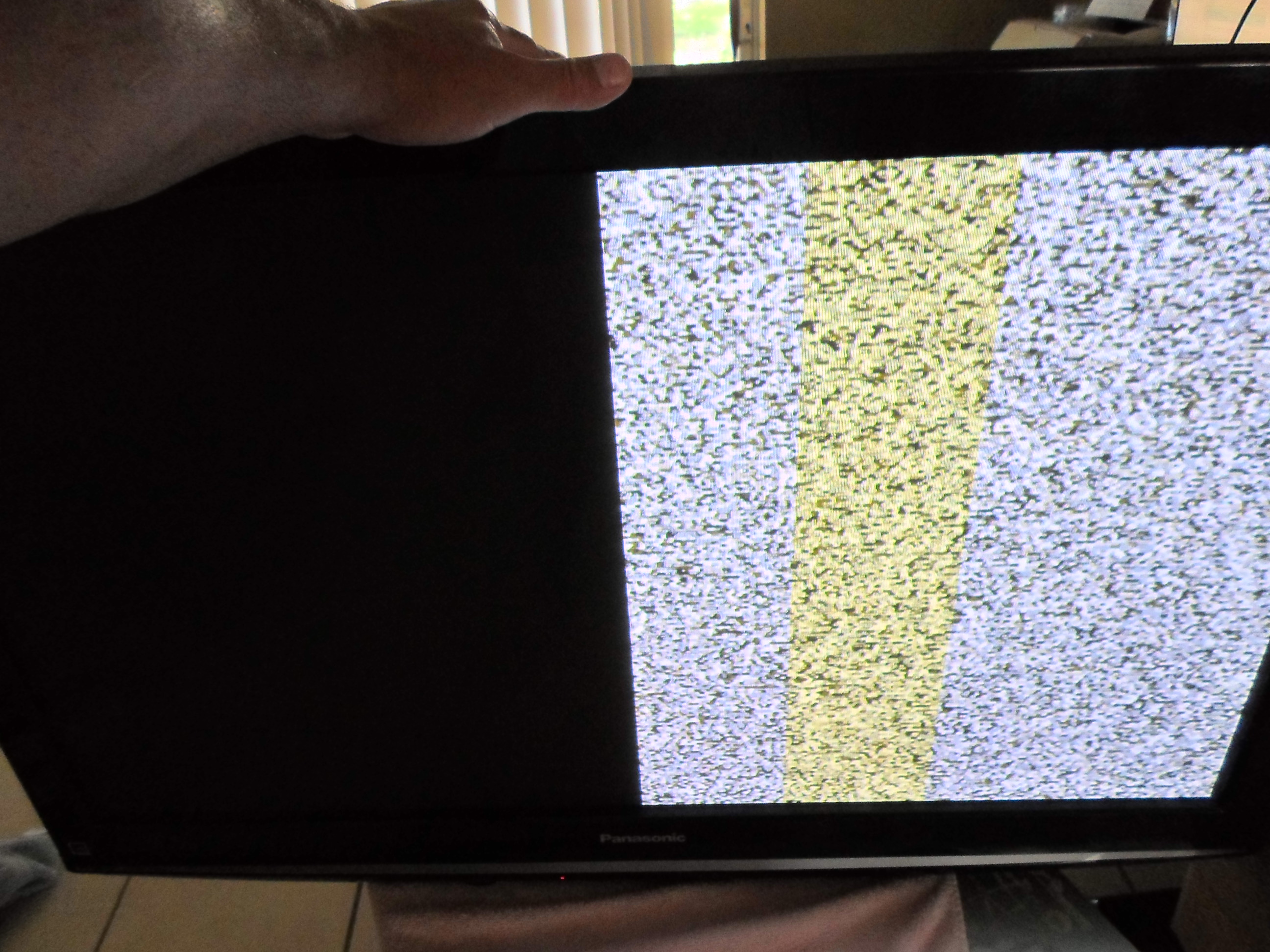

                                  #36
                                  I immediately thought bad panel when I saw half the screen missing and the yellow stripe, what do you think of that?
                                    #37
                                    I have had that with a loose connector on the PZ80s. It's very rare to get a completely dead half of a screen with a bad panel. Yellow bar is OK, if it can display something with no random lines in the bar. Statistically improbable to get every 2nd line to fail .
