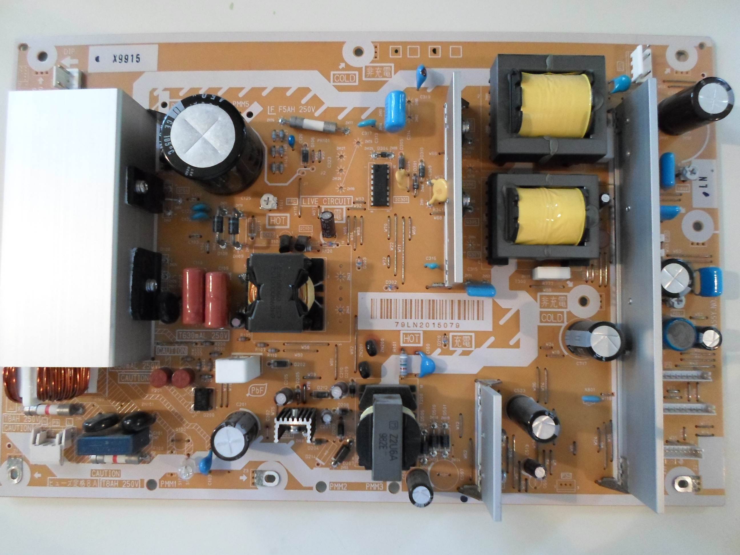

    Hey before I order new PS board can someone tell me how to isolate SC/SD/SU on this 2009 model too see if set stays on?

      I have the FSTB +15V but not the others, so how do I determine A Board or PS board, is there a PS-ON equivalent from the A Board that turns on the other 15V lines?

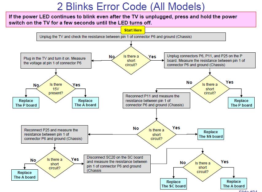

          Re: Panasonic TC-P42X1 Plasma 12 Blinks

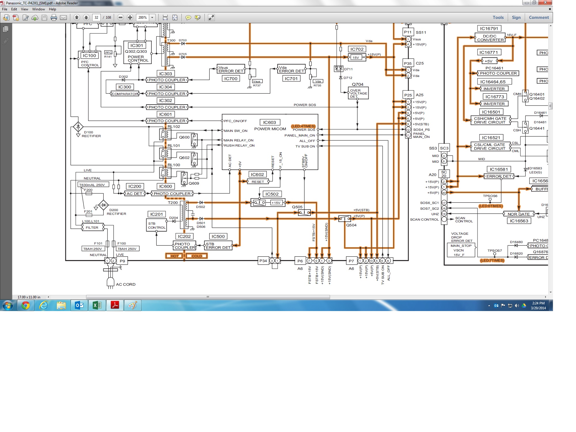

          here's some flowcharts.

            The 15VP and 15VAudio never comes up though, there is a FSTB+15V that comes up with the standby but I think the other 15V comes from somewhere else and is turned on later?
              They are MOSFET-switched from same 15V usually, so it could be a short on there is dragging FSTBY 15V down.

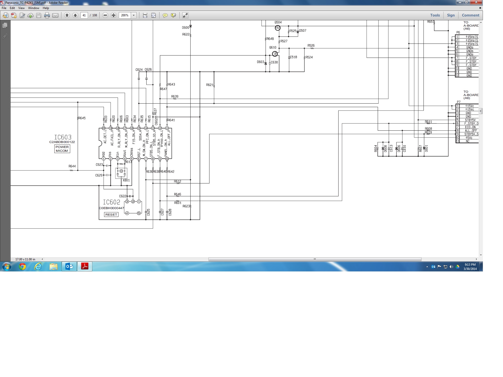

                On the flowchart it says check pin 1 on P6, which if you look at the pic below is +15V(SND). There is never any voltage there from plugging into AC to the blinking SOS.
                And that looks like it comes from D705 not where the FSTB+15V comes from right? So I wasn't sure if that had to be 'turned on' by the A board, because I basically get no voltages other than the 5 and 15 STBY.
                Oh another thing is I was not getting any voltage to VCC pin of IC301.

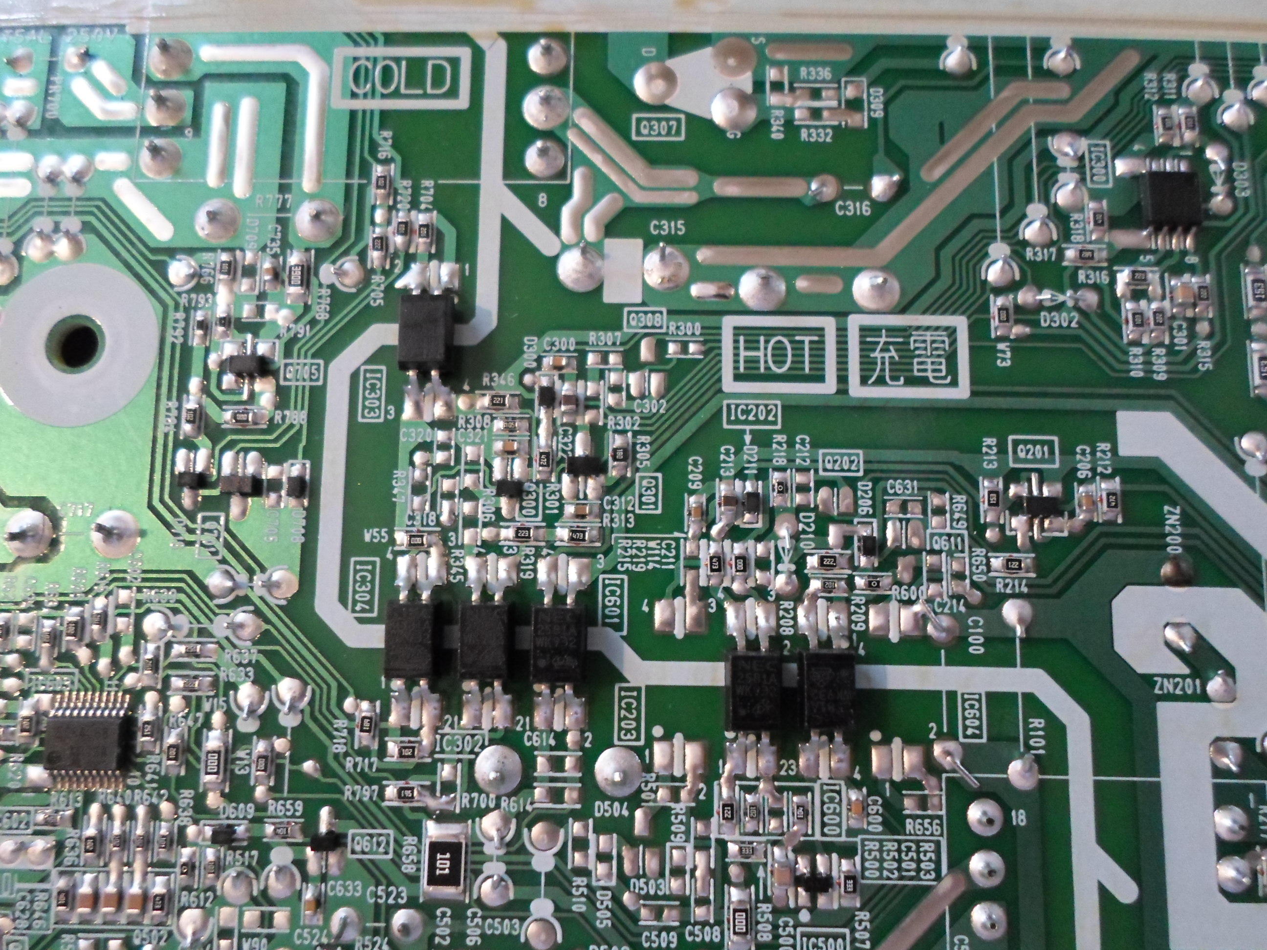

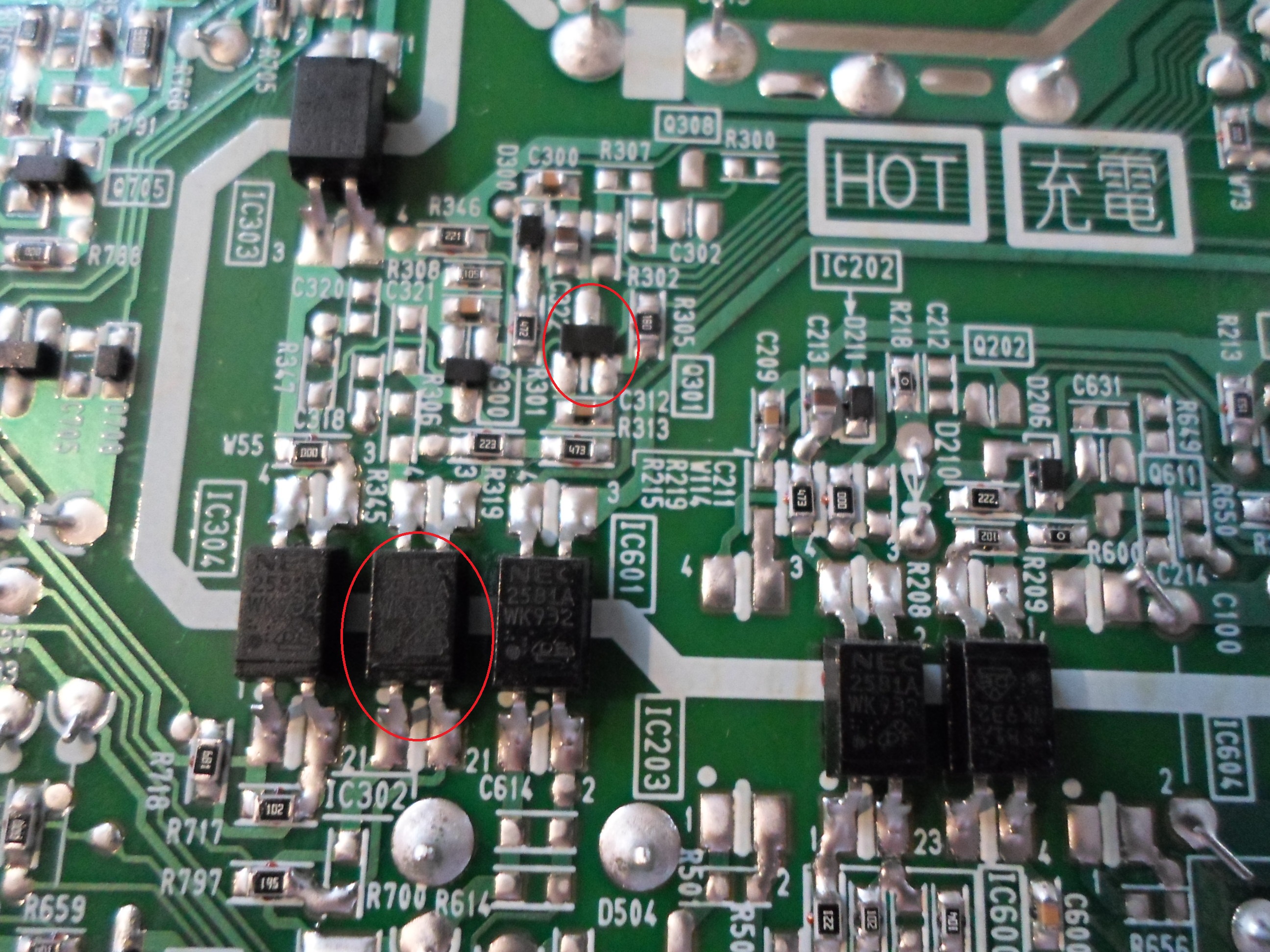

                  Can you see transistor Q301 on power board? What about IC302?
                  • kevinm34232
                    • May 2012
                    • 1884

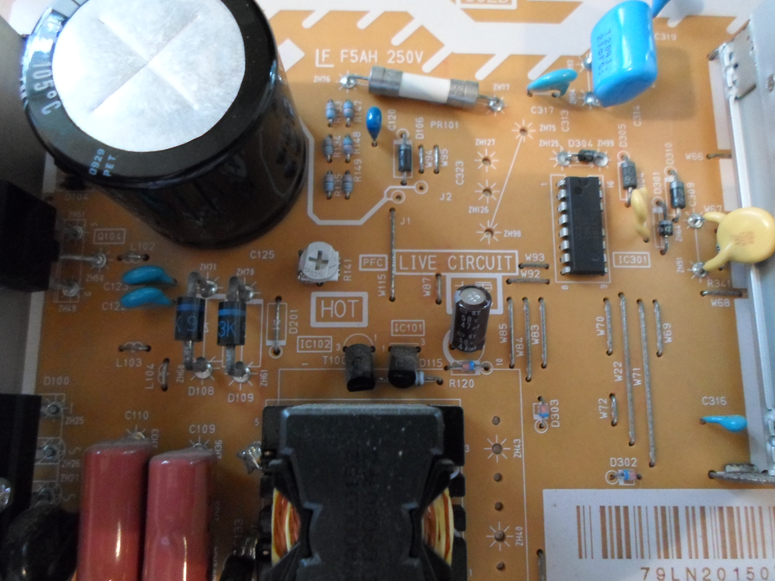

                    Yes here are some pics, those are on bottom of board.

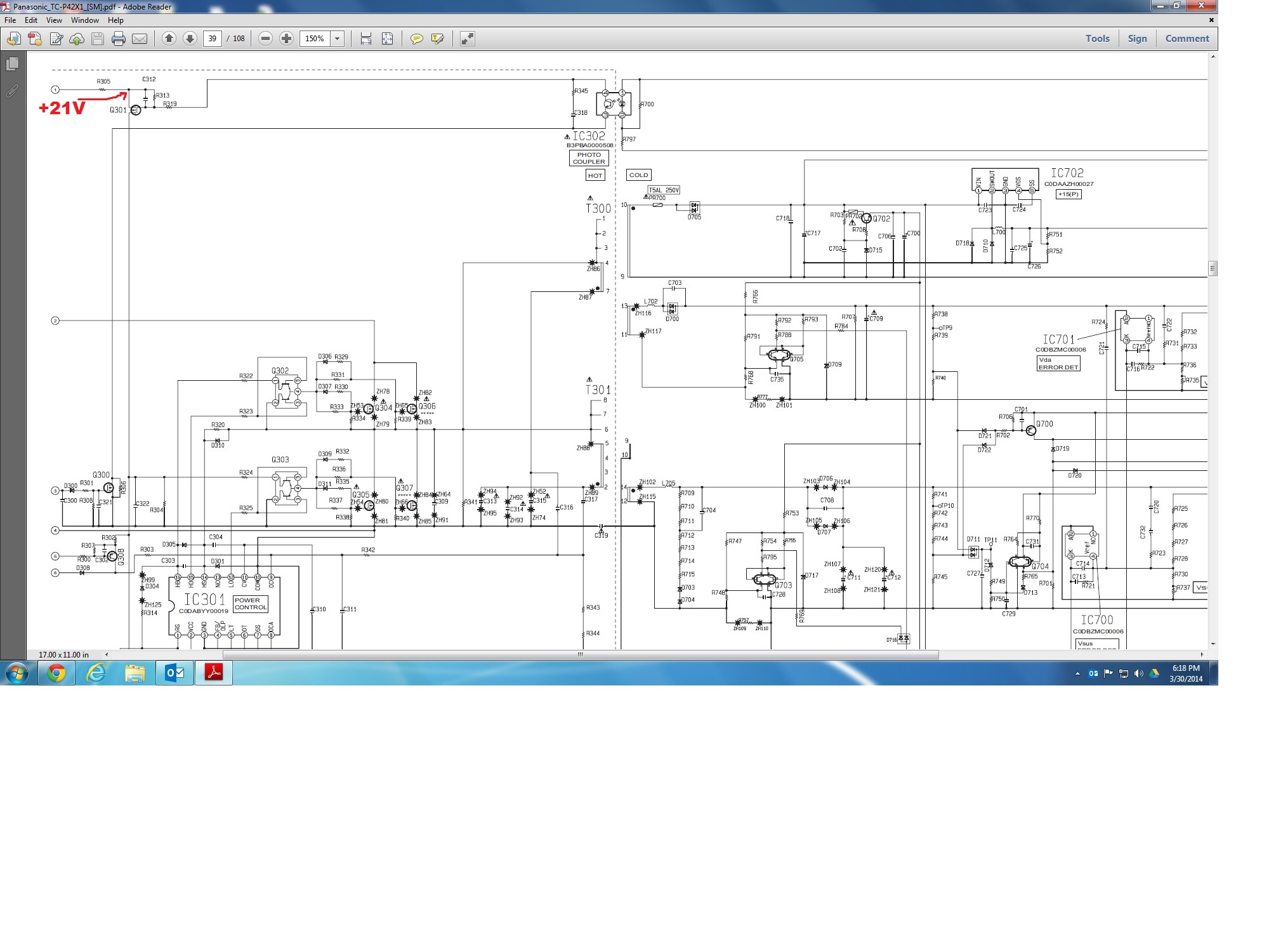

                    Last pic from SM, not sure if you were looking at it but I have the 21V from IC101 at the one leg of Q301
                      This is going to be awkward. Can you check the voltage across the primary side ("HOT" side) of IC302 as it turns on and switches to the blink code? It might work best to solder wires to the terminals and measure those.
                      • kevinm34232
                        • May 2012
                        • 1884
                        It's 21V. I have the board upside down on a towel with just the connections to the main board.
                        So basically I have 21V on those 2 pins of Q301, but 0v on the pin going to VCC of IC301.
                          IC302 is not being turned on, then. Check across the secondary, expecting near-zero. (<1V threshold.)

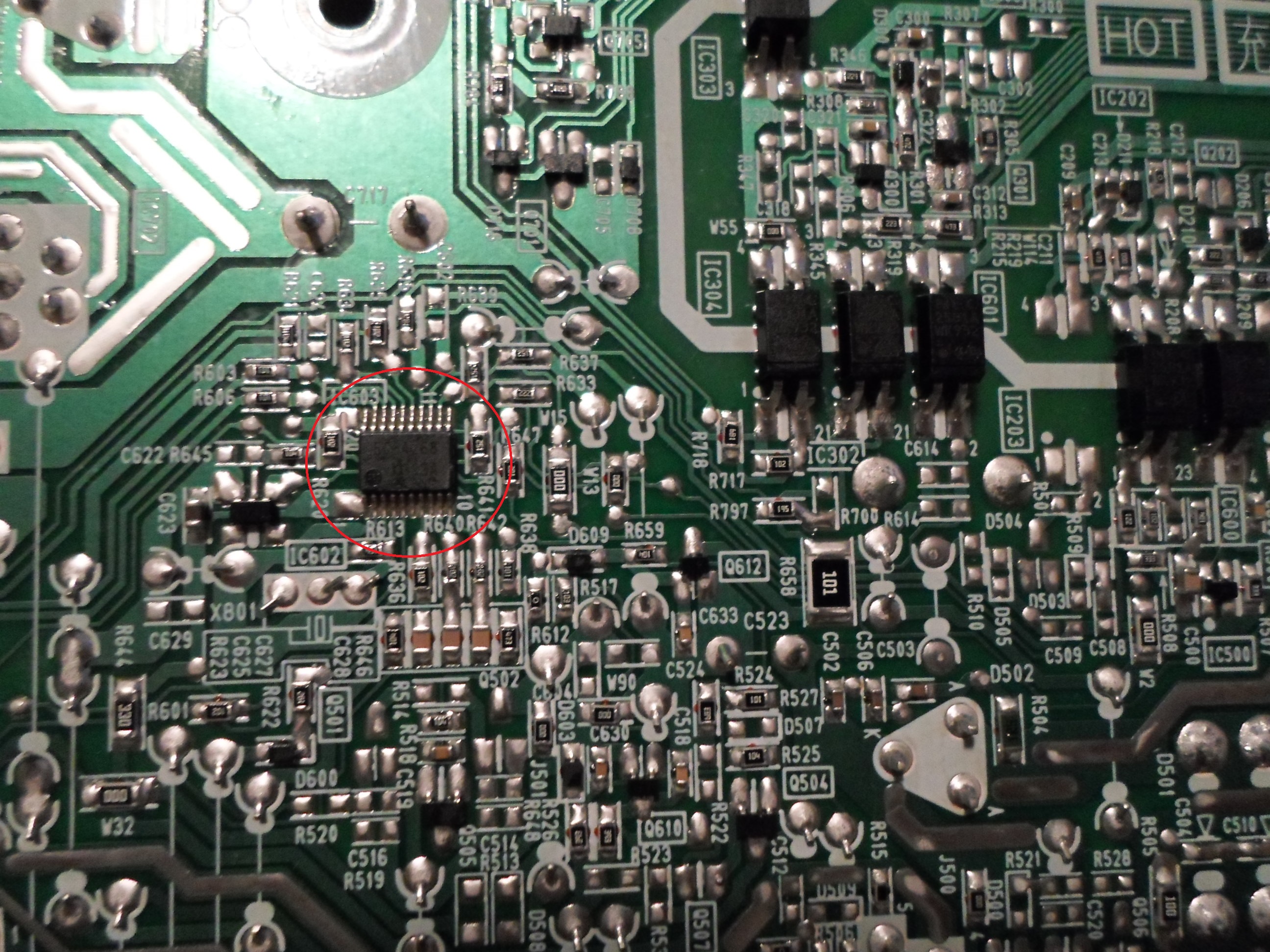

                            Yes 0.1V across secondary side. What would happen if IC302 was turning on, voltage would go low across HOT side?
                            I tried to trace, looks like that signal is coming from pin 12 of IC603 Power Micom (Vreso_ON_L)?
                              OK, on the secondary of IC302, check the voltage on each end with respect to ground.
                              If both ends are near 5V, the OPTO is not being commanded to turn on for some reason.
                                Yep both legs are around 5V when first plugged in, AND when switched on there is no change up to the 2 blinks...
                                So you think this is controlled by IC603?
                                Can we conclude yet going back to post 5, if there is no 15V at pin 1 of connector P6, that this is power supply issue and not an A board issue????
                                  So very first step, check resistance pin 1 P6, what happened there?
                                  This could be worth a go, disconnect SC2,SS11,P35,3 white ribbons at A and powerup.
                                    No short, and disconnecting all of those cables still gives 2 blinks.
