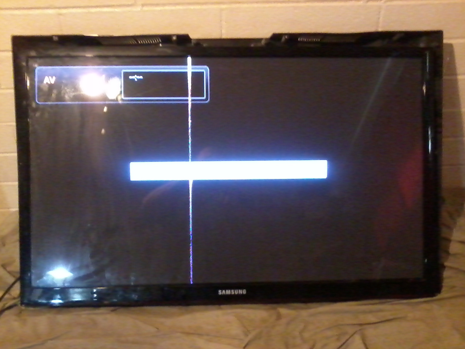

    Samsung Plasma PN43D490A1DXZA Vertical lines middle of the screen
    I've never run across this before. This TV had a shorted X SUS or X Main whatever ya wanna call it so I replaced it and the set powered up w lines in the screen... Any help greatly appreciated.

    Re: Samsung Plasma PN43D490A1DXZA Vertical lines middle of the screen
    here is the picture of the screen
      Well, I think it looks like the plasma display is bad. You can try to reseat those ribbon cables that you disconnected when you replaced the x main. They have to be just perfect. Change the aspect ratio of the screen from 16:9 to 4:3 and back again. If those lines didnt move, probably thaw plasma panel.
        Definitely a bad panel, crazy, another new, dead Samsung plasma.
