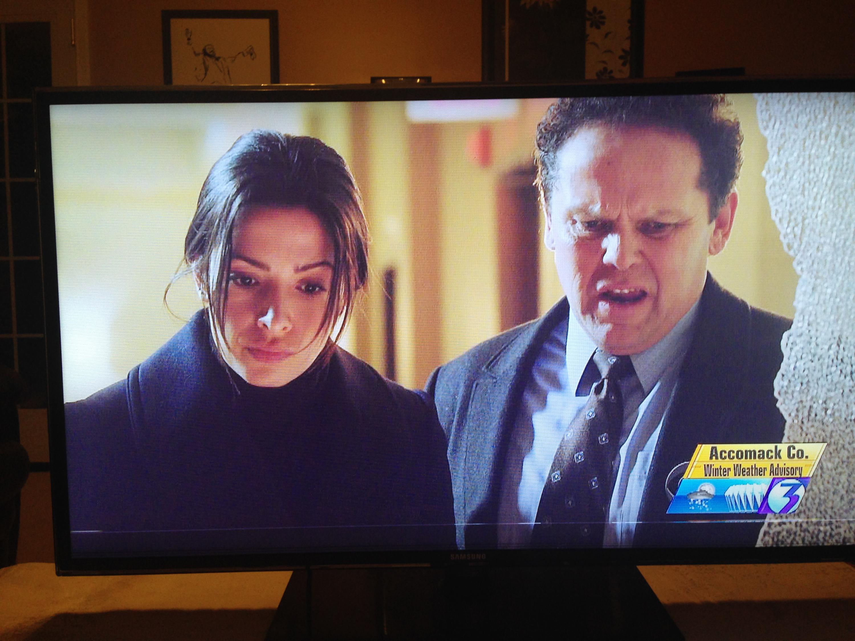

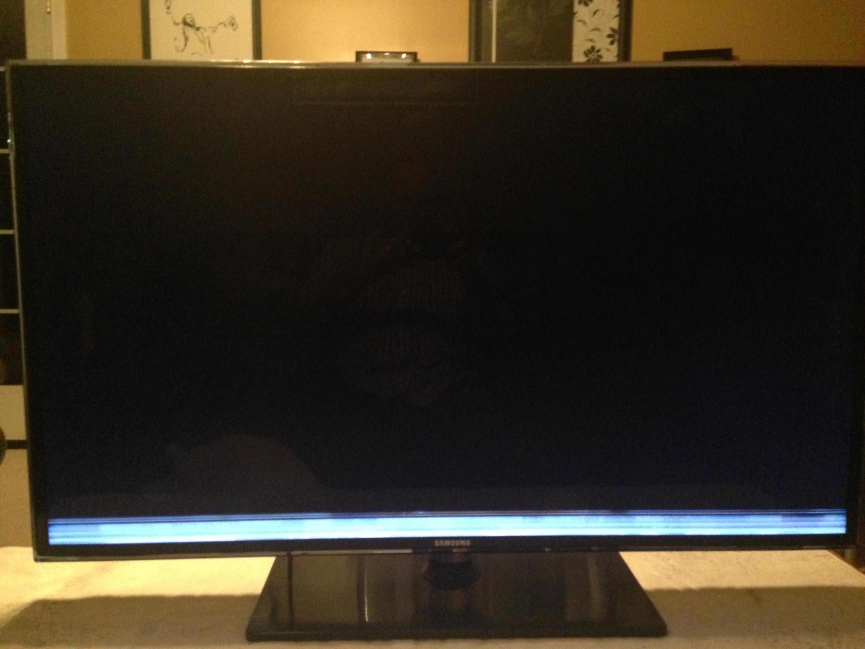

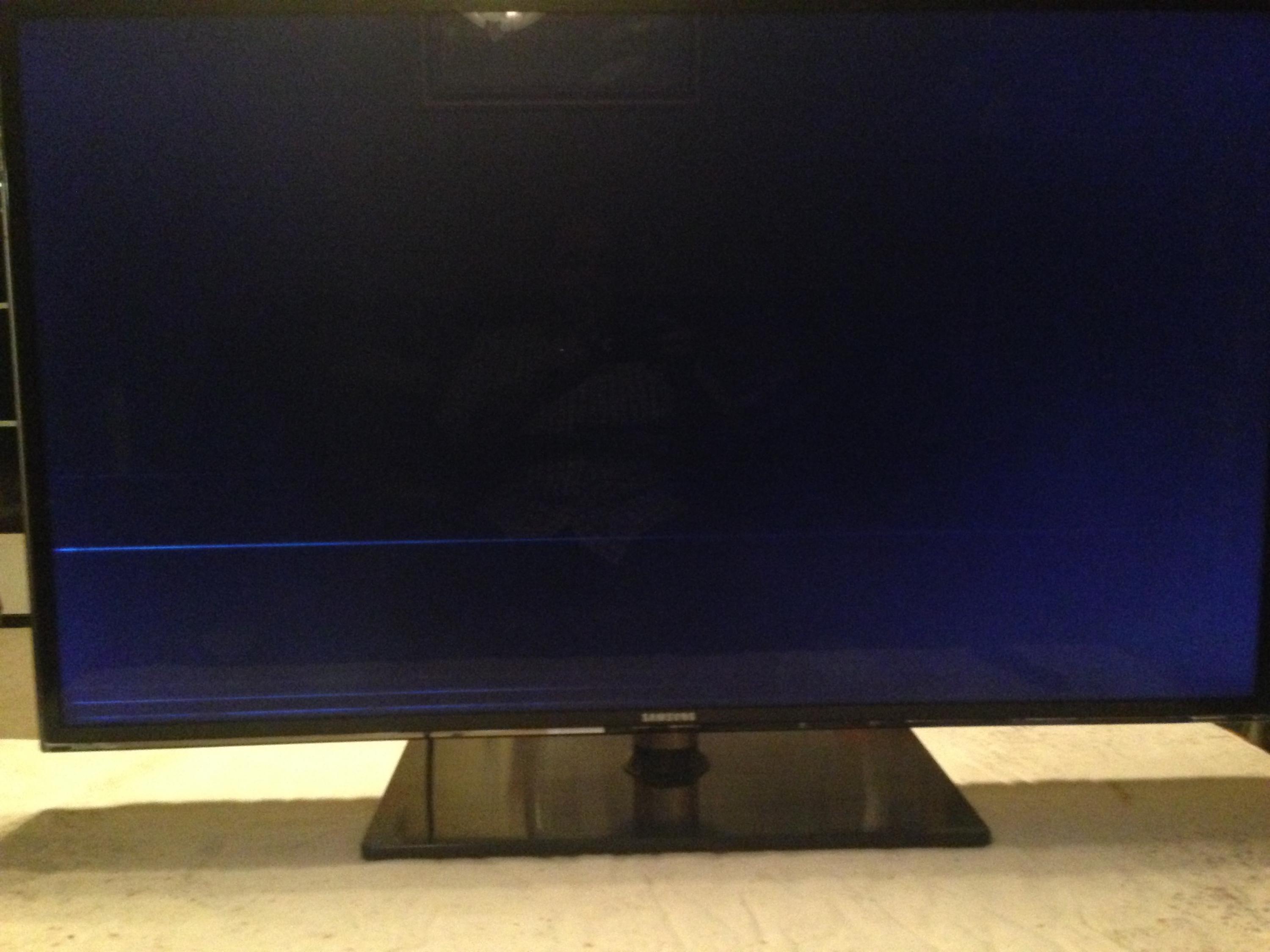

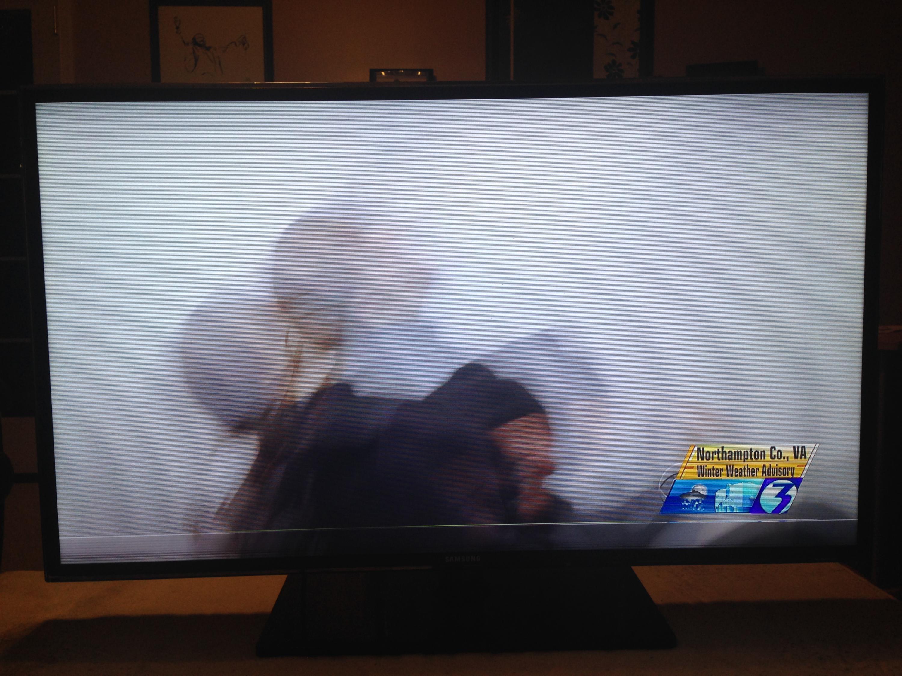

    Replaced the T-Con board on my 2-1/2 yr old Samsung UN46D6420UFXZA after screen went black. Installed the new T-Con and after 3 days, started seeing scan lines, ghost images, double images. Today, got black screen with horizontal lines at bottom. Recycled power and got more lines halfway up screen which then faded to black. Recycled power again and got full picture but picture is grainy. Thought my LED screen was bad but these symptoms make me think I got a bad replacement T-Con board. Can anyone help. Paid $1600 for this TV and really don't want to scrap it if it's just the T-Con board again. Could something else be cause the T-Con boards to fail? Pics of what I was seeing below.

    That looks like a bad LCD panel to me, not repairable unfortuntely. I've seen tons of these with the same fault popping up on eBay, terribly unreliable.

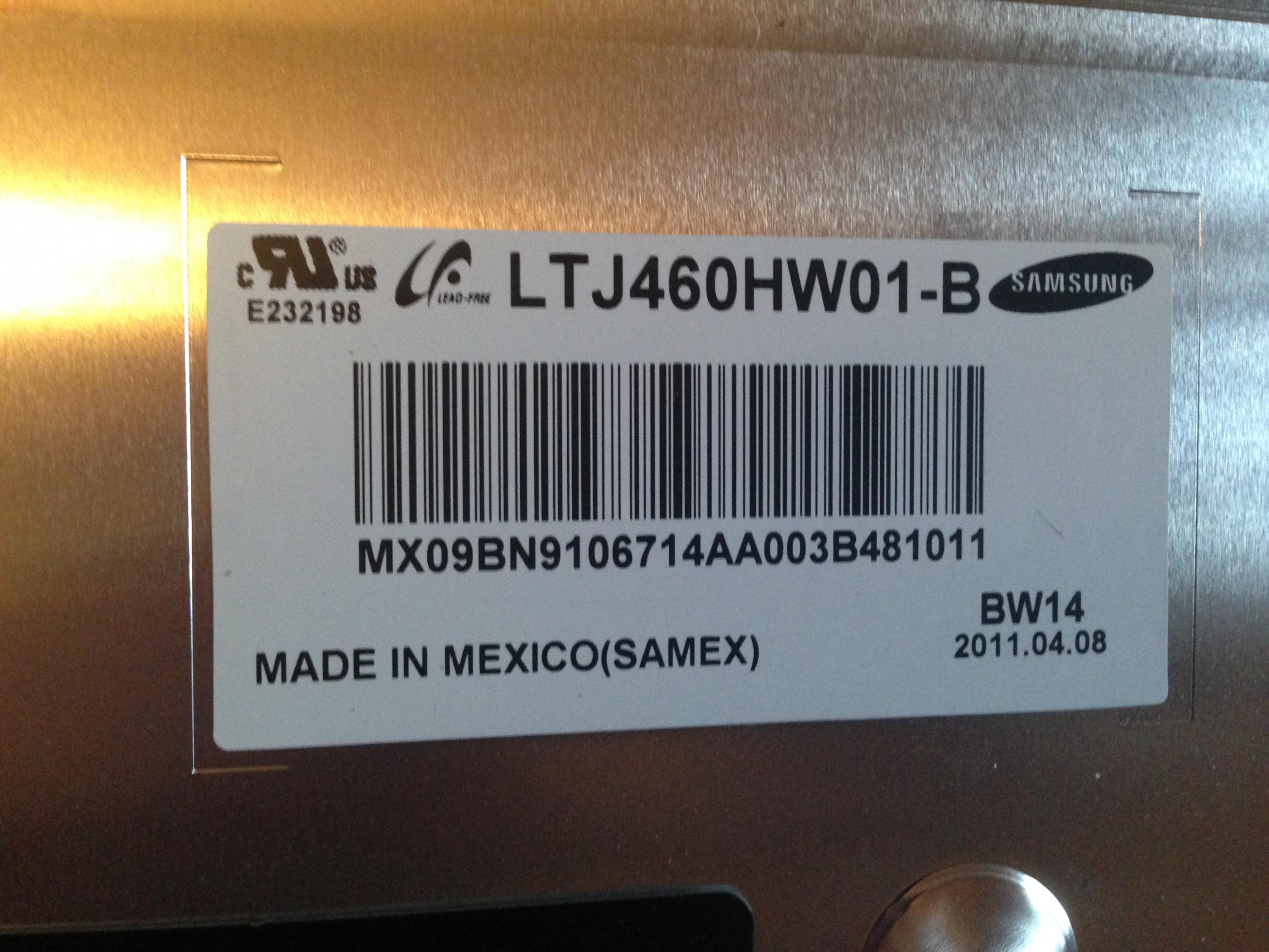

                My TV model is a UN46D6420UFXZA. The panel model is shown in the attached pic.
                I did spend a fair amount of time cleaning and checking connections and tab bonds. Didn't have any success eliminating a bad LCD panel vs a bad replacement T-Con board. I think I will try to exchange my T-Con board to eliminate that variable. I'm having a difficult time thinking my T-Con board and LCD Panel both failed at the same time.
                Exchanging the T-Con board only costs me shipping and if I'm lucky it will fix it. If it is the LCD panel, I'm no worse than I am now and I'll have to go look for a new unit before my wife comes back from Europe.

                          sad news. Thanks for the response. The fourth image from the post above is the most accurate depiction of my issue, although it gets worse with extended viewing time and will even begin to flicker (not certain if the flicker is related or not.) So does that mean that my best bet is still to replace the whole thing or are there reasonable self-repair options?
