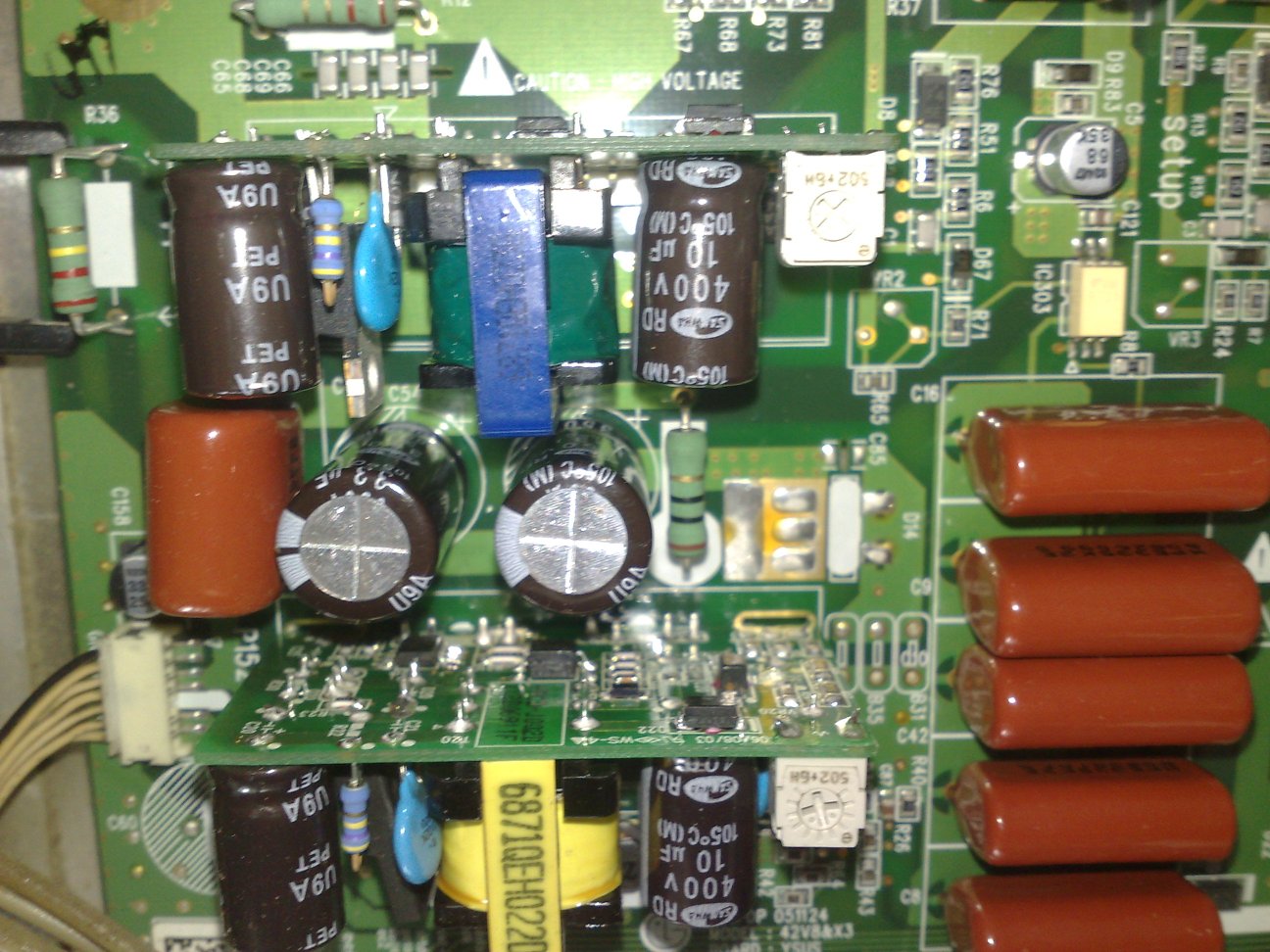

    Today i removed the flat cable that goes from the YSUS to the Control board and now i get proper -180V -Vy and the YSUS does not make the weird regular buzzing. Could this be a control board issue? Maybe it's not sending the right signals to start the YSUS?
    The control board temperature LEDs do not light up with the flat cable removed so i'm assuming it's powered by 5V from the YSUS.
    I recorded the sound it makes and the varying -Vy voltage measured accross R36:
    https://www.youtube.com/watch?v=oy7bYYbWvVM
    Hope you can hear it, youtube compression dulled the audio a little.
    I think the noise comes from one of the little transformers on either the "setup" or "setdn" daughterboards but i can't tell wich one (the blue and yellow ones in the attached picture).

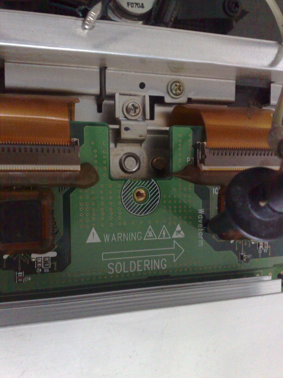

          @charles frost I checked the buffers board (there is only one large board with 6 buffer ICs in this TV) and there are no shorts between the input and output pins and the inputs (two of them, one for 3 buffer chips) show up as diodes like i read on the forums that they should.
          I also put a scope on the pin labeled "waveform" on the buffer board and this is what it shows when the tv powers up:
          https://www.youtube.com/watch?v=Su8TgXIwdhY

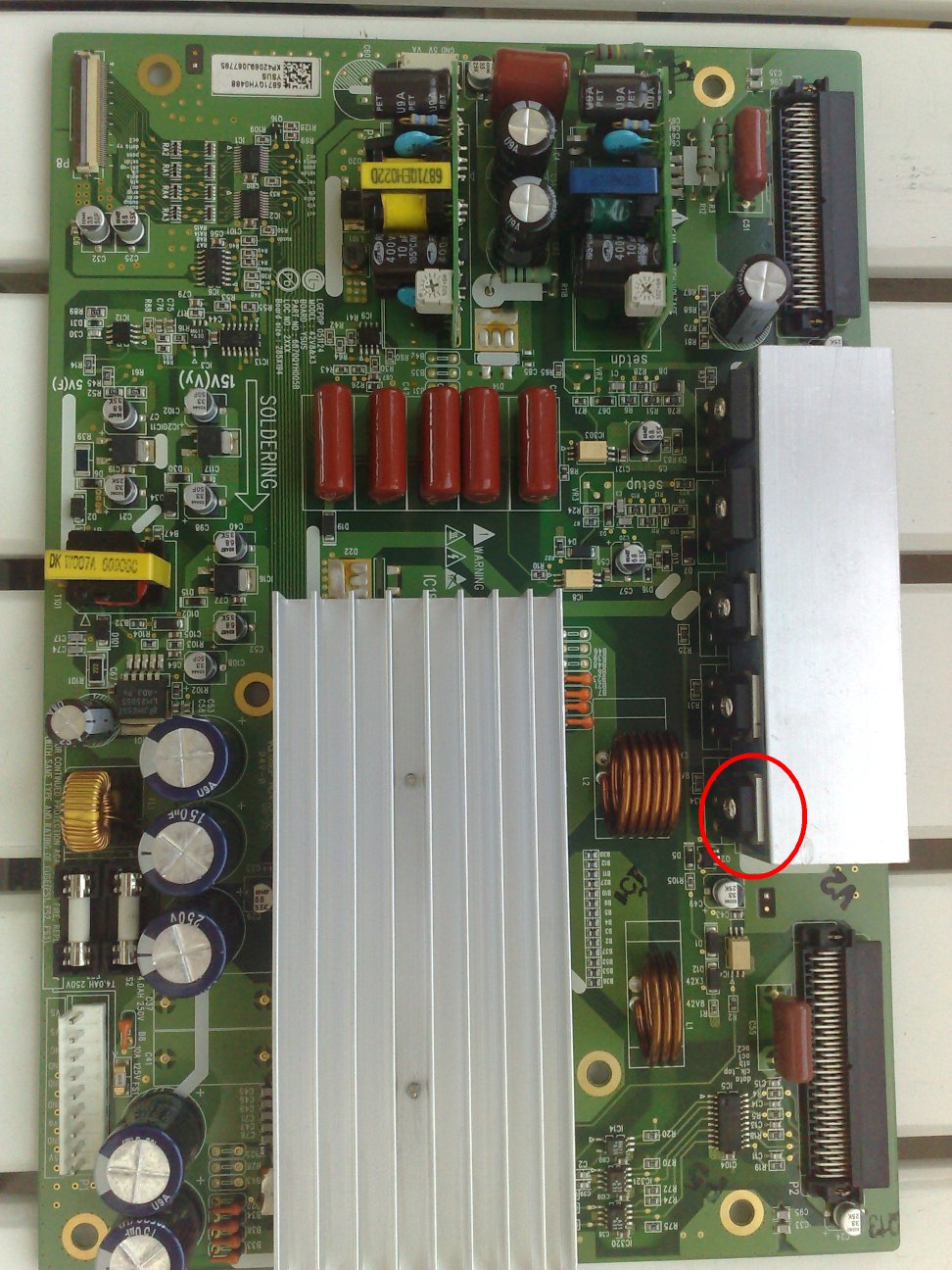

            Re: LG 42PC1RV - Powers up, sound ok but no picture
            Hello again!
            I had some extra time over the weekend and i did some further research and tracing of the Y-SUS. Turns out the two daugtherboards are the power supplies in charge of generating -Vy and Vsc and they take power directly from the Vs line. The left one (blue transformer) is for Vsc (even though the resistor across which we measure -Vy is right below it) and the one with the yellow transformer is for -Vy. The yellow one was buzzing. So since they are powered by Vs and that voltage was nice and stable, i concluded that te problem must be something shorted on the output of the -Vy module. I traced the problem down to one of the MOSFETs on the smaller heatsink. There were 3 of them in parallel that showed some strange readouts on the meter so i removed them for proper testing. The defective transistor was not shorted but showed a weird small resistance across two of it's pins. I've attached a picture of the culprit.
            I bought a replacement and now the TV came to life and works great. Good picture too! The panel seems to have some life left in it despite the age of the TV.
            Thanks for helping!
            Regards,
            Andy.
