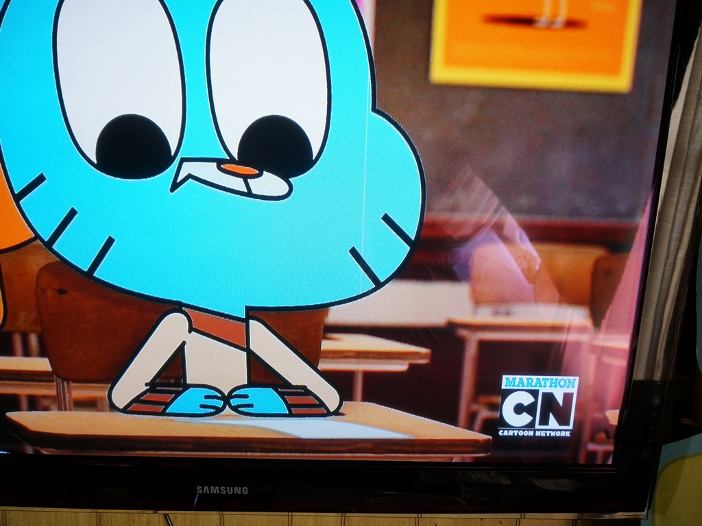

    Help please, I am new here and just came across this sight researching Samsung Plasmas and lines. There seems to be quite a number of threads but, most deal with horizontal lines or moving vertical lines. What I am trying to figure out is if this is a bad panel or if it is fixable. Hopefully you can see the line going down the cartoon characters left cheek. This occurred out of the blue. As far as I know the TV has not been physically damaged.
    Re: Samsung PN50B650S1FXZA vertical line on right
    Sorry, bad plasma panel, not repairable (without replacing the entire screen.) Pretty common on Samsung plasmas - a friend of mine had a B630 I think with a red vertical line.

      That sucks,
      I guess I will have to harass Samsung and see what they do.
