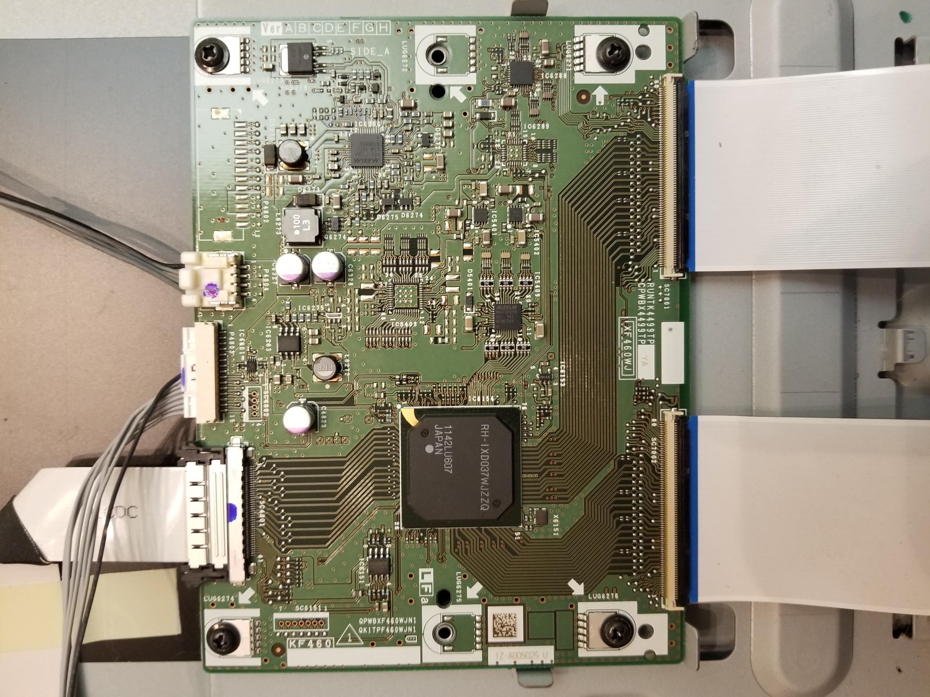

              disconnect one of the cables going from the tcon to the panel. Try turning on the tv. What happens? Do the same test with other cable.

                Just tried that and nothing changes, when I turn on power it takes maybe 2 or 3 seconds then the clicking noise comes from power supply board and the led code flashes power led flashes twice and opc led flashes 5 times

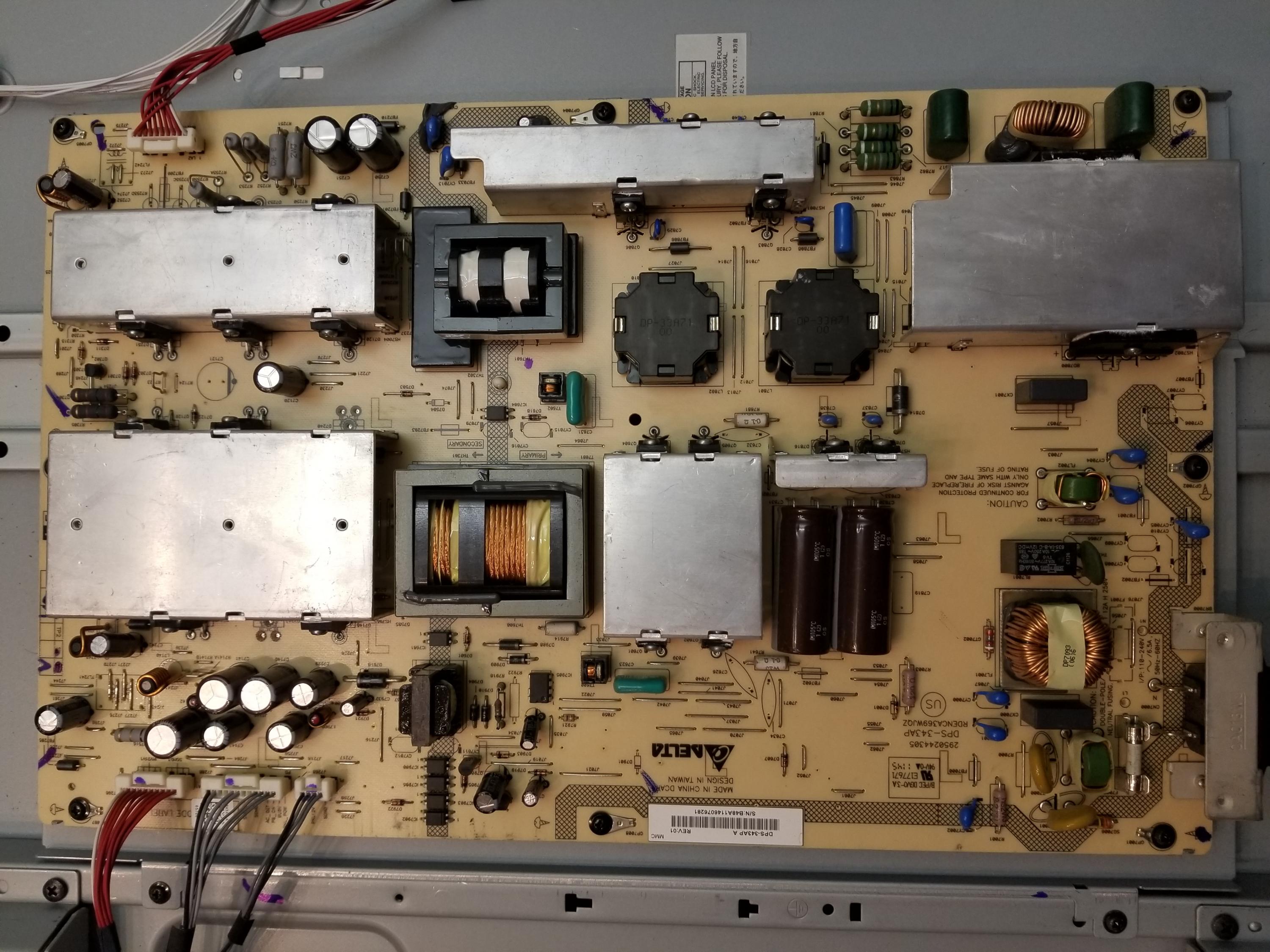

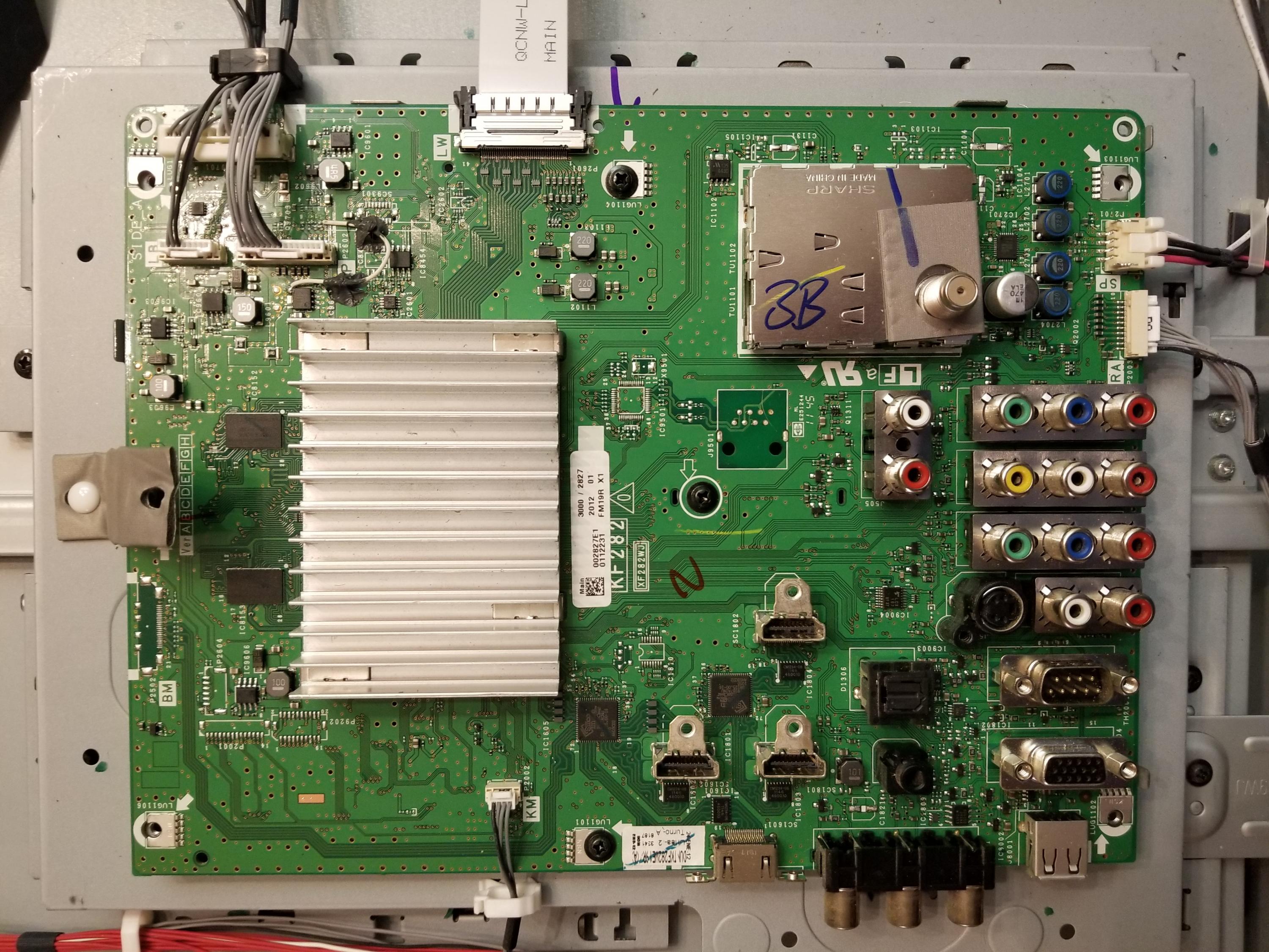

                  Need good clear straight on pictures of back of tv with cover off and each board.

                    Ok thanks, I will go take some real quick

                      Here are the boards minus the lcd driver boards

                        Sorry thought I attached them on last message, I new to this wonderful forum

                          I just did the hard reset again by plugging in AC while holding the vol down and input button, once again all the backlights come on but nothing else will work. No way to access menu or change input. In this state is does allow all the proper voltages to hold on the psb. I do notice a small blinking red light on the main board. The light flashes next to RDA8001, not sure if that is normal.
