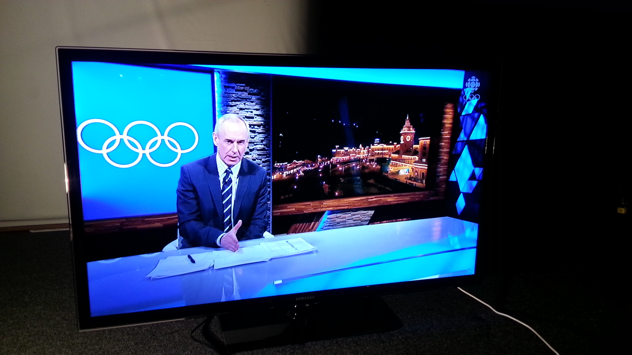

              Ok so when I was watching it this morning, the shading suddenly went away, but after about 10min or so it came back again is this still sign of a bad led? I'm not really repair savvy but I'm good at following directions
                Re: Samsung LCD led un55d6000 won't turn on
                Sounds like an intermittent LED or connection. A picture of the fault could help us.
                  Since the top and bottom halves of the strips are run in parallel an intermittent led or connection as tom suggests would cause the symptom you are seeing. I will post a pic of what mine looked like in the next post...
                    #29
                    Similar to this ? Notice the lower left portion of the screen and the downward diagonal "shading".
                      #30
                      Yes!! Exactly like that, did you manage to fix it??
