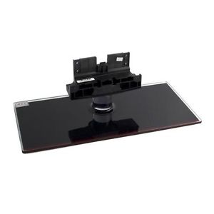

            Ok so I'm getting the tcon board repaired but I also need the stand attachment in the picture I've uploaded I already have the glass stand but just need the housing, anyone have this I could buy of them or know of anywhere I can purchase this ?

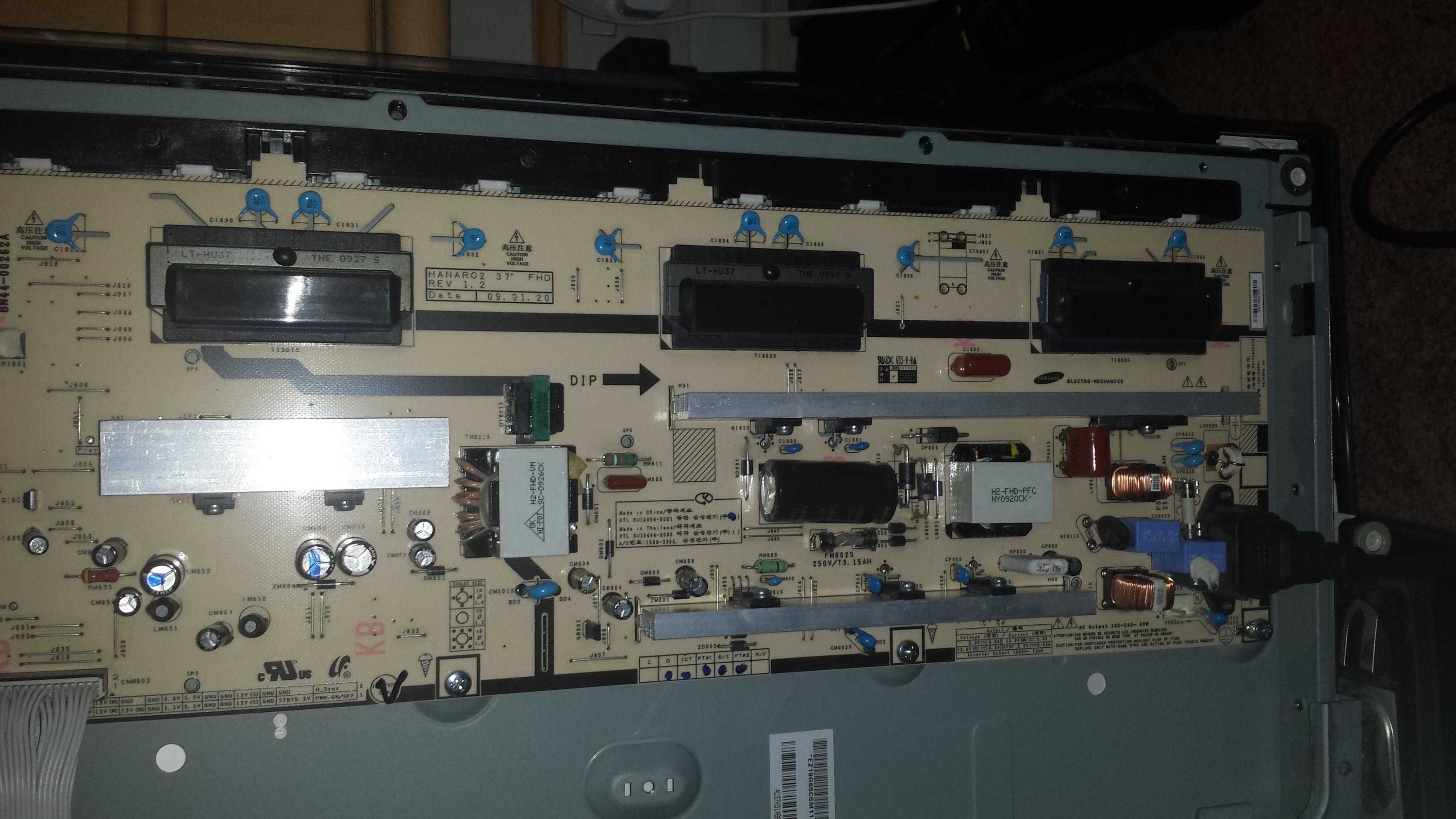

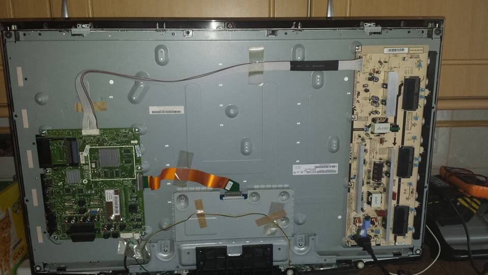

              Ok the tv run for a week but went off yesterday seems to be totally dead now I've not checked the voltages due to being a work, originally I sent the tcon off for repair could the tcon cause this ? I'll be checking more in the morning
                Re: Samsung le37b651
                A shorted t-con would cause the TV to be stuck in standby, but it wouldn't cause absolutely no power - that would be power board or main board IMO.
                • sordids999
                  • May 2013
                  • 2161
                  • uk
                  Ok found the 3.15 amp fuse has blown changed it still totally dead no voltages

                              ok disabled the main board from the psu and it still blew a fuse,psu number is BN44-00262A
                              thanks
                                Close pic of power board? And BN44 number?
                                  You can get the SCH from Tom website.
                                  http://www.tgohome.com/ServiceManual...&Search=Submit
                                  That fuse is for feeding the Voltage to the standby power supply and the inverter circuits, so you have shorted circuit some where.
                                    Bn44-00262a
                                      Remove that fuse FM802S, see if the main one still pops? Maybe consider building a lamp test jig
                                      http://s807.photobucket.com/user/bud...01682.jpg.html
                                      This will stop you popping new fuses...
