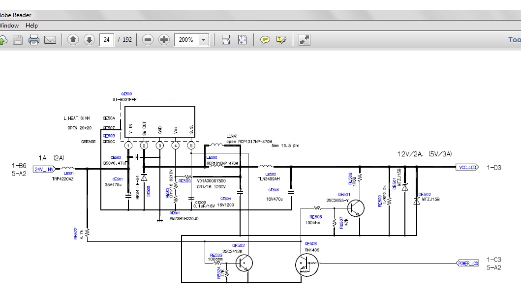

    but on the low_b (second power board) there is an output to the AV board to power the LDVS board (should be 12v according to schematic diag) this doesn't give me any reading at the connector but the switching part of the circuit is getting 24v on its input pin 1 (this is a little daughter board standing vertical off the low_b board) and giving out 24v on pin 2 like the diagram shows but nothing after that,

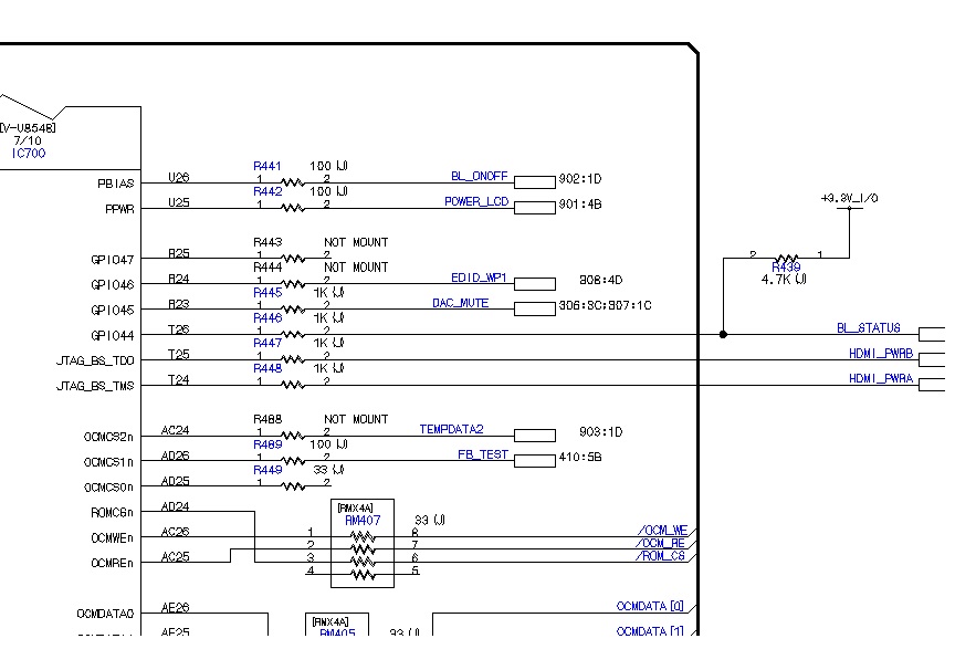

    on the same switching circuit there is a Power_lcd input back from the AV board that comes from the ocm memory chip right back in the the circuit
    I just cant work out if the 12v should be on and the power_lcd is the (im ok signal) or if its the (wake up signal) ether way this has no voltage at any time on there
    this is the manual, starts at the mem chip on page 50 and goes via these 65-28-23-27&24 are where I've traced the Power_lcd back to the low_b VCC_LCD switch daughter board
    I did notice the protect circuit stays at 2.8v once power button is pressed/power relay is on, also tv doesn't turn it's self off if the cable from the av board to the LVDS board is unplugged

        Mr_Bodgit can you tell me what was the problem with the 12V line?
        My TV has the exact same problem...no VCC_LCD voltage, the regulator does not start due to no signal from the POWER_LCD input and the POWER_PROTECT line stays at 2.8V.

          'POWER_LCD' is command signal generated by the Main board.

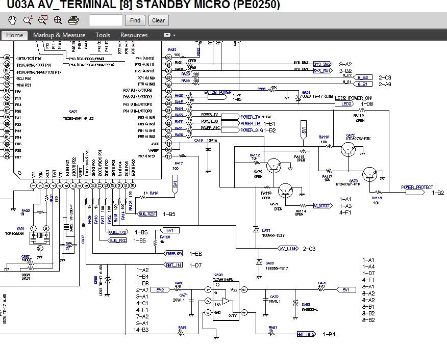

            I have the service manual...the signal comes from OCS memory. The 2.8V POWER PROTECT comes from the ST_BY CPU. I`m not sure what triggers that POWER PROTECT, that is why i`m asking you help, maybe you remember what was the problem.
            Thank you
              Re: toshiba 37x3030D power up issue
              POWER PROTECT and the AC DET are the signals should be generated by the power supply board to feed the processor through those transistors.
