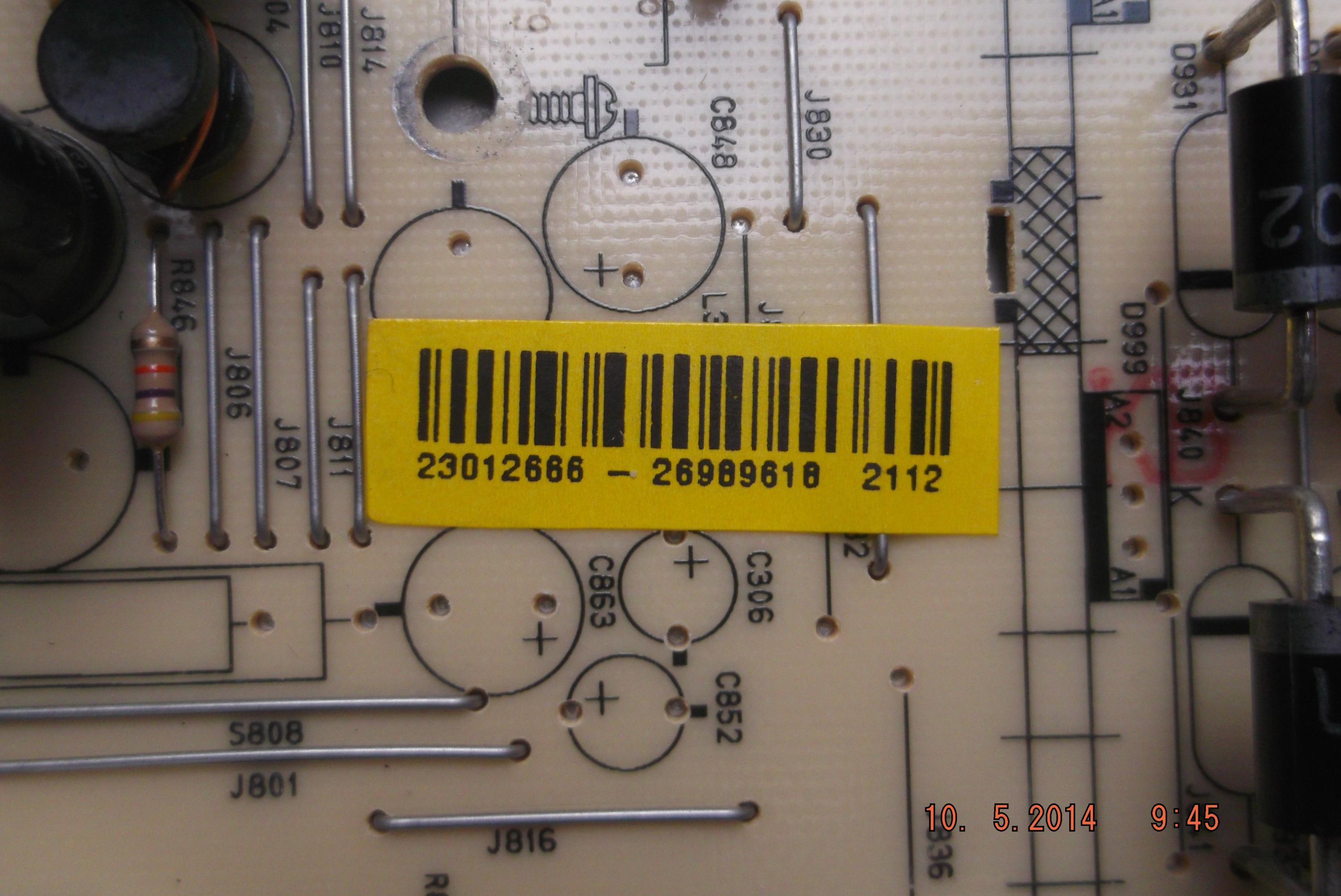

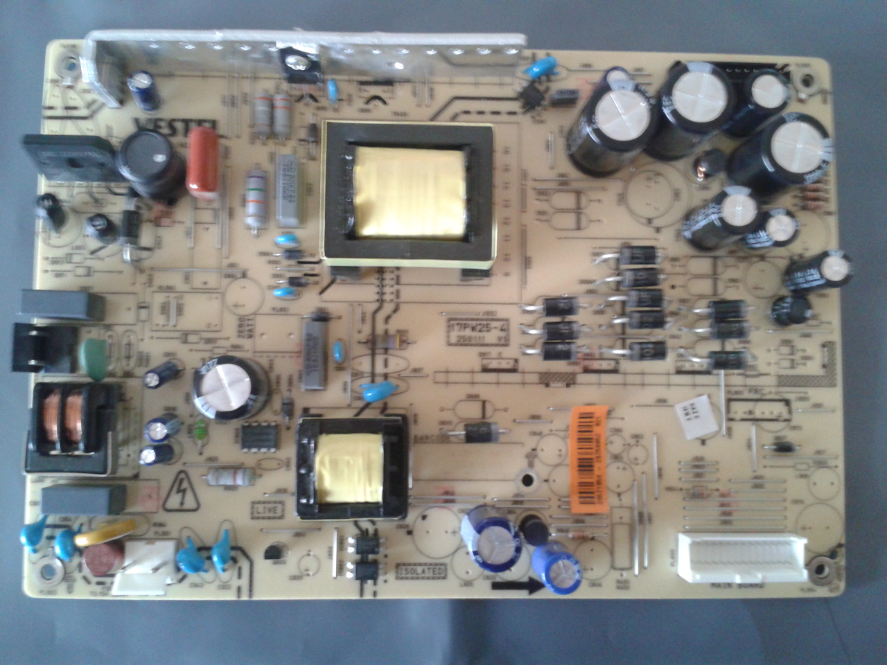

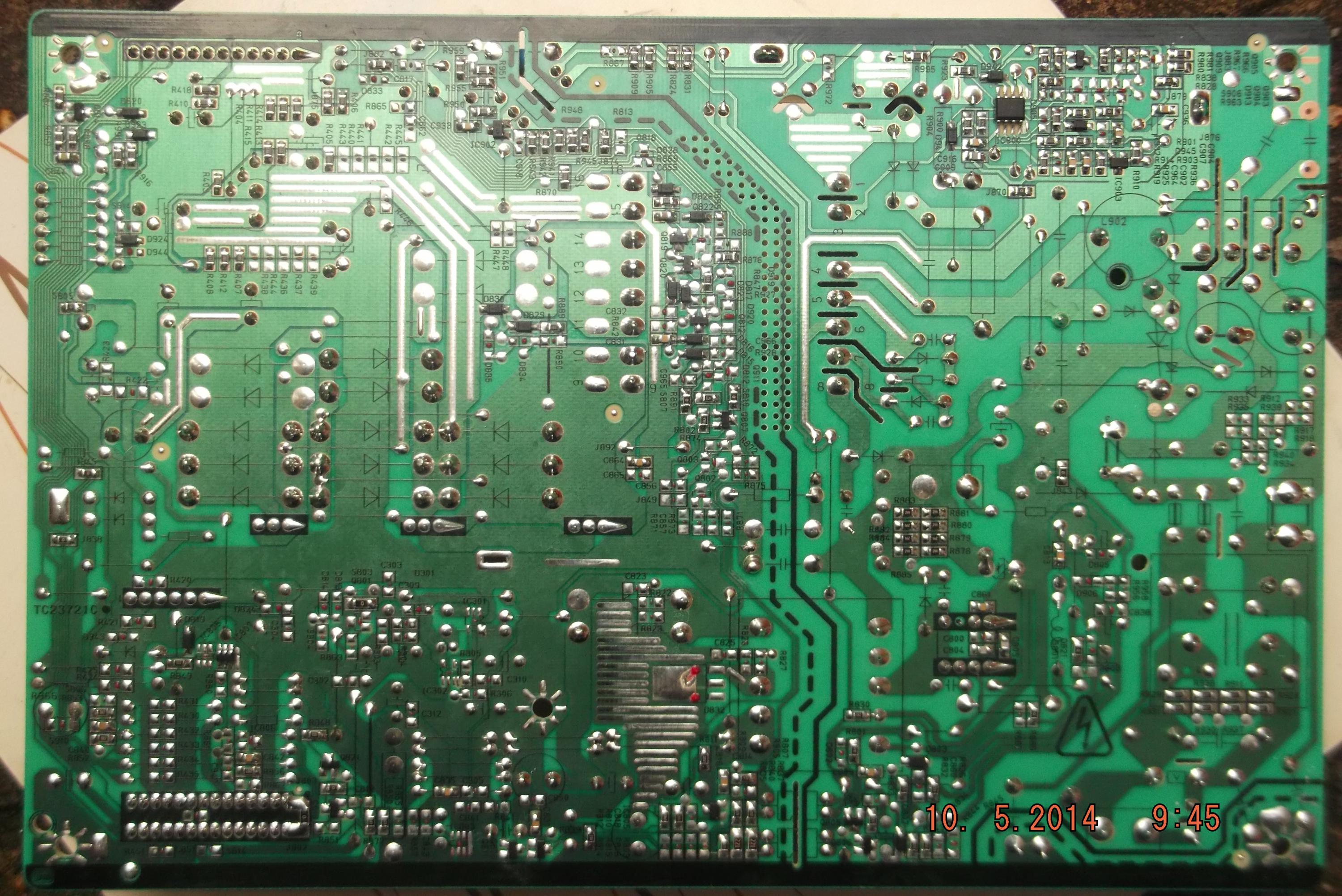

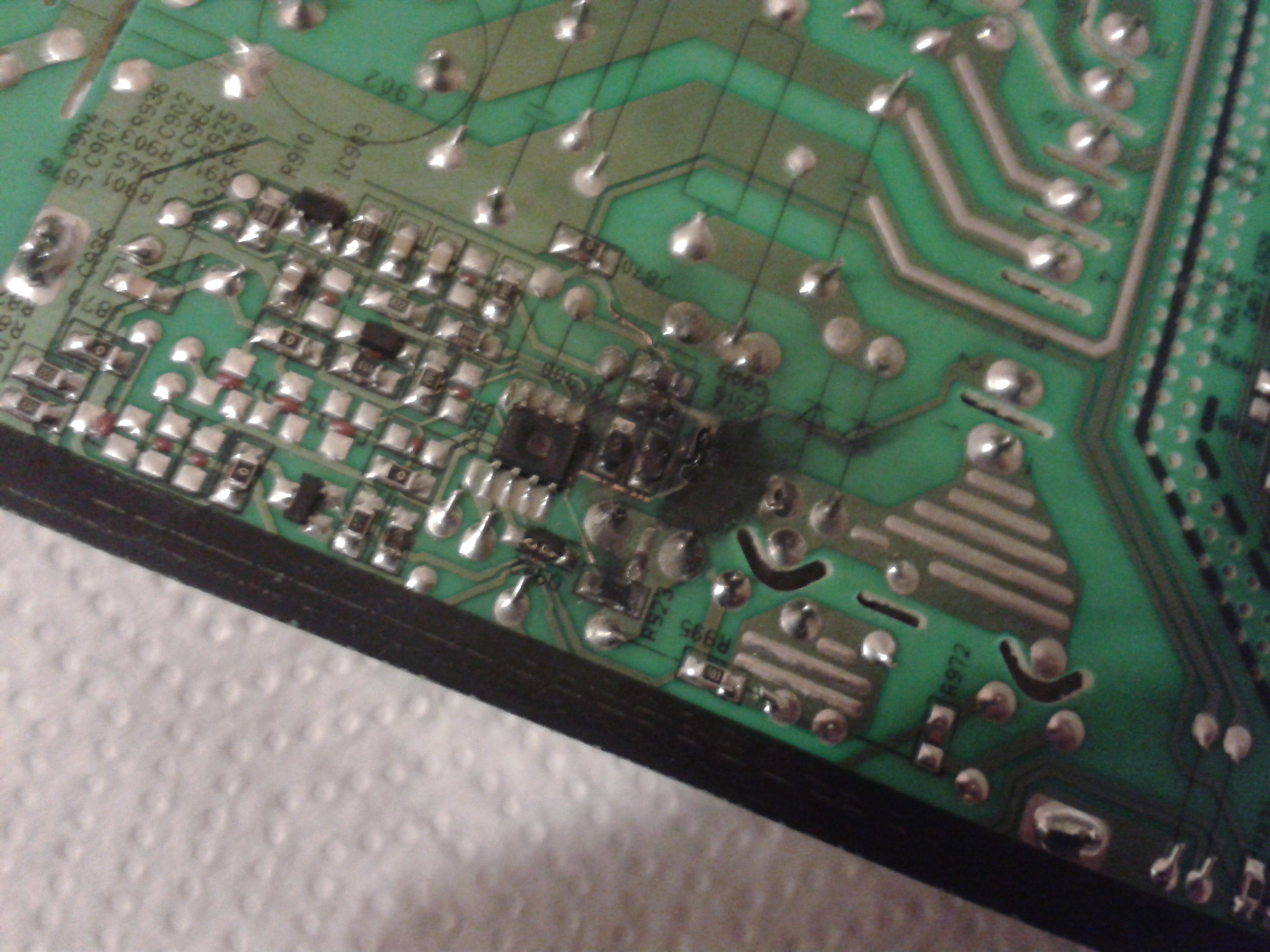

    Hi All,
    I have attached some pictures of this VESTEL 17PW25-4 250111 V1 PSU removed from a Toshiba 32BV702B.
    TV worked fine from new (10 months old) it had a blank screen and red flashing light on start up, performed factory default reset as advised by Toshiba and all was ok for three months.... Now13 months old and Toshiba don't want to know.
    TV was in PC mode VGA connected, when I shut it down / standby / no on off switch.

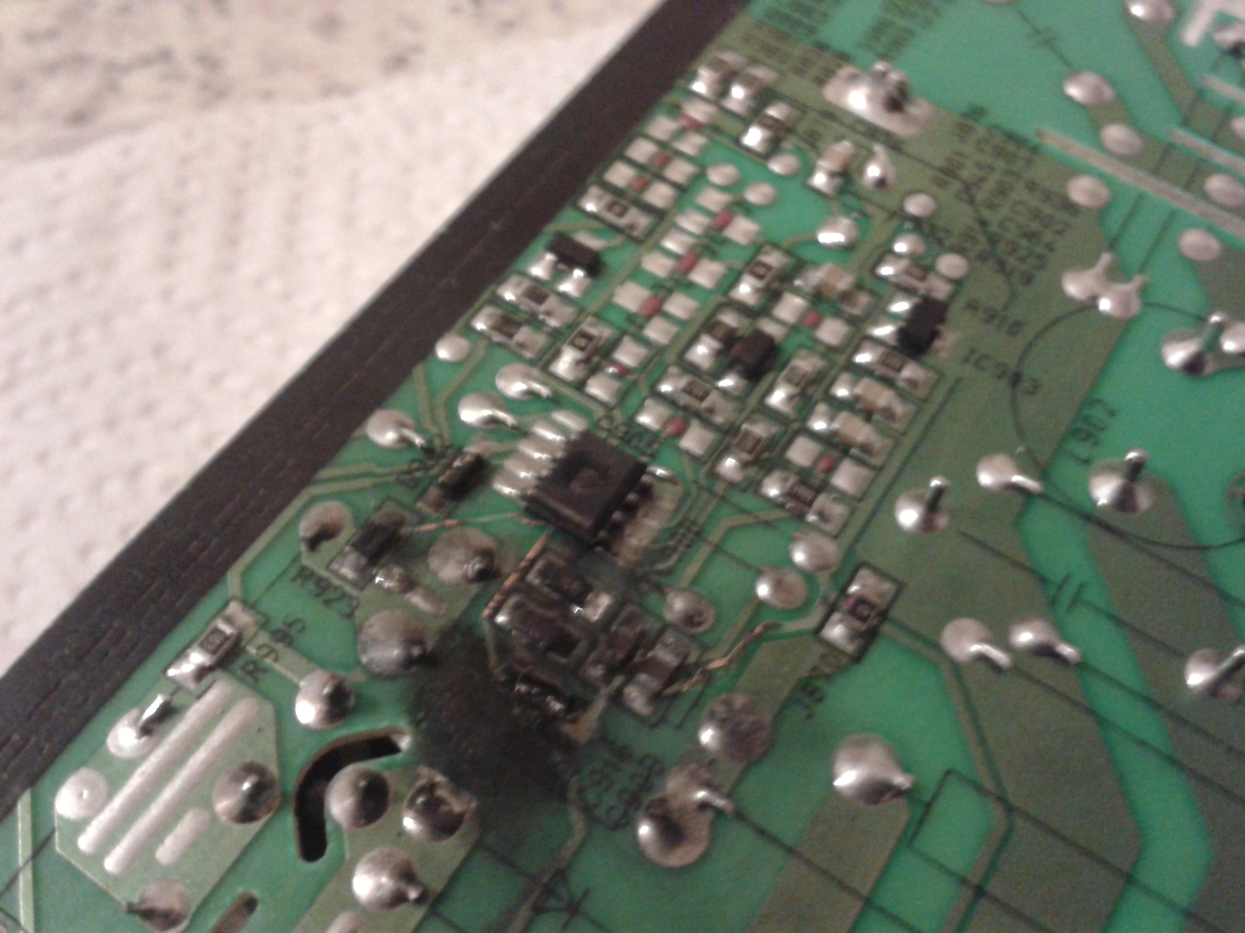

    Next morning the set was totally dead, stripped it down and found the PSU Board is Fried, Blown apart IC (see Pictures).
    Q1. Is this failure common on this PSU and is there likely to be another / different panel fault that caused it?

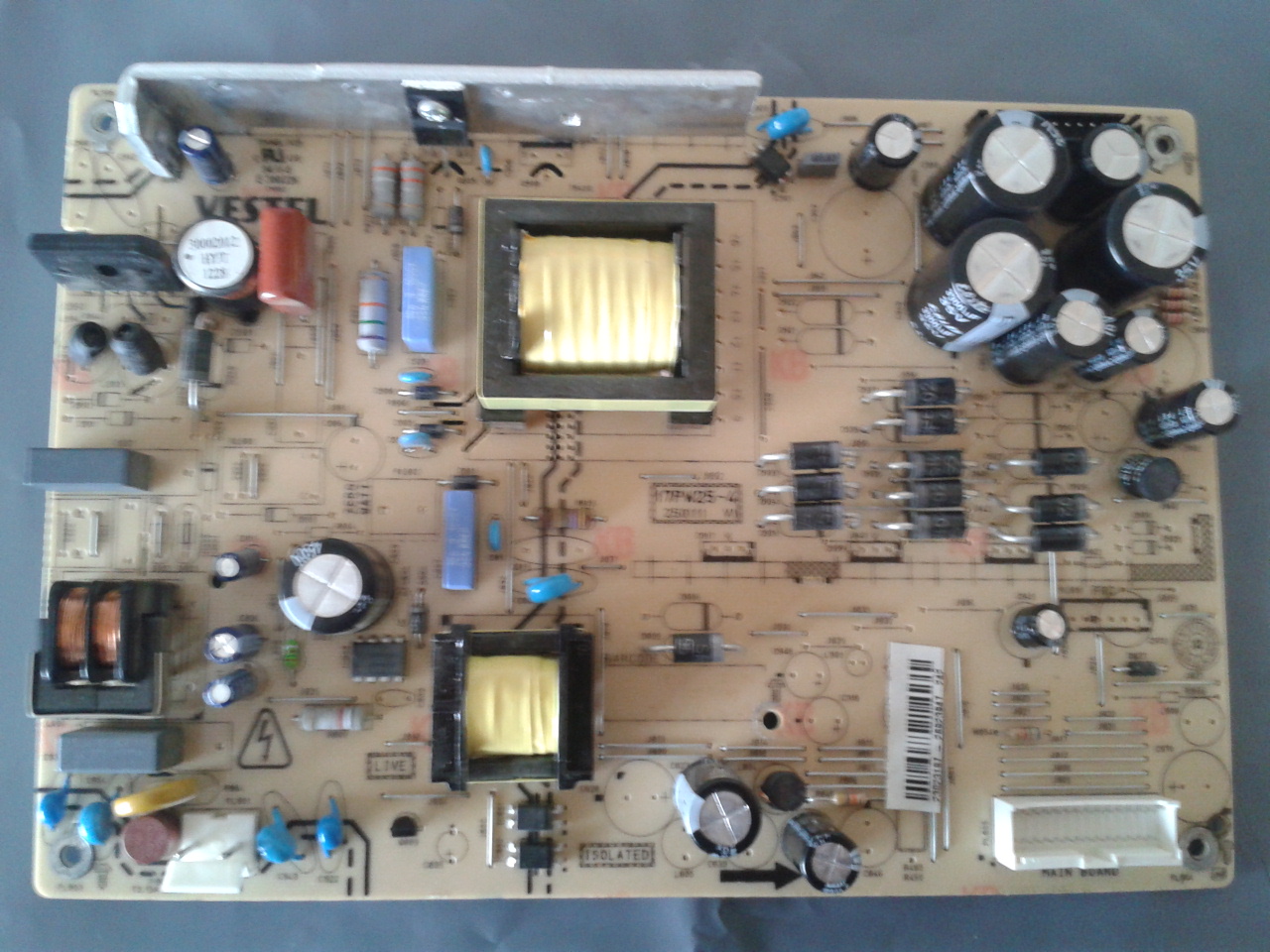

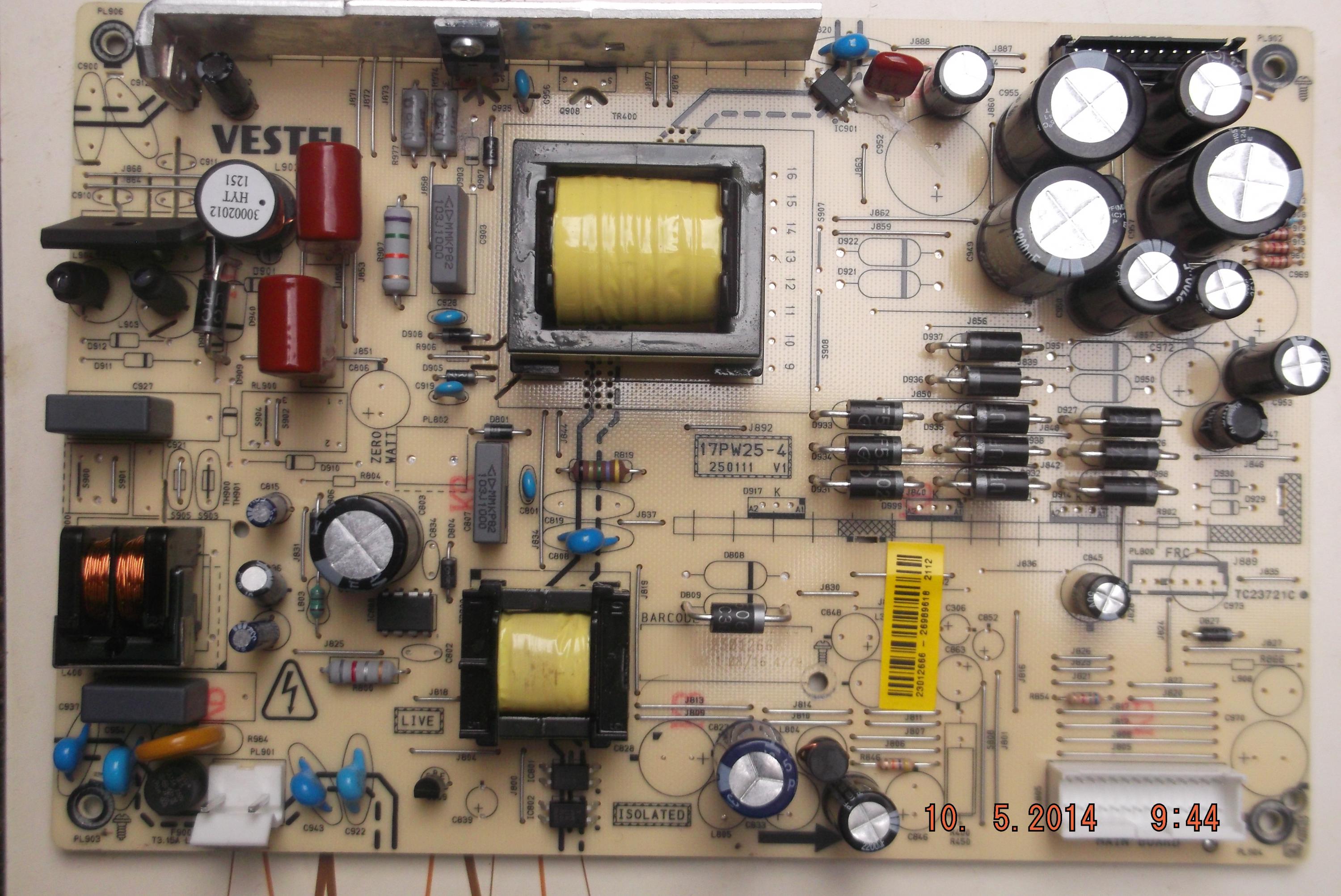

    Q2. I have got another working 17PW25-4 250111 V1 PSU (See Pictures) from a 26" if I remember rightly.
    What are the Chances of it working if I swap out and replace all different components, caps, etc from the blown board to the working board, it seems to be half a dozen caps to be changed or repositioned and the toggle switch socket needs bridging?
    I have examined it closely and everything else seems to be the same underneath, a standard board with different positions for components and caps to make life hard.
    (I am of work sick at the moment, so it will pass some time)
    Any and all feed back would be appreciated, before I start this project. Thanks Fred.

    Sigh, another one of these. I've had three of these PSUs in 6 months. All with same fault. Though usually not as catastrophic.
    Has a serious design flaw due to penny pinching:
    https://www.badcaps.net/forum/showth...light=17pw25-4
    It's NOT a Toshiba, it's a Vestel set same as Alba, Bush, Technica, Digihome etc. Toshiba just rebadge and add big markup.
    The 26" board will work fine. They are interchangeable. You need to check if the jumper "S814" is present (near connector going to main video board). It needs to be same as your old board, if it's present then use a blob of solder if not remove it.

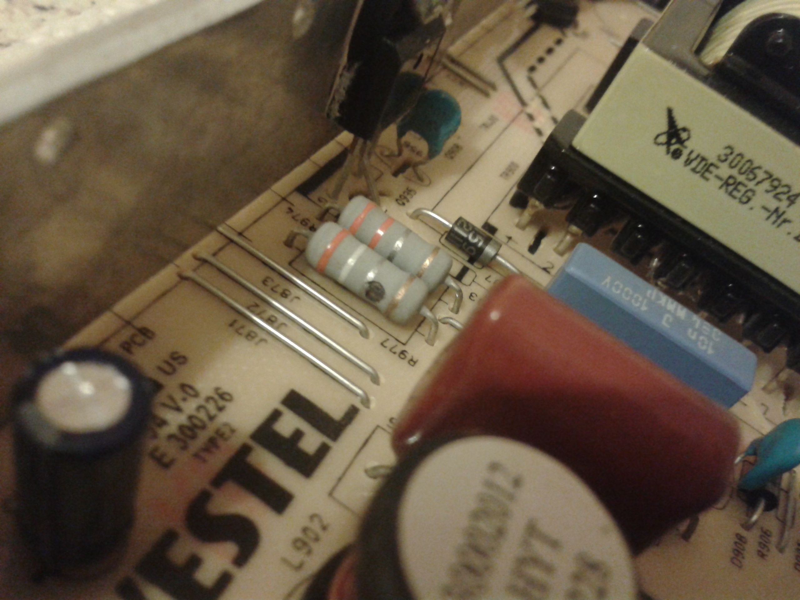

                    I have a problem with R980 wich is partially burned. I can see a little bit of the marking so I think it could be 15R. I will gamble with that.
                    R923 is 100R on my board, but 15R in the schematic so therefore it feels insecure to trust at values in the manual.
                      Re: VESTEL 17PW25-4 250111 V1 PSU - Project
                      I believe those are 0.15 ohms....

                            Hi guys,
                            Now I'm really pissed off for this bad PSU design.
                            I replaced the brokebn resisitors and the TV started...jippie
                            Then I checked the forward voltage drop of the 8 pcs 1N5402 and discovered that the one that I had replaced earlier, had a much higher voltage drop than the others.
                            I decided to replace all 8 with new ones from my stock. They differed from 543mV to 555mV (12mV), but I decided to try that.
                            I restarted the TV again and after about 10 seconds I checked the temperature of the diodes and found that the diod with the highest forward voltage drop were quit hot.
                            But before I had done that I heard a noise from a spark in the diode region.
                            After checking some components I found out that the diod with the highest voltage drop were shorted and Q935 and the fuse were broken. Maybe som more components hav gone to h..l
                            I consider to throw the shit away, but maybe I will try to find a large to replace the 8 with to override the miserable construction.
                              It really is a dreadful, horrible power supply to repair. In future, consider using a series light bulb, it might save you killing everything at once.
                              Usually it's the diode with the lowest forward drop that gets hot.

                                  See here for how this power supply is a complete failure of design:
                                  https://www.badcaps.net/forum/showthread.php?t=42137
                                  The forward voltage is one issue. The fact that the diodes voltage rating is exceeded by 2.8x is also a problem and it begs belief that any company could release a power supply with such a critical design flaw. The diodes must be replaced with 1000V type for reliability.
                                  Just a look at the schematic will tell you that it was drawn by a complete idiot.

                                    Hi Tom,
                                    I will try to use these diodes
                                    BY500-1000
                                    What do you think of that?
                                      Should be OK.
