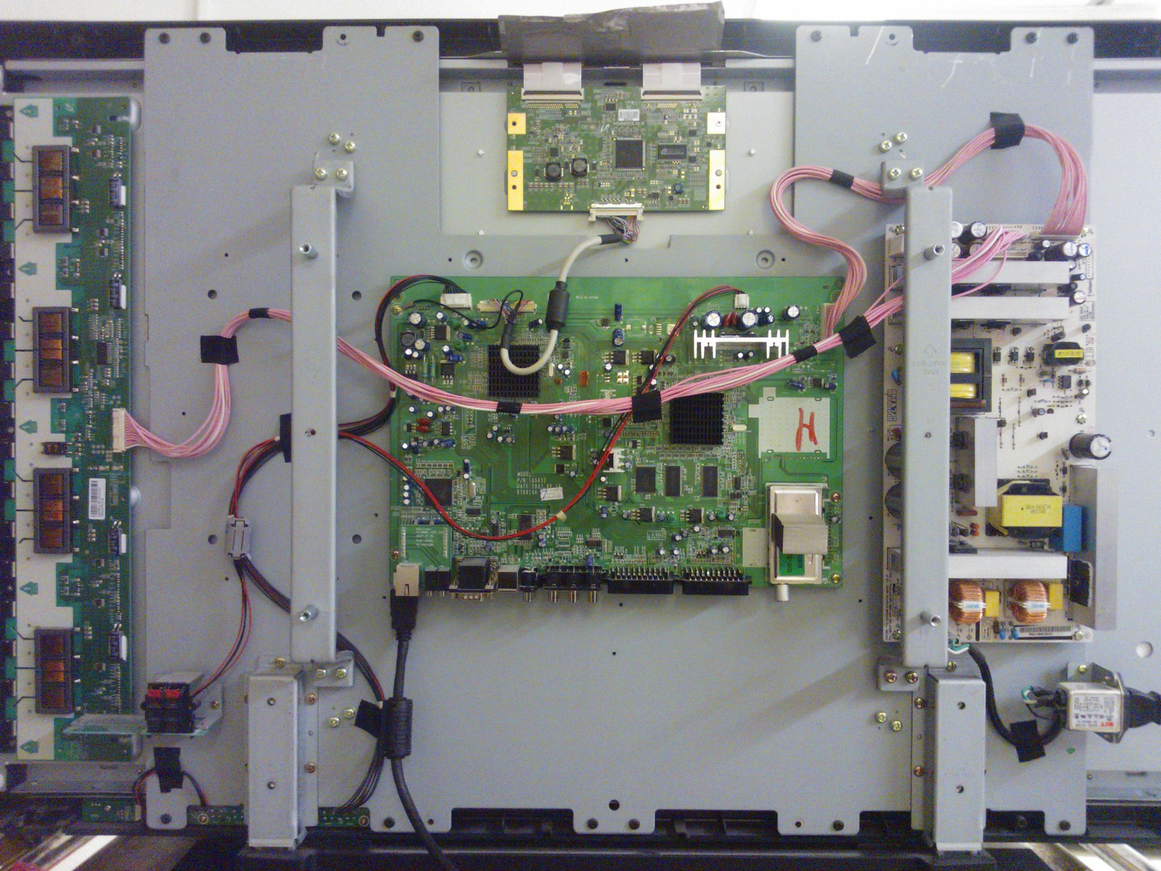

    This 40" Lava set does not output a picture, but sound only.
    Backlight on, psu voltages seems OK.
    Wonder if this set is possible to factory reset by remote sequence or changing an eeprom?
  • PowerAmpFreak
    • 982
    • Sweden
    Re: Lava LV-40LVG factory reset?
    Guys, I certainly need your help and advice for this dude.

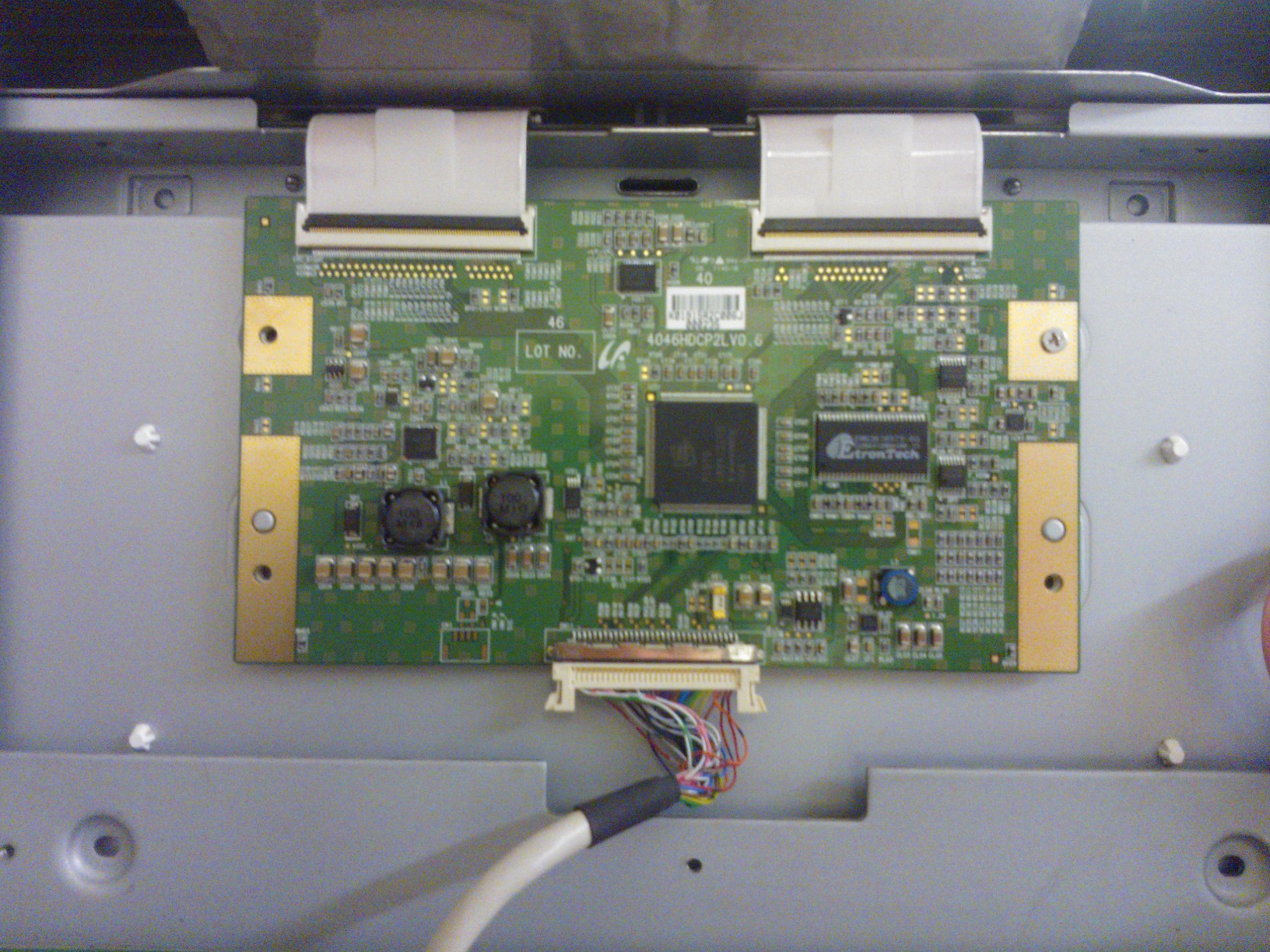

    Got a brand new T-con fitted, no help.

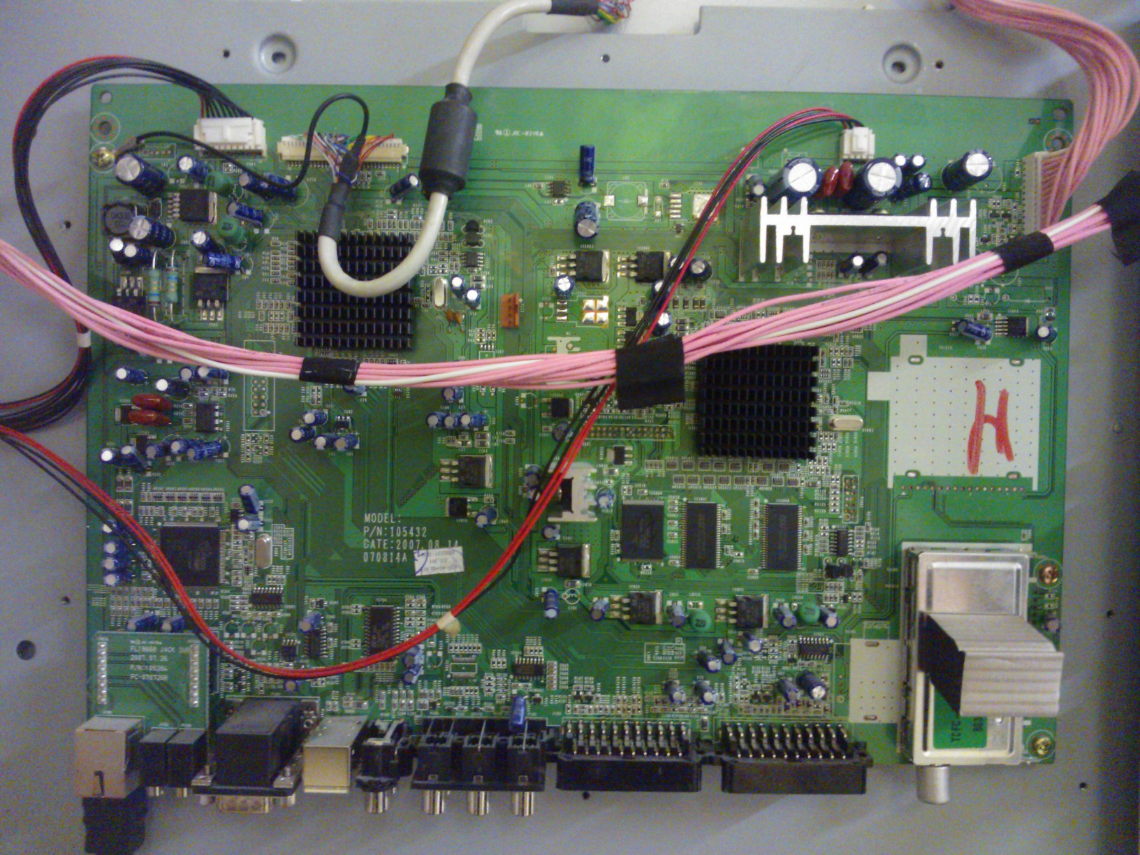

    I was probing the datalines between mainboard and T-con and found nothing. There seems to be no activity here, so problem should be the mainboard after all.
    I was taking a longshot replacing the T-con, without doing much investigation.
    I found an eeprom on the mainboard (24C64) wonder if it's possible to replace this to initialize the mainboard?
    Please see the attached pictures.
    • PowerAmpFreak
      • 982
      • Sweden
      It worked out to replace the SMD eeprom.
      Then set went through factory reset and set is back to operation
