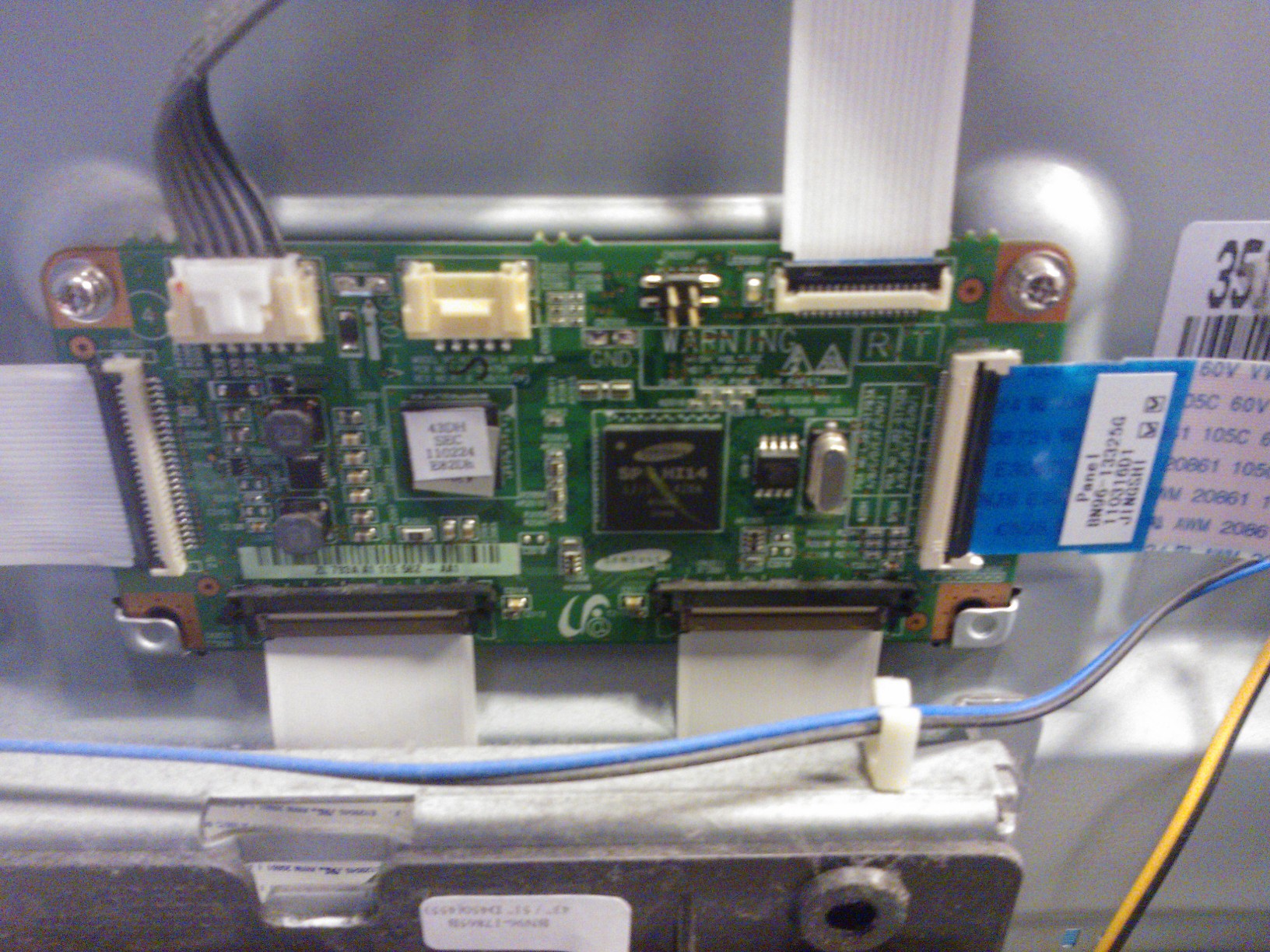

    Samsung PS43D455 no picture
    Set starts up, all voltages fine. Flashing led on logic board. No picture.
    Want to put this logic board into testmode (pattern generation), how is this done?
    There are a 4-pin header, but I don't know how and then to short.
    Re: Samsung PS43D455 no picture
    Unplug right hand cable, going to main AV board.
    Then jumper pins 3 and 4 of logic board connector. (Board should have pins numbered.)
    Note: one blink/sec = No Y-main/X-main fault detected, one blink/5-7sec = Fault detected.
