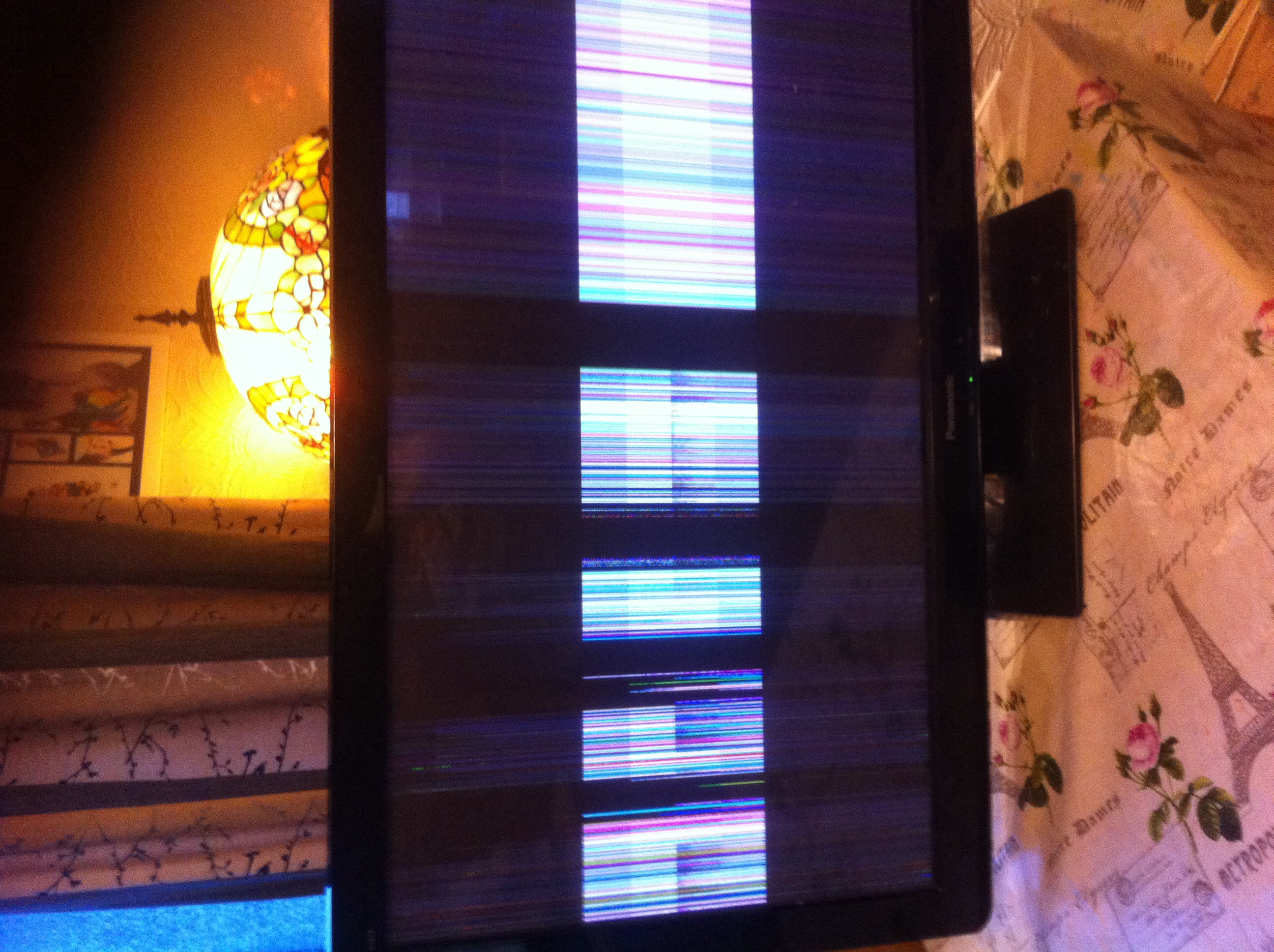

    I have had this TV for about a year and half bought from Comet which is now in administration. Basically long story short i cant get it fixed as i dont have the reciept. So i have no other choice than to fix it myself.
    I was just watching it and all of a sudden these strange vertical lines appeared in varying colour from green to purple. They cover about a 1/3 rd of the middle of the television and the top and bottom third is basically completely black.
    I contacted a professional on Fixya who insisted that it was the xsus board. So i bought one and replaced it and it was still exactly the same. I have spoken to another person who insists it is the Y board. Before i commit i would like to hear some news other than "it cant be repaired"
    I will post i picture of it below.

    Here is a picture, apologies for having to tilt your head to the left as it was taken on my i phone.
    Oh and my apologies i forgot to add that when i try to press any buttons on the side like the volume or channel change the lines expand or shrink or just move.

      Re: Panasonic Tx-P42U30B Vertical Multicoloured Lines
      Personally, it looks like a bad panel to me! Sorry!
      Take a look at this document, last page:
      You can try checking that 3.3V short thing on the page before and the page before that.

        Hi Tom, thanks for the reply. On page 27 the symptoms are described exactly where it says 2011 model. The position/length of the colourful bars change position and length when volume or channel buttons are pressed.
        My son pulled out his headphones about a fortnight before it broke and he ended up breaking off a HDMI cable with part of the metal left inside the TV, i had to use a set of fine pliers to remove the HDMI part. But it was ok for a fortnight before. If i took a video of the symptoms would that help at all??

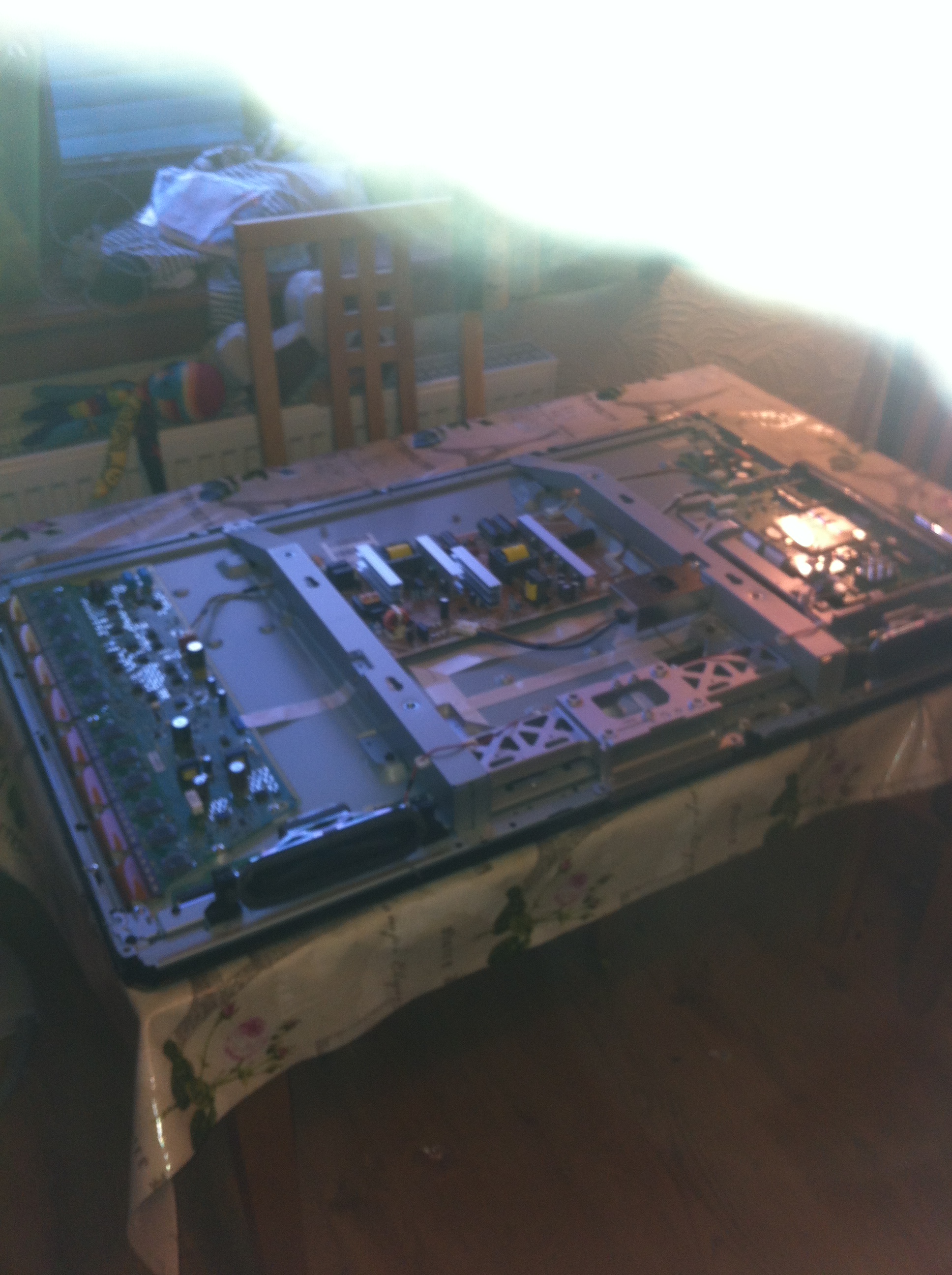

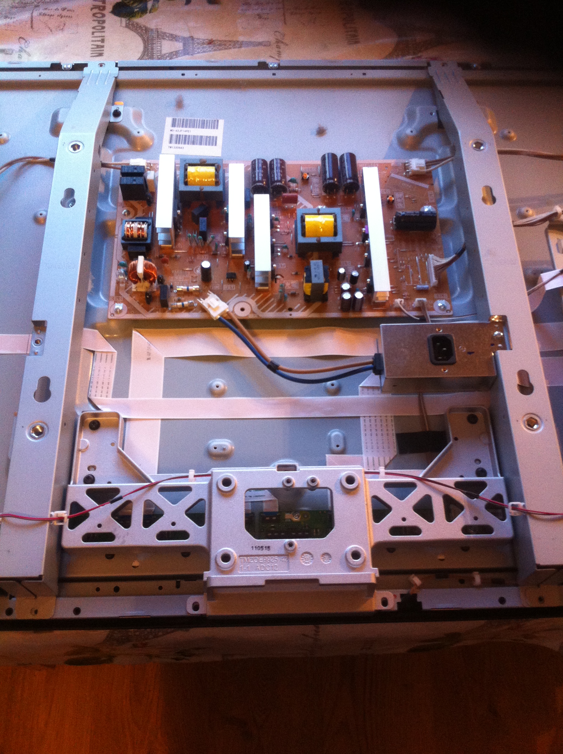

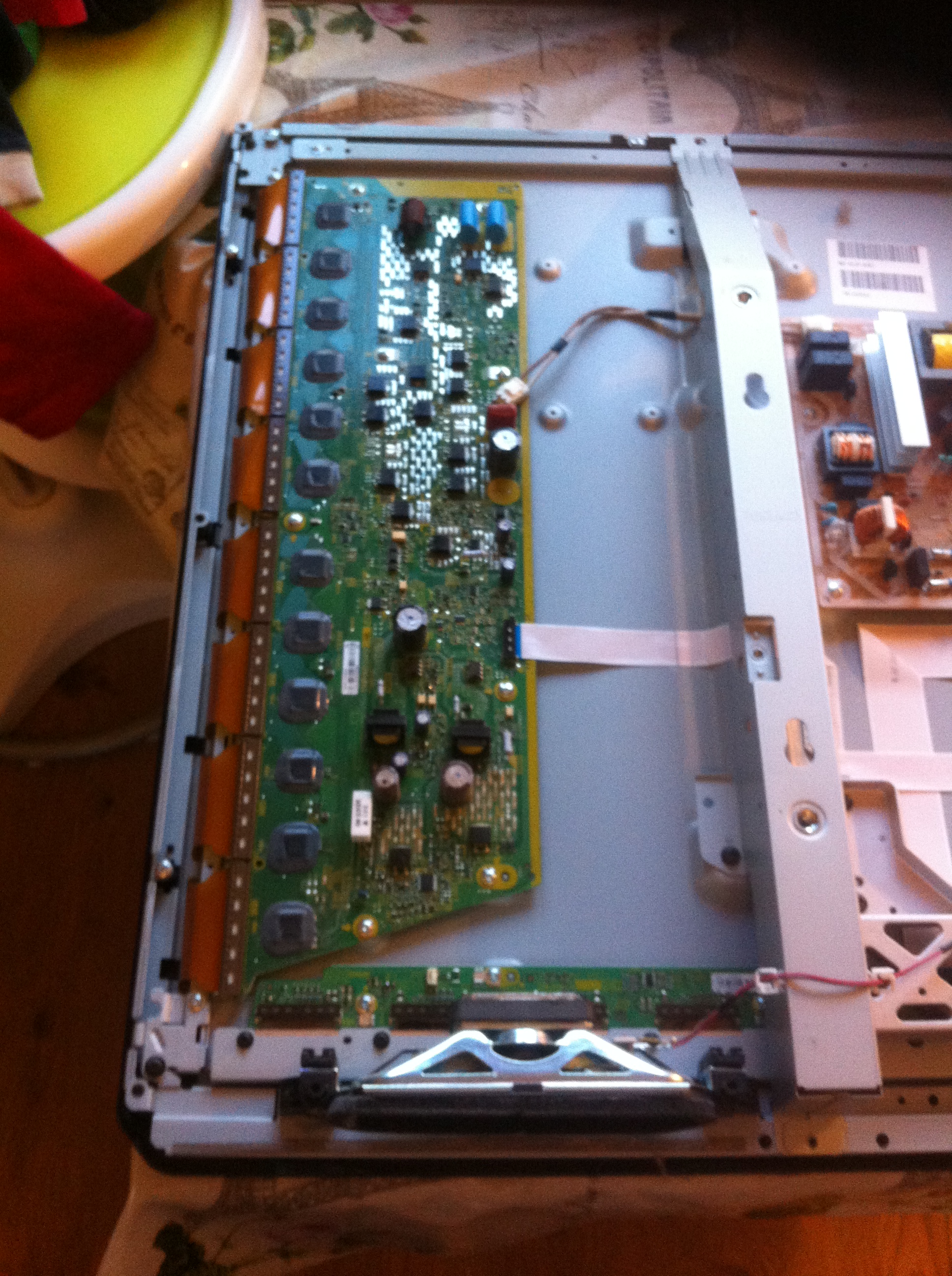

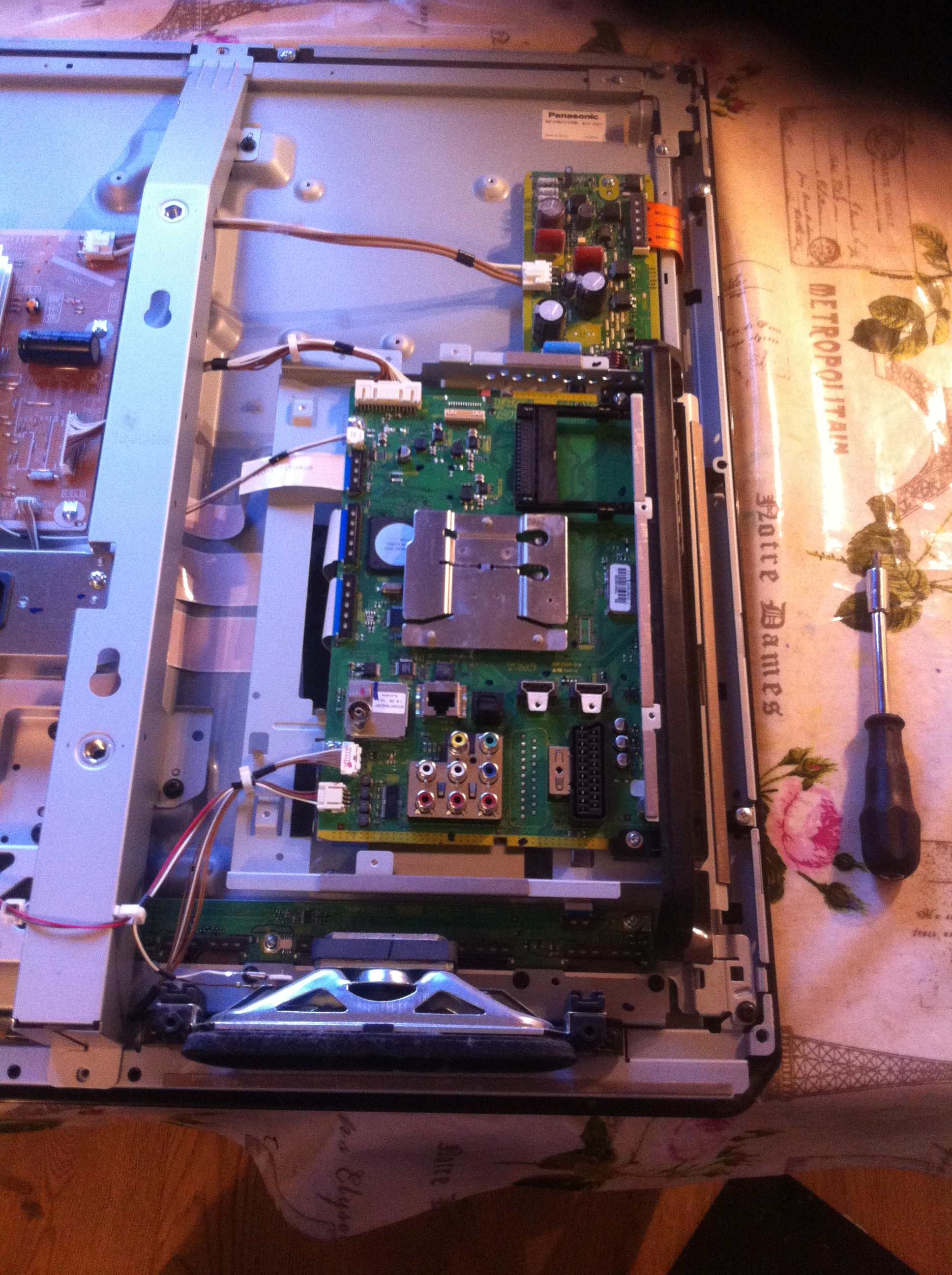

              Picture 1 it the complete board layout.
              Picture 2 i think is the y sus board along with the C1 board at the bottom
              Picture 3 is the PSU i think
              Picture 4 is the main a board with the xsus board underneath and the C2 at the bottom

                Also one last thing which i never noticed before. There is quite a loud buzzing sound coming from the Y-Sus board and there is a green led lit up.
                  Both those are normal.
                  We can guide you through the meter tests if you can borrow one or buy one (Maplin sell a half decent one for under £10.)
                  You can also try another test. Along the C board, I would unplug all the ribbon connectors which correspond to a dark patch on the screen. The only one which looks completely dead is near the middle. I'd take that out and leave the others in. (Only do this with power OFF!) Then see if you get a picture minus that bar.
                  If so, that would confirm bad data driver IC, which is unfortunately a nonserviceable item. It needs a new PDP, which isn't cost effective, so I'd see what you can do about claiming under the Sale of Goods Act because quite frankly that's a pathetic lifespan for a TV...
