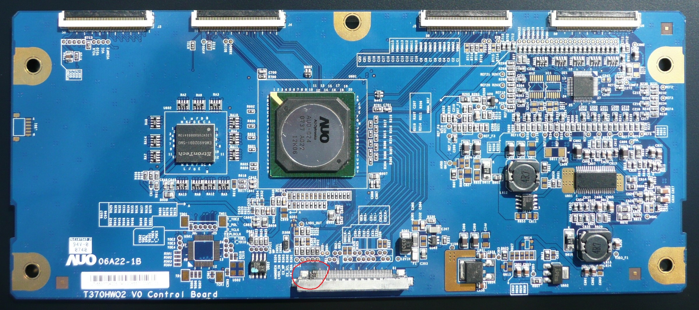

Inverted Colouras on Samsung LE37M87BD

      is the board i have repairable, dont realy wanna spend £50 on a second hand board incase same fault develops or £75 to have the one i have repaired.....
        Re: Inverted Colouras on Samsung LE37M87BD
        You will have to get the IC from EBAY, then find someone that is good at SMD component replacement.
          i know someone that is good at that kinda stuff... what would i have to type into the ebay search bar do you know ? thanks for the help.
            As15g, that is on your board, right?
              not sure Budm can even see any numbers on the chip itself..
                Just read them off and confirm if it is AS15 type (G, H, F are all same) which commonly fails with this fault.
                  yes Tom its AS15-F
                    ordered one off eBay, going to get a friend to replace it for me as he will be much better at it than me ...
                      was wondering if anyone knows what slot C253 is on this board as it seems to have snapped / broken off. unsure of why ?
                          Unless there's an available schematic I doubt anyone can answer your question....
                            Hi tom, something had definetly broken off it but plugged it in and it seems to be working 100%
                              Picture? May or may not be important.
                                The lvds connector looks bridged at pins 1&2
                                  It looks burnt or corrosion.
                                    Could that be causing his problem ?
                                      I changed a AF15-F chip yesterday in a 40" Sony Mine works fine now.
                                        Probably need to re-visit Posts # 9 & 11. My interpretation is the image is borrowed from GOOGLE.
                                        Originally posted by Mikeyboy2007 View Post
                                        Tom cant get a clear enough picture, broke my camera and my phone camera is a pile of sh*t... the T-Con board thats on it is T370HW02 V0. ....................
                                        no Budm its exact same one attached (taken from Google images)
