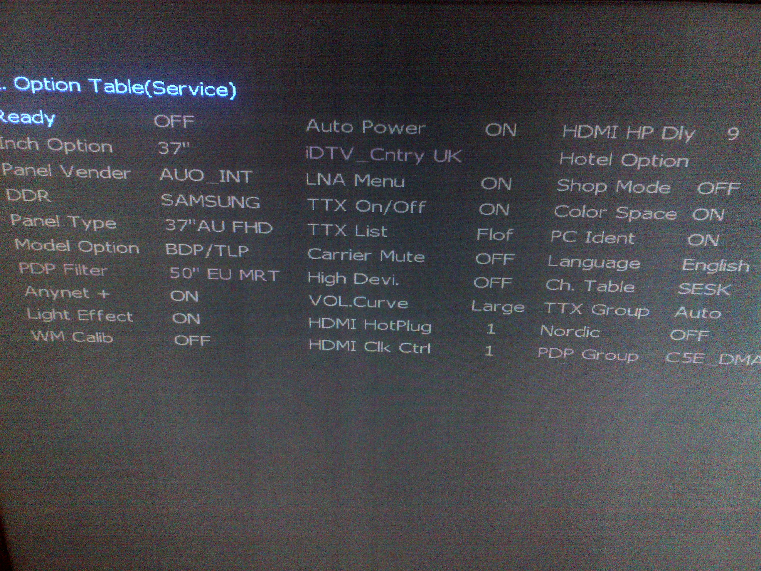

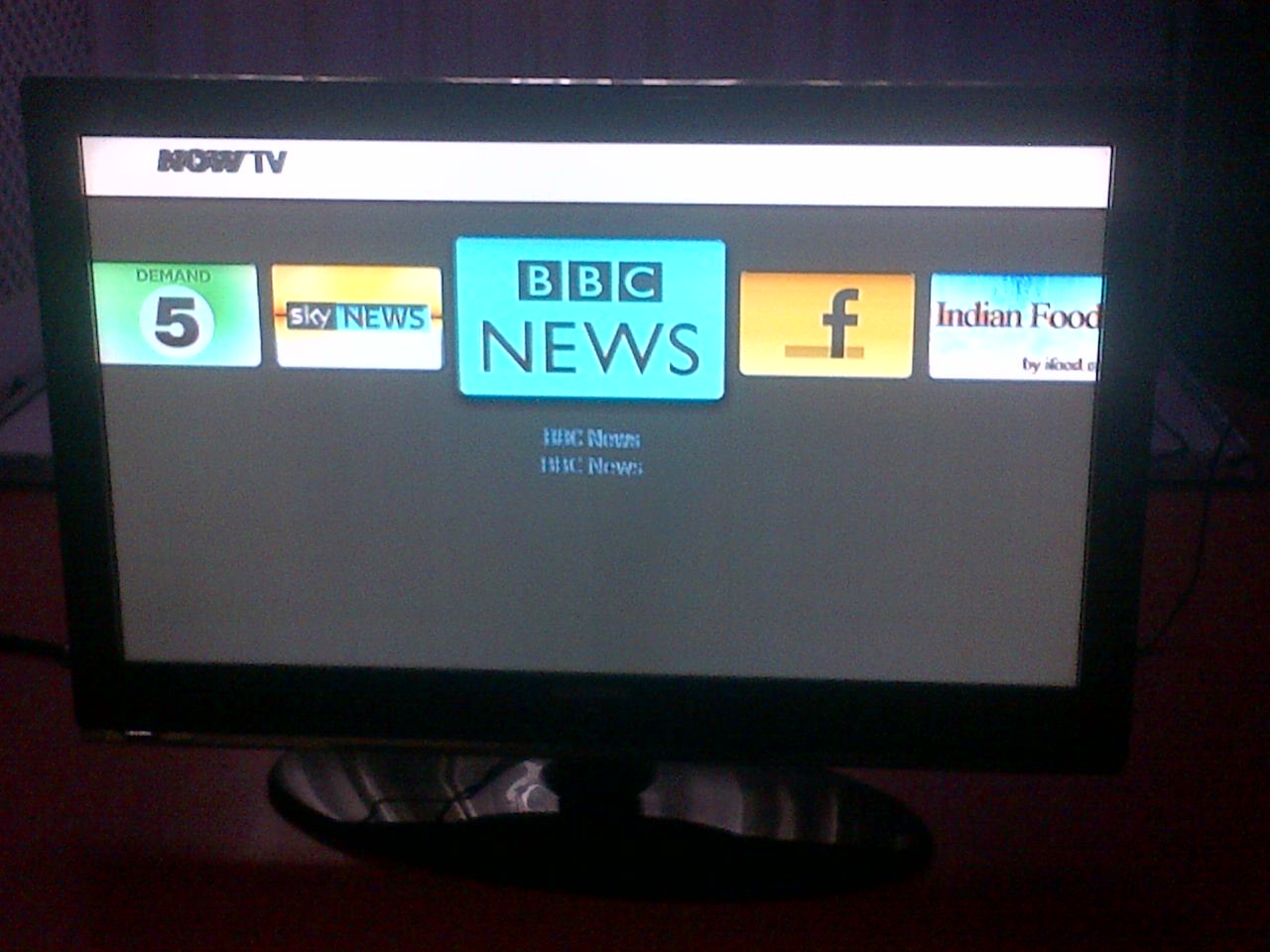

    hi guys bought this telly form someone (as faulty) , plugged it in and all the colours are inverted, there was a buzzing coming from the tv and after i turned down contrast etc the buzzing went away. any ideas ? also went into service menu and changed DDR to Samsung.

      hi Tom, attached picture, also there is a little ghosting on the picture too.
        Re: Inverted Colouras on Samsung LE37M87BD
        Could be GAMMA or LVDS/FORMAT fault. A natural image (a face is best due to the smooth gradients) can help narrow down the exact fault.
        First check LVDS cable seated properly both ends, no corrosion on any pins, no bent pins.
        If that passes enter service menu and check LVDS format option: there may be a few, JEIDA is one of them. Try each and see if picture gets better. Also check panel setitng is correct - AMLCD 37" for example is SAMSUNG 37" panel. Note down all settings before changing them.

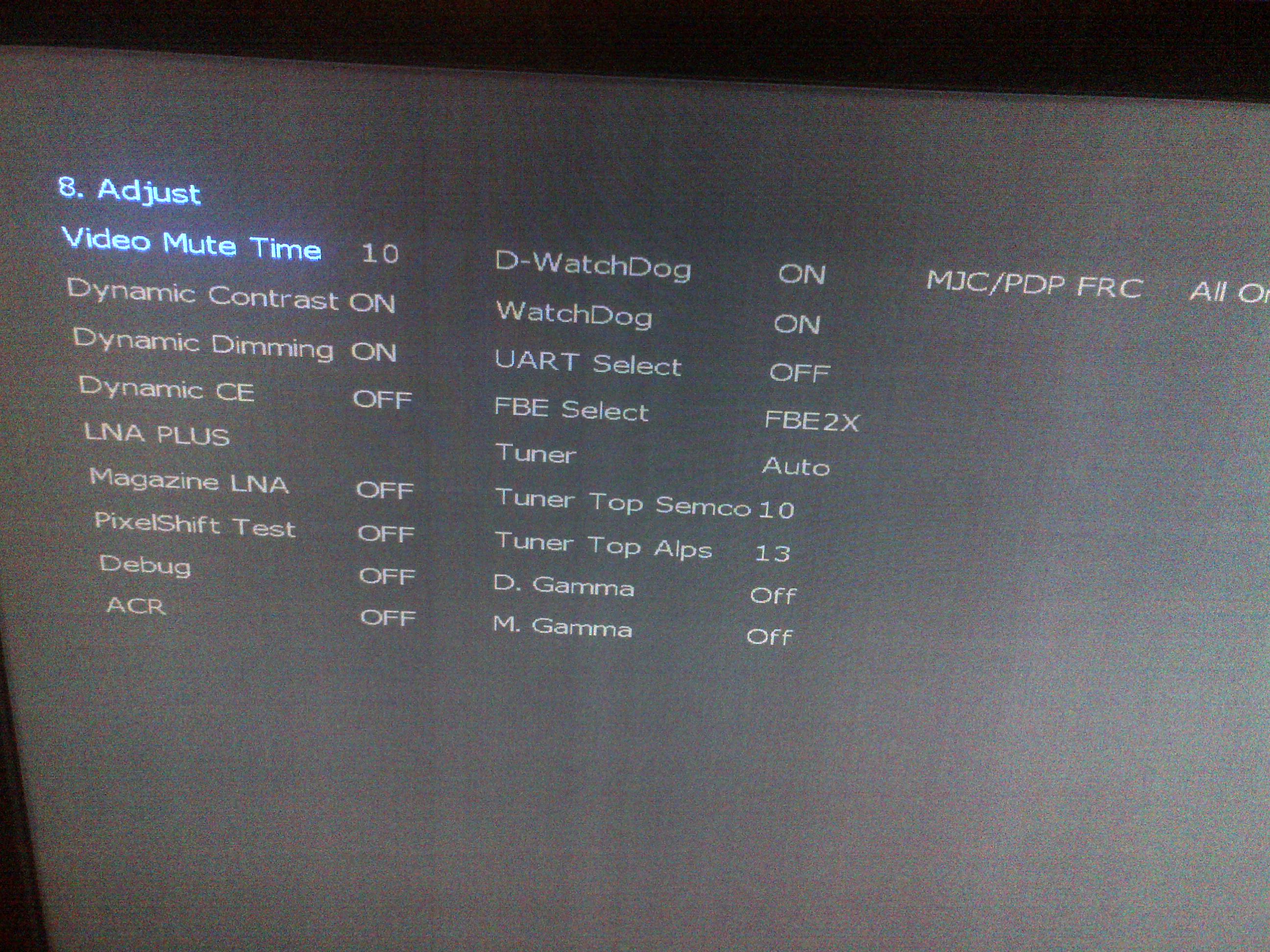

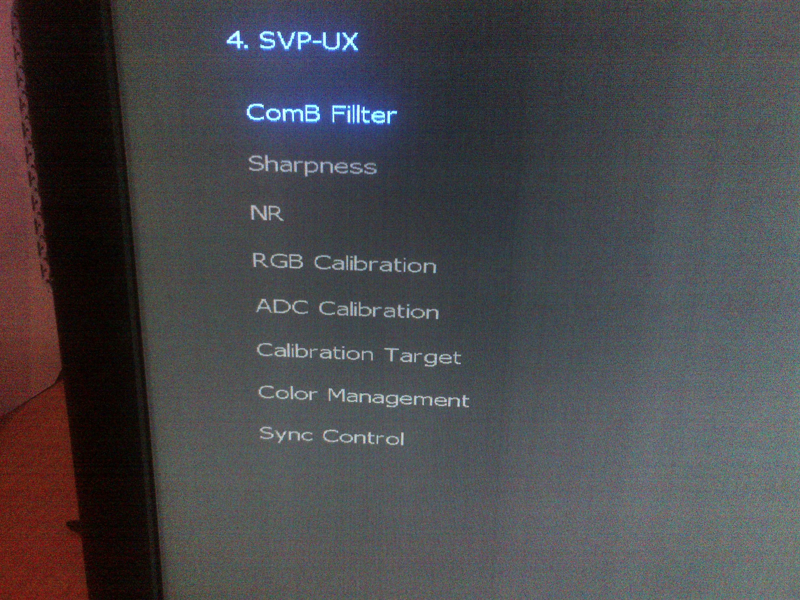

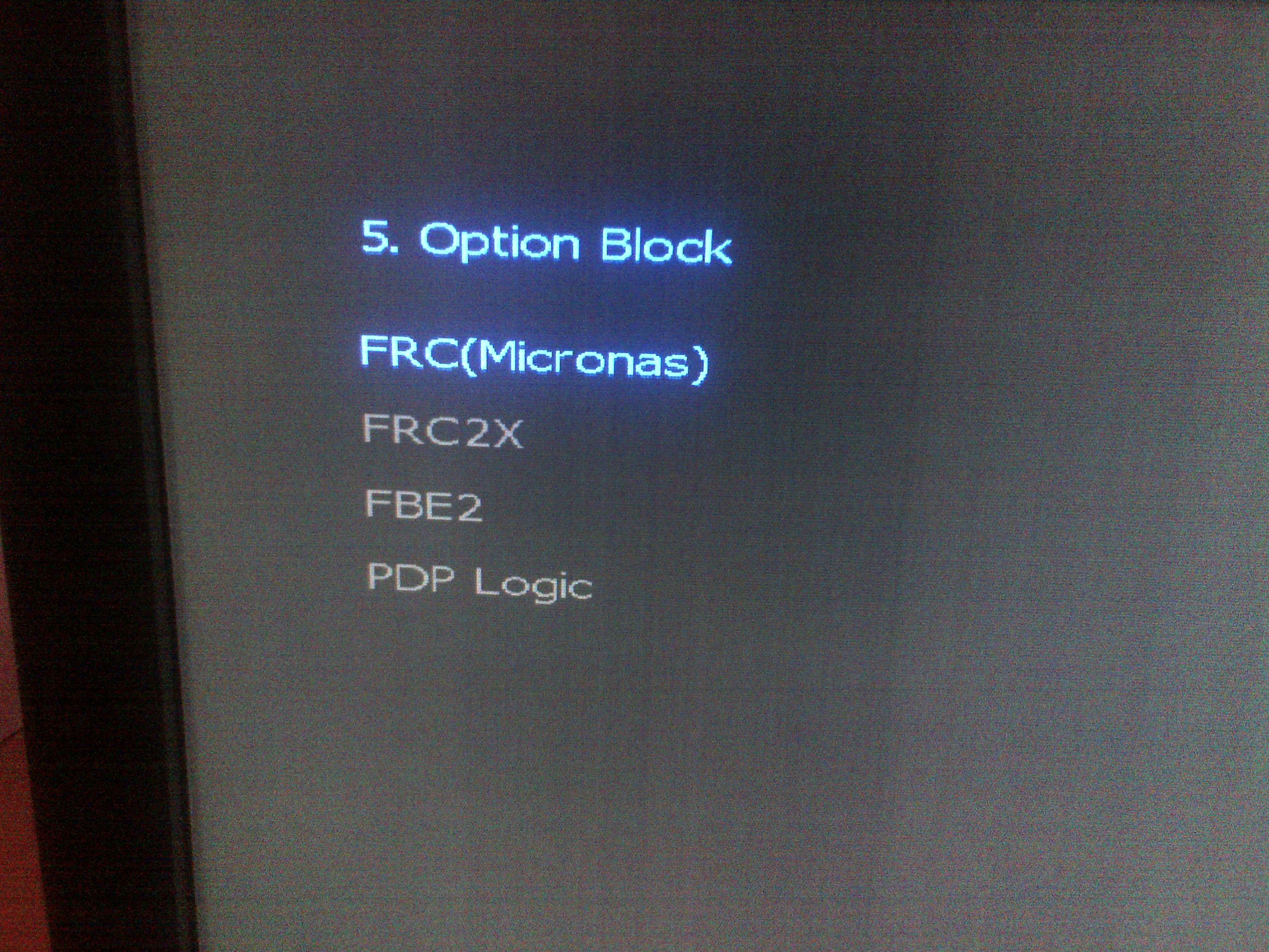

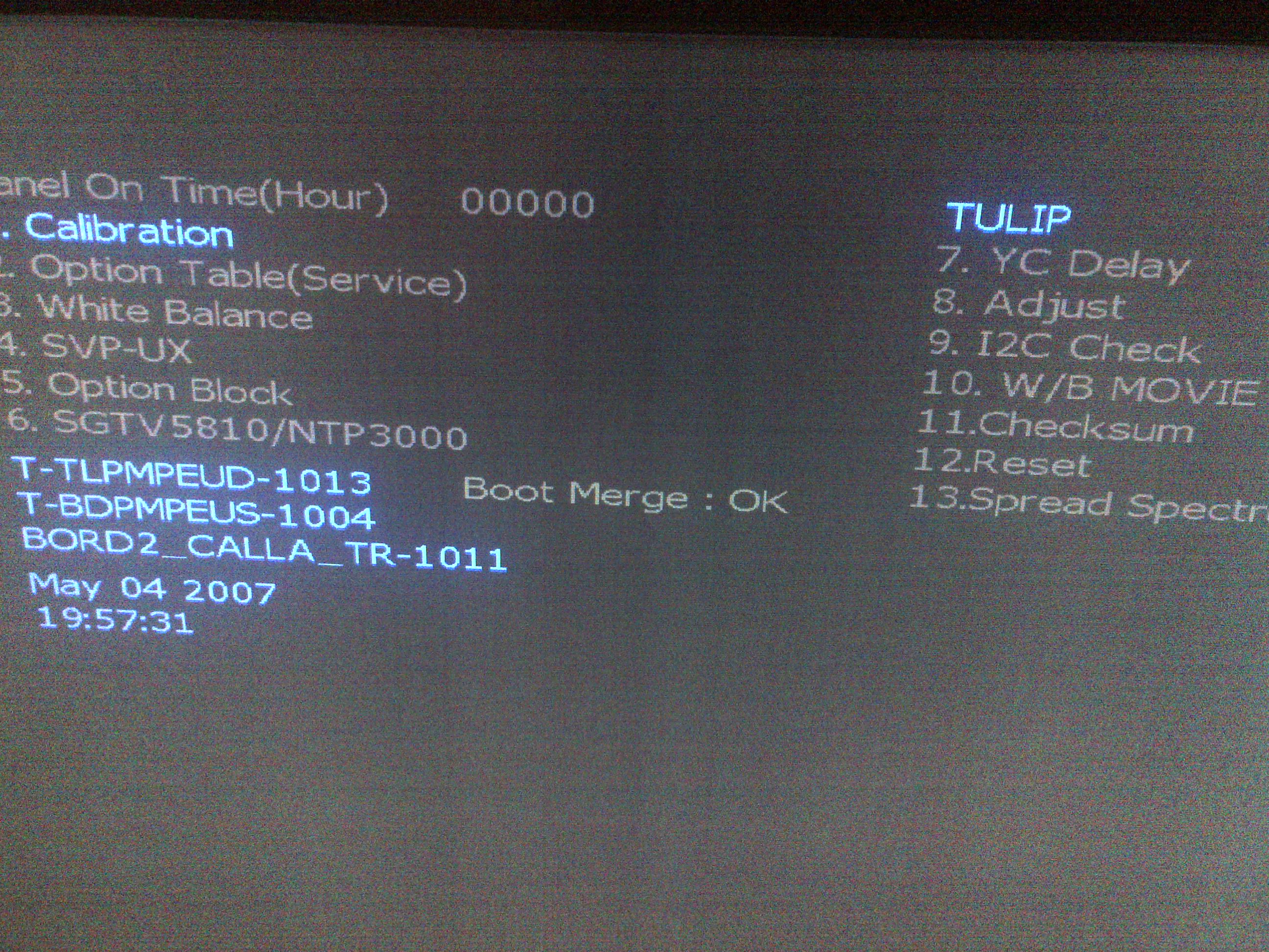

          hi Tom, couldn't find LVDS option anywhere on the service menu ?
            What options do you have?
            • Mikeyboy2007
              • Mar 2013
              • 745
              • Scotland
              hope this helps Tom.
                Ok, looks like no option for LVDS format, so time to focus on t-con.... good clear photo required.

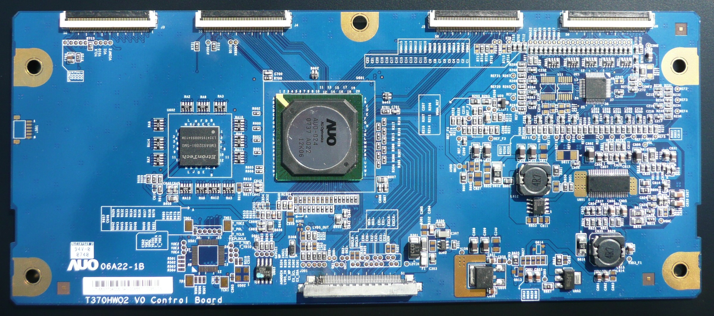

                  Tom cant get a clear enough picture, broke my camera and my phone camera is a pile of sh*t... the T-Con board thats on it is T370HW02 V0. looked it up on ebay and they have a repair service for this specific board, costs £75 though and dont realy wanna spend that kinda cash when it might not even be the fault, the pins on the LVDS cable took fine and the board itself looks in excellent condition.

                      no Budm its exact same one attached (taken from Google images)
                        I see, my version is 402, it does use the same AS15 Gamma Vref IC.
                            is that whats in place U603 ?
                              U21 in your picture, and I believe the test points that Tom wants you to test is the row on the top right close to that IC. Tom can give you more details about testing those voltages.
                                You should test the points marked VGAMA1 thru VGAMA22. Meter on 20V DC, board installed in TV and showing pic, red pin on test point and black on chassis ground. Report your readings.

                                  sorry for late reply guys, Tom did what you said got following readings..hope this helps..
                                  VGAMA1 0.02
                                  VGAMA2 0.18
                                  VGAMA3 0.29
                                  VGAMA4 1.84
                                  VGAMA5 3.39
                                  VGAMA6 4.92
                                  VGAMA7 9.85
                                  VGAMA8 12.35
                                  VGAMA9 12.81-12.87 (was jumping up and down)
                                  VGAMA10 12.92
                                  VGAMA11 7.62
                                  VGAMA12 15.02
                                  VGAMA13 15.41
                                  VGAMA14 15.38
                                  VGAMA15 15.15
                                  VGAMA16 14.84
                                  VGAMA17 14.25
                                  VGAMA18 14.14
                                  VGAMA19 14.03
                                  VGAMA20 14.01
                                  VGAMA21 14.01
                                  VGAMA22 14.00
                                    It is bad.
