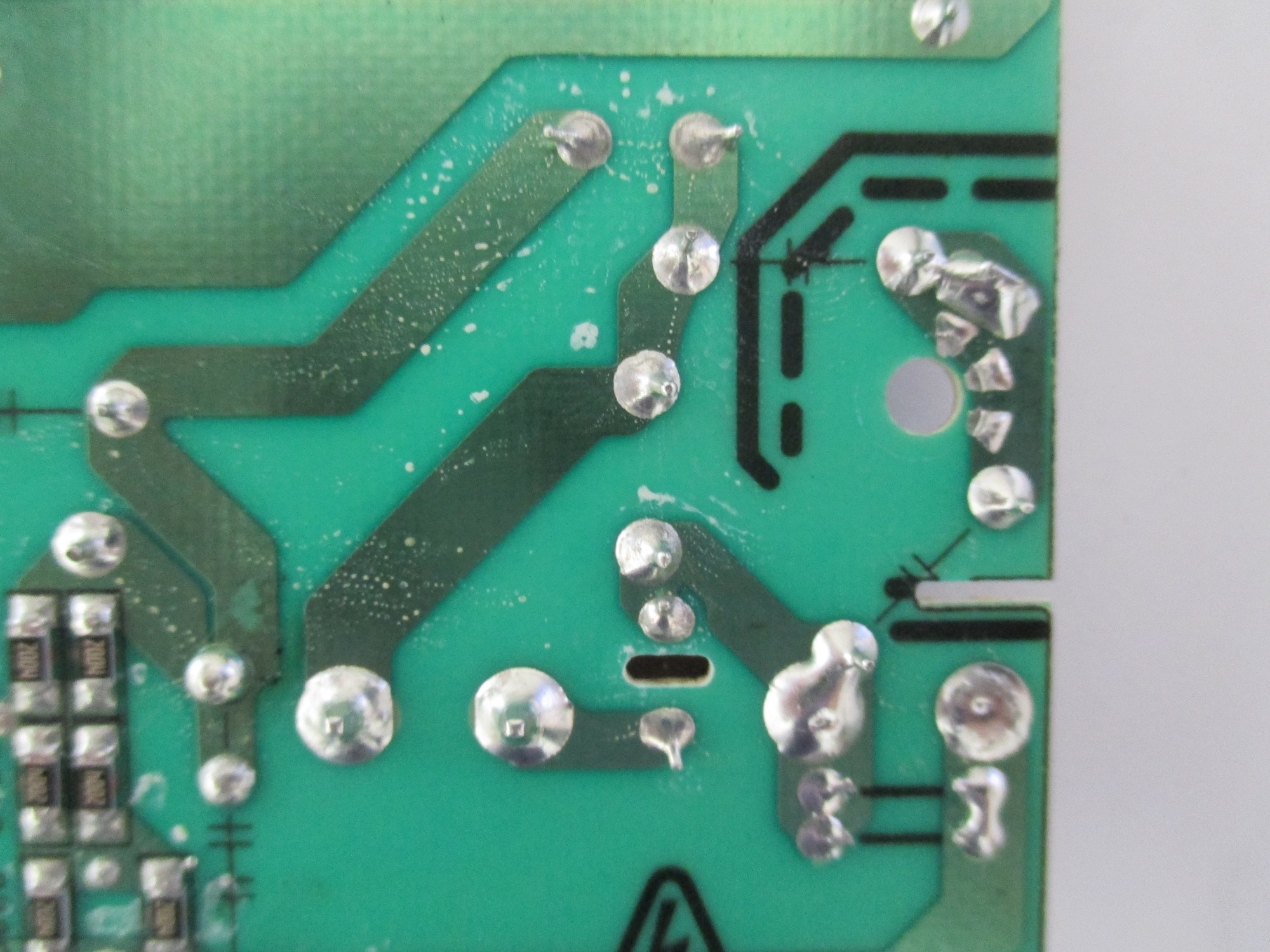

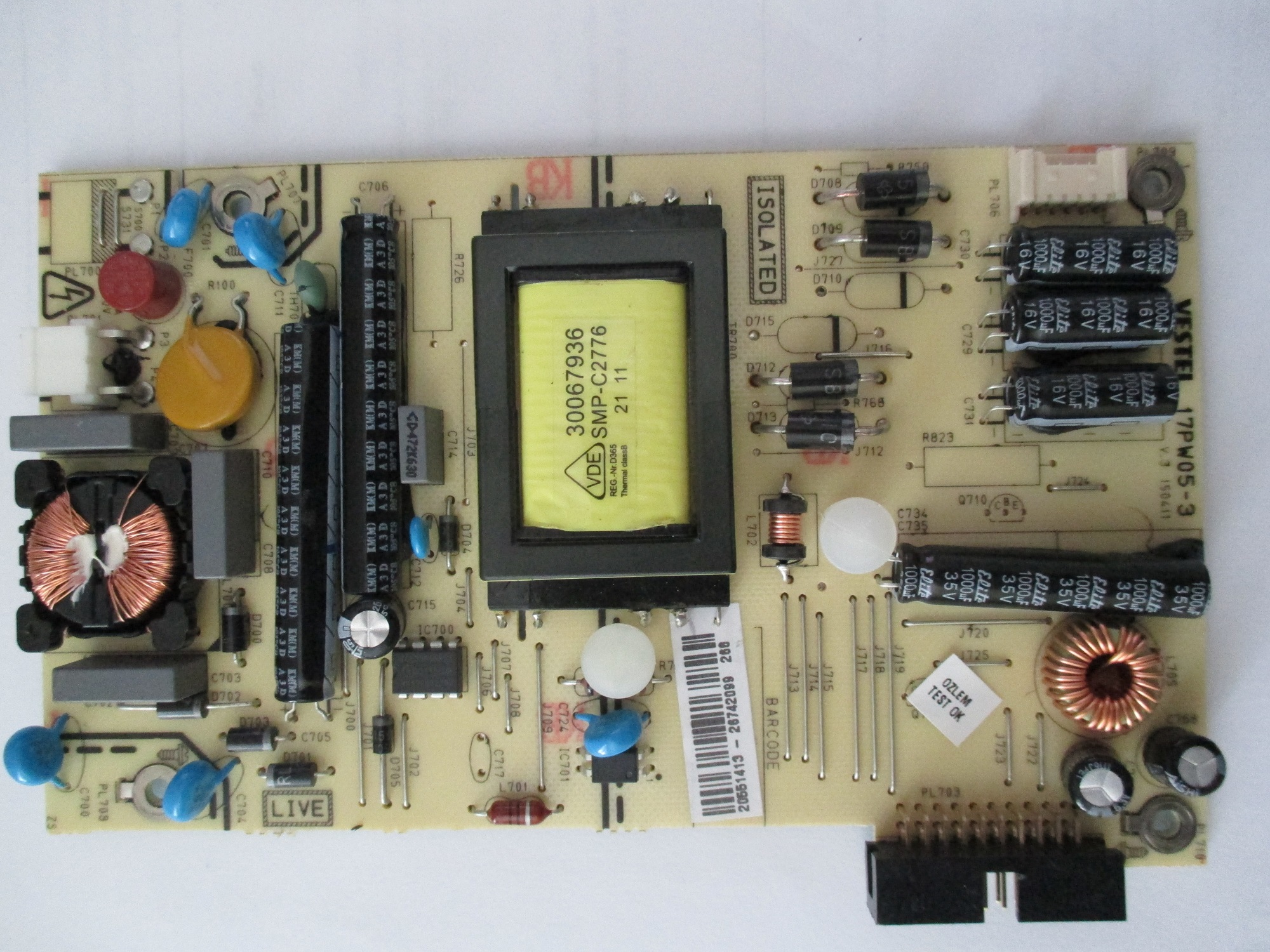

              Just joined having found this fantastic resource following a dead Vestel 17pw05-3 in my Toshiba. Have replaced all five of the commonly identified troublesome diodes but now have a problem that is perplexing me.
              When I connect the psu back onto the casing via the four screw holes I get a dead tv. If I remove the screw at PL 707 it shows the start up lights flickering then it goes into stand by. Put the screw back in and the tv fails to start again.
              Can I ask what might be causing this please?

                Some pictures especially of your power supply, front and underside would be helpful.

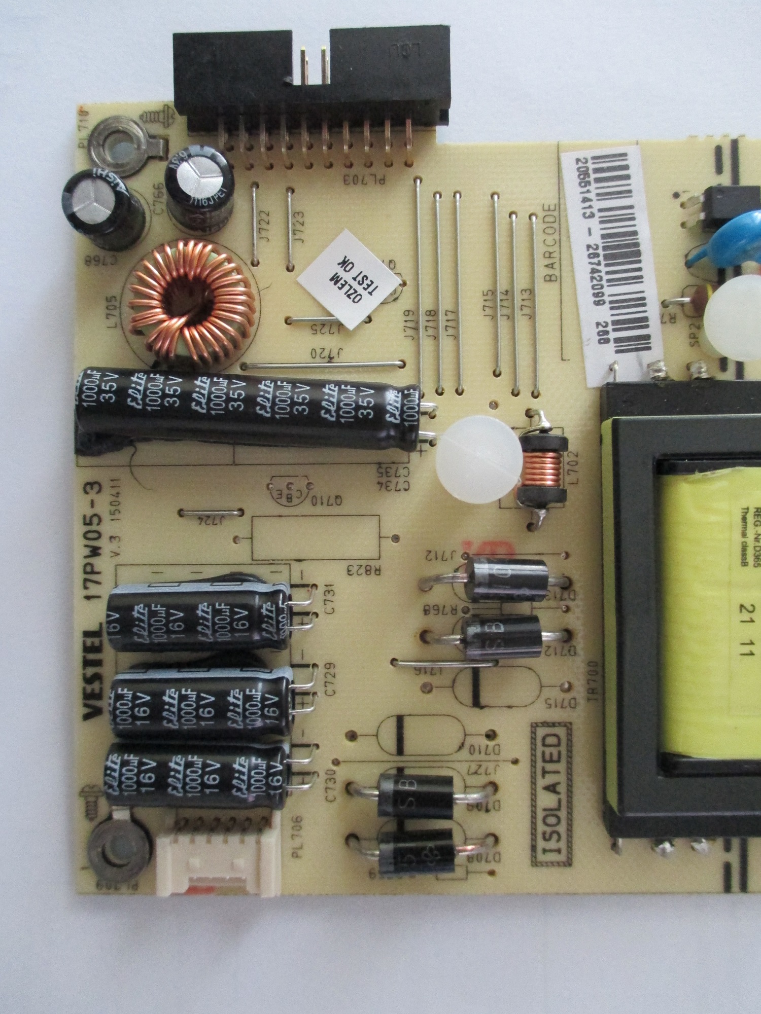

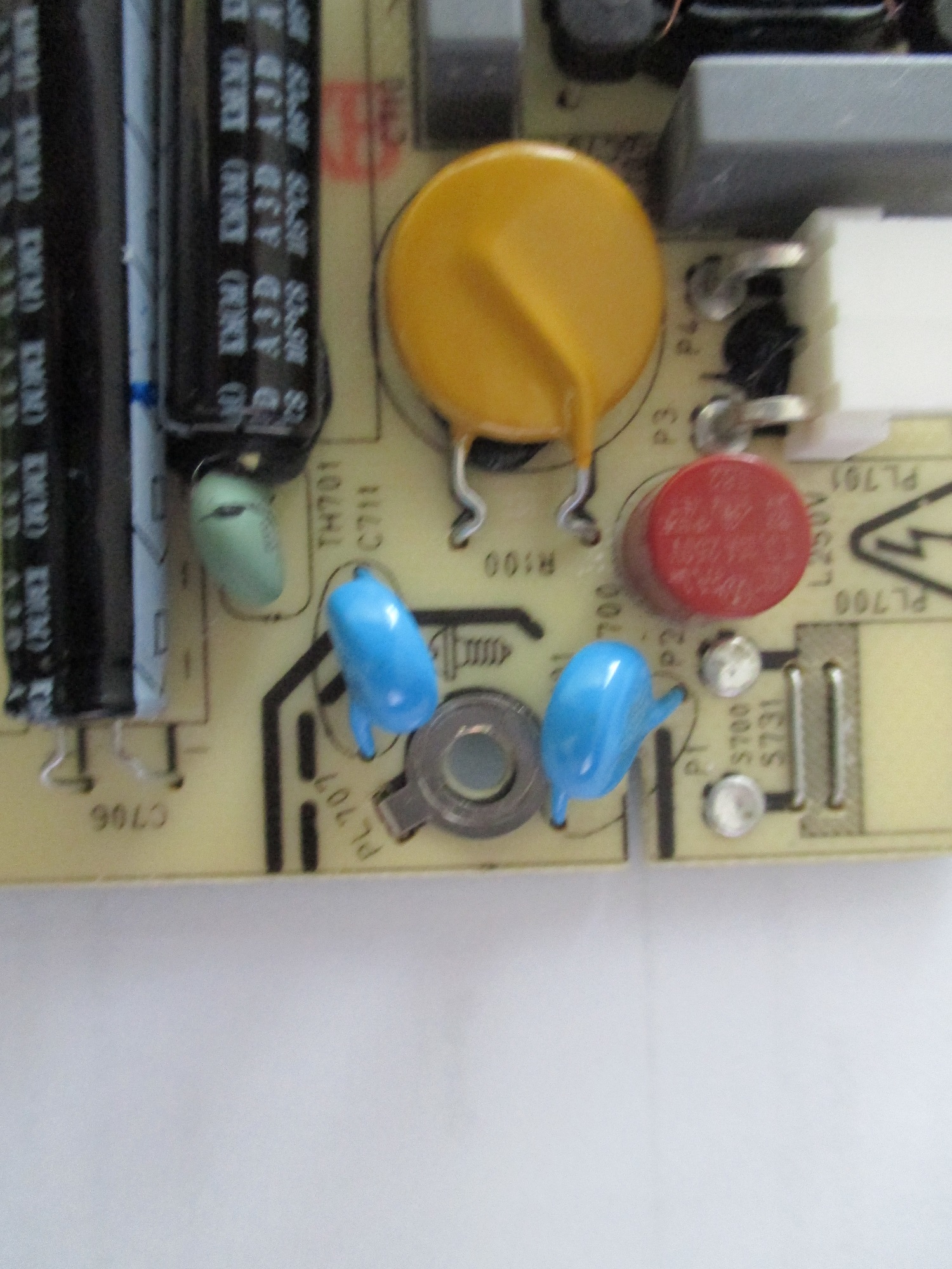

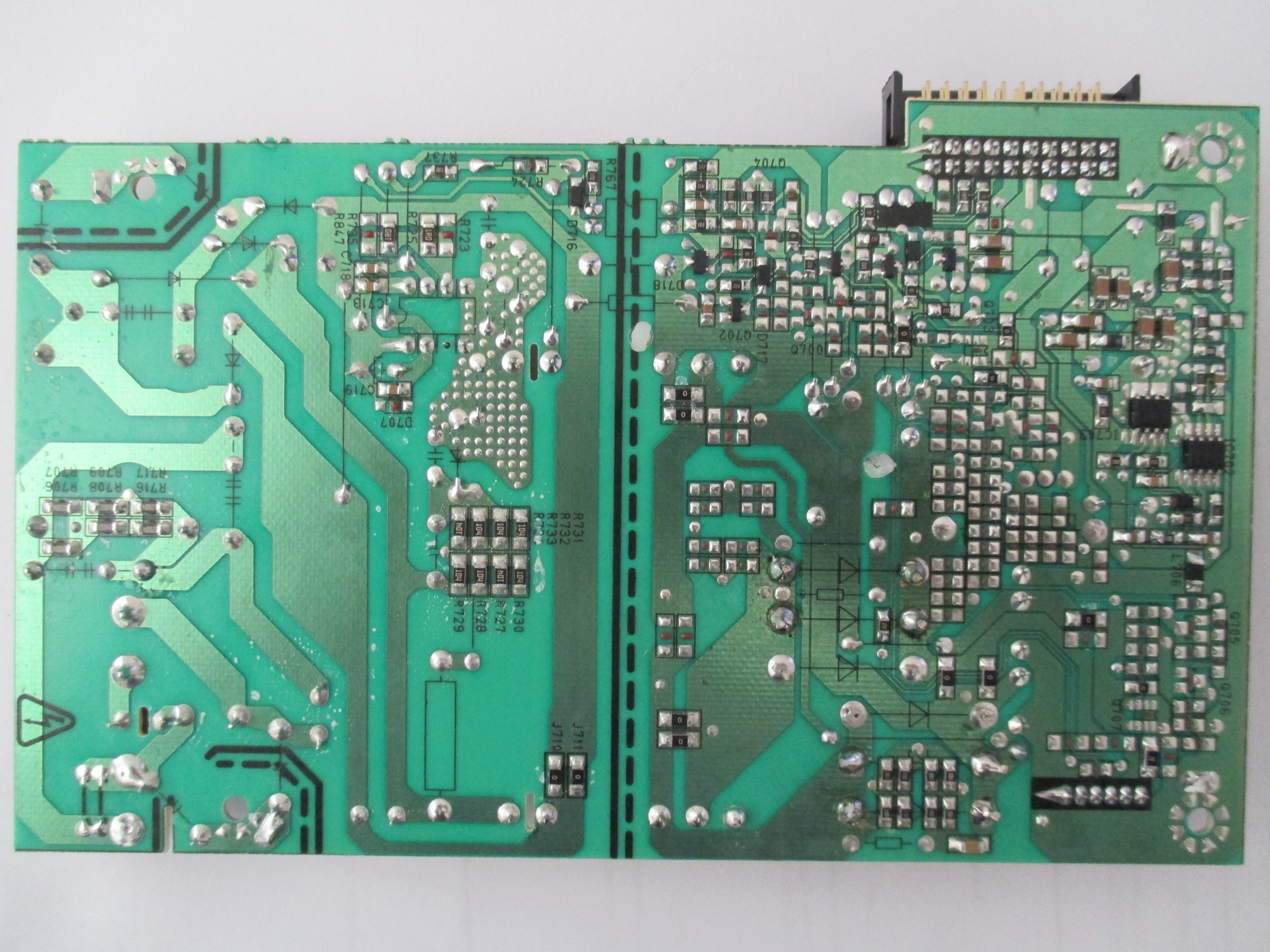

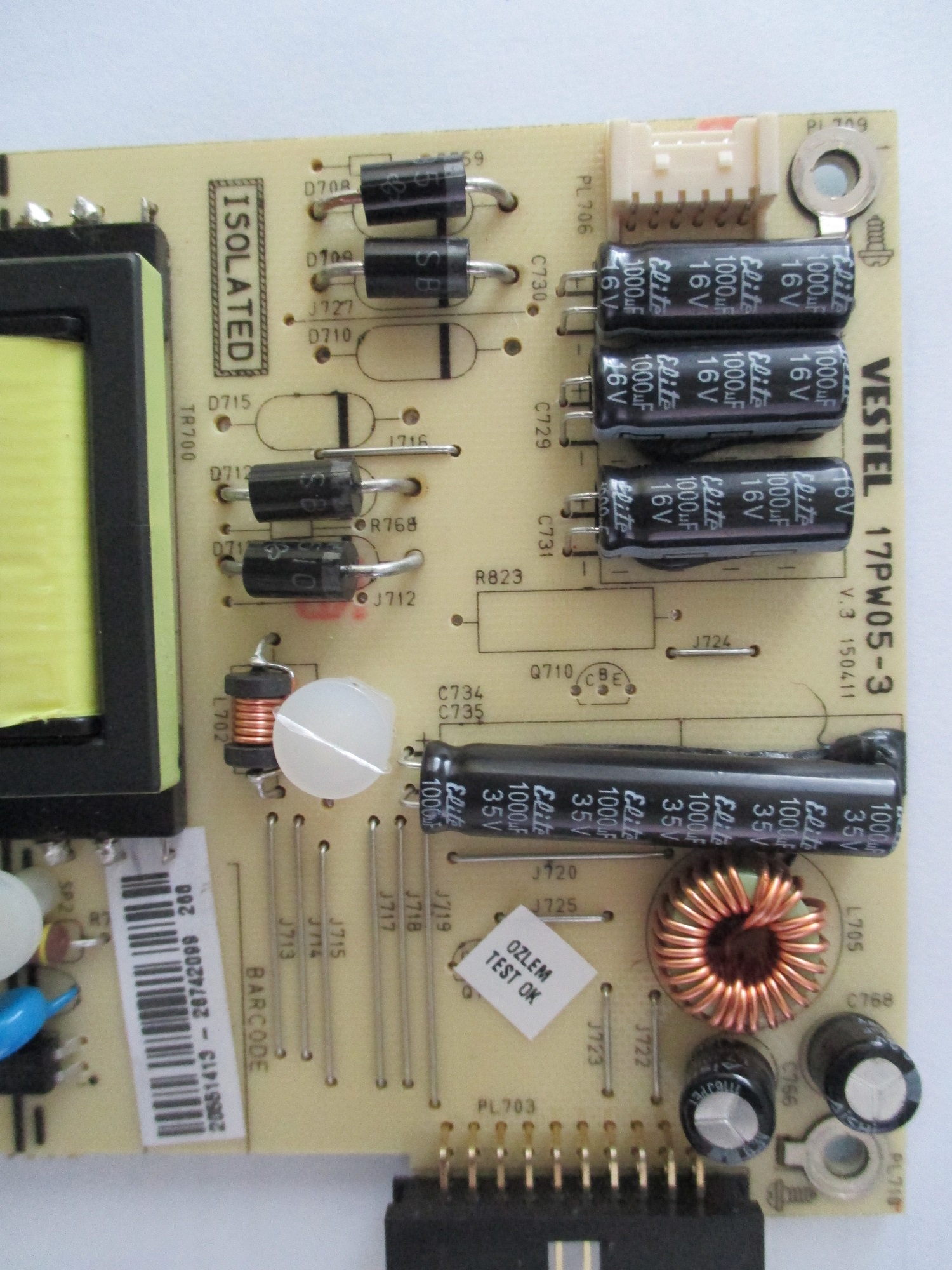

                  Pictures as requested which I hope are useful for showing the psu board. I have included three close up's of the area around PL707.
                  Thanks for your reply and look forward to hearing any suggestions for going forward.

                    If you have a capacitance checker then check C701 & C711 and also with your meter on the highest Ohms range check resistance of each.
                    TH701 should measure 10 ohms.

                      Thanks for the advice. I am awaiting delivery of a capacitance tester but in the meanwhile have completed a resistance test using my Philex 83000R multimeter set at a resistance of 2M.
                      C701 gave a reading of 448, but this moved around quite a bit to reach 515.
                      C711 peaked at 1100 and seemed to stabilise at around 980.
                      C701 looks like it needs replacing? However I can't make out much of the detail on the cap (SHM, X1400, Y1250 and E102M). As I am totally new to this I have no idea what to get as a replacement so any suggestion would be appreciated.

                        What DCV do you have between the two legs of the main filter caps C705, 706?

                            So you do have main DCV to run the SMPS IC700.
                            Do you have any DCV between the +/- legs of these caps?
                            C729
                            C730
                            C731
                            C735

                              And having now been able to check the blue disc capacitors, one shows 986 PF and the other 928 PF. It would be great to know what they should be!
                              Thanks for your continued help.

                                Which blue disc caps? There are 5 of them.

                                  Re: Toshiba 19DL502B totally dead
                                  C729
                                  C730
                                  C731
                                  C735
                                  All show 12.56
                                    #37
                                    OK, so the power supply is not dead then.

                                      The blue caps are the one's that Dick-Barton suggested I check-C701 & C711

                                        Are you sure that C735 only has 12V? It should have 24VDC.

                                          Those are SAFETY X/Y caps for line noise filter, they are not needed for the circuit to function, no need to worry about them at this point.
