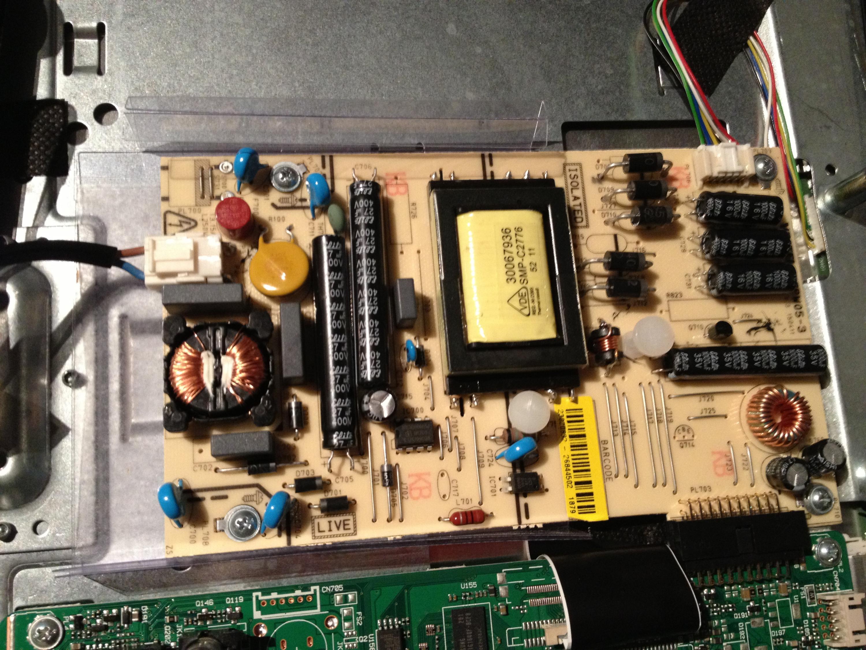

    My sons small TV/DVD combo has gone dead. No red standby light, no sign of any electric life inside. Played with holding down the power button as the manual says, but nothing. As it is half term school holidays in our part of the world this has not been good news! Not to mention the Faulty Towers DVD still in the DVD drive!
    We have opened it up and found a Vestel 17PW05-3 Power Supply board inside. We've got 235V coming in from the socket, no obvious burnt components and now I'm trying to identify the broken bit(s). Happy to invest into a new Vestel board, as long as I'm reasonably sure it is the troublemaker.
    From a previous thread covering a Toshiba 22BL502B with the same Vestel power board I gathered how to check the voltage for the panel back lighting, PL706. Pin 1 & 2 go up and down, from just below 0V to something like 6V, oscillating happily within a few seconds, ie pretty erratic. Rest of pins all read zero V.
    But, I have no idea how to check whether the Vestel is supplying the main board with anything useful, at PL703.
    Any advice would be greatly appreciated.
    Cheers folks

    Everythng in this TV is Vestel supermarket junk - it's the same as an Alba, Technika, whatever. Toshiba contracted it out under their good name, ripping off customers in the process (IMHO.)
    I have heard a common issue with these PSUs is a shorted diode.
    Can you post a picture of the whole PSU?

      Re: Toshiba 19DL502B totally dead
      Struggling with the attachment functions, full pic should be there now
          Yep, pretty standard LG screen - nothing special. They're OK. You'd get the same in any Vestel TV -- I think Toshiba made their own remote for these sets though!
          To test: you need to set your meter to the diode range and put it across each diode. Then reverse the probes. For each diode, note the reading. A low reading <100 in both directions is indicative of a short circuit.
            The three fellows grouped together all read zero in both directions, whereas the two grouped together gave values between 400-1600 or so. I had the power disconnected whilst measuring. So the three are all dead?
              to comfirm 100% you really need to unsolder each diode and retest.
                  Yeah, pretty typical on these (and other variants) is one of those three go bad, you can find whichever ones are OK and run briefly (max 2 minutes) with it removed. The diodes are in parallel, which is bad design because diodes have a negative TC (temperature coefficient)... this means as they get hotter, their voltage drop falls, which allows any one diode to conduct more current, causing it to get hotter, causing more current... before "POP" and it's dead.
                      More like, one goes bad and they all appear bad. So only one is actually bad and set will work with one less diode briefly. However, once one fails, the others aren't far behind. Basically one diode ends up taking all of the load and fails because of this.
                      I think they are UF5408 or similar. I would replace all at once, because of matching between diodes. RS is best, eBay 2nd, Maplin don't stock them in my experience. I'd also consider some thermal epoxy between diodes to help keep them matched at the same temperature.
                        Ok, as they are in parallel I'm measuring always the same circuit, slowly starting to get the drift.
                        We have a RS nearby, I'll certainly change the lot, not doing this again next week. I assume putting in a bridge from thermal epoxy, creates also additional surface dissipating the heat a tiny bit better.
                          No longer dead!
                          Took me a while to get to it, but it's alive & kicking again. 3 new diodes did the trick.
