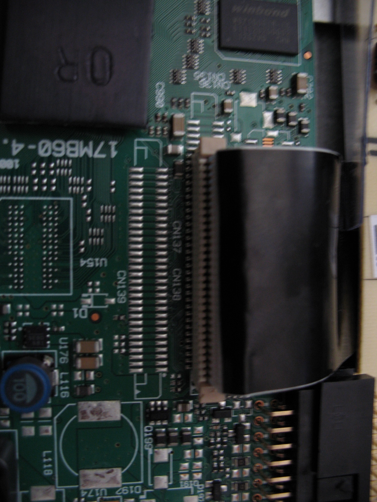

            Can we see the pictures how the LCD panel is connected to the main board?

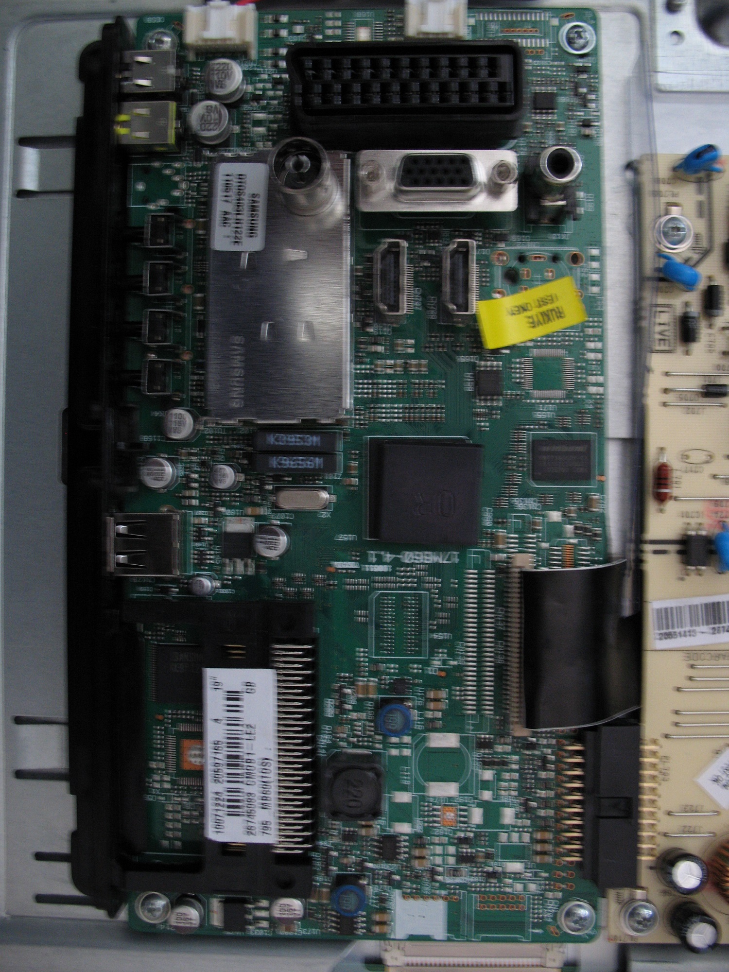

              #66
              Re: Toshiba 19DL502B totally dead
              Hows this?
                #67
                I cannot see how the LCD panel is connected to the board.
                We need to find out if the LCD T-CON is getting the signals and the Voltage to run or not.

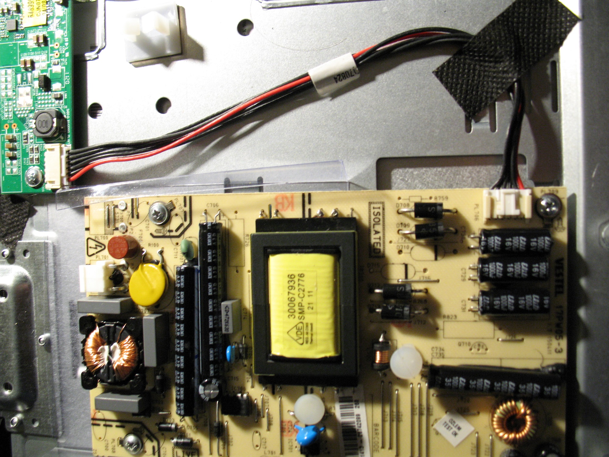

                  sorry to tell and you are following of fault which had story of screw...
                  you have cracking at layer print of yours Vestel 17pw05-3, it cant noticed just with eyes unless the boards waved , and each time you take it out in hand and back the crack growing to reach join point of SMD parts.
                    #69
                    He should be able to push on the board now with a wood or plastic stick with all the screws in place to see if it will cutout the power, I hope that will be it.
                      if he push from top of board the crack will remain more open. it should opposite push from down to top of the board
                        I think you are correct about this as it seems consistent with what we have been finding. It is not however possible to push from underneath as there is just no space.
                        By fully reassembling (including the casework) and having very carefully tightened all 4 PSU board screws so that they felt secure but not too tight to cause any evident board distortion I can achieve a TV that powers up and which can receive a signal through the aerial which gives sound but no picture. The LCD appears backlit only.
                        As mentioned previously I know that the screen did work okay and all the connectors that I previously disconnected are clearly in place.
                        So this project still has some life in it with a new T Con board problem to resolve?!!

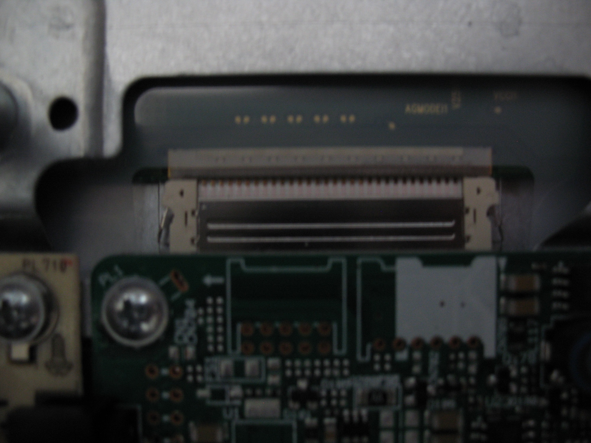

                          I think it is these you were referring to? Going from main board to top of casing. The main board on was disconnected as part of the earlier diagnostic exploration and I have checked again that it is secure.
                          So what do you suggest I should check?
                            #73
                            The LCD panel may bot be getting the Voltage to the panel to run (the panel probably has integrated T-CON which will not be replaceable).
                            There should be enough room to put thin flat plastic or wood under the board to flex the board. I would still try to flex the board from the top.
                            BTW, is there insulation sheet under the board? If is the board is <6mm above the metal chassis it will require to have insulation sheet at least around the hot side of the circuit to meet safety compliance.

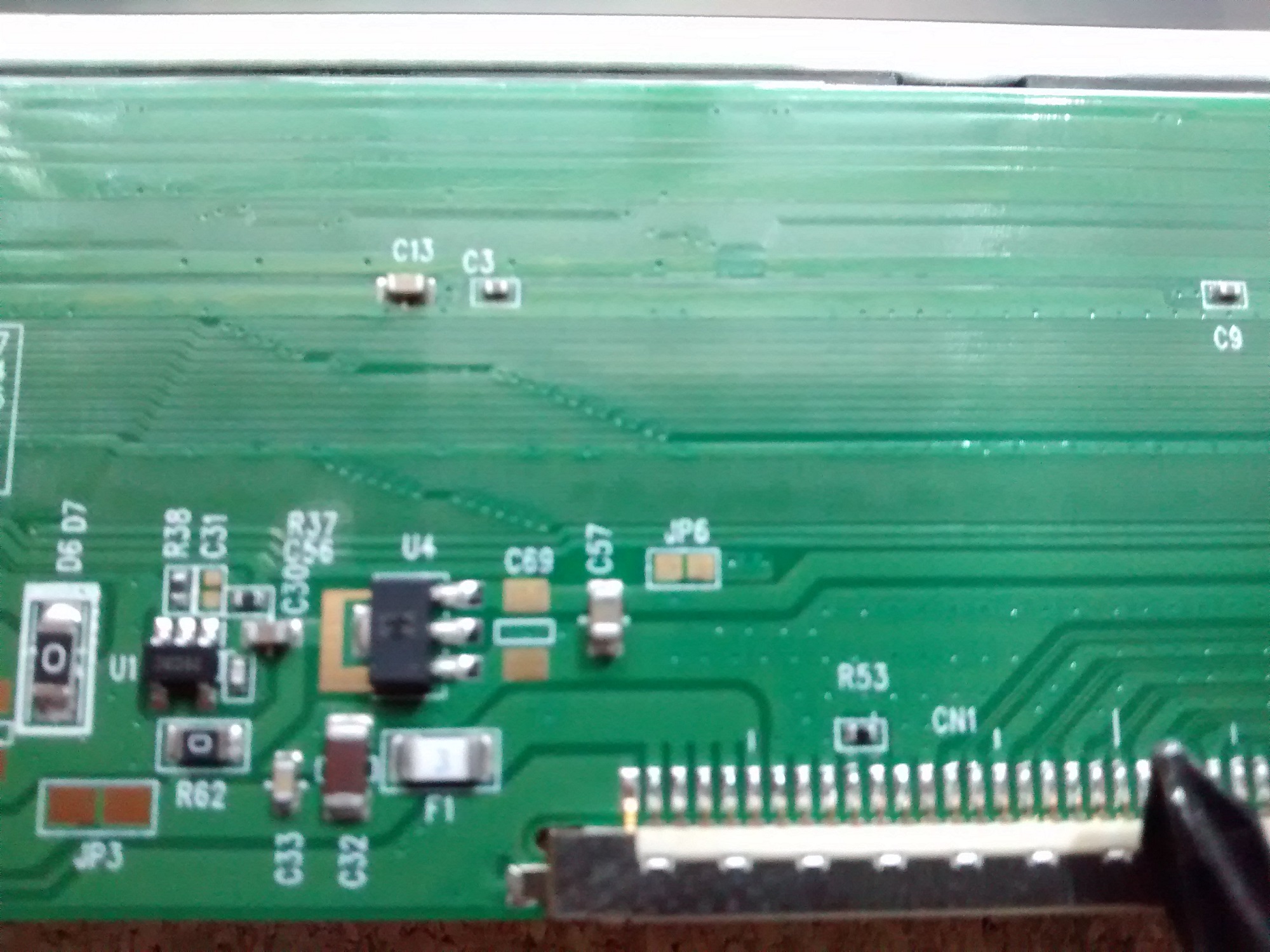

                              the T-con is under that metal shield and there should be a small SMD fuse close to that LVDS connector.
                              • viera247
                                • May 2016
                                • 28
                                • United Kingdom
                                #75
                                What does that fuse look like please?
                                This is the area around the connector if that helps. Apologies for quality, taken on phone.
                                Think I have found it. It is on the underside and shown as F1
                                      F1 is the fuse, it should have either 5VDC or 12Vdc (depends on the LCD panel model) at both ends with ref to the chassis GND.

                                        #79
                                        Shows zero so that's it I assume.
                                          #80
                                          0VDC, so the main board is not sending the Voltage to the T-CON board, more troubleshooting required.
                                          BTW, what is the LCD panel model number so we can look up the spec sheet to find out what the DCV requirement is for the T-CON?
