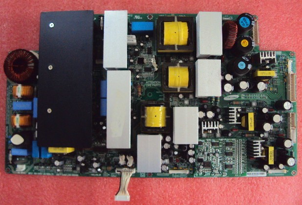

    Got this projection tv with no display. No Va, Vset and no 5V to YSUS board. Has anyone repaired this board before?
    No sign of damage on board. Board on internet seems expensive.

    Projection? You mean plasma?
    Pic of power board?

      Re: Techwood TWP 4205. Board: LJ44-00049A
      It is plasma but it's not a "TV" as in a full TV. cant explain it as I've never seen this before.
      Pic:

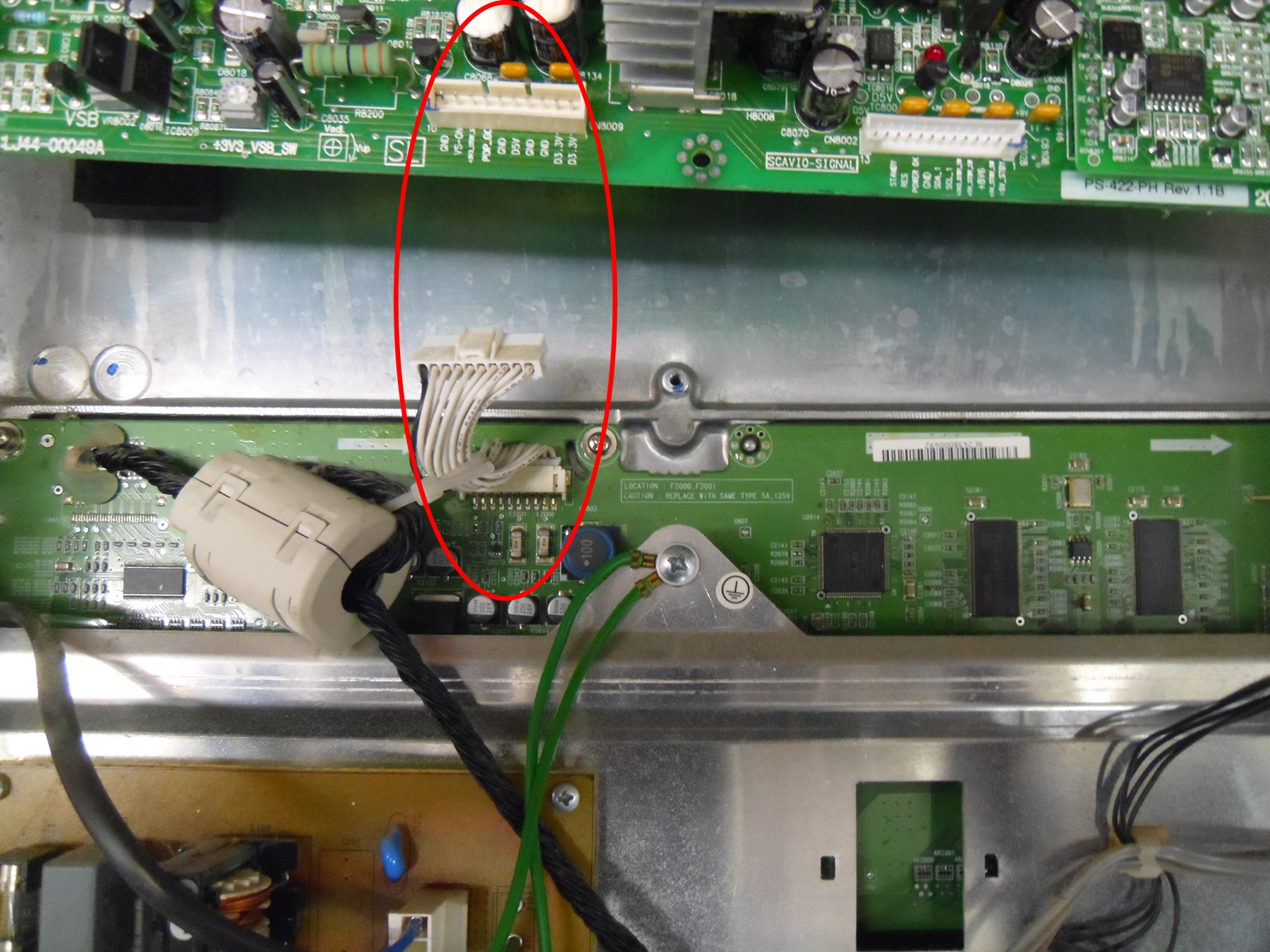

                  Connector next to "SL"... Does that go to main board or another part
                    See pic:
                    Full-time computer repair tech (10am - 6pm) and full-time, (8am - 11pm), Ruby on Rails Developer
                      That's control board, then. Check the VS ON and PDP GO signals.
                        Should I get a voltage at VS ON? If so, no voltage. Those two fuses are ok. No voltage at any of those fuses.
