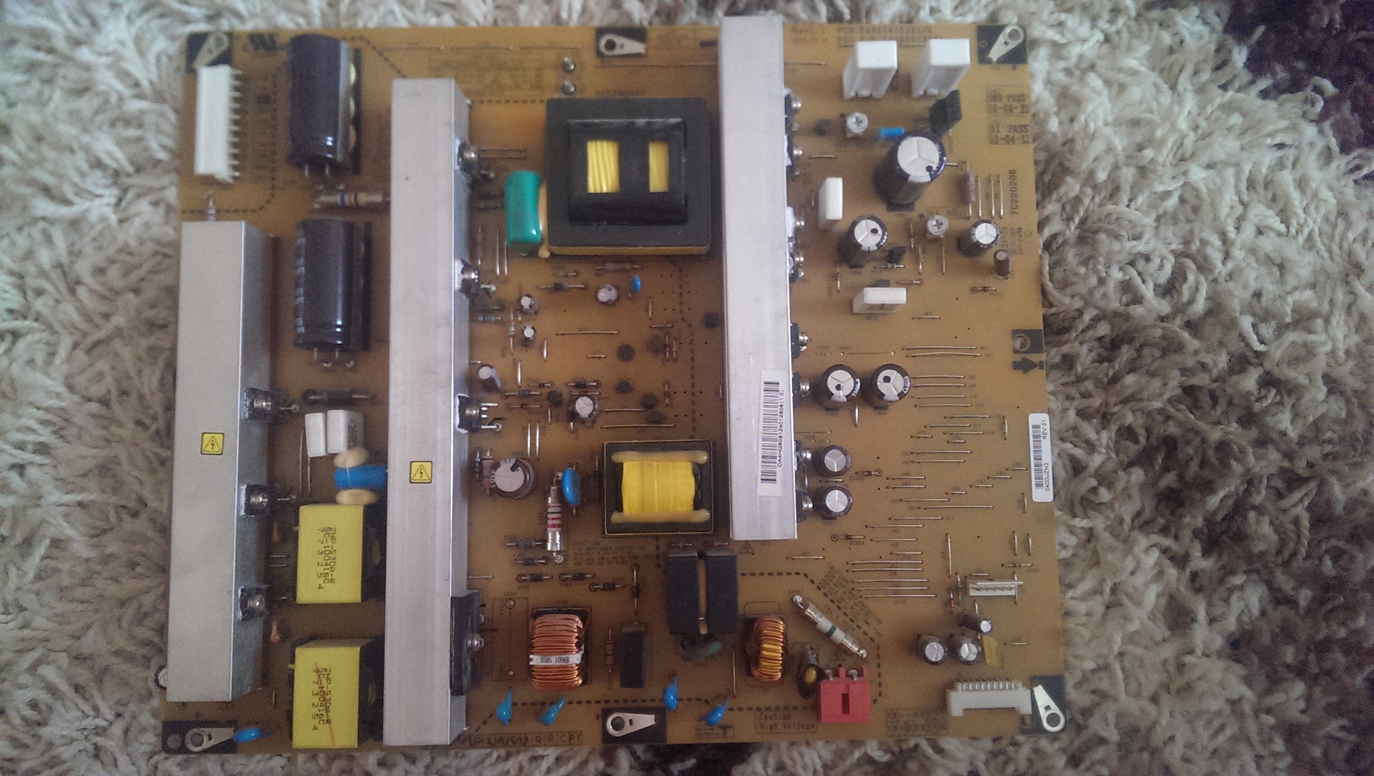

    I have clicking sound when turning ON tv, red light goes off and on. When I disconnect white cable from the left side of power board the tv stays ON but of course no picture. Anyone knows where can be the problem?
    Re: Lg 42pj350
    I have replaced on power board:
    2x 5W22R Vertical Ceramic Resistor
    1x 3BR1565JF
    but that not helps this time, but works fine with my LG 50pk350.
    I have no backlight and can hear buzz sound when turning on tv for a second.
    Last edited by sekino; 02-15-2014, 05:59 AM. Reason: uploaded picture of board on the left side

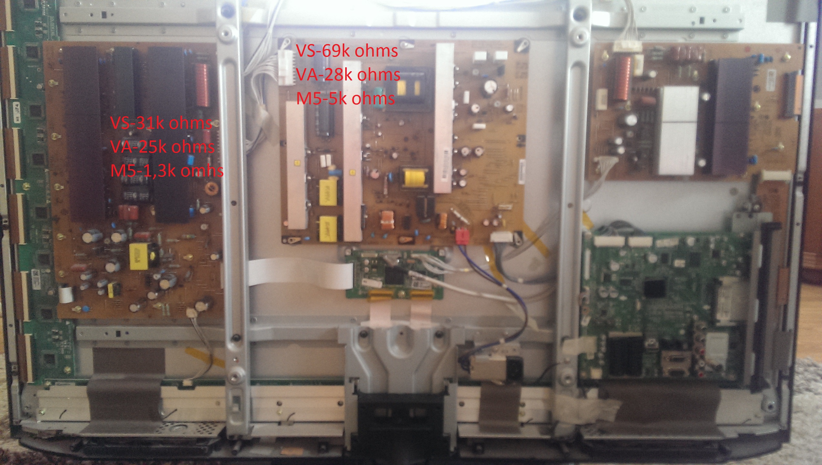

          Re: Lg 42pj350
          hopefully i get your point right, please look at my picture attached:
          1. if I disconnect plug from power board to Y-sus board (yellow rectangle) the tv stays ON
          2. if plug from Y-sus board is connected but i remove plug from X-sus board (red rectangle) the tv is turning off and on.
          I assume now that Y-sus board is faulty, what can I check on this board?

              Re: Lg 42pj350
              I don't get it. Please look at my picture.
              1. First I disconnected plug 1 > TV stays ON
              2. Then I reconnected plug 1 (that means all plugs connected) > tv turns off and on.
              3. With reconnected plug 1 (that means all plugs connected) and disconnected plug 2 > tv turns off and on.
              If I should test something else please highlight it on my picture.
              Thank you very much.

                  Re: Lg 42pj350
                  I measured resistance with unplugged plug (1), see picture.

                      Re: Lg 42pj350
                      Not sure which plug to disconnect, hopefully ot's one in bottom left corner o Y-sus board (red square on picture) or something else?
                        Re: Lg 42pj350
                        Not quite.....
                        The long green panel on the left is the Buffer-board. As I recall--there's a row of screws that connect the buffer to the Y-SUS where they overlap.
                        You'll need to remove all those screws, and separate the boards so there's a small gap between the boards as well as that small white flat lead--Then re-try.
